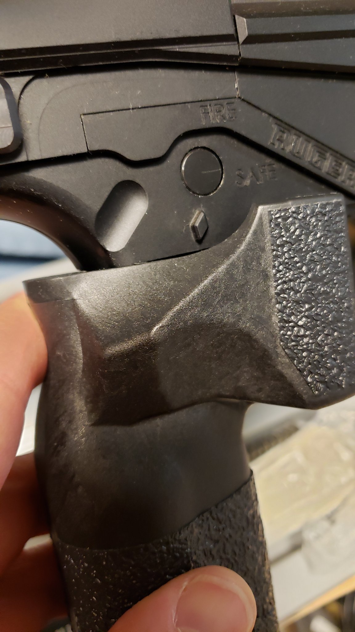

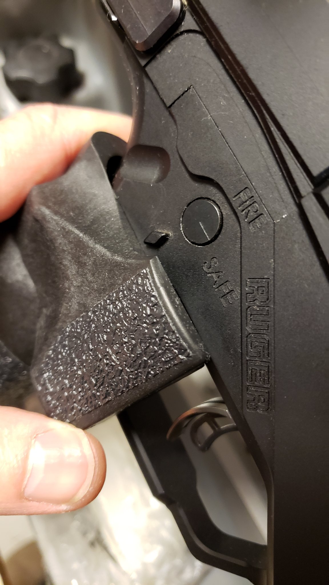

I would have to make them a little better, in which case I would have to make a block. HOWEVER, if you are interested and want to make a go at it yourself, I will tell you how I did it.
The one advantage I did have, is having multiple rifles so that I could attach 2 of the existing cheek pieces together to make a form.
Hit me via a PM and we can discuss it and not clog up the thread.

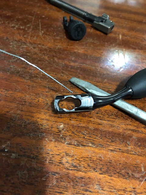

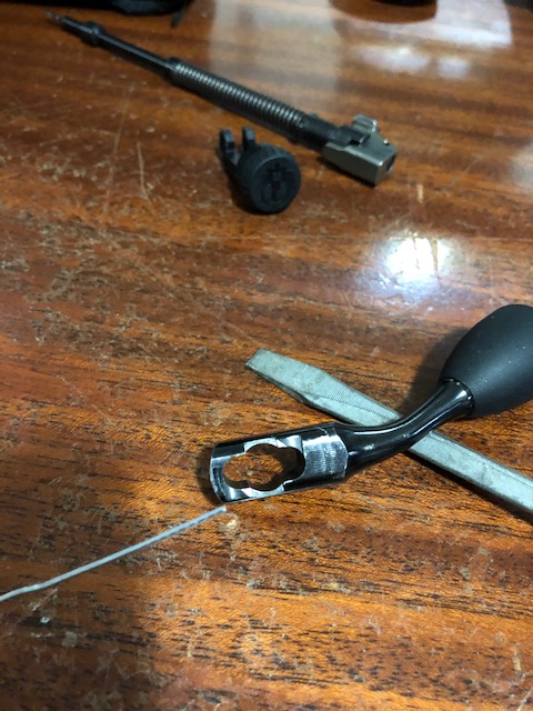

I spoke to Ruger today. They had never heard of the problem, however they want me to ship the bolt and firing pin assembly back to them.
The bolt handle has an indentation machined into it so the firing pin stop ears can lock into it (look at the schematic in the manual). The indentation has rounded off on one side and is no longer square on mine. I expect the ears are sliding past and out of the indentation groove and that is where the problem is. I'll let you know what they say when it comes back.
You can see in the photos that the 90 edge has worn away in the indentation.
Yep that warn bolt handle is the likely root cause of original problem. Ruger replaced mine when I sent in my bolt. I'll have to disassemble it periodically now to check for any wear in the future. Anyone make a hardened handle thats more robust to the wear? Ruger should've designed this part to be more robust to this type of wear.

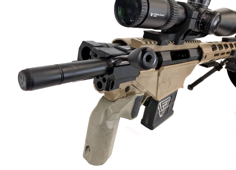

Got my magnum bolt back from ruger. Looks like they installed a new handle and shroud. No written explanation of what was wrong Dry fired it s few times. Seems to work out but for how long?
It's probably going to last until you round those edges off the bolt handle again. I went a different direction and ordered a 17-4 stainless handle from Anarchy.

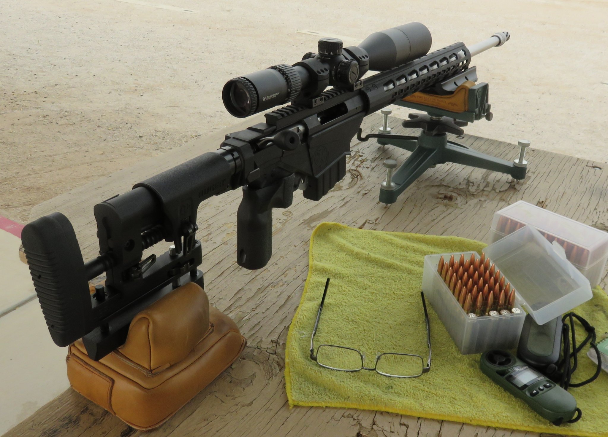

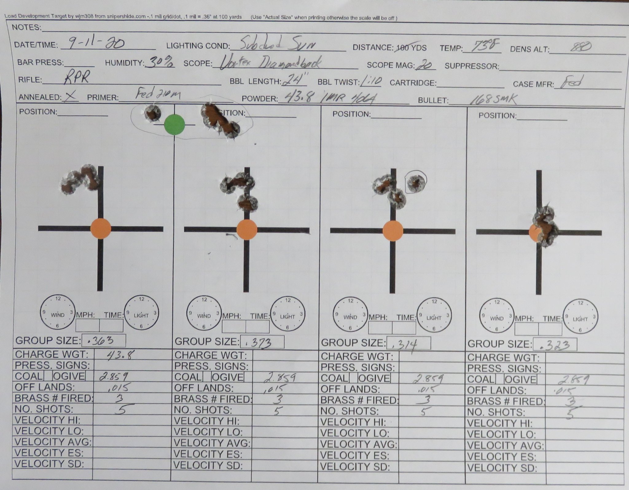

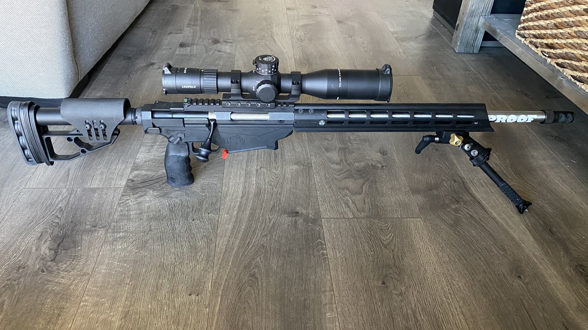

A couple changes to my Gen2 .308 and having a ball with it shooting 40-70 rounds a week. Now, I've mounting a Vortex Golden Eagle (not in the pic below) on it to help me see better further out (like at 1,000 yds).

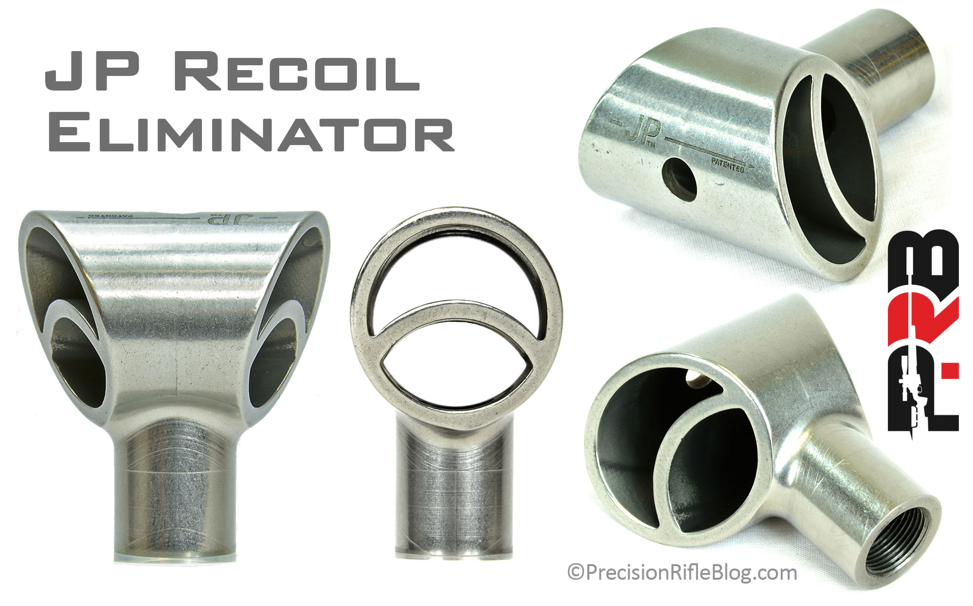

You should try a 3 port brake on that, I bet you’ll have a lot more reduction in recoil then what you have now. Nice shooting!
Reactions: DScorp
I also just added the MPA grip and that adjustable bag rider but the base rang has been closed for lead abatement hopefully some time in Jan back open. With ammo prices being what they are I am saving my rounds for the thousand
Reactions: straightshooter1
No doubt about the recoil. It's Harrell's all one piece tuner-break and there was a noticeable increase in recoil from the factory break. I have a new tuner on the way that'll allow various brakes to be mounted along with it without any need for any machining modifications. So, I'll be mounting the factory break back on, though I do have a break that works well and helps stay on target well though a bit ugly (the JP Recoil Eliminator - see pic below). Typically though, recoil for me is not a big deal, especially since I usually shoot my RPR free recoil.

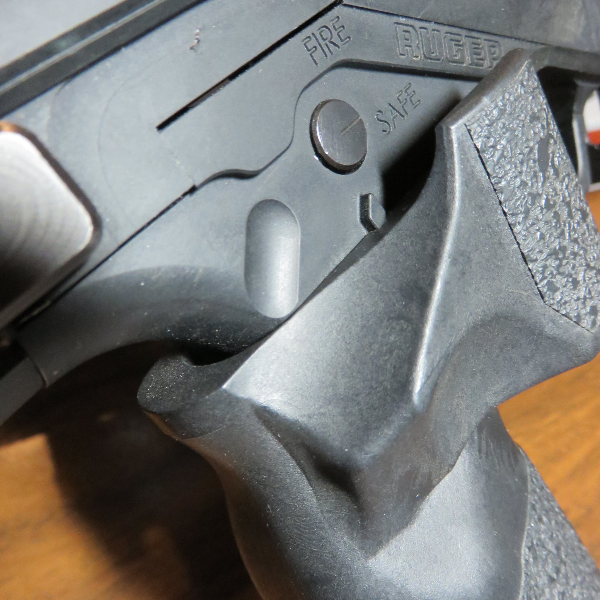

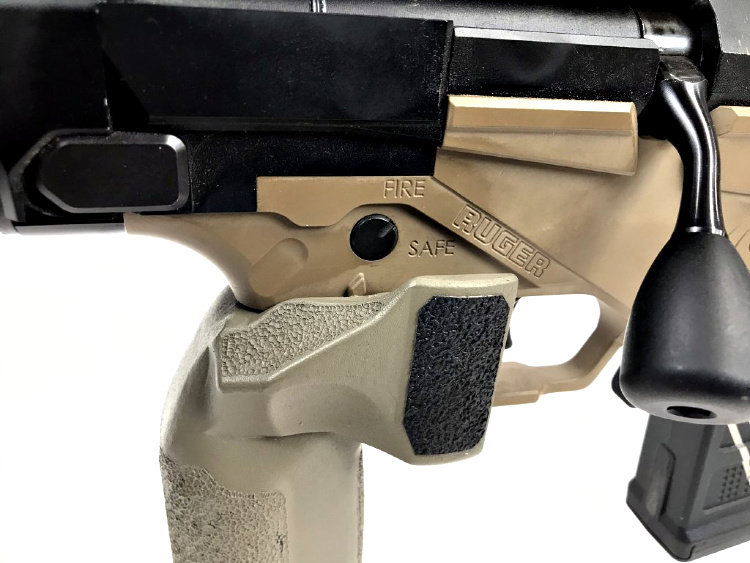

I've heard the MPA grip isn't a straight 'screw it on' addition, requires some modification. Any comment on that?
All I did with my right handed MPA grip was to just screw it on (on my Gen 2 RPR). There's been no interference with the safety or anything else.

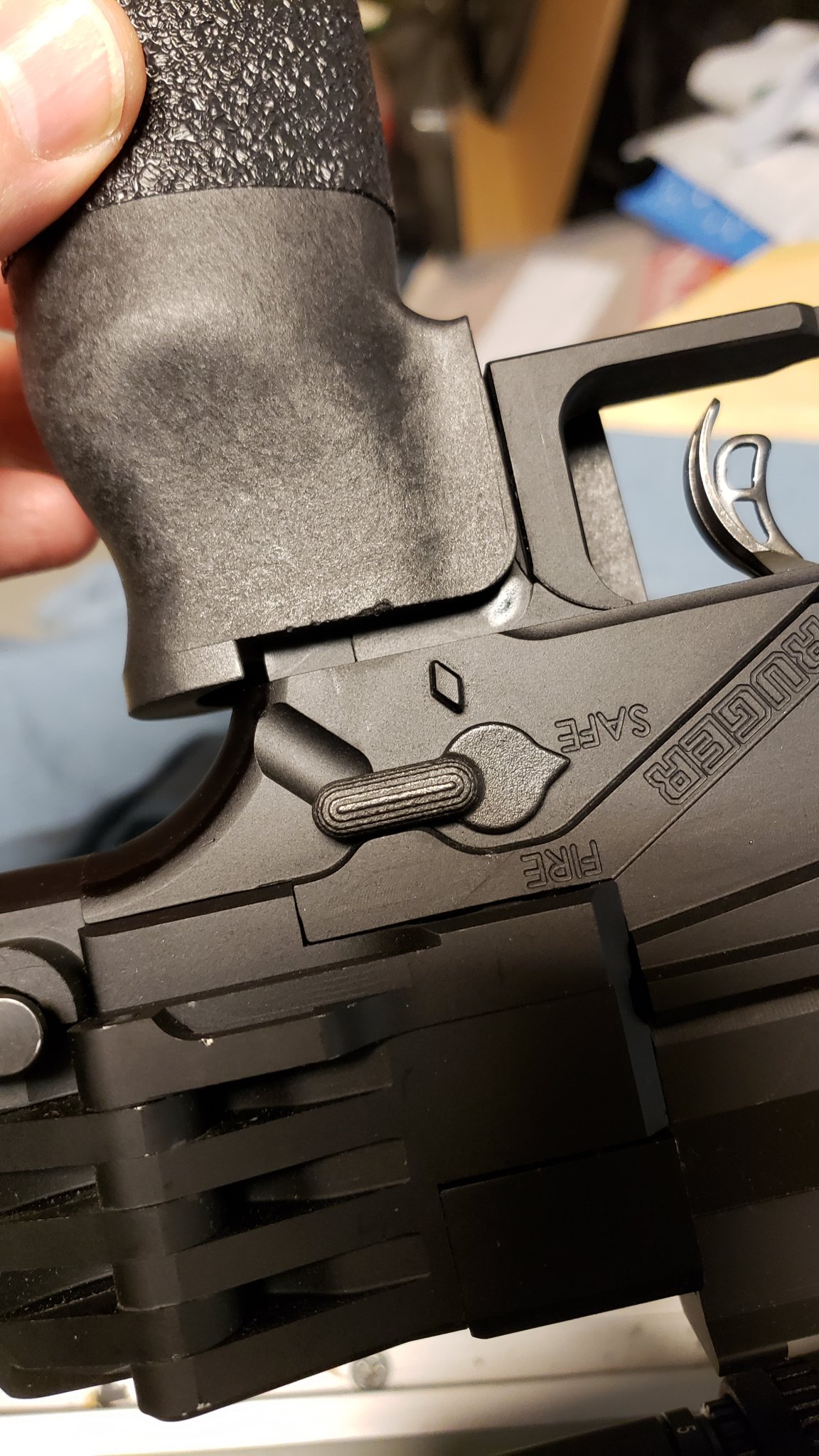

There seems to be a ledge on the top, inside right of the grip that doesn't let it slide all the way onto the gun with mine (also Gen2). I can drag out the Dremel or a file, but it's gonna be a hack job.
Hmmm??? I think the only little thing with mine was that the safety stop on the right side dug into the grip a little as I tighten the screw on the grip. I wonder if MPA changed up their grip design a little since I bought mine??? 🤷‍♂️

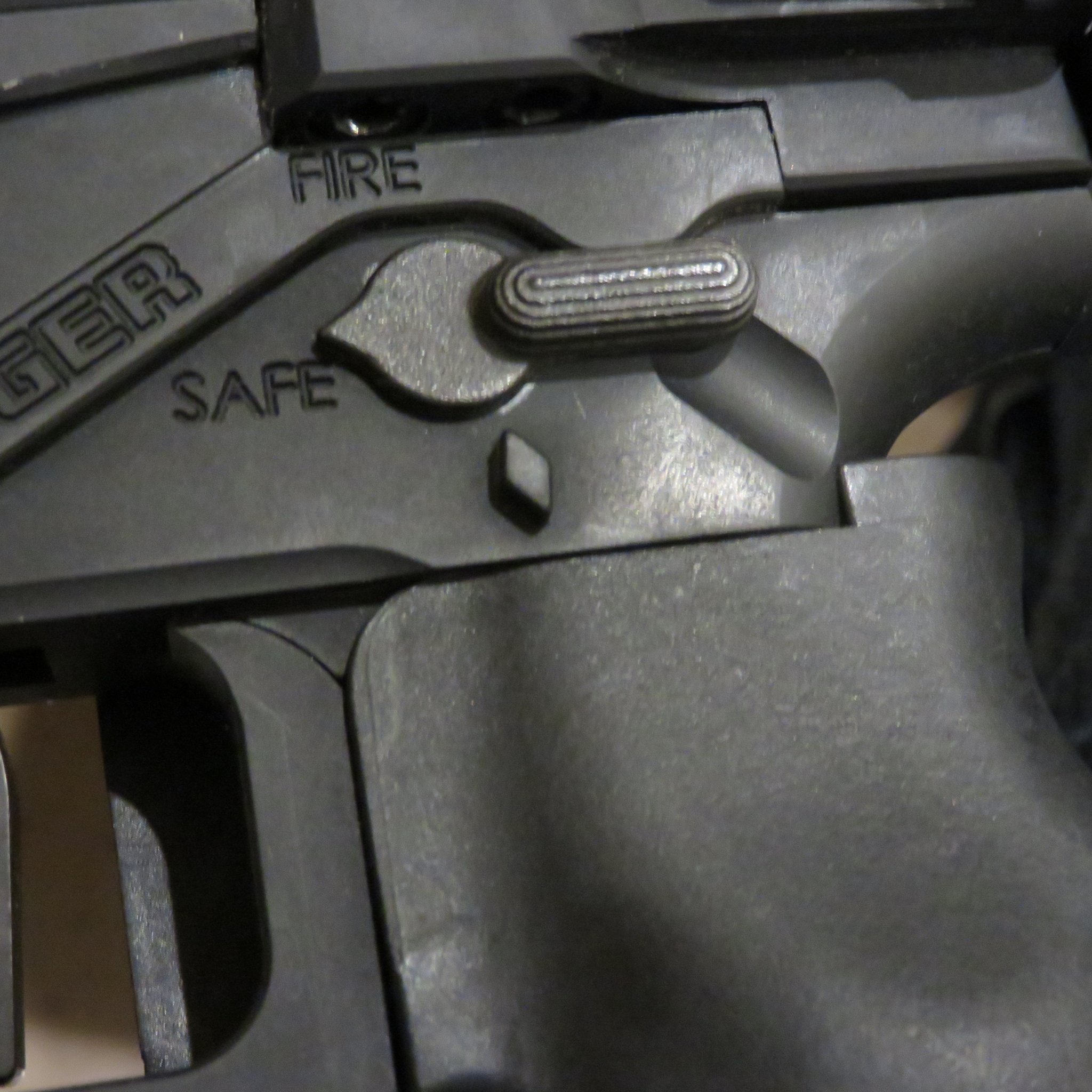

Here's some pics of mine on my RPR:
Reactions: DScorp
Thanks for the pics. I'll see if I can get some decent ones and show you what I'm seeing.

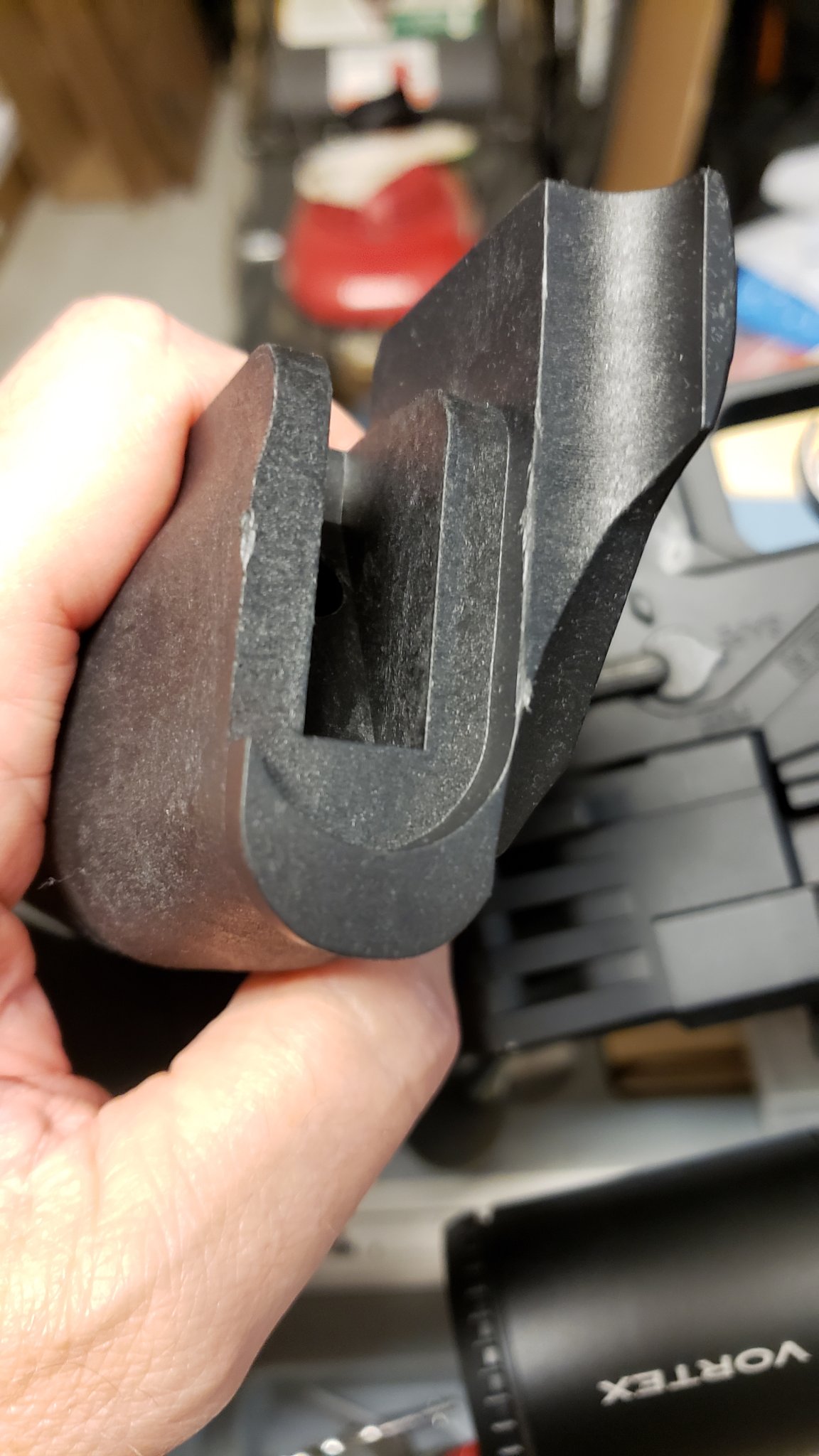

Please do. Mine just needed a small notch cut out of the inner circumference to clear the safety stop on the right side. It bolted right up after that. That grip was one of my first upgrades to the rifle

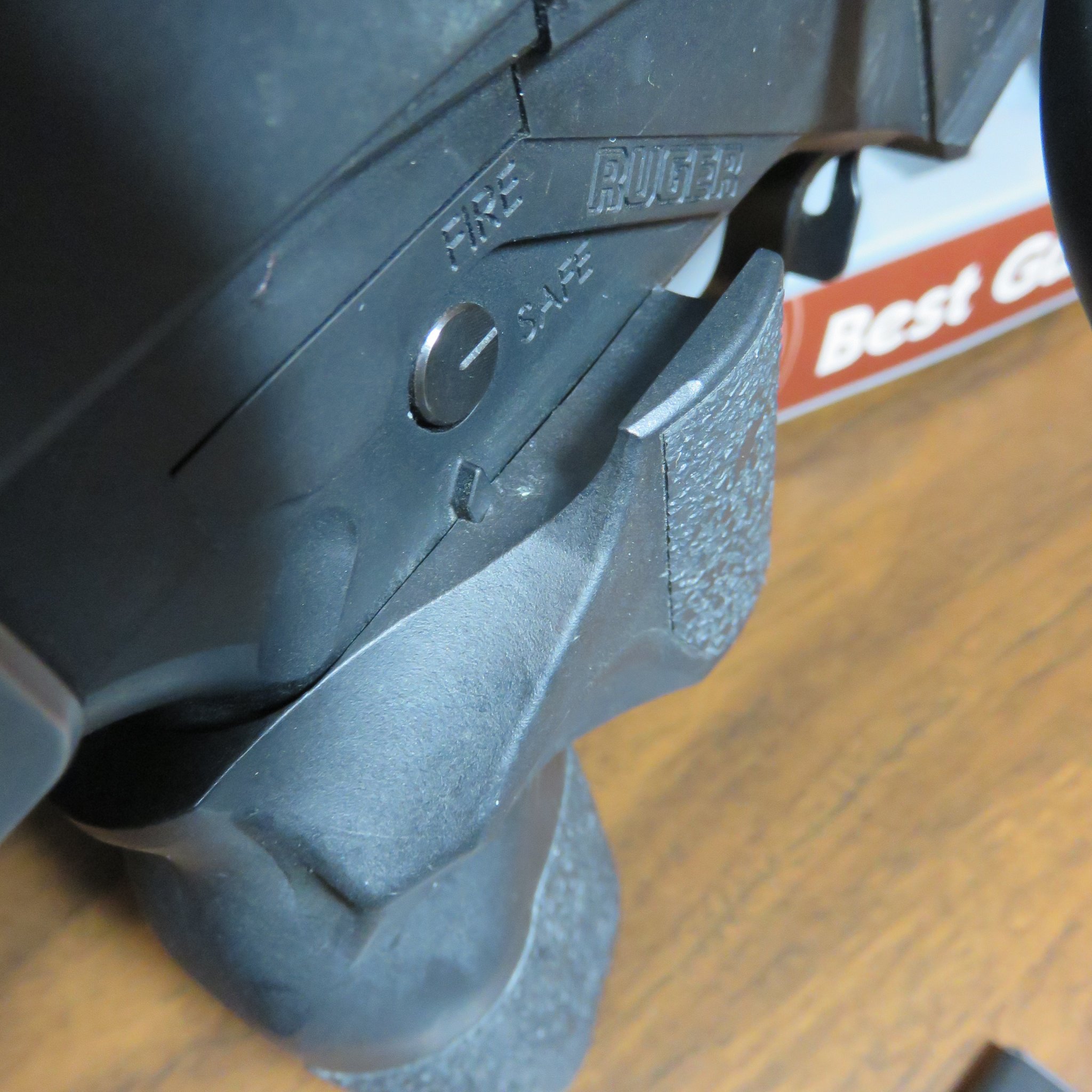

Ok, here we go:
You can see it never reaches or touches the safety stop on either side. There's a ridge along the right, inside top edge of the grip, and it's stopping on the frame of the rifle. I considered trying to flex the grip, but the material isn't very flexy.
I may have to grind that ridge down with something to give some relief to slide up into place.
