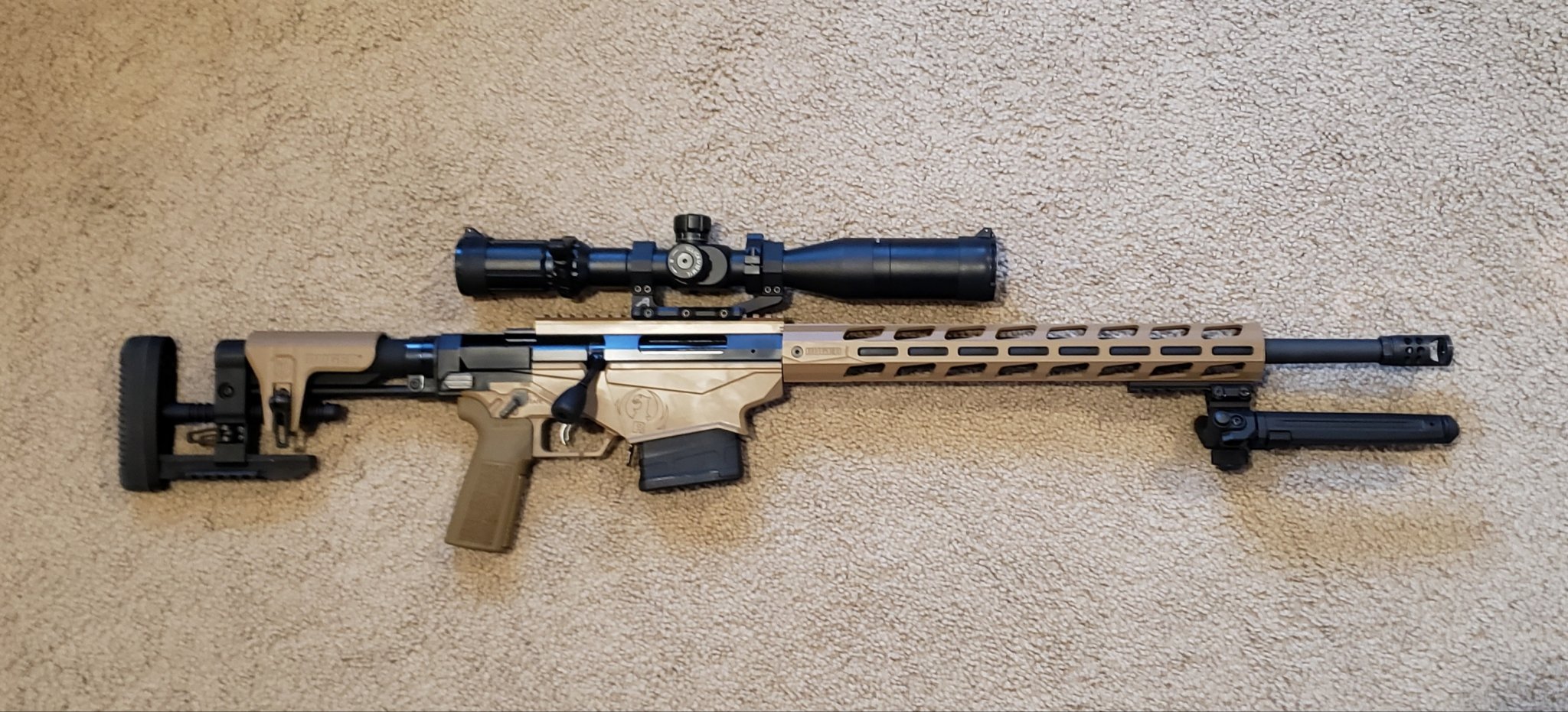

After reading all 99 pages, I have bookmarked and learned alot. I finally shot my RPR and I am very grateful to be apart of this group. This is my first bolt gun and I feel like it is a great place to start.
Rifle and Parts Breakdown
• Ruger Precision Rifle Gen3 Barrett Brown 308
• Primary Arms SLX 4-14x44mm Illum ACSS HUD DMR-308
• Aero Precision Ultralight 30mm Scope Mount blk 1.5"
• Magpul Rifle Bipod 1913 Blk
• B5 Systems Type23 P-Grip Coyote

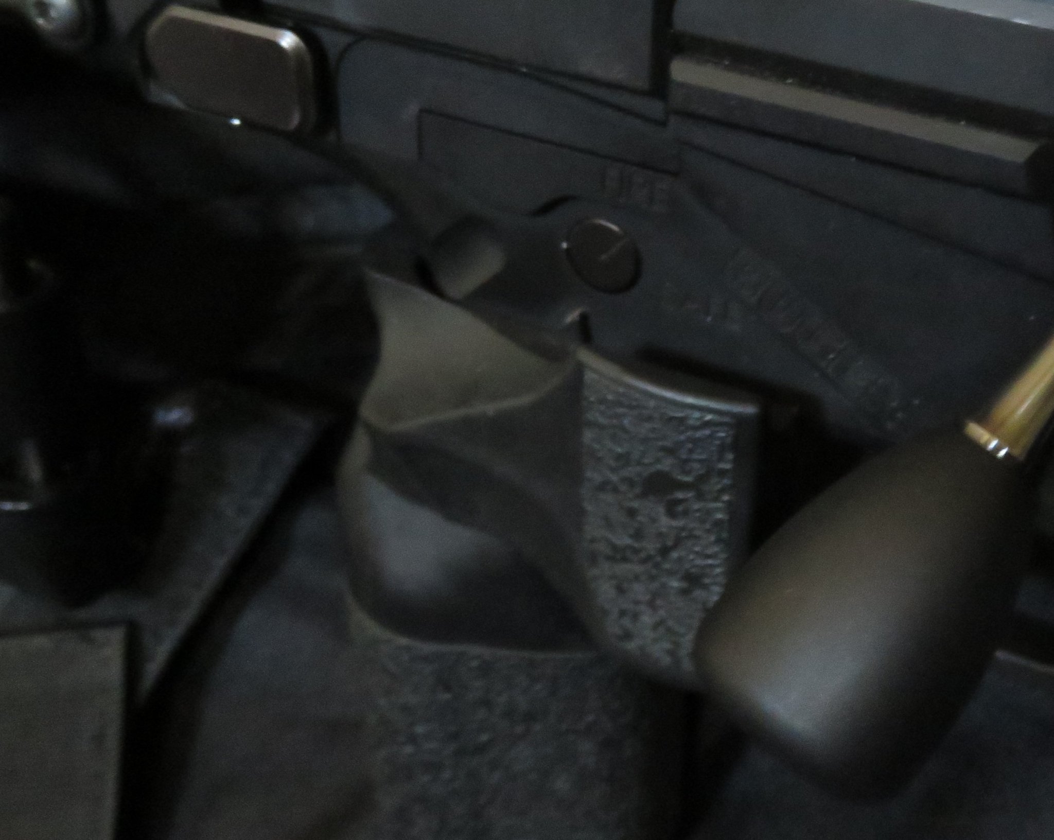

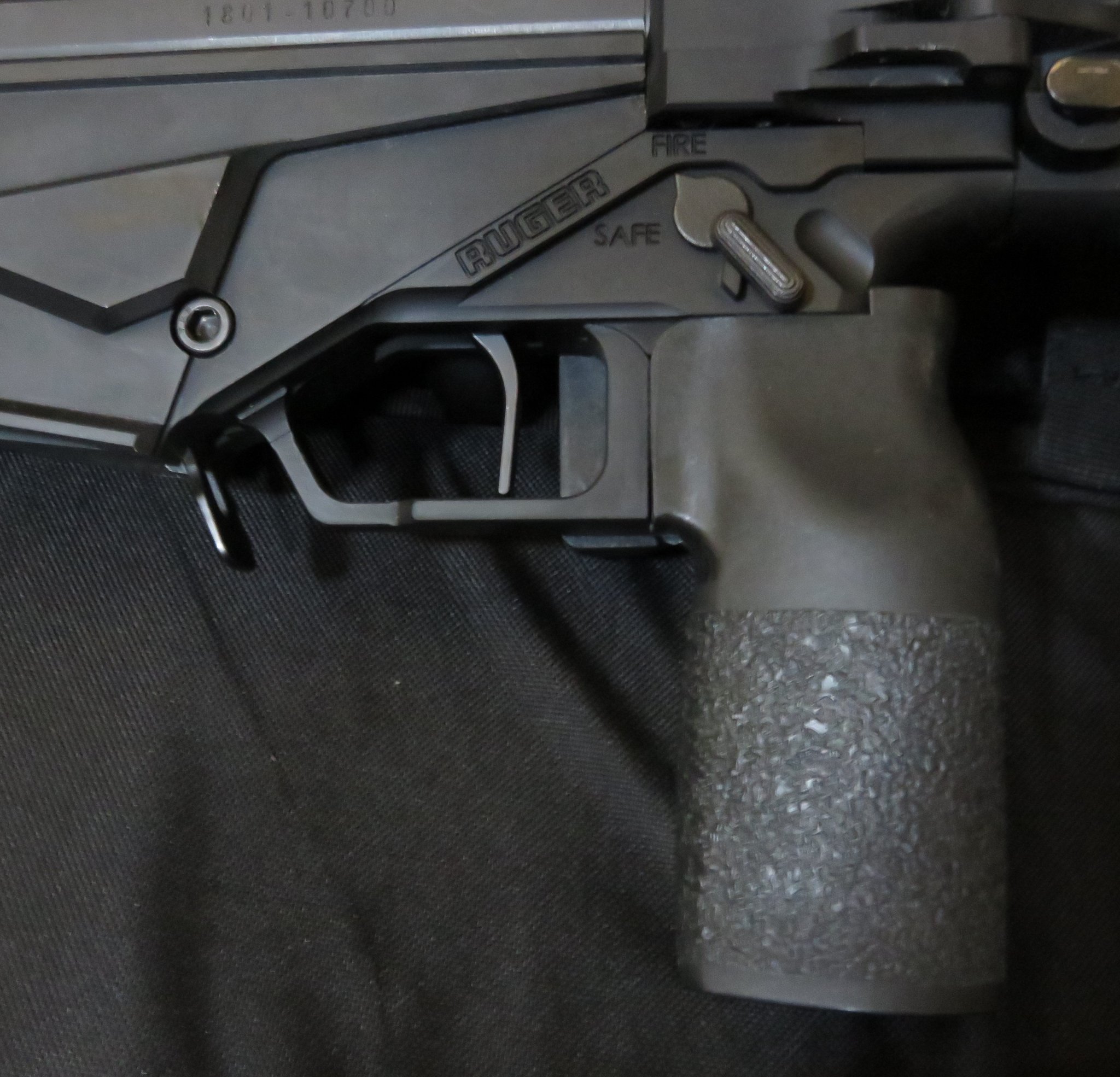

Does anyone have pic of what they did to put MPA vertical grip on there RPR I don't want to hack this up very much and it seems like the safety will still be in the way of the shelf thanks
How's this? :
On the other side there's still no interference and a gap between the finger rest and the lower frame:
