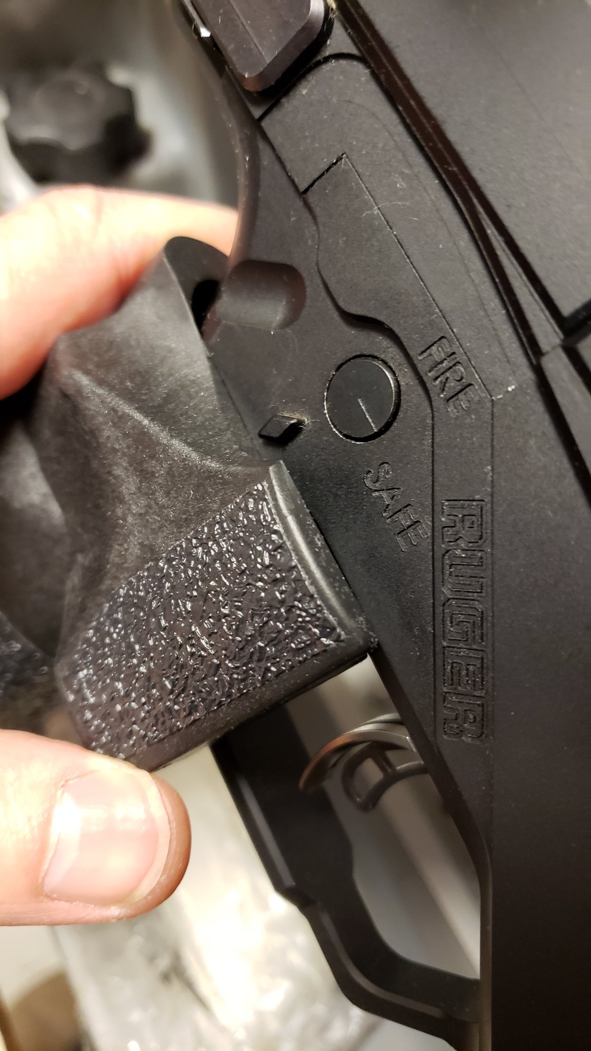

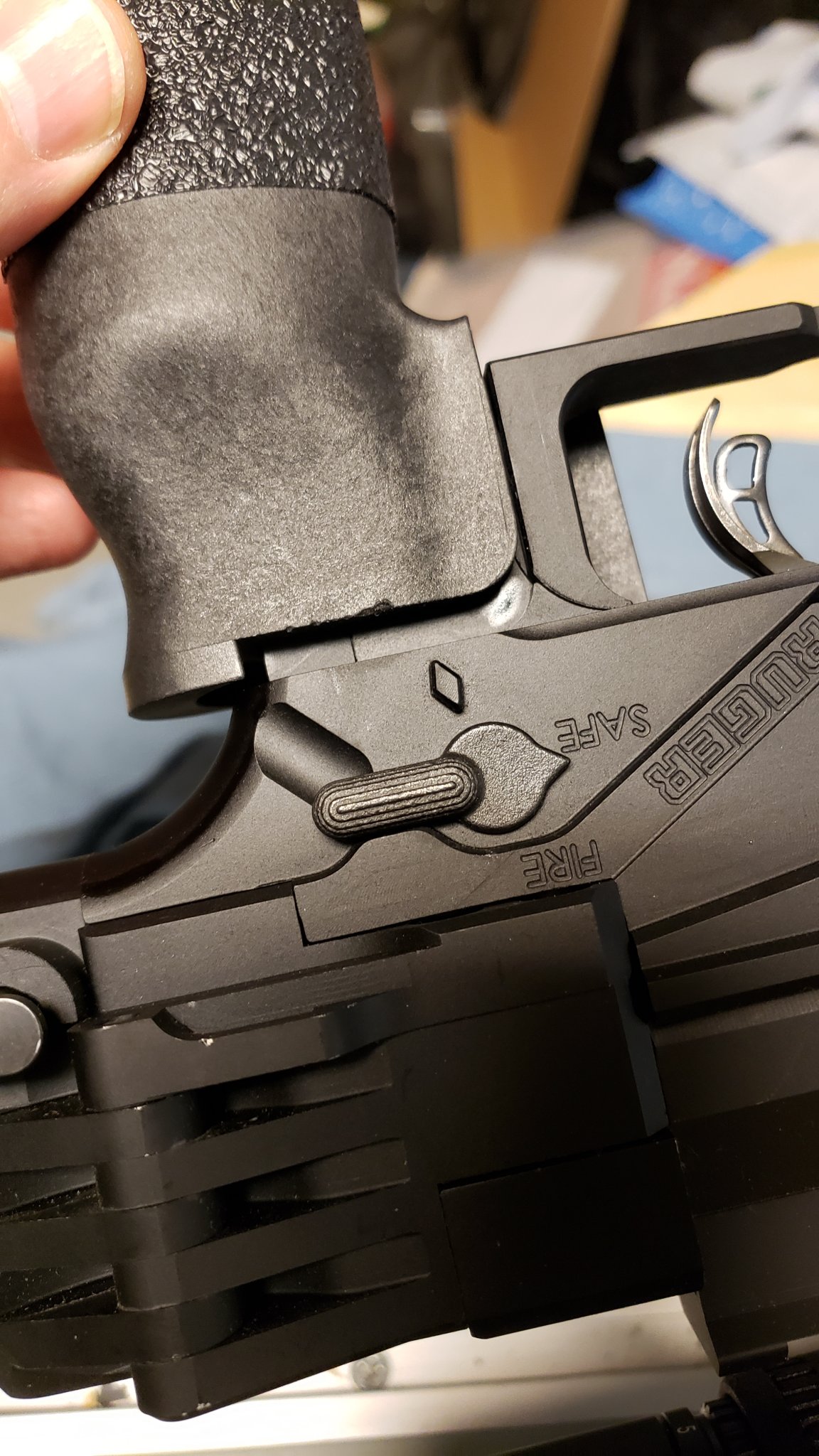

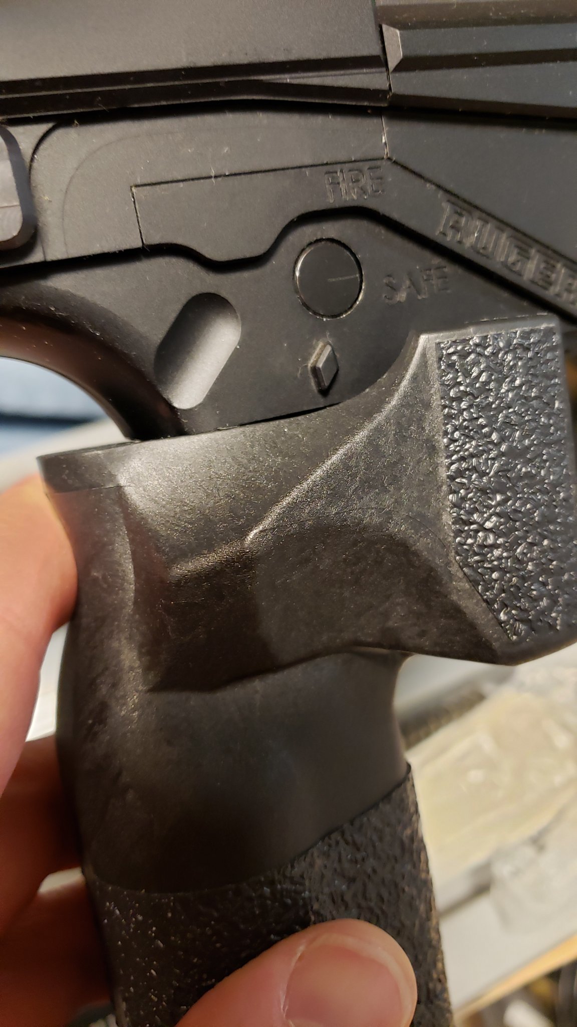

Ok, here we go:
View attachment 7518455 View attachment 7518456
View attachment 7518458 View attachment 7518459

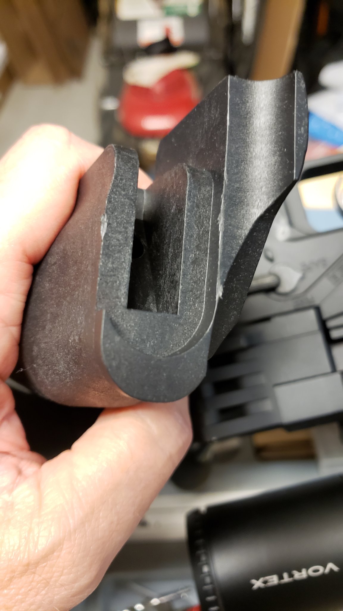

You can see it never reaches or touches the safety stop on either side. There's a ridge along the right, inside top edge of the grip, and it's stopping on the frame of the rifle. I considered trying to flex the grip, but the material isn't very flexy.
I may have to grind that ridge down with something to give some relief to slide up into place.
When I bought mine I bought two of them (one for my RPR and the other for my RPRF) and had no such problem with either of them. So . . . something changed in their manufacturing to where the dimensions are no longer that same as when I got mine. Bummer!

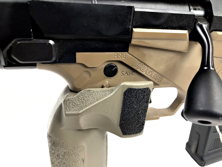

Hmmm??? Apparently, MPA EVG grips have some variations in their designs. I just saw this and in this pick the grip is not exactly the same (maybe this was a custom mod on the grip???):
View attachment 7518375 View attachment 7518376

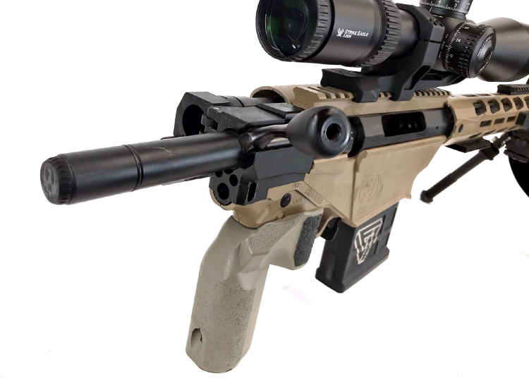

Where did the pics come from? Curious if is a new model or someone did nice job customizing. This one only has grip tape in one spot, the rest is either molded or hand stippled and then you have the color, MPA only lists black.
The pics came from here:
Thanks. From some of the other pics can see black showing through in a few places so was painted or coated. My guess is he just did a very nice job customizing it and omitted that from the article.

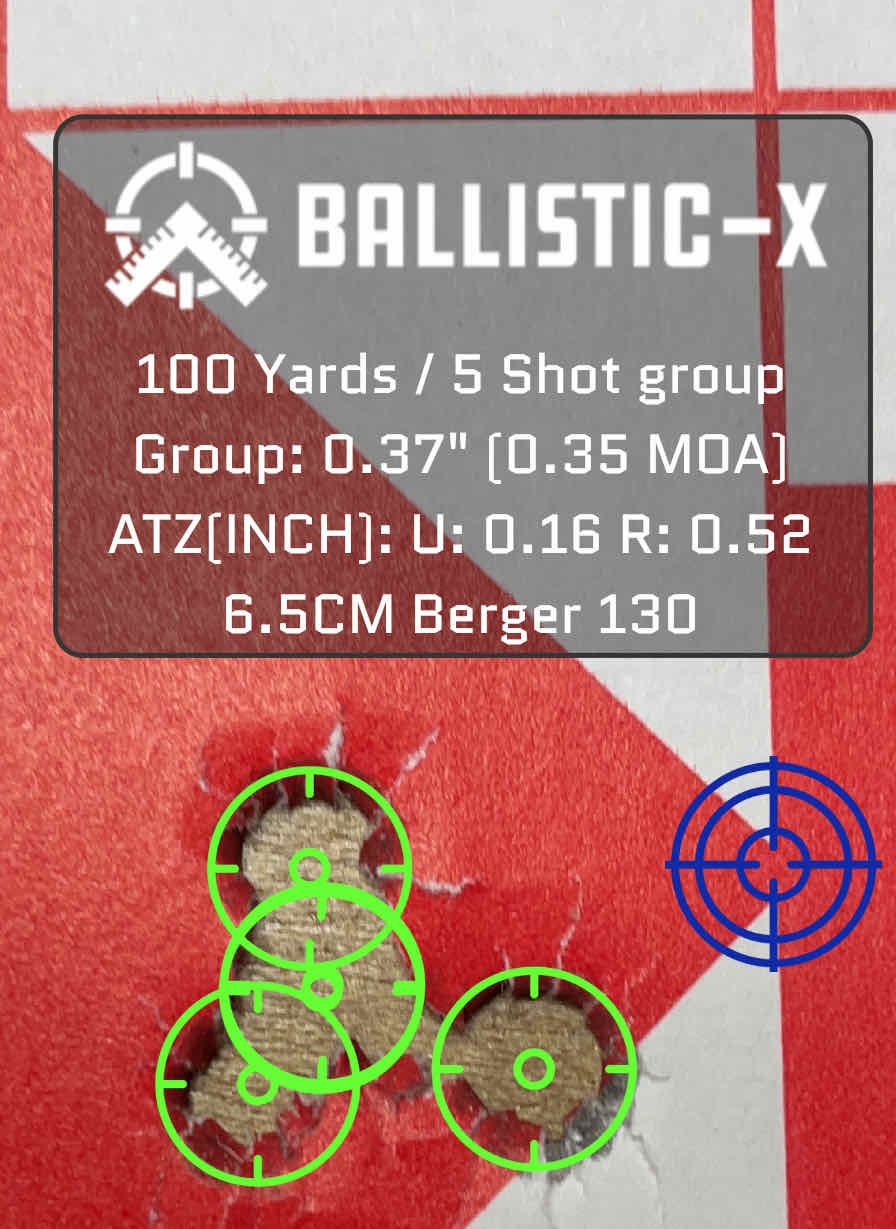

Over 4500 rounds now through this Krieger barrel and still getting a lot of bugholes. I've already got a new Krieger bull barrel sitting in the wait for when I start losing accuracy.

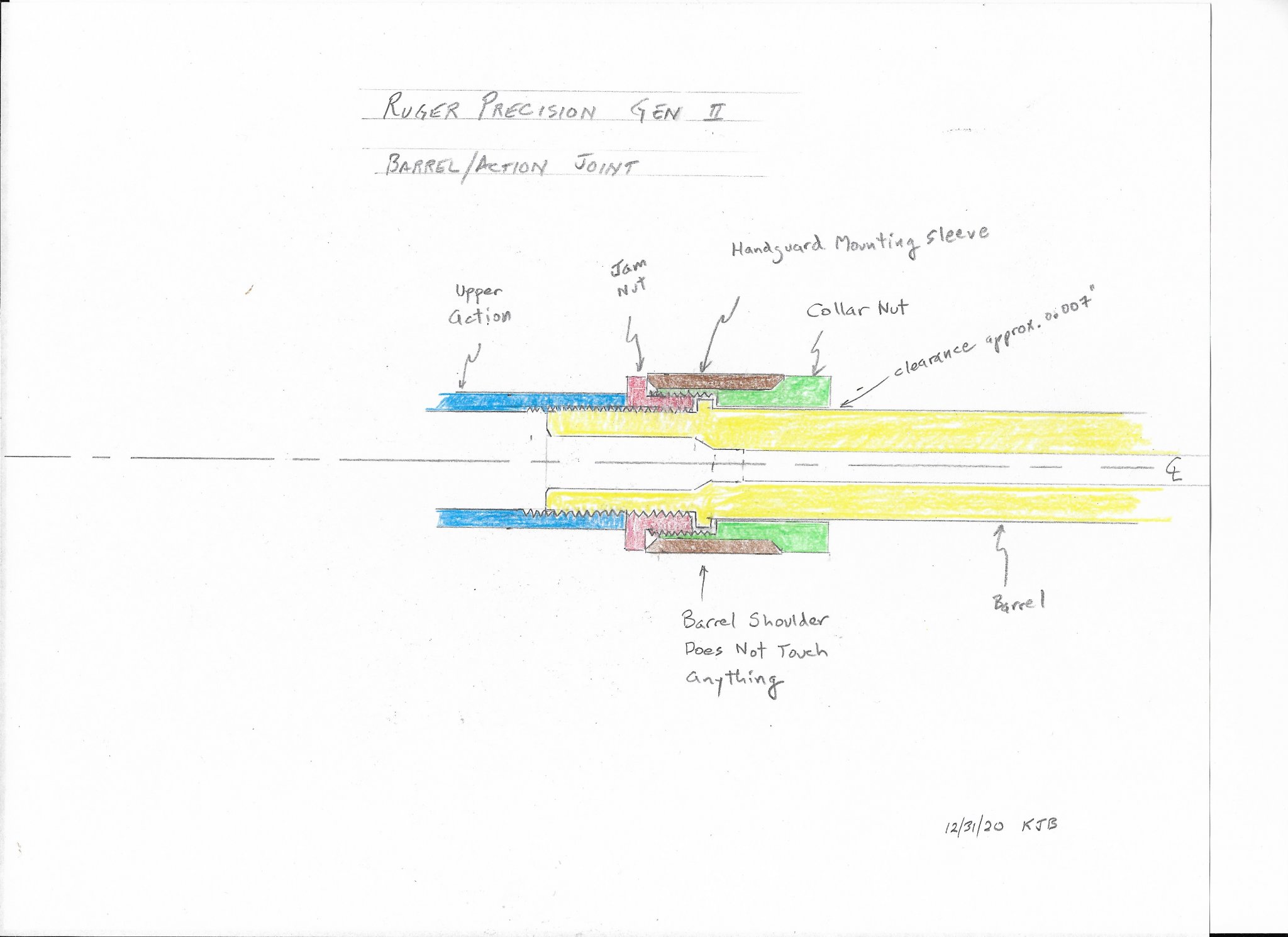

Does anybody have any experience with their 6.5 CM Gen II RPR coming out of the factory with significant offset in the barrel to the action? I've seen some online discussions about guys sending theirs back to Ruger because they could not zero their scope, usually windage however to the left. A couple years ago I ran into having to put a 30moa rail on it to reach 1260 yards with a 65moa NF elevation scope. Basically, the barrel was pointing low relative to the action and eating up some of the available adjustment. I lived with that for 2 years and recently decided to replace the barrel since its accuracy and speed was dropping and with a borescope it looked heavily alligatored out to about 10". I don't chase lands I just load to mag length. I got a low round count original rpr takeoff in 6.5CM as a replacement. While it shoots 0.3" or so, similar to my original barrel, it too is pointing low. My first attempt it was about 21 moa low. I removed it and tried to tighten the jam nut in a direction that my wrench forces might tend to lift the slop in the barrel/action threads and got it so it is 14 moa low now. I even tried temporarily installing the barrel 180 degrees from proper headspace (not shooting it just sighting through the scope and bore) and don't see it shift the opposite way so I'm thinking the action face is not perpendicular to the barrel threads. I have trued AR15 upper barrel shoulder faces using a lapping tool but I don't see a good way of doing that to the RPR face with the lugs in the way. It'd have to be a 2 piece custom tool. I figure if all was straight, with a 30 moa rail I should be near the bottom of a 65moa NF scope adjustment when it is mounted and zeroed at 100 yd. But I am in the 14 - 21 moa range when zeroed, which eats up some of my available elevation range of adjustment. It seems like there is so much slop in the action/barrel threads, and jam nut/barrel threads that the barrel seeks different positions each time it is tightened in place. I am certainly not a gunsmith. Anybody got suggestions?
I'm no gunsmith, so this is just me thinking it thru.
As I understand it, the RPR is a variable headspace design. The headspace is set with go/no go gauges by threading the barrel into the receiver. That headspace is then set by tightening the barrel nut, which locks the barrel to the receiver thru the nut.
So, given this system, I don't see how you could alter the receiver to barrel alignment by any sort of lapping like on an AR. I guess it's possible the nut is shifting the alignment, but it sounds like the receiver threads are cut wrong? :unsure: Maybe a different nut?
I know this doesn't give you a solution. Maybe call Ruger & see if they're willing to help?
What you say is mostly true, except the barrel jam nut does not lock the barrel shoulder to the threads of the reciever through the nut. Instead, the barrel jam nut bears against the flat surface of the reciever face and jams the barrel from turning. Nothing whatsoever touches the shoulder of the RPR barrel when it is installed. You could grind it off with no effect good or bad. See my attached drawing. The barrel shoulder has daylight on all 3 sides of it when assembled. It comes out of the gun with no marks on the shoulder. If the flat face of the reciever is out of square with the axis of the reciever threads, grinding the face would improve barrel installation alignment. There is a ton of slop in the threads. There is less than one diameter of thread engagement between the barrel and action. That lets the barrel wiggle quite a bit in the reciever till the jam nut is tightened after proper headspace is selected. Thanks for the reply and thinking about this issue.

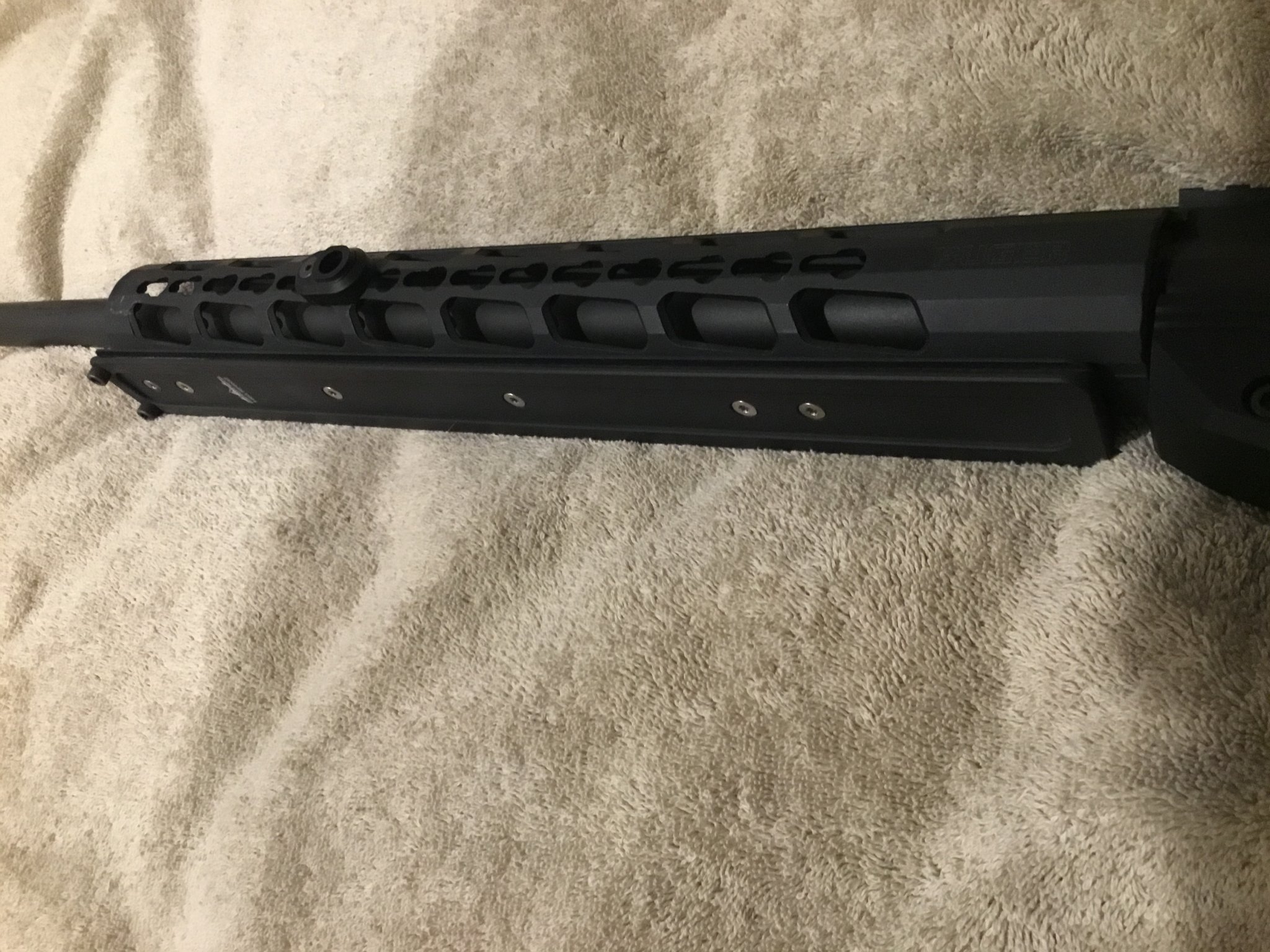

On another note, has anyone installed an ARCA rail on the Gen2 RPR (keymod)? If so, any particular brands favored, or fit finish issues? I'm looking at the Area419 for Keymod, and one on Anarchy Outdoors from Sawtooth.
I have a Sawthooth on my Gen 2 handguard, works great. I wanted a full length rail so I could run my wedge bag as close to the mag well as possible. The only issue is if you want to take your handguard off you need to take the rail off first as it covers the bottom screws.

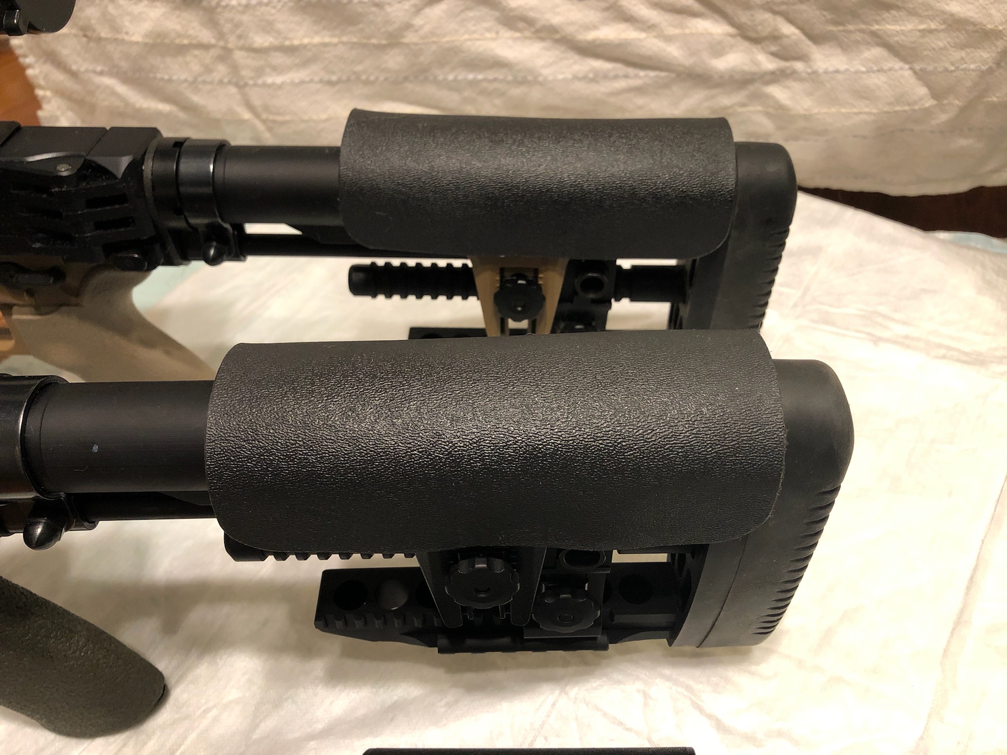

I extended the cheek piece with some Kydex. The 2nd one worked out better, eventually I will make a good mold and recast the first but it is very usable as is. Extending the length 1 1/4" ish sure changed the feel. We got a little curl on the first one, there was a learning curve for working with the Kydex and heating it with a heat gun.
I wanted to try this before investing in another or 2 Magpul PRS Gen3 stocks. It was a success.
The extension is held on with 2-sided tape.
This worked out extremely well. I went and shot the rifle the other day. The increased length is much better.
I would recommend thinking about doing this.
