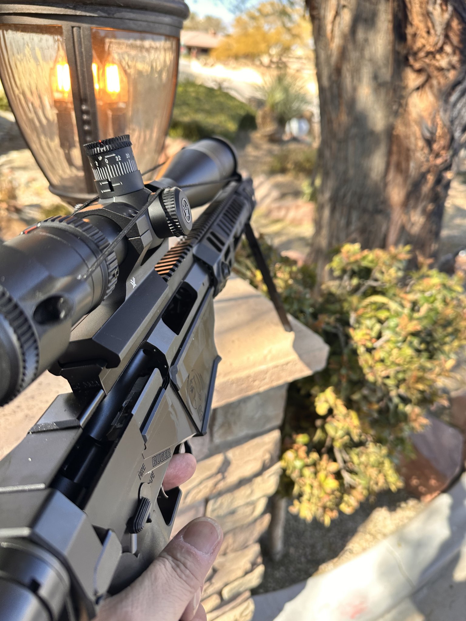

New to the precision rifle scene, just bought this rpr 6.5 creedmoor, with Vortex Venom 5-25x56 scope. Still need to buy a scope mount and bipod. What scope mounts would be recommended?
Burris XTR Signature Rings. I use them on both my RPR's and they've been working really well for me.

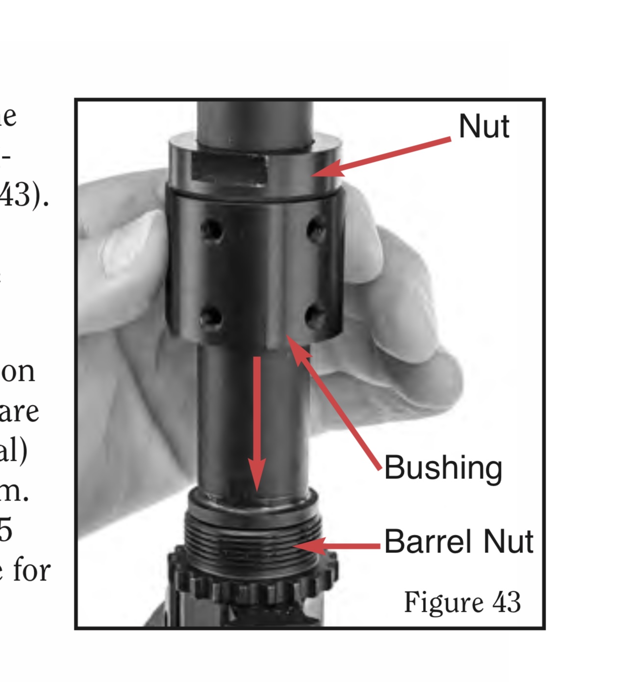

Off the wall question for the group: has anyone adapted a Gen 2 handguard to a standard AR upper receiver?
Looks like you’d just need to remove a little material from the barrel bushing and maybe the tensioner nut to allow the gas tube to pass through. Thinking the “scallops” in the barrel nut itself would allow enough clearance.
Yes, I’m aware it’s not worth the hassle, just buy a cheap handguard, etc etc. Have a friend that just wants to use the RPR rail on a build.

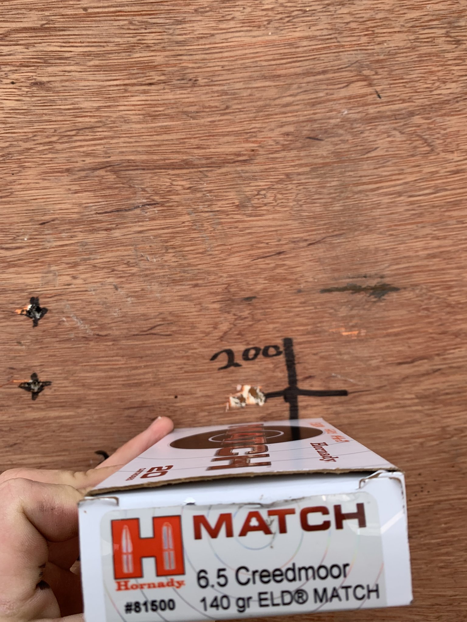

The 5.56 is on my Do Not Sell list. It will print a 1/2 MOA group at will, provided I do my part. There's never any guarantee of that!! 😂
This is one of it's better groups, but not too far off from average. I have a VX-3i 8.5-25 on it and have been tempted to put better glass on it, but I'm almost afraid to mess with it. It's bone stock.
Another. Different day, different ammo.

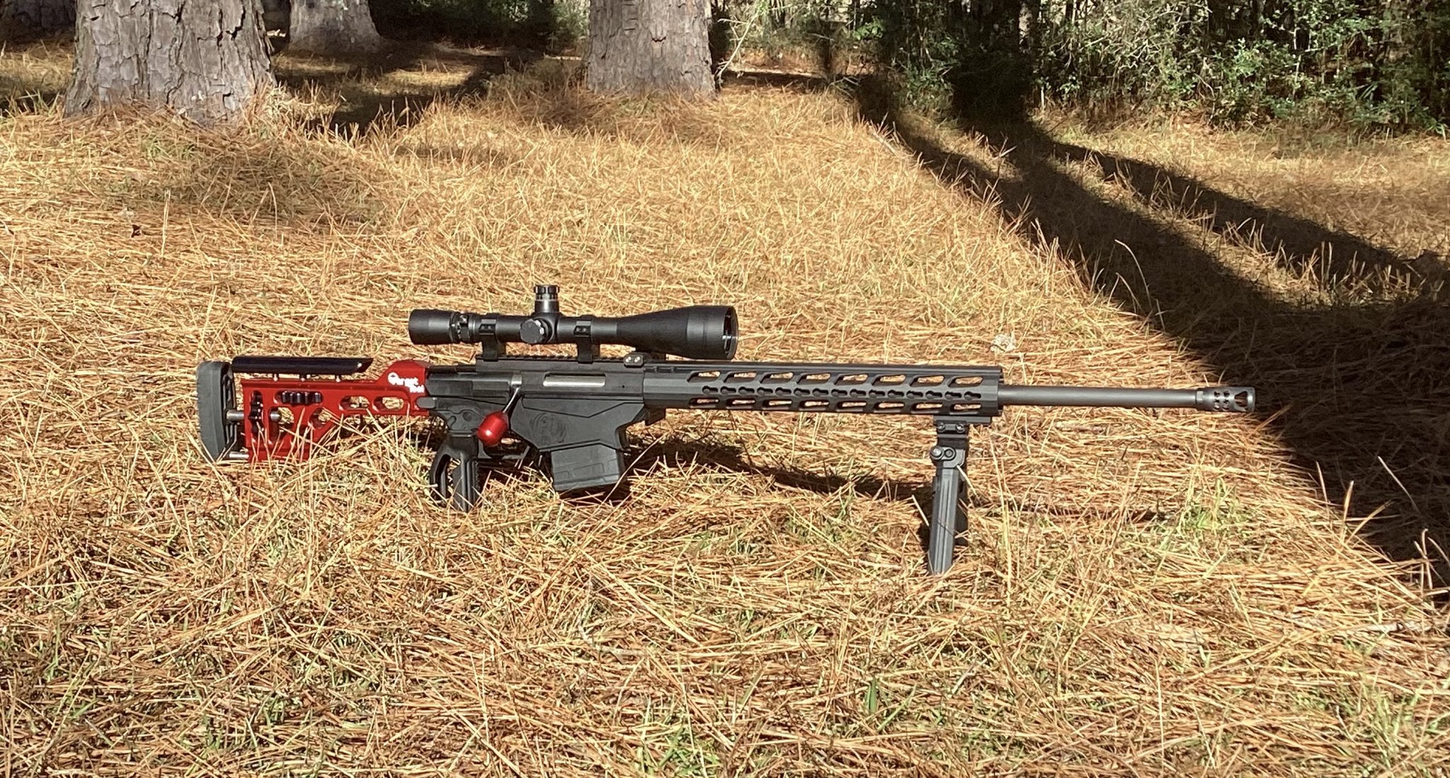

Waiting on the forend to come back from the gunsmith. Being Cerekoted to match the buttstock

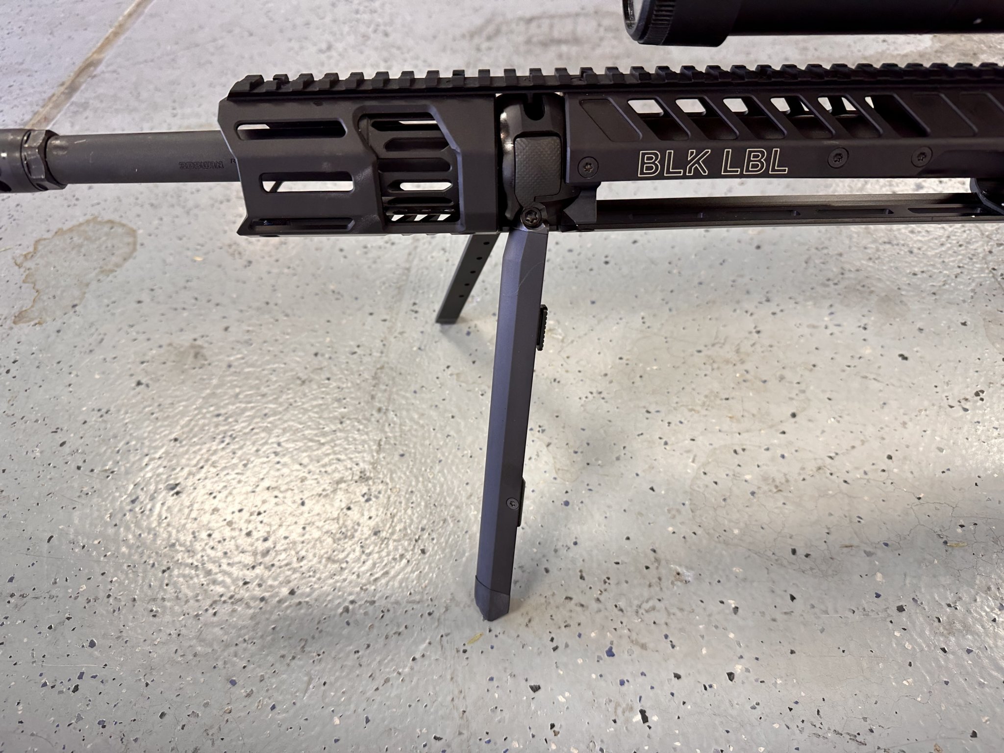

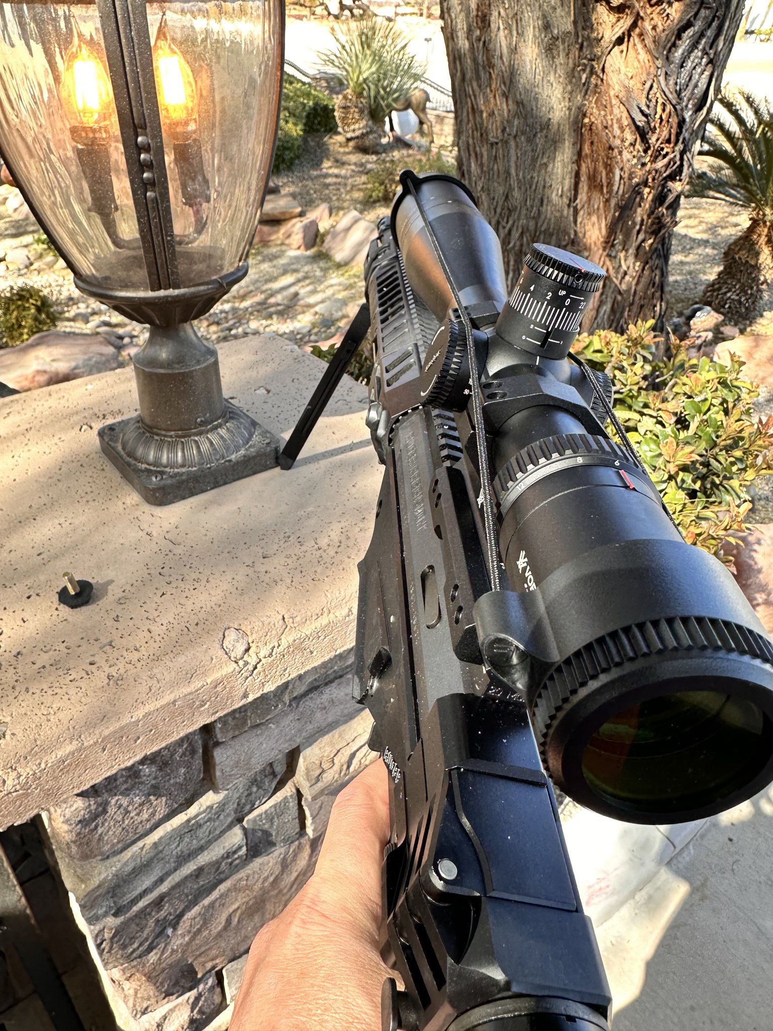

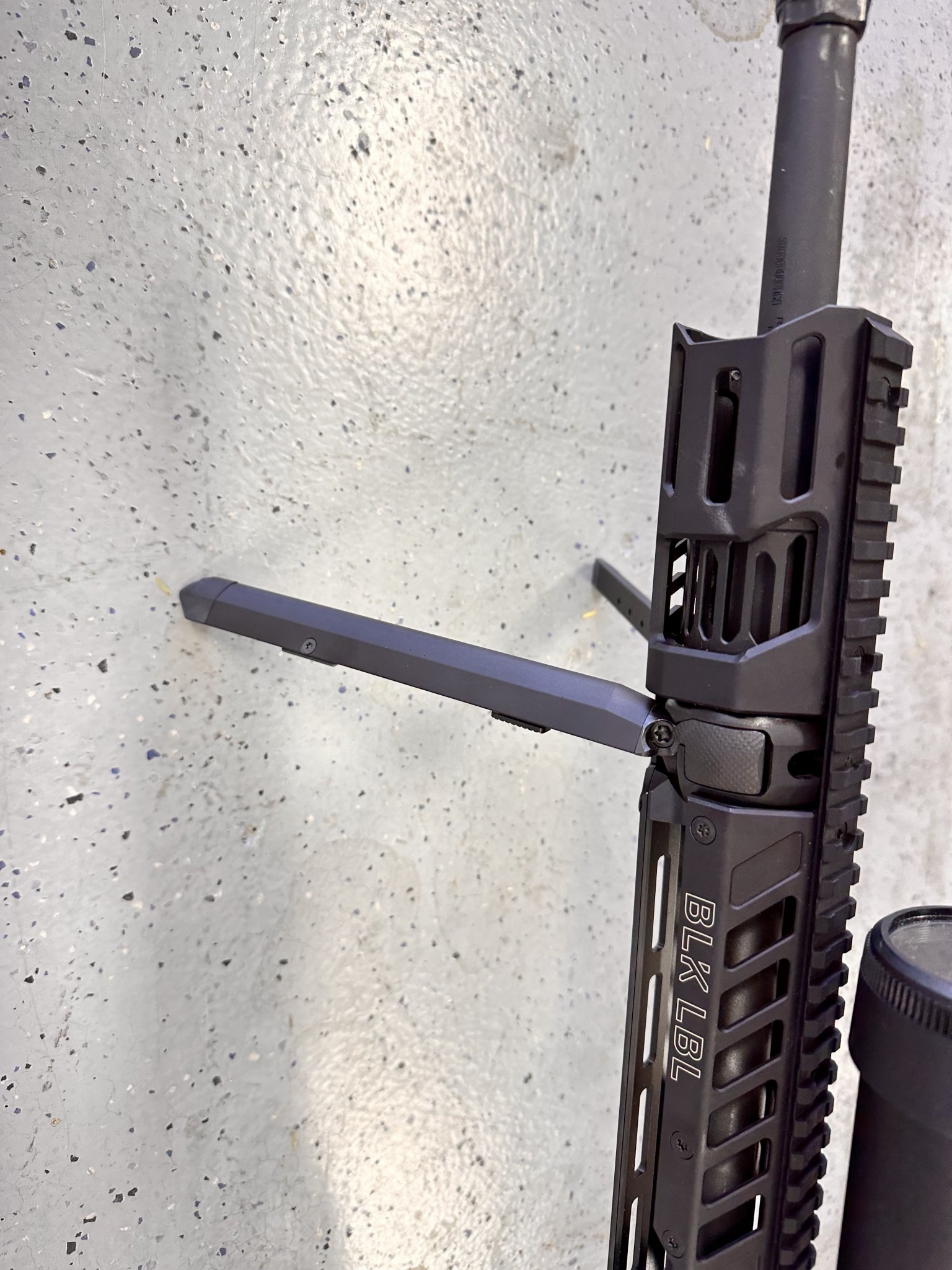

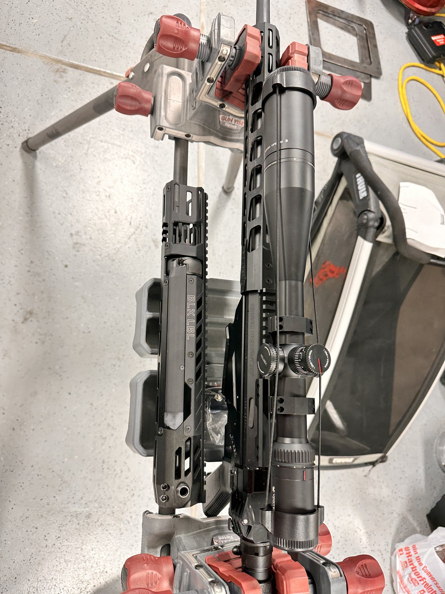

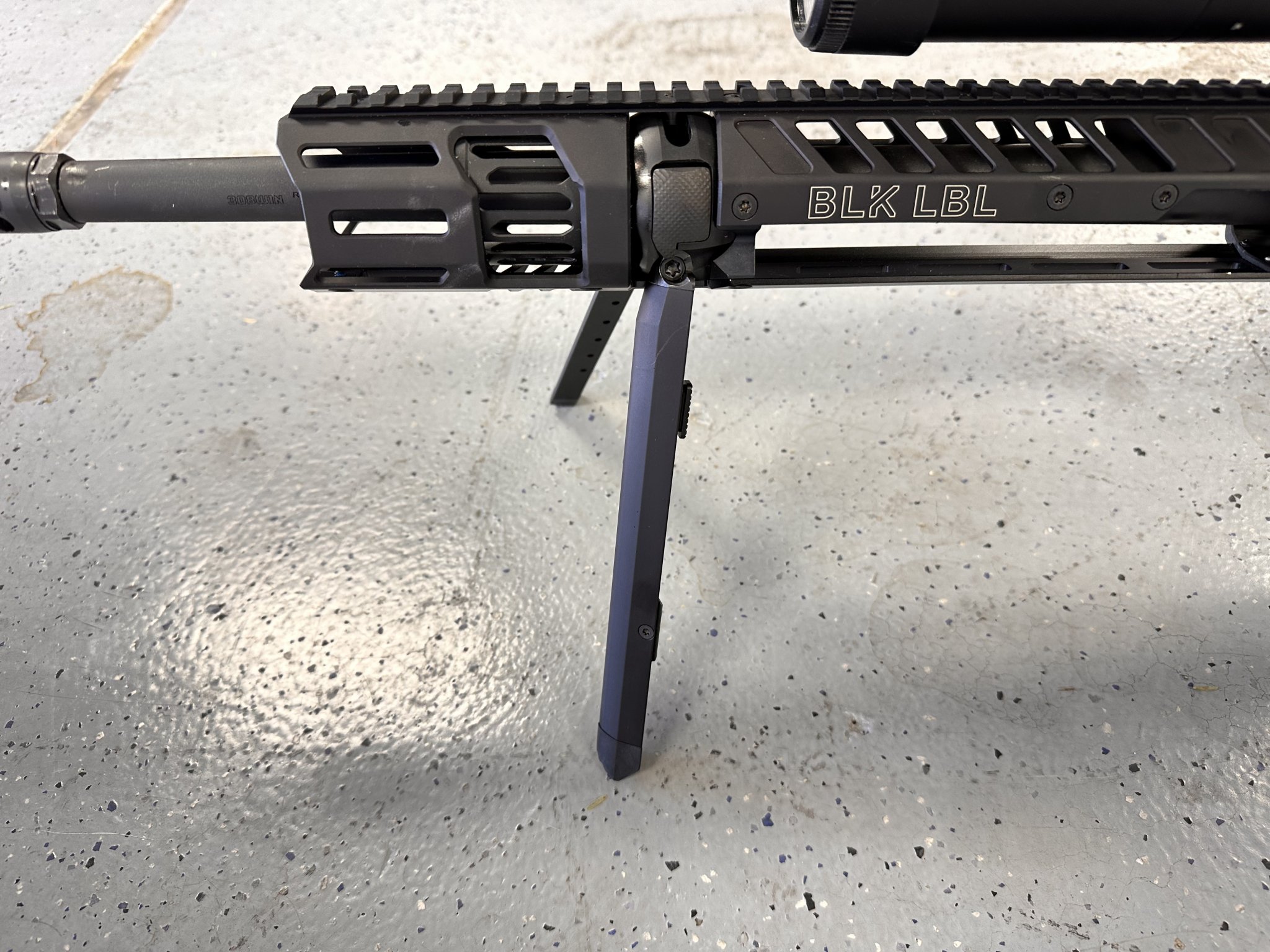

I bought one of these and have not installed it yet..
BLK LBL Bipod​
I looked at that online and thought it looked really cool, innovative. I was wondering it it still leaved the barrel free floated, and just curious how it worked.
Very cool
