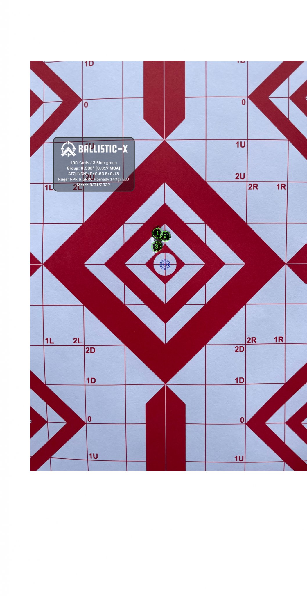

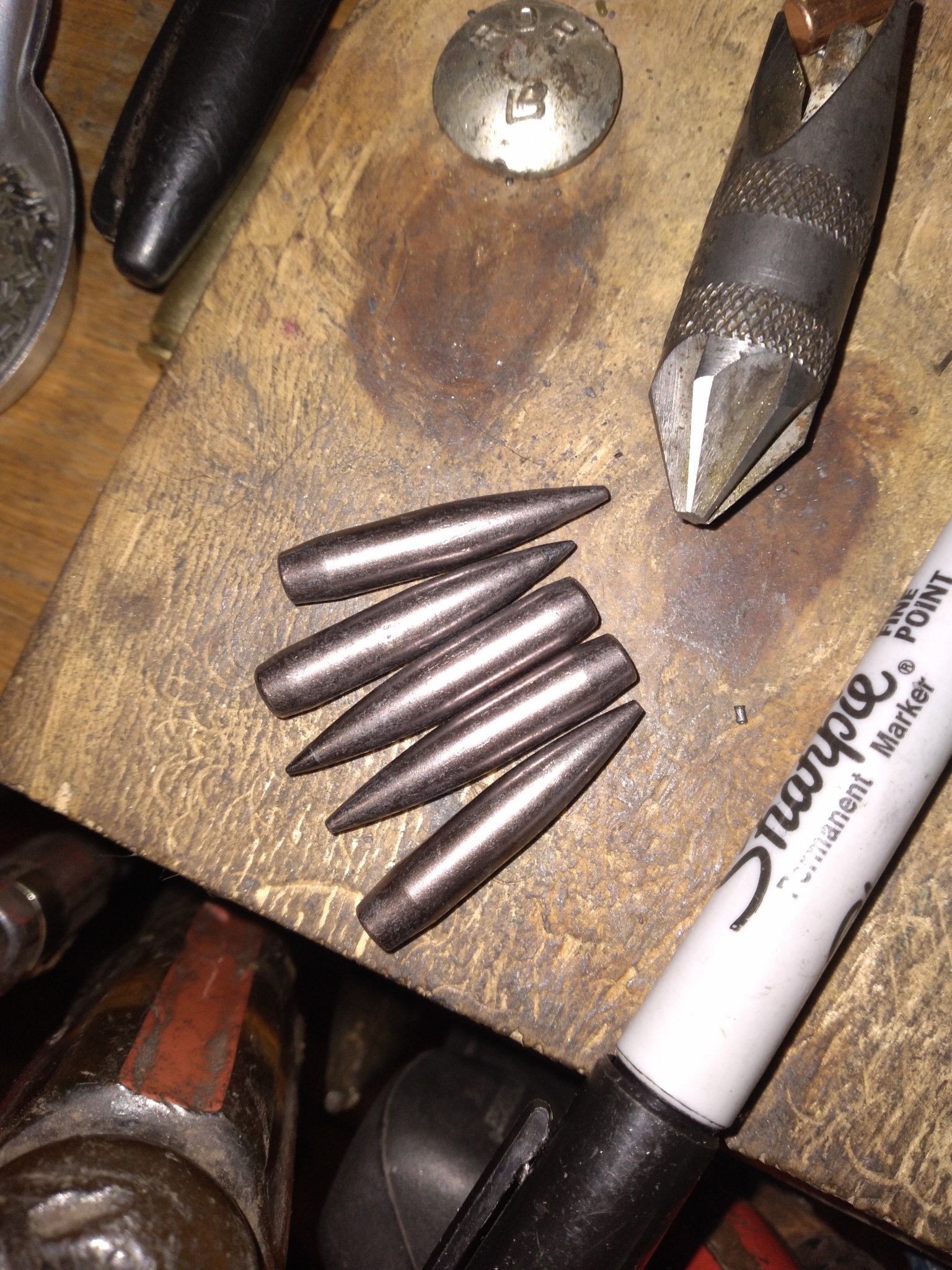

My Ruger shoots as good as any brand rifle and I have to say boron nitride bullets work without a doubt faster speeds less flyers tighter groups !

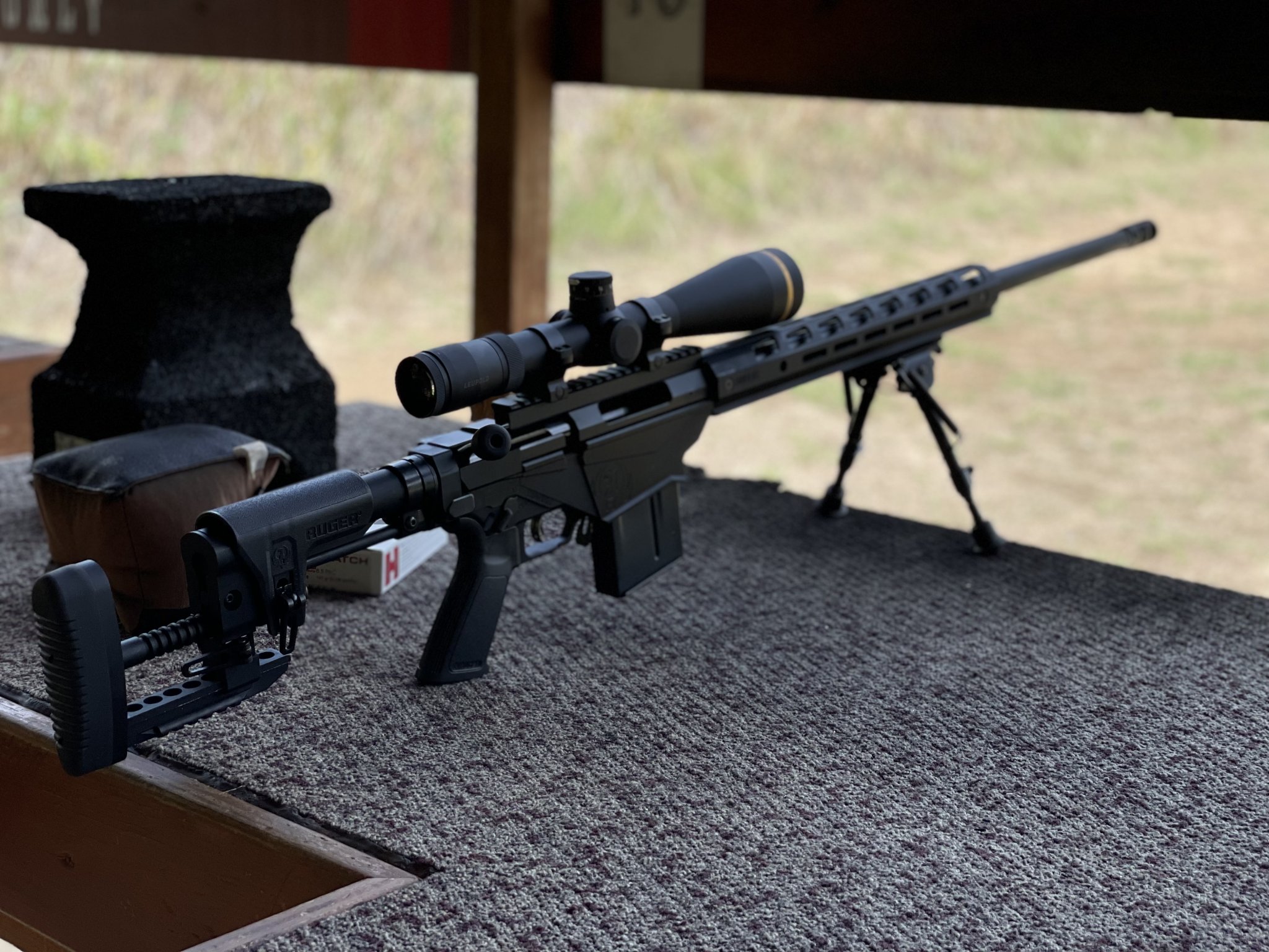

I shot my first 600 yard bench-rest match today. I’m happy to report that I managed to get the highest score, and “closest to bullseye”. At 603 yards, my RPR maintained a 5.481” grouping on two targets. I was using factory Hornady “match” 108 ELD. These guns can shoot, when we do our part.
Excellent shooting !!!!!!!

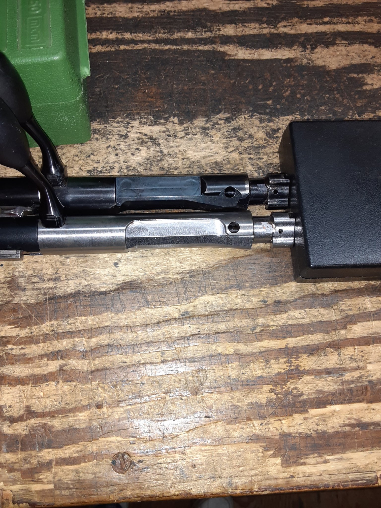

I have been looking at the RPR in both 6.5 PRC and .300 PRC and had a thought. Could I buy a .300 PRC swap in a 6.5 PRC barrel so I could run both cartridges out of the same rifle?
Both cartridges use the same .532 rim. My big question is will the 6.5 PRC feed from the long action mags?

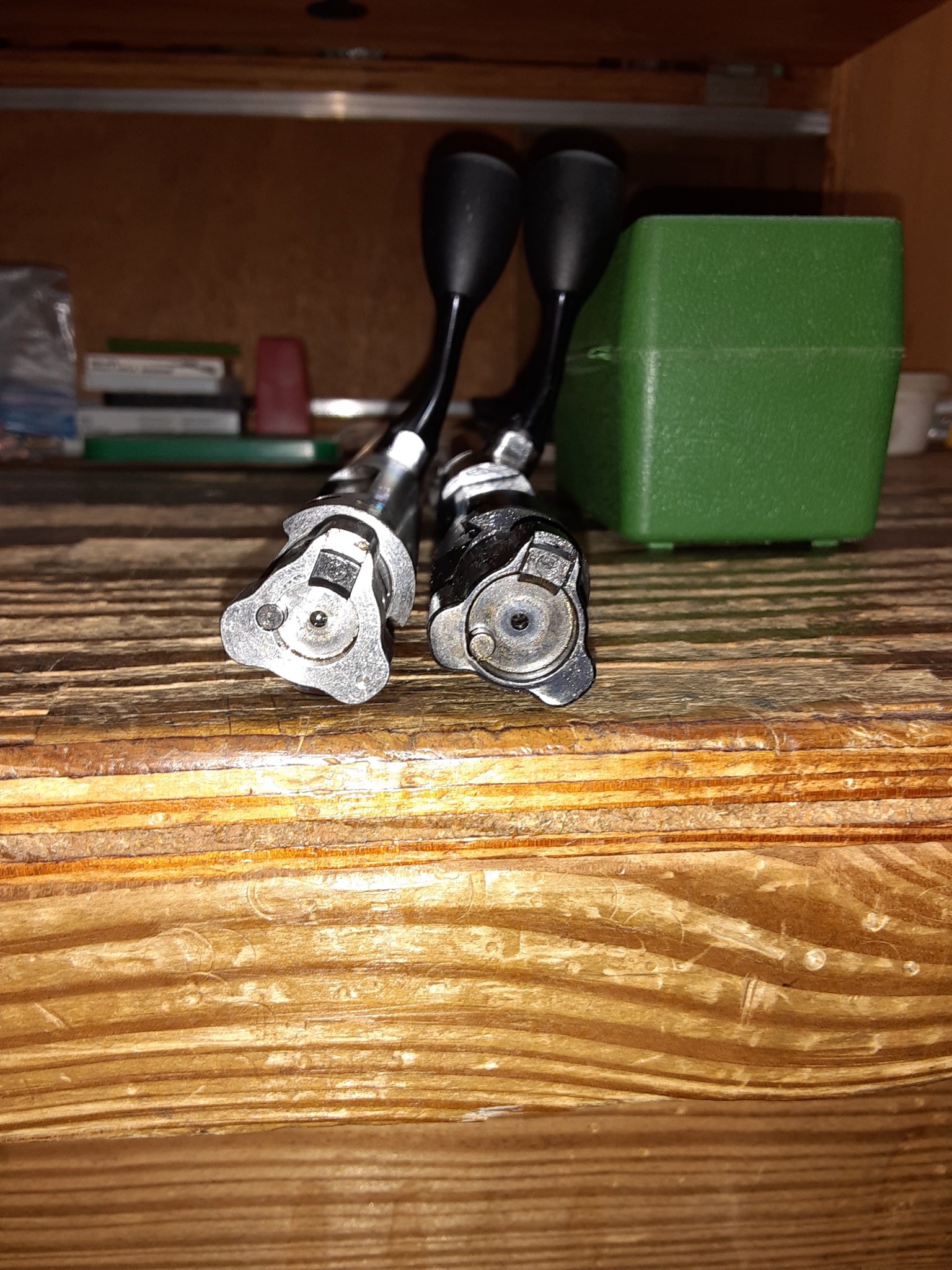

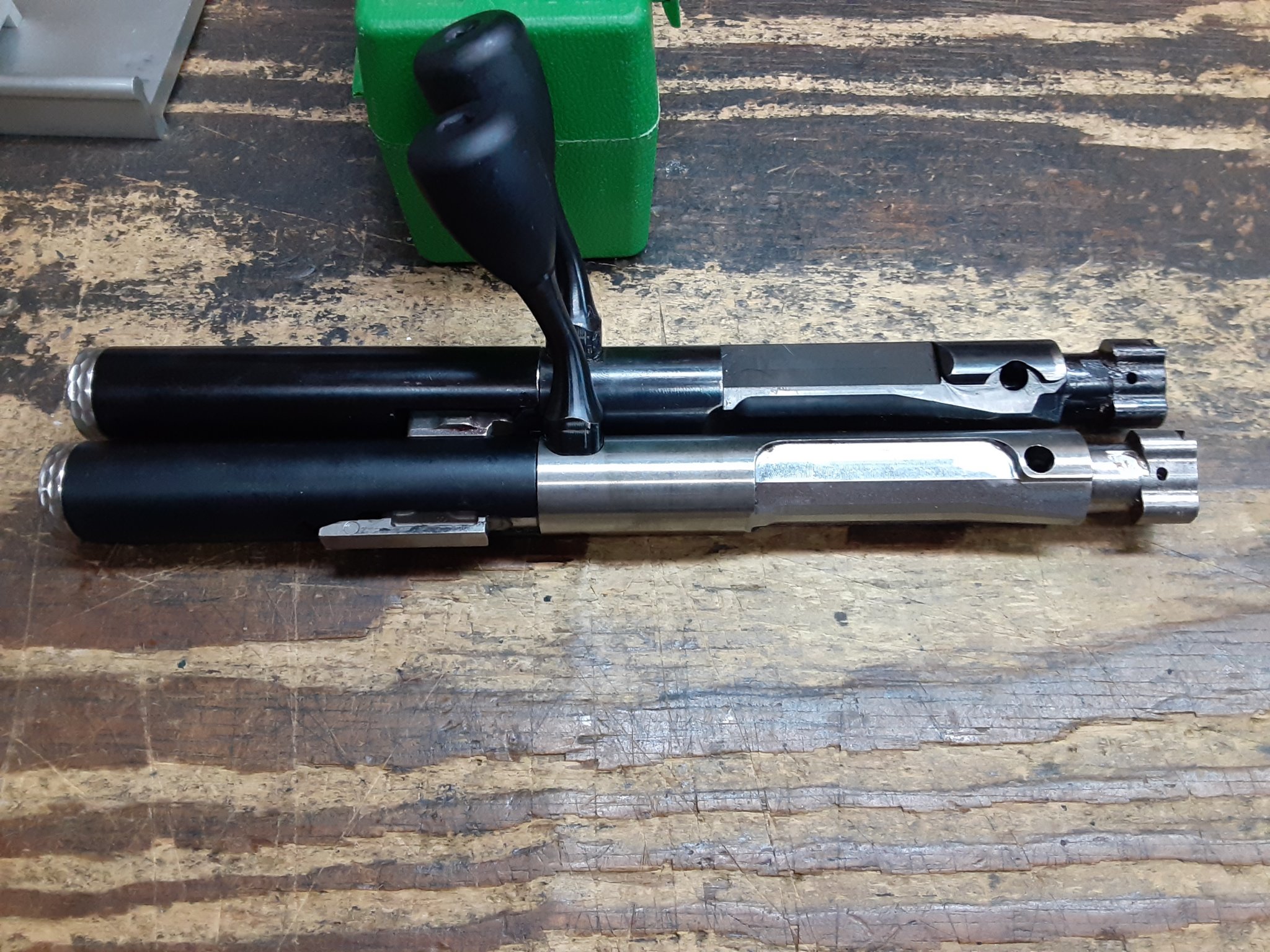

Other than the bolt face, what are the dimensional differences between a 308 bolt and a 223 bolt? Length? Bolt body? Lugs?
They are the same length but different in the cutouts on the bolt body and have different cocking pieces. The 223 bolt will go into the 6.5 Creedmoor receiver but not vice versa. However, I did not measure anything. 6.5 is Gen 3 and 223 is Gen 2? maybe since it has a muzzle brake?

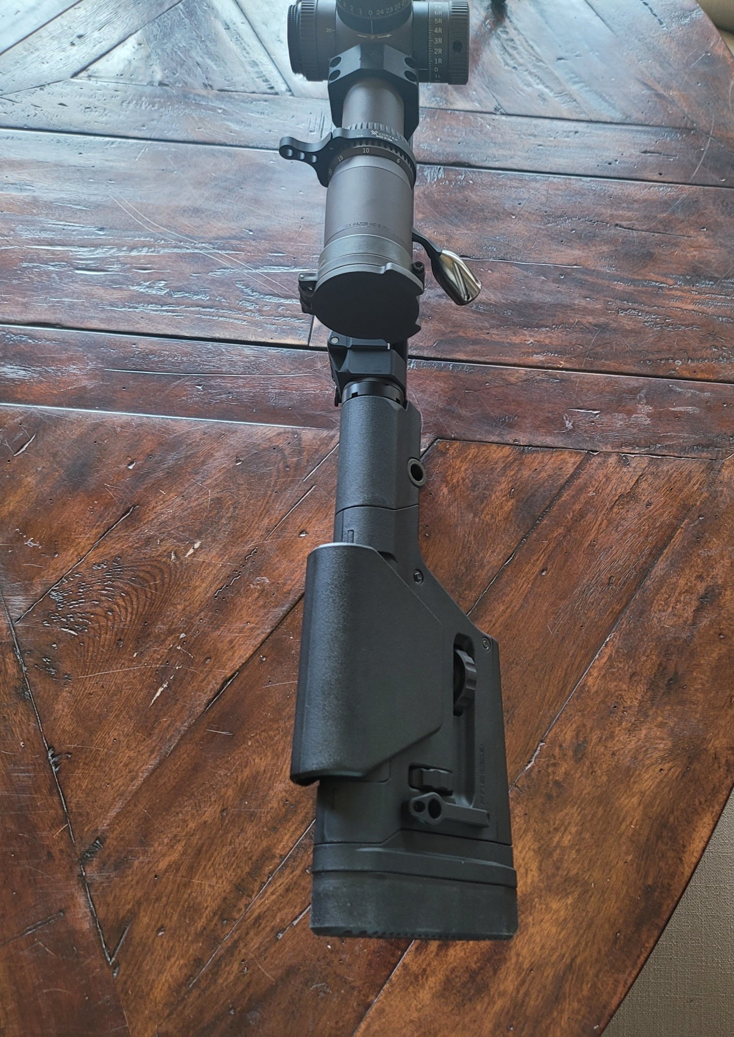

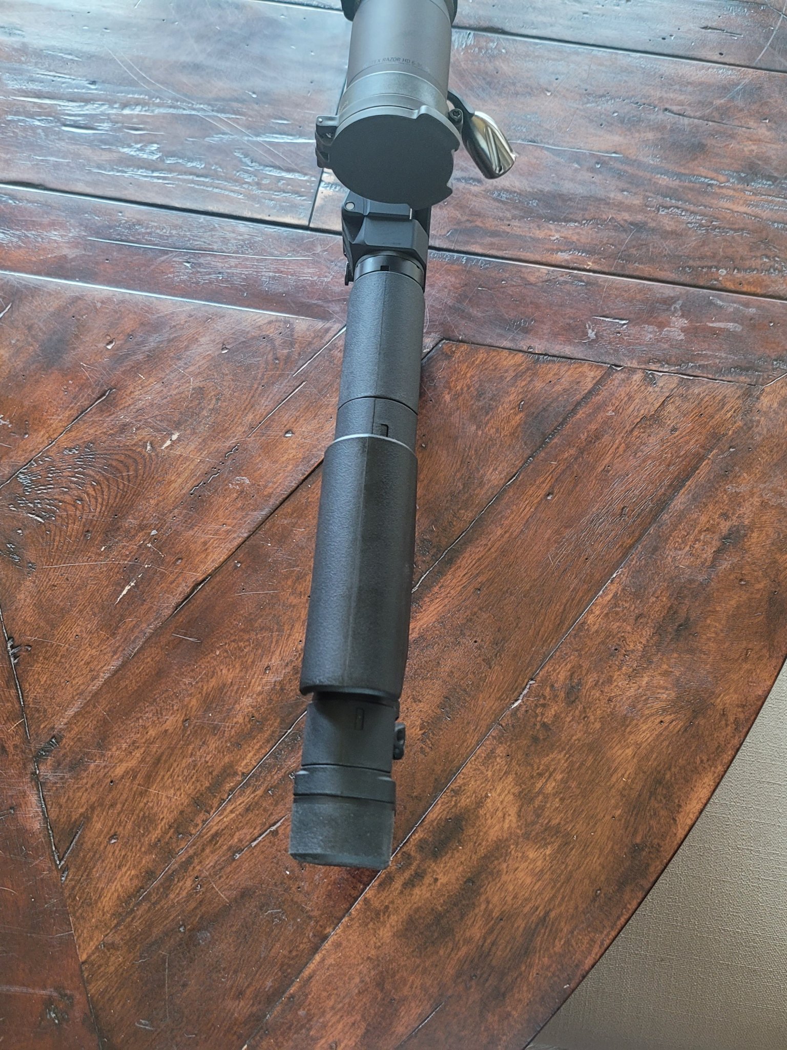

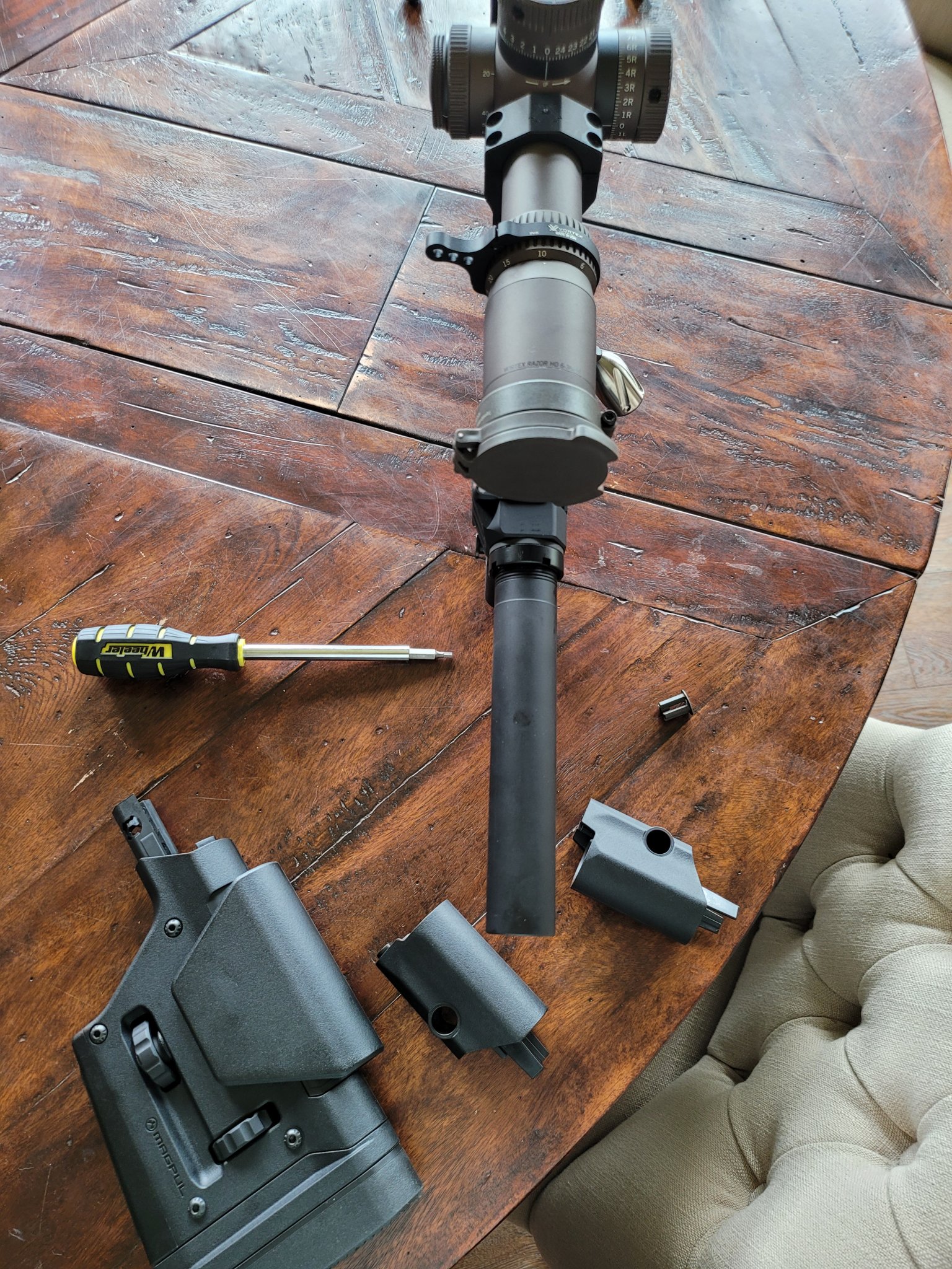

Hey guys quick question. Just replaced factory Ruger stock with Magpul PRS gen3 stock. Any idea why the stock is able to easily twist like shown in the picture.
are you using a rifle length buffer tube or a carbine tube? Do you have the correct adapter? Is rear screw tight (if using rifle tube)? Is that forward bolt tight on the adapter?
The adapter for the rifle tube has a little nub on the front that slides into the picket of the folding mechanism to prevent twisting. Make sure your adapter plate isnt the kind that blocks that
Reactions: DubfromGA
I am using the carbine length buffer tube that is stock to the RPR. I am not sure about the adapter. The Magpul instructions say to swap the adapter if using a rifle length buffer tube. So since I am not, I took as I don't need to swap to the included adapter. Is there a way to tell which is which? The bolts that hold the stock to the carbine buffer are torqued to spec. The stock cannot be pulled backward. But it does easily twist as shown above. Makes me think you are correct, and it's the wrong adapter.
Ok I disassembled it. The carbine adapter has no nub, but the rifle buffer adapter does have a nub on the end. However I have the carbine buffer and so cannot use the rifle adapter. The nut holding the buffer tube (which require the special AR wrench) seems a little loose. But I don't have the special wrench. Guess I'll have to buy one. Needed to get one anyway for reasons like this.

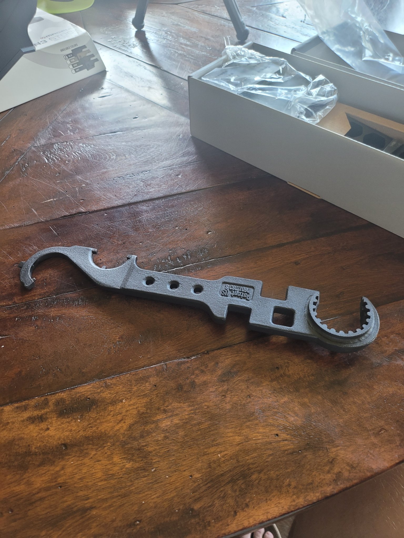

Do you have an AR armorers wrench?
No. I will go and buy one, should solve the issue
Pro Tip: When working with the castle nut buy/use a wrench that engages more than just 1 of the slots. Lots of all-in-one AR armorers' wrenches only engage a single slot and it's real easy to slip and bugger up a single slot. There are wrenches just for doing castle nuts on ARs that engage multiple slots and they're much less likely to cause you problems.
Yes, issue improved with tightening the castle nut. Not sure why the carbine adapter doesnt have a nub to fit into that slot on the rifle similar to the the rifle length buffer tube adapter. If I really crank on the stock and castle nut I can loosen it and induce twist again. But with the wrench I can get it pretty tight.
Because most AR's with carbine stocks use an end plate that engages and blocks that hole to help prevent the carbine tube being able to rotate..(meanwhile the anti-rotation feature for stocks is provided by the lower protrusion of the carbine buffer tube). Having the nub would cause the PRS to stand proud instead of flush on most end plates
