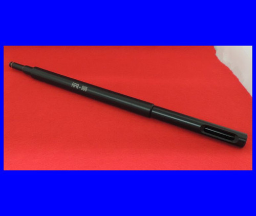

What bore guide would y’all recommend? The one I’ve used for my .264 Win mag and 26 Nosler is too lose in the chamber of my 6.5PRC RPR.
PMA has been great for me. Below is the one made for the RPR 6.5PRC:

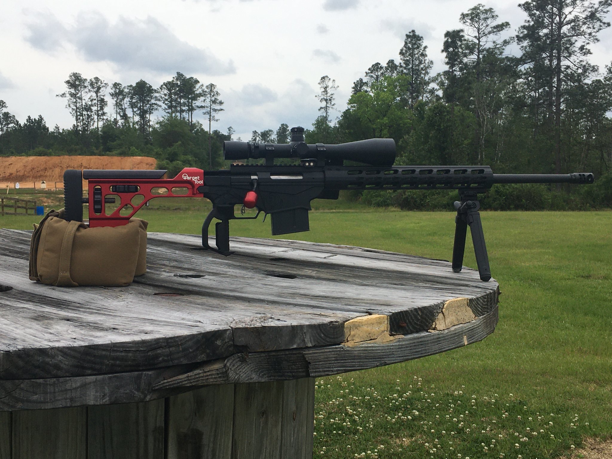

Are there any other buttstock options besides the PRS?
One of the best is (was) Target Tool. Not inexpensive, but a really nice rear stock. Not sure if they are still in production. My thoughts, Pine Tree Casting ought to purchase a license and put them on all the custom shop RPR’s.

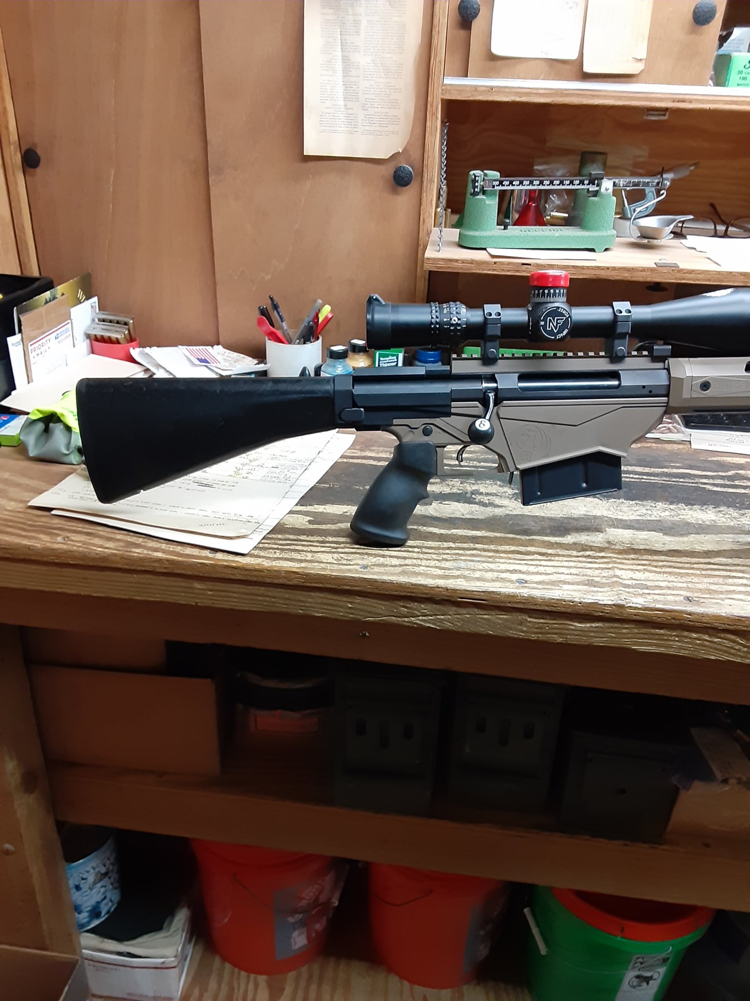

M16A1E stock w/rifle buffer tube for std calibers are plug and play and "if" you can find one of the scarce USGI smooth plastic or rubber coated trapdoor style buttplates. Magnum calibers (.300 WM shown below) require cutting a notch in the threads for cocking piece clearance.

Not too bad. The buffer tube component was the one thing that didn't cross my mind.

Target Tool has stocks on their website. Been out for some time. If you are not happy with the stock, RPR rear stock, and don’t mind spending a bit of cash for a really nice addition to your rifles(s) need to check these out
As said, NDIH but I sure like mine.
How does the rifle balance with the Target tool stock? The stock looks very heavy does it change the rifles balance a ton?
Balance has been an issue but no worse than with the factory stock. If the RPR has an issue is that it really needs a couple more inches of barrel (and a bit more barrel metal would be nice as well.). That said, the hammer forged barrel has been a real surprise as far as accuracy.
