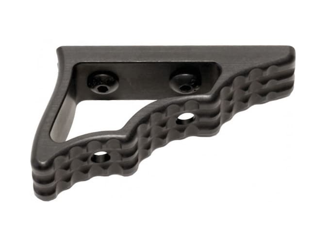

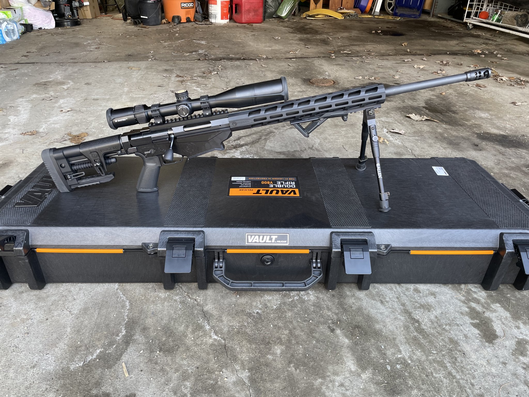

It looks like I scored a gen3 but does anyone know what the item is behind the bipod? I have no clue what it is.
This is a handhold, typically used in AR style rifles. It might have been used for a barricade stop, but not a good one and too far forward. Frankly, as heavy as an RPR is, a forward hand hold would really only be useful to a very big, very, very strong fellow. Not the same brand but basically the same idea.
Forward Grip

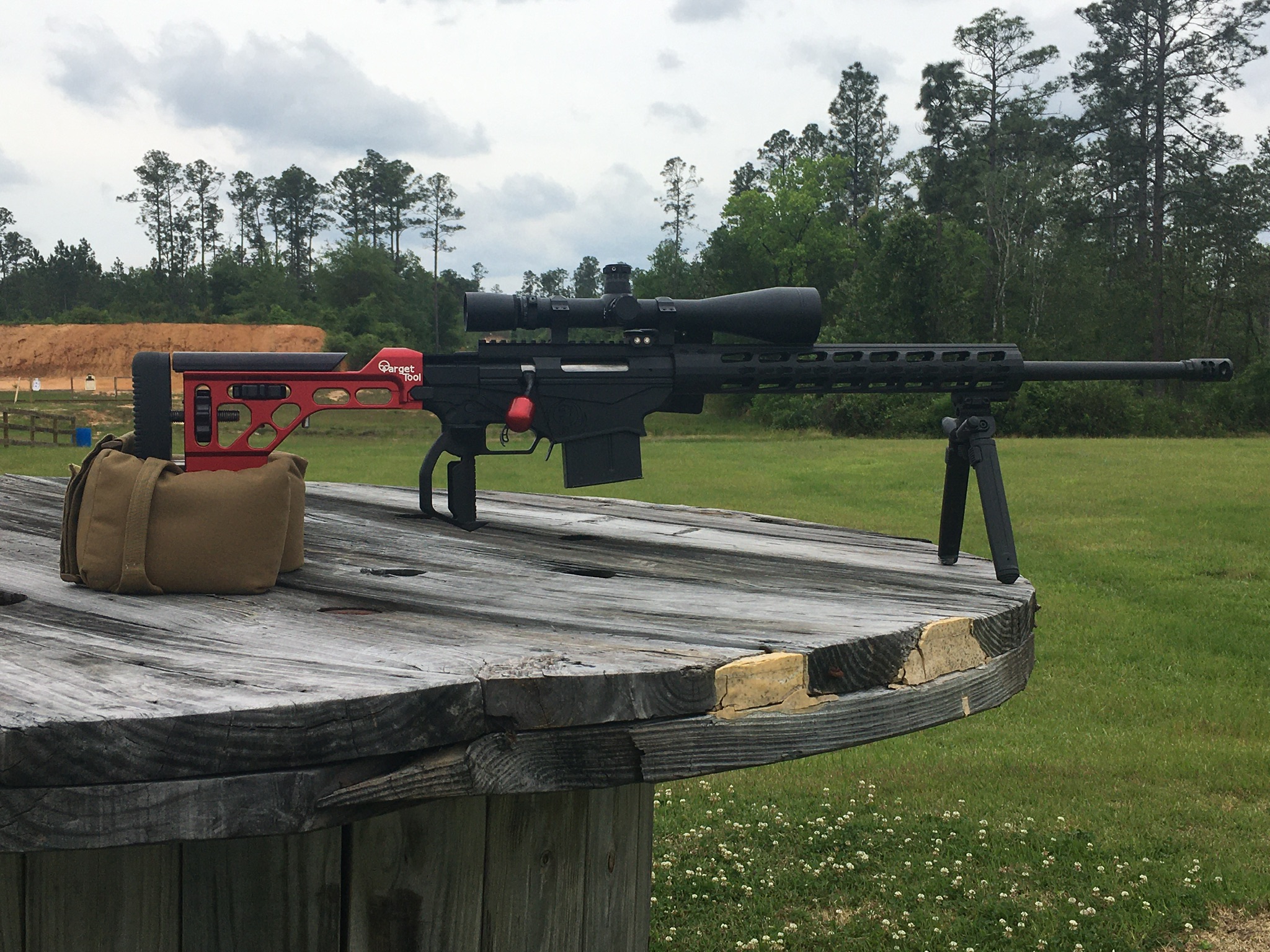

I'm jealous. I looked for a target tool stock and no more available. I wonder if he went out of business
Website. Have not talked to them for a while, but great fellow to work with. Nice Stock! Pine tree Casting ought to buy a license from Target Tool and produce these for the Ruger Custom Shop rifle. A definite improvement.

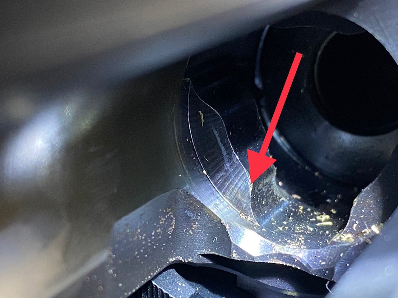

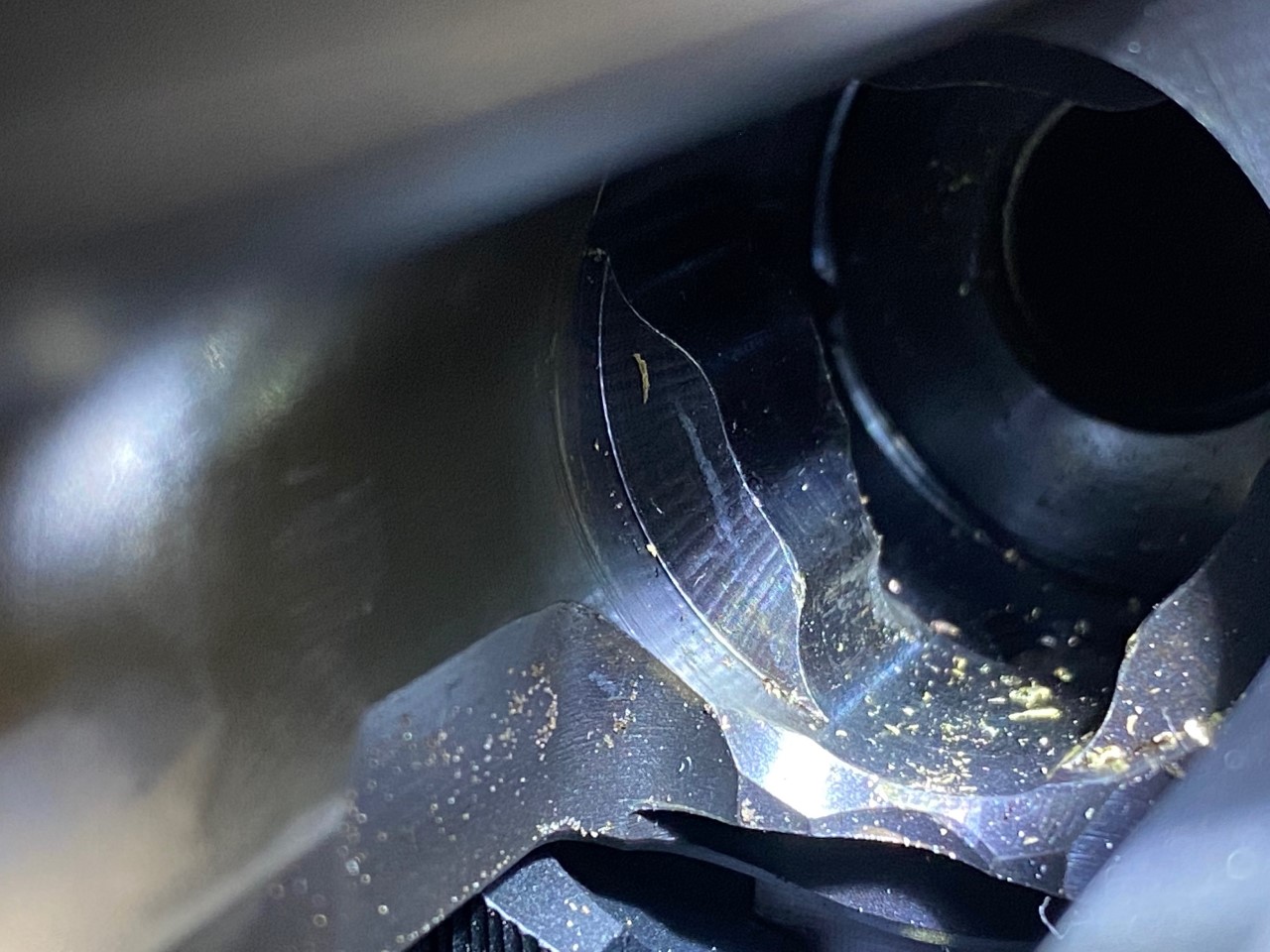

Hey guys - I'm brand new to SnipersHide. I joined for this exact same issue, with the exact same gun. Anybody ever get to the bottom of this? I can see where my brass is getting hung up, but I don't even know what the hell this is called. It's just like a feed ramp on a regular barrel, but it's part of the receiver...like a pre-feed...feed ramp. From the looks of it, I just need to bevel this surface and polish it, but wondering if you guys had any advice. Polishing it doesn't look too easy from a tool-approach angle standpoint, so this might need to take a trip to a pro.
Gen II RPR. Issue is more prevalent with nickel plated brass vs pure brass...because the round will just STOP on the bolt's forward stroke. If I run the bolt really fast, I can chamber every time. But if I'm just a little slower, it'll stop. Waiting to hear back from Ruger.
