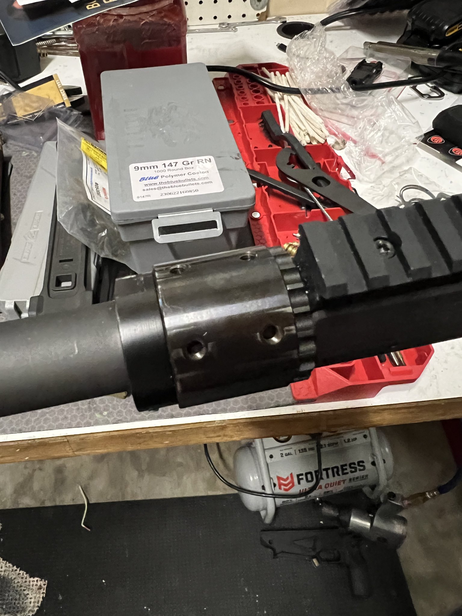

Trying to change the barrel on a gen 2. I have the LRI barrel nut wrench. The videos I see are all gen 1 it seems. Does the wrench not work with the gen 2 or does this collar have to come off first in order to slide the LRI over it to get to the teeth? Can’t get the collar off, scratched the crap out of it trying.
Yes, the wrench with work.
Yes, the collar has to come off first. To get the collar off, did you loosen the nut that hold it on and remove it?
Is that the black piece with the flats to the far left? Can’t get it off. Used a pipe wrench and just removed material from the flat. I guess a box end wrench would be better maybe.
Reactions: seafury
Yes, a box end wrench or a large crescent wrench. Make sure you're tuning it the correct direction (counter clockwise as you face the action).
Reactions: Shutrmgavin

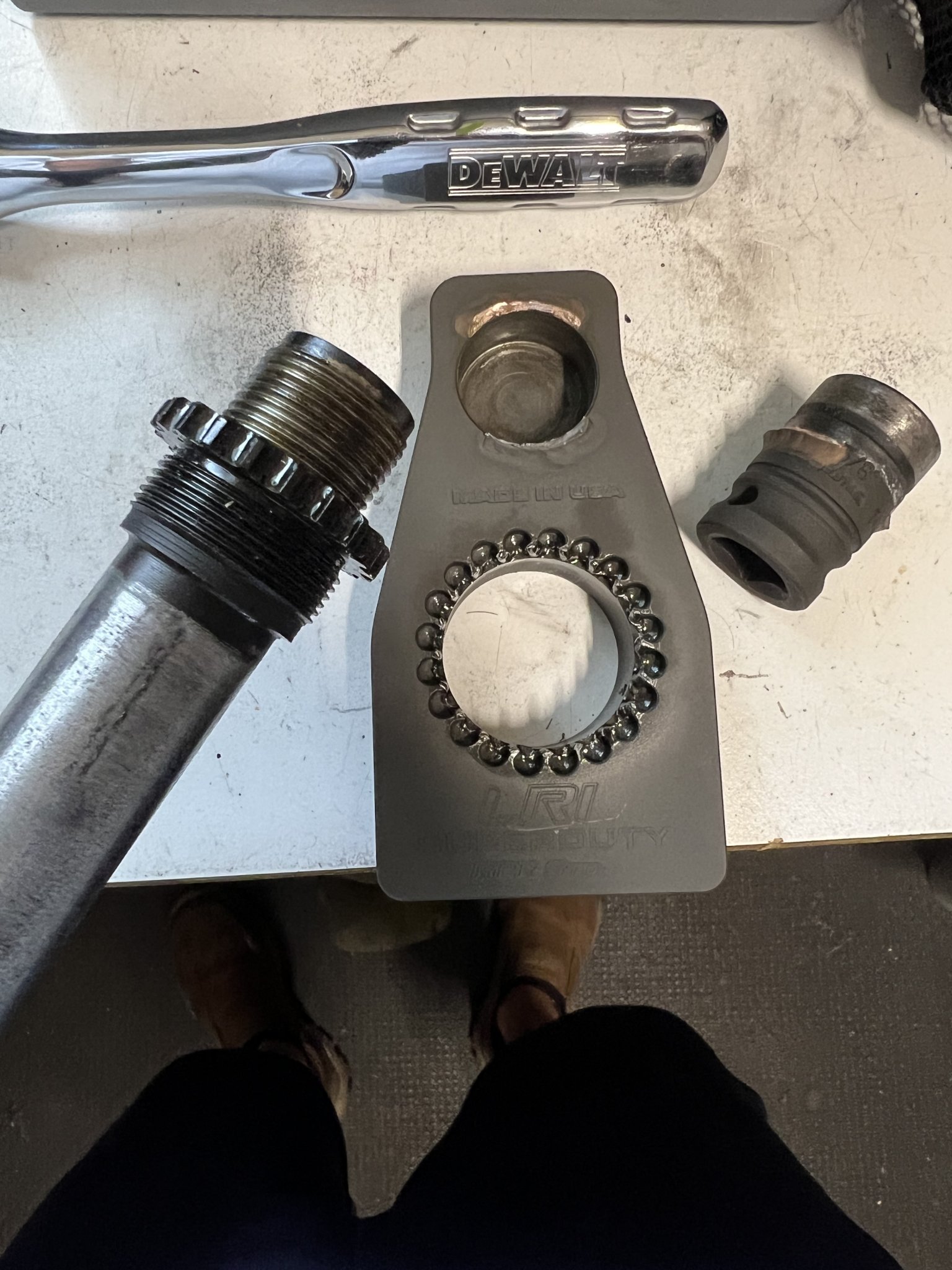

The LRI wrench succumbed. The barrel nut just won’t give. The receiver is obviously free and undamaged as is the factory barrel. I don’t understand. I heard they don’t sell barrel nut replacements
  • Wow
Reactions: CaptNkllm
I think you can get that barrel nut off and reuse it. The nut on the factory set up is indeed tight, but I think the LRI wrench just isn't up to the task. A couple of things you might try, if you haven't already, is soaking it in WD-40 or apply some heat to the nut to get it to expand a little. I used a different wrench (see pic below) and when I went to replace my factory barrel, I simply used a large rubber mallet on it to break it loose (a somewhat firm flow broke it loose and then the nut came off easy enough).
I don’t know that LrI wrench has very tight mating 360° around the nut. I used some oil and tried hammer blow and a 3ft cheater. I thought the nut kept the receiver secured but I guess that’s not how it works? Receiver unscrewed after several firm blows to the nut. I will try a blow torch I suppose. Really hate to send it in just to get the nut off.
A good reason to always use anti-seize on every barrel nut. I sympathize with the OP. Good luck

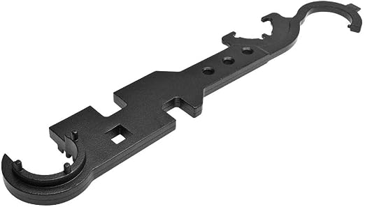

For barrel replacement the Magpul Armorer's Wrench has been up to the task, it also has a 1/2 torque wrench/breaker bar interface that helps aid in removal. A gunsmith buddy has busted a couple of other wrenches trying to remove that barrel nut.
