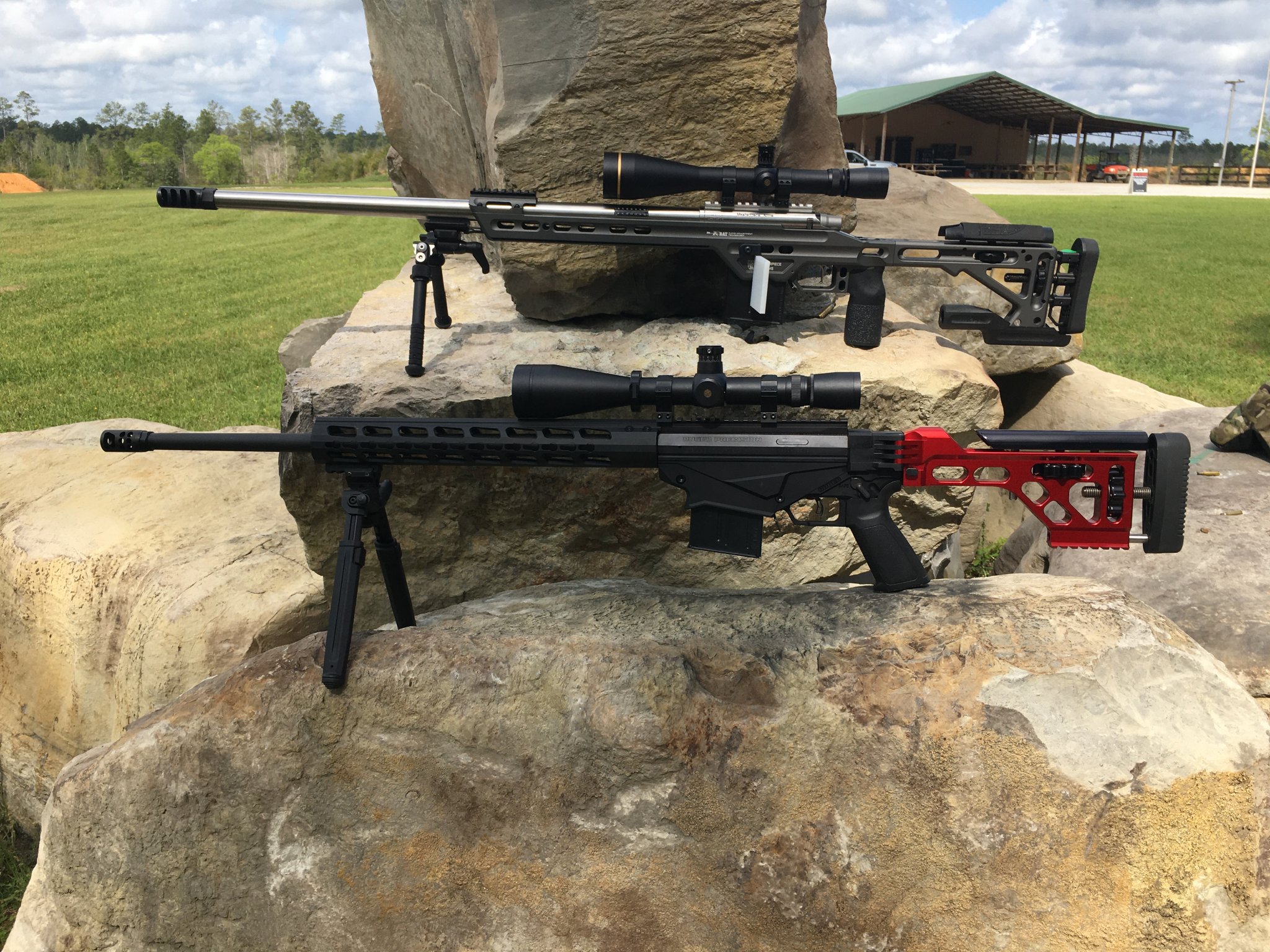

Took both my RPRs to the local 600 yd range yesterday. I have a .308 with a new 24 inch Bartlein barrel and a .338 Lapua. First time for either rifle past 100 yds. The .338: Let's just summarize real fast. 600 yds is easy. The .308 is stupid fast to the target at 300 yds. 400 yds was pretty easy and didn't try much at 500. They are a lot of fun.
