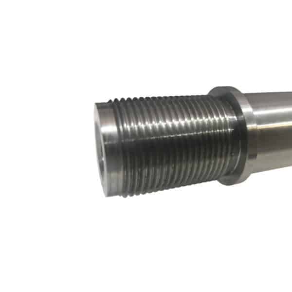

What do you mean about the unique drop in barrel design?
This barrel can not fit anything but an RPR. And no other drop in, unless made exactly like this, will work.

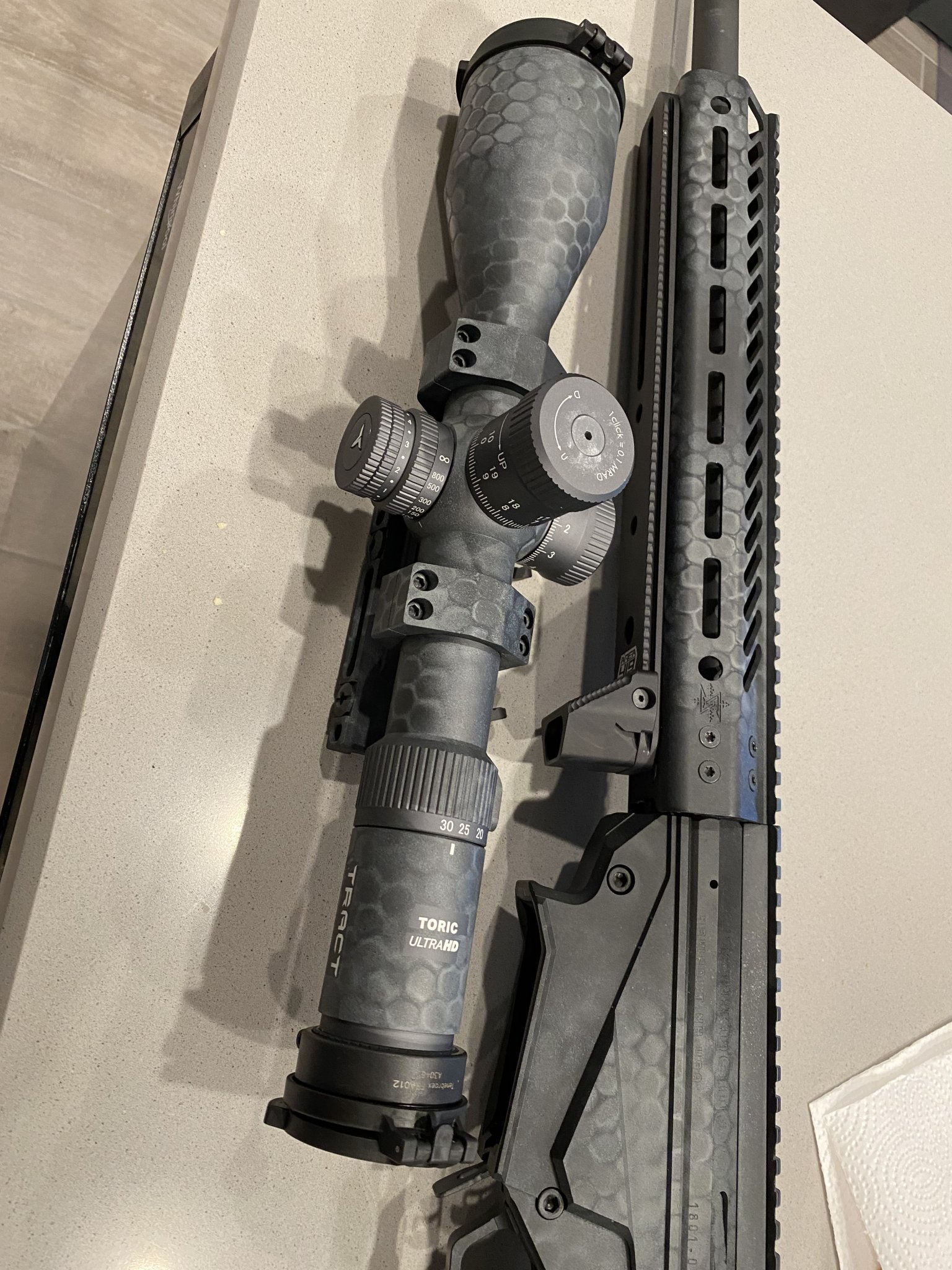

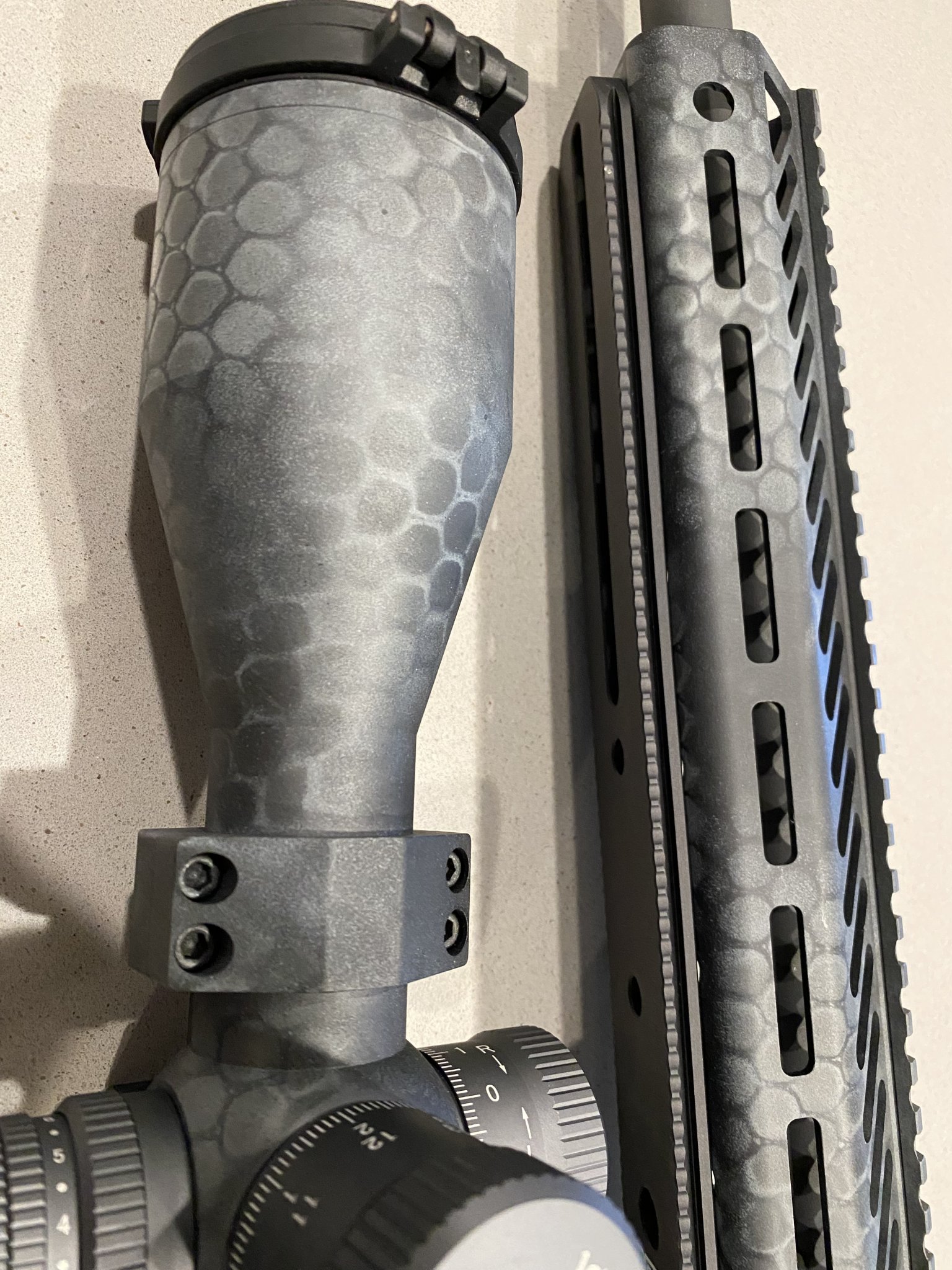

Edit- this is the rattlecan job done on my RPR. Need to make new full rifle pics
