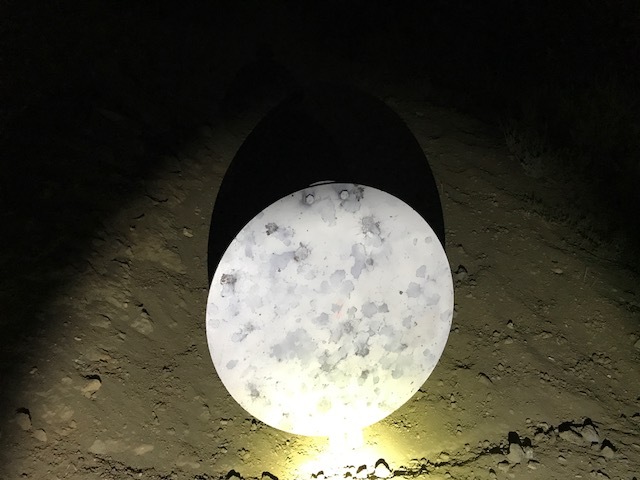

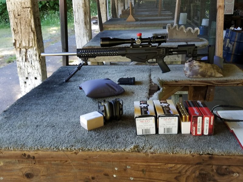

Went to the range yesterday for the 1000 yard attemp. We set up a generator at the plate and went up to the 1000 yard pad. We didn't start shooting till 9pm, it was DARK. It took me about 7 shots to make impact. There was nothing but shadow around the plate so it was difficult/ impossible to see our misses. My calculations gave me a 35.6 moa, it ended up being 34.5, pretty close for guestimating my velocity. I was shooting the 129 gr interlock hornadys. After my first intitial hit I made consecutive hits with relative ease. I don't know what happened next but I started hitting just below for the last few rounds, I'm thinking it was the ammo but it's hard to tell, it cooled down a bit too, maybe temperature? Either way it was a good time.
Sweet! At 1000 yards, temperature is VERY important. Especially when you start reloading. The 1000 yard shoots here start at 8 am. I usually shoot two strings of 20 rounds. As the sun rises, so does the temperature, and I always have more velocity on my second string, leading to a higher impact. I can also get away with loading lighter bullets in the summer that I basically won't even use early spring or later in the fall. About 36 MOA would be correct for me with the .308. With that speedy 6.5 CM no surprise you're at a little less. Bang away man!

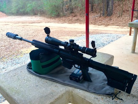

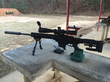

I was finally able to get myself to the range with my 308. The first session was setting up and figuring out the scope and getting the rifle zero’d. Once that was done I only had 3 rounds left and they grouped well as you see here.
fetch
Ballistic AE measured them to be .45 MOA. I was shooting Freedom Munitions New 308 ammo with the Hornaday 168 gr HPBT.
I wasn’t a fan of the factory stock and like a blessing from heaven MidwayUSA put the Magpul Gen 2 PRS stocks on clearance and I was able to snag one for $165.00. After tossing on the PRS stock it changed the LOP for me and I had to adjust the eye relief of my scope. I tossed that on the 308 and finally had a chance to get out to the range again. After a quick re-zero I got some rounds sent down range. The rifle performed admirably.
fetch
I didn’t have anymore of the Freedom Munitions Hornaday HPBT. The second range visit was using Freedom Munitions New Hornaday 168 gr A-max round. Once my rifle was zero’d I shot my first 5 round group. Sadly I pulled the fifth shot! Without the flier Ballistic AE measures the group .53 MOA. My second group was 1.03 MOA.
fetch
fetch
Given my naiveté with regards to precision shooting I’m pretty happy with my results. I’m looking forward to having both the 308 and 6.5 RPRs up and running.

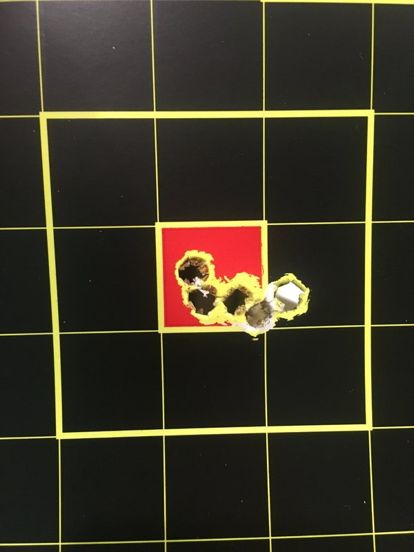

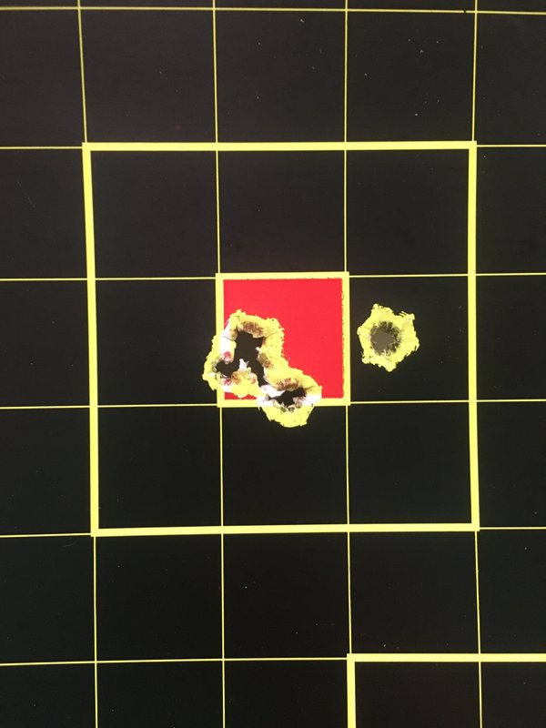

I purchased a LRI barrel last November for my 308 RPR and just recently got around to installing it (life got real busy) The install went well but the results are puzzling. I'm shooting federal GMM out the 22inch barrel and the best group I have been able to archive with the 168 grain is 1.5 inchs worse than the Ruger barrel. When shooting 175 grain GMM the bullets are consistently keyholing! The same ammo is shooting .85 - 1.0 inch groups with my JP semi so I'm pretty sure it's not the ammo.
Anyone have any advice on what could cause this from a brand new barrel?
I have contacted Chad of LRI but after his response of asking me what type of ammo (1day) I'm shooting (reloads or production) I've gotten no response back (5days). Too soon to say what's happening at LRI as far as customer service but not to soon to seek a solution from other experienced shooters!
I'm a newer guy here so thanks in advance for any help.
^ I'd try different ammo or a different load. Ammo that shoots great in one rifle can shoot like shit in another. For example, as far as factory ammo, Federal GMM actually shot the worst in my factory .308 RPR. About 1.5 MOA. Nosler Custom Competition shot the best at about .5 MOA
I'm sure Chad will be by soon and will make sure you are squared away. Folks at LRI may just be taking a few well deserved days off around the 4th of July Holiday.
Definitively something strange going on if you are keyholing rounds. Are you confident in the quality of the barrel change operation? Any chance it may not have been mounted or tightened properly?

The keyholing was at 100 yards. The barrel install went perfectly, head spacing great. I may take it all apart after I try some different ammo. I have 3 different types of match ammo to try, never had an issue with GMM but anything is possible. I just have a hard time believing the keyholing is from the ammo. Hopefully Chad will have some idea what is happening.

Truth be told I have no earthly idea why your gun is splattering bullets like a shotgun. Do you have a brake on it or any other type of muzzle device? Anything is certainly possible and LRI is not infallible. I would have to see this thing before having any kind of speculative guess.
As for a 5 day lag, let me put this into perspective: If I sit on my ass and answer email after email after email it does absolutely nothing to ensure I get bills paid. We have a phone number gents. I plainly list it at the top of every single page on our store. We have 5 lines coming into the shop. We answer it when it rings.
Give us a call and lets get you tuned up.
