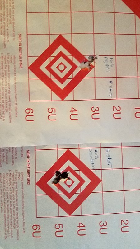

After rechecking headspace, scope mount and switching to a bag instead of my Bipod my groups tightened up considerably! Thanks to everyone that pointed me in the right direction. LRI barrel is living up to it's reputation. The wind kicked up so I quit today but the 2 groups below made a believer!

^ Are those your handloads?
Nope, 1 was FGGM 168 the other was Creedmoor brand 168 grain....forgot to add those were 5 shoot groups! I'm looking forward to my next trip with some hand loads, 175 grains FGGM and creedmoor were not as tight. Next decision I need to make is Break versus suppressor ...or neither.
