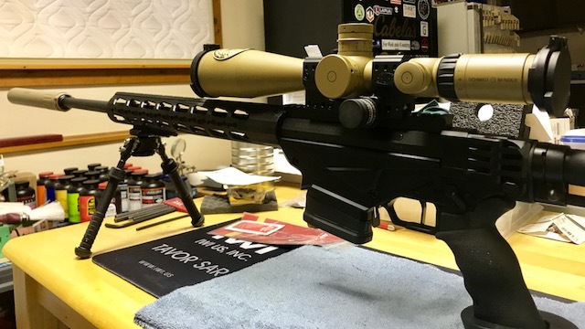

I have the SPUHR SP-4006 on my 6mm creedmoor, it has a height of 1.35" seems to work just fine for me.

I'm getting a vortex razor HD gen II scope for my precision gen2. What rings do you guys recommend.
I really like the Burris PEPR one piece mount. Easy to remove and store the scope, perfect re-alignment when you put it back on.
The (6) screws per cap torqued to 18"# is really easy on the scope tube and the wide rings will never leave a mark on the tube.

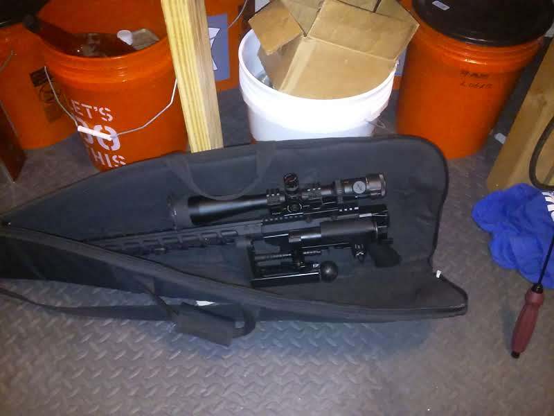

Kind of a equipment question but it relates the RPR.

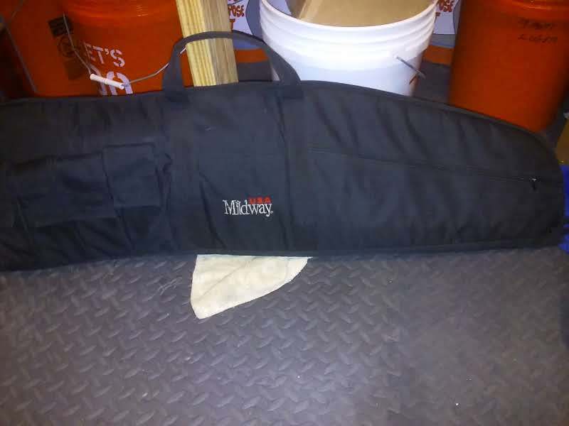

what are you guys doing for soft cases? I'm deciding between a Midway rifle case/ shooting mat combo or a real simple case and dedicated mat, most likely the triad tactical mat.
Heres the case/mat combo I was looking at.
https://www.midwayusa.com/product/182067/midwayusa-pro-series-shooting-mat-tactical-rifle-case
My only restriction is case length. Case can't be over 46" otherwise it won't fit in the trunk. The rifle is about 44" long so and I'm ok with folding he rifle but it's hard to tell online which case are thick enough to fit a folded rifle.

When I am taking only the RPR, I use an AR bag, rifle folded. That would meet your length restriction nicely.
I use one from Midway, priced right and good quality. It balances perfectly with my range bag in the other hand!
The only thing I would mention about storing it folded is that for me to get my eye relief correct on my scopes, the scope extends past the hinge-point on the stock. Meaning, when folded, the scope stands proud of the folded stock, and could possibly be damaged if you're not careful. Does anyone else's scope stick out further than the folded stock?

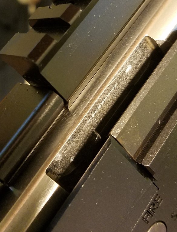

A lot of folks mention or complain about the "zipper" sound from the bolt. It stems from the rough machining of the bolt itself. There have been a couple of ways to remedy this. One is to shoot it until the bolt smooths out, two is to polish the bolt to remove the rough machining and three (what I did) is to have the bolt "Micro Slicked". This is a Cerakote dry film coating that smooths and protects the bolt (some have complained of rusting of the bolt also). Zephyr Defense were the folks that did mine and you should be able to find them on the internet. I also had my bolt handle done at the same time so it matched the color of the bolt. I'm not sure what colors are available but I had mine done in black.
Sent from my Pixel XL using Tapatalk
Folded, yes it does. I don't have an issue with that, I am pretty gentle on my rifles even in the padded bags. When I am hauling more than one, I have a large 2 slot drag bag so they don't get folded.

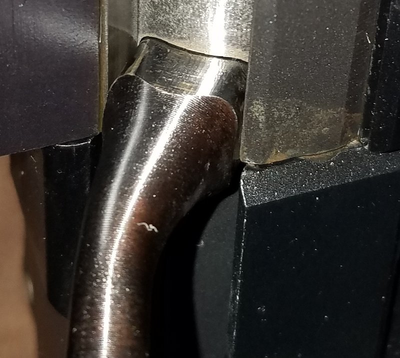

Here's a question for you RPR scholars. I just bought a Gen 2 6.5 creedmoor. Running the bolt I noticed an issue. When the bolt handle passes the rear of the action, where the hinge assembly meets the action, there is a narrow spot. Moving the bolt to the front or rear takes extra force because the handle is essentially pinched. Its worn the finish off the base of the bolt handle. If I run the bolt as fast as I can it passes through with less extra effort but it's still noticeable. Slow manipulation and it takes considerably more work. I'll take a picture when I get a moment. Anyone had an issue like this?

Have not experienced that issue.

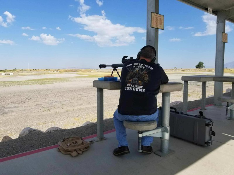

Finally got some decent weather and a morning off so out to the 1K we went. The Sinclair bipod is NICE. The range sets are scattered side to side up a long hill, so going from 250 to 500 is uphill, as is 500-600, 600-650, 650-750 and at the top is the 1,000. So to run the ladder, you need to constantly have to re-adjust the legs on the bipod. First set requires a shorter leg than normal, so I spread the legs to drop the barrel, Going to 500 meant taller, so I brought the legs back in and as I went on up the hill just extended the legs. Super simple, super quick. This is now my favorite bipod. I thank you Lefty, for posting the info on it. I like a little play in the legs, as long as it is horizontal and in-line with the bore. It helps with recoil absorption. With the adjust-ability of this this bipod, that is very easily accomplished.
I ran the ladder, five shots at each distance with no misses. After cleaning up at the plate at 1,000 yards, I decided to give the 3" a go. Ever try to hit a 3" hanging gong at 1,000 yards? I hit it on the third shot. Even a blind hog finds an acorn every once in a while. LOL, the bipod is great. And to boot, a guy 4 benches down from me hit about 10 minutes later. Guess what he was shooting? An RPR chambered in 6.5CM. Gotta love these rifles, spot on at 1,000 yards with a factory gun.
