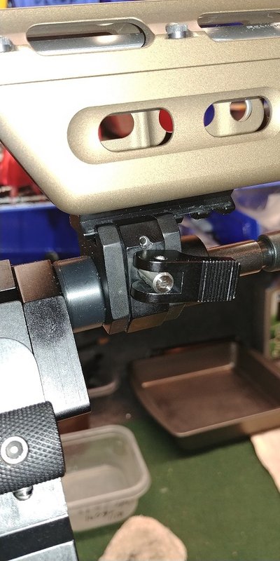

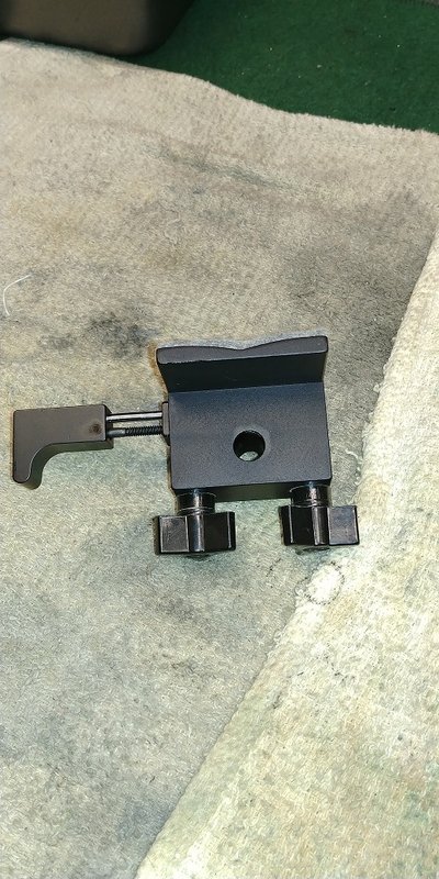

The Sinclair adapter replaces the entire stud mount assembly with a new assembly that the bipod mounts directly to. It is not truly an adapter, it is a replacement mounting block. I opted to go this way to keep the number of parts at a minimum, therefore reducing overall height and minimizing movement with more pieces int he stack.

^ Griz is exactly right. Adapter isn't quite the right word for it. I use that term only because Sinclair does. As you can see, the entire head comes off the bipod to mount to either a stud or rail. The swap is easy. Only takes a minute. For you guys using a sling, Sinclair put a stud in the bottom of the rail mount head so that you'll still be able to use it.
