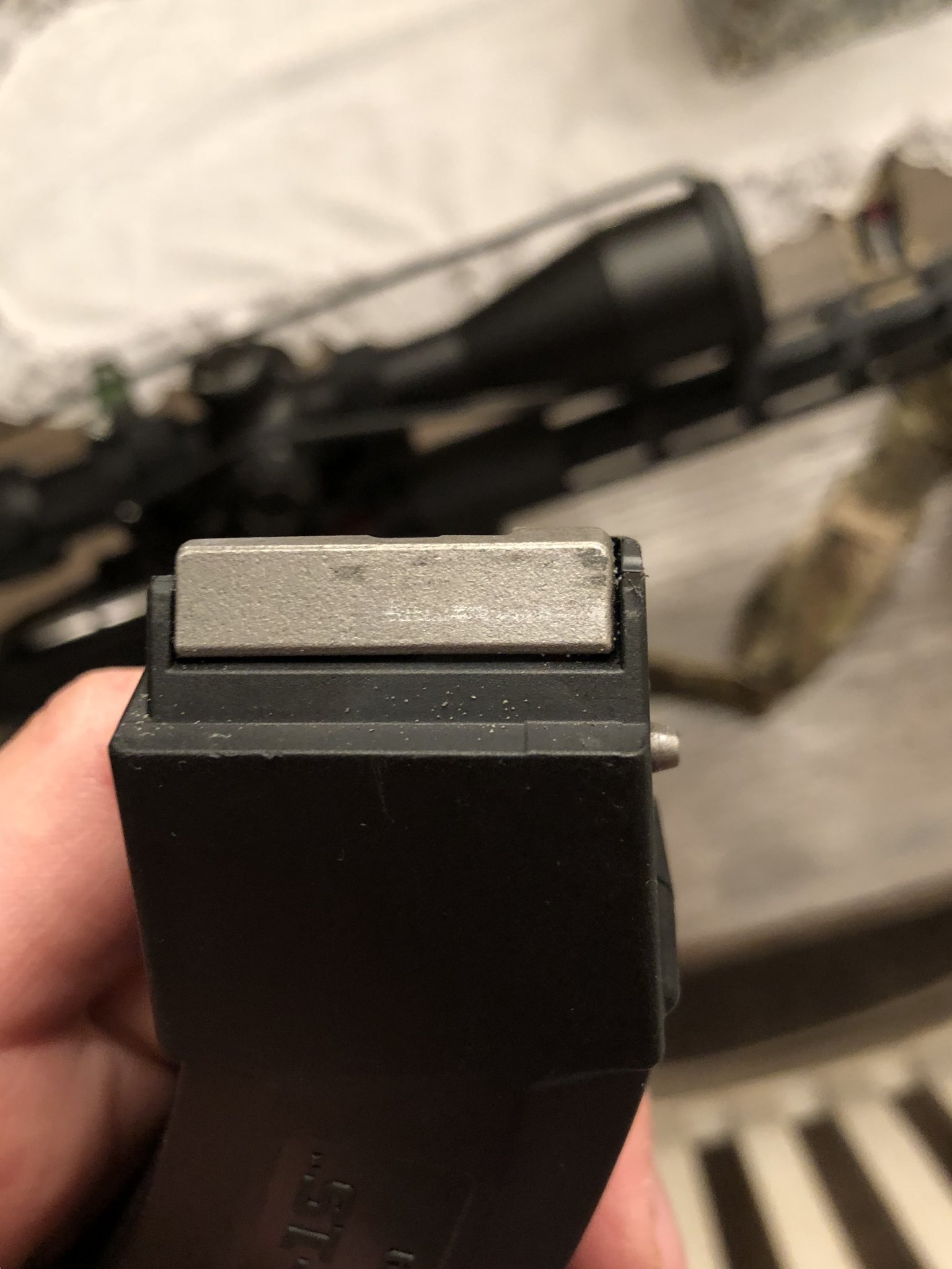

In regards to the 10 round magazine issues look into Kidd Innovation's 10/22 magazine plunger and extra strength spring. I've found that the combination has worked very well in my Ruger Precision Rimfire and Ruger American 22LR Rifle.
Thanks for the tip.

Is anyone else having issues with cycling the bolt with certain mags? The BX 15 that came with the rifle cycles perfectly. BX 10 rotary mags do as well. I tried a BX 25 and the bolt kept binding up. Even with magazine completely empty. No big deal, I always have problems with them in my 10/22 also. I ordered more BX 15s. They are doing the same thing. They cycle perfectly in my 10/22 though. I received another BX 15, ordered from a completely different company about a month after the first batch. Same exact thing. Works like a dream in my 10/22, and I can't even push the bolt home without excessive force in my RPR Rimfire. So at this point, it has to be the rifle. I'll be sending it back to Ruger shortly. You can see where the bolt is rubbing the magazine.

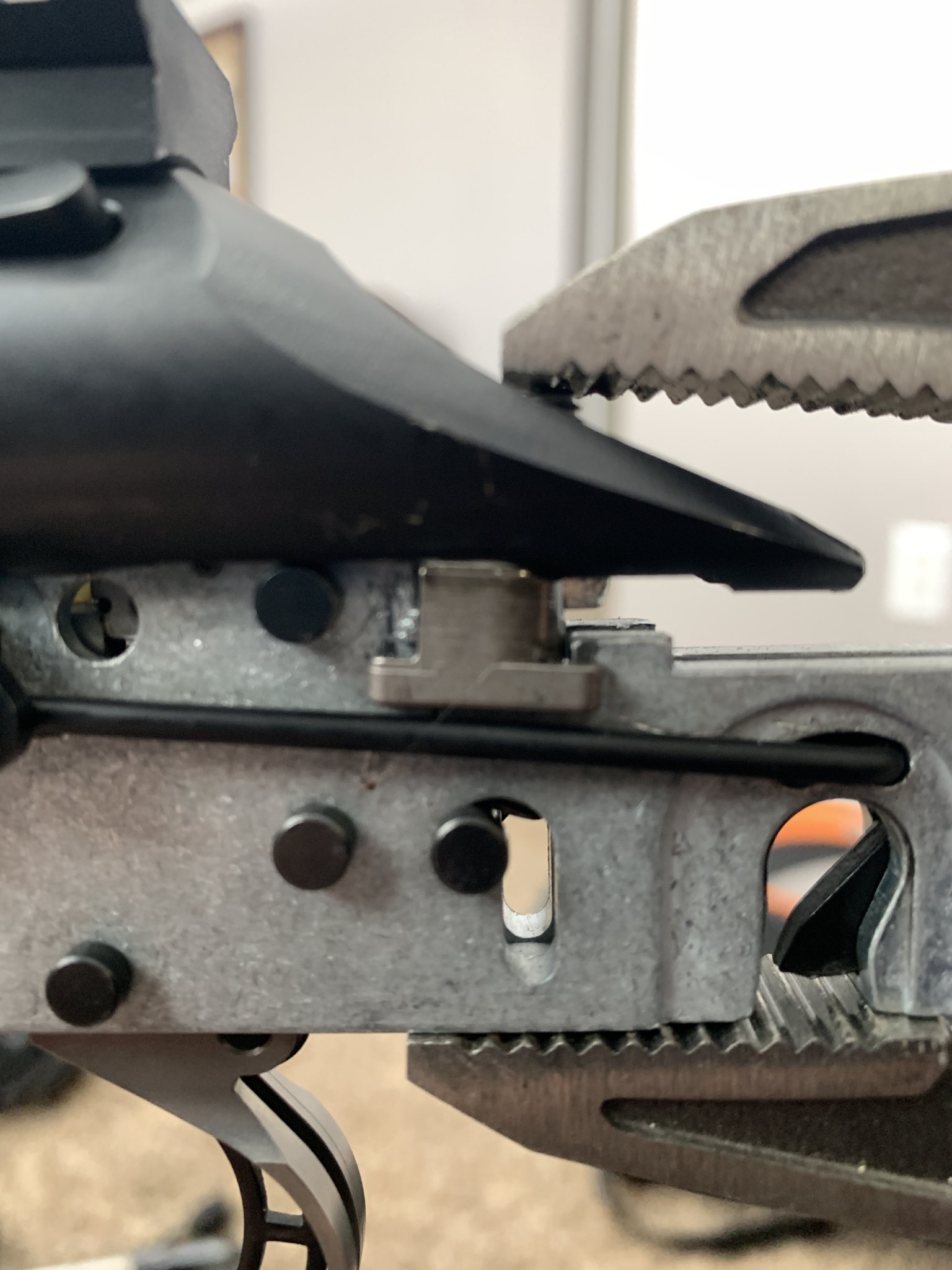

Taking it apart again.
Just re-adjusted the trigger and going to see if it’s dirty and my shoot it with maybe dry silicon lube to see if it helps.

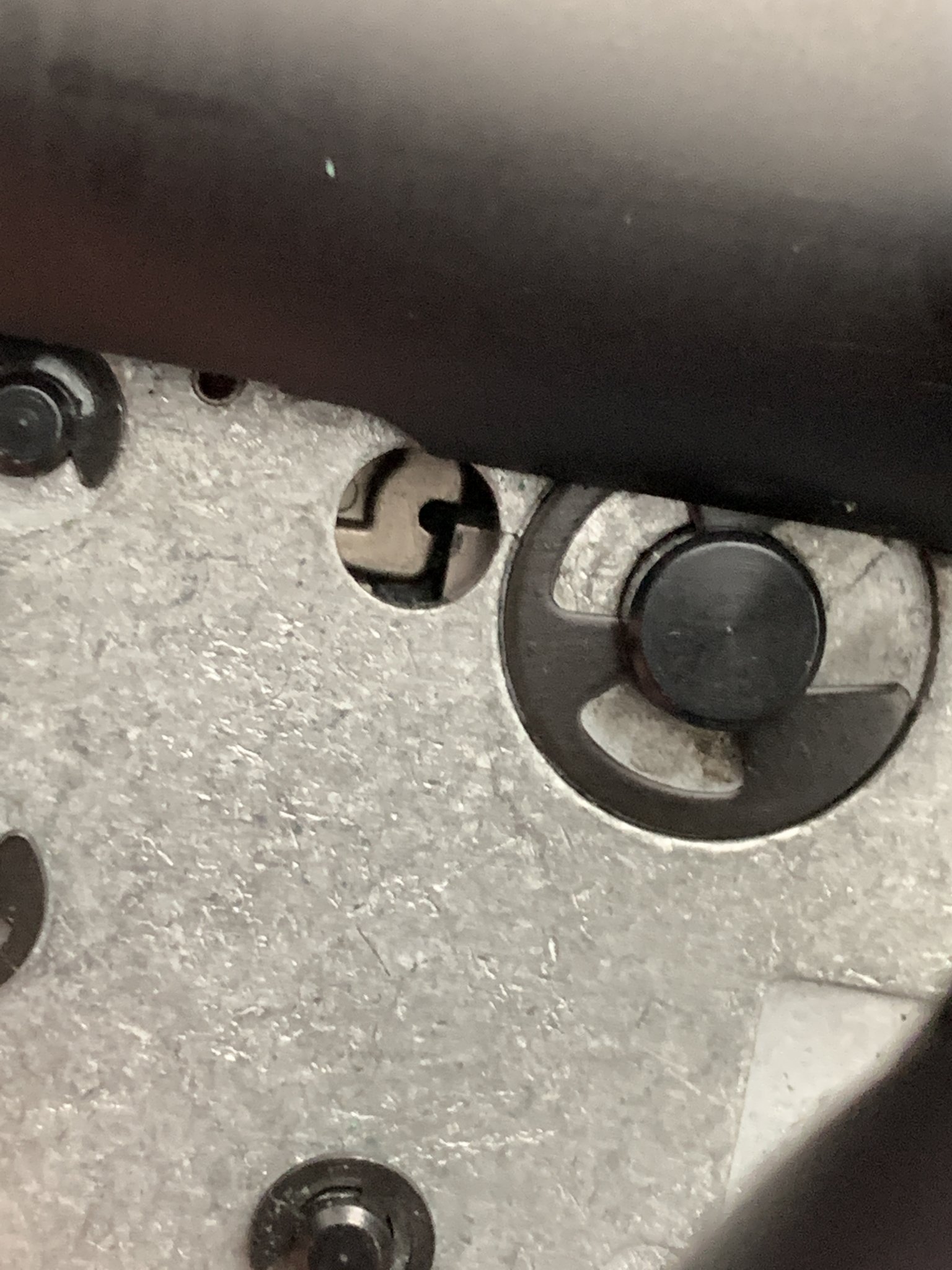

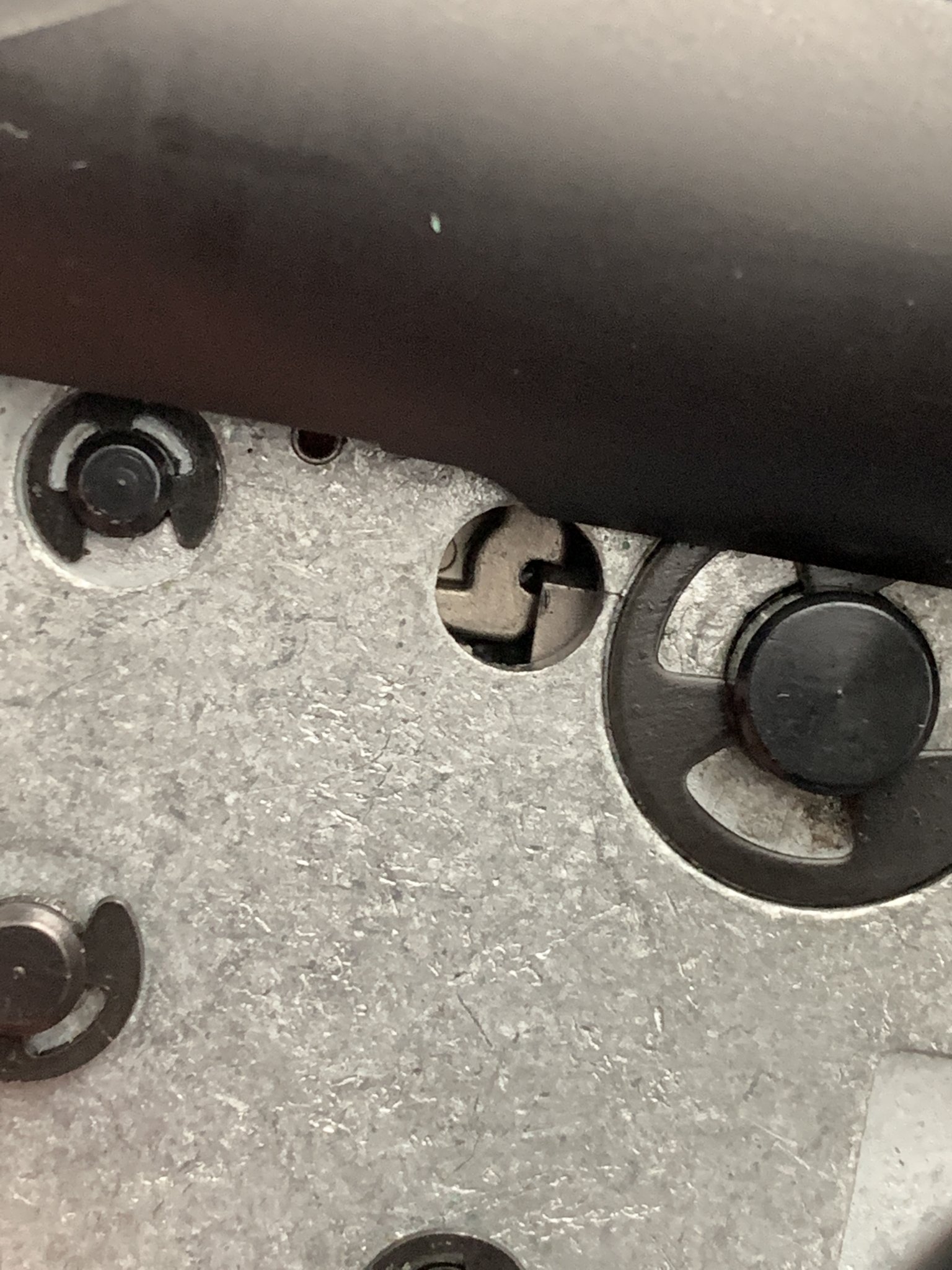

Here is the issue with trying to remove the trigger group.
The retainer with the spring doesn’t go low enough to clear the receiver.
This is fully compressed and bottomed out and it still won’t clear the receiver.
The safety seems to have a “2 stage” feel as it clicks twice when you click it to fire.
1st “stage” goes too far and the 2nd “stage” moves it towards safe like 1/64”. Kind of weird
I wrote Kidd CS asking about the compatibility of the Magazine plunger and spring and never heard back from them. Got to the range today and ran two 10 rd mags through mine. Results are very encouraging. Using Eley Club first group about .65, after slight sight adjustment second 10 round group is right at .50 @ 50yds, no wind, 65F. I will clean and go again but I am happy right now. The CCISV I first used is not so great. In fact this lot has not been good in any of my rifles. My safety is something I can live with. Before I sent it back to Ruger it was ridiculously hard to move when the action was torqued down. Trigger is fine so I'm in no rush to change anything there.

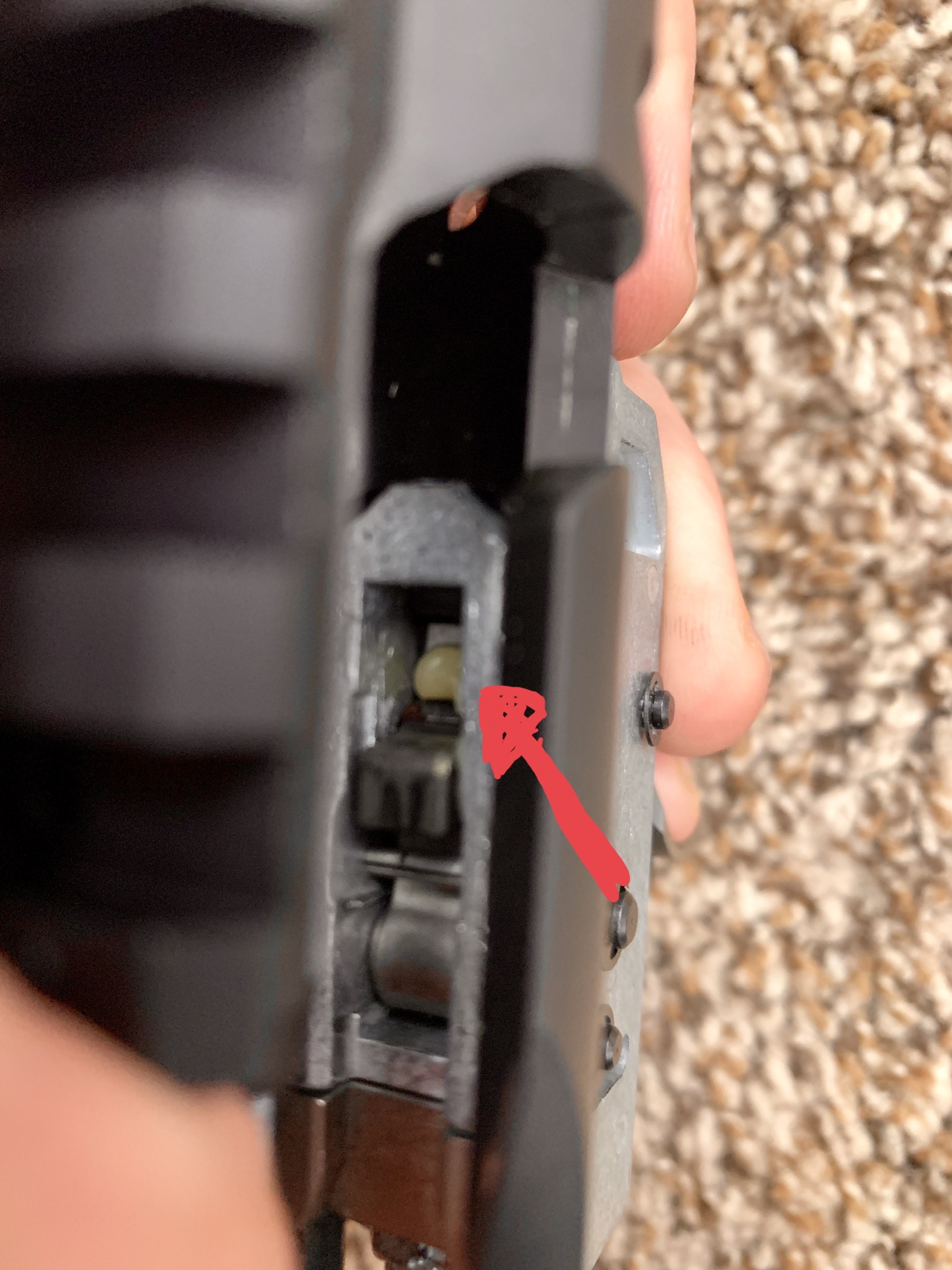

Frankr I can't tell if you putting the trigger assembly back on or taking it off but i believe the cocking guide spring pin should be at the long end of the "J" before removal/installation. You are fighting against the built up loaded coil spring.
In addition it looks like the rifle's safety is off. How were you able to remove the action from the chassis?
Carriec- exactly what was wrong- went back and moved the pin to the end of the "J" and got it out. Now I can really clean and lube it.
Thanks a ton.
The safety was on when it came out. I was watching it as I moved the safety bar to see if I could find where it was binding or where it could use some lube to help make it easier to engaged or disengage the safety.

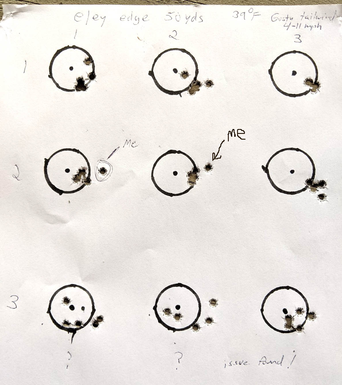

Ok I braved the cold weather and headed out to the range to do a magazine accuracy comparison. I'm posting a 3x5. My results are surprising and CONFIRM that if the rounds are not loaded perfectly, accuracy goes to hell. Why?.... I found an issue with my BETA PITA Sled.
Excuse list: Its COLD, 39 degrees, and I was literally being buried in 5.56 and 7.62 casings by 2 guys shooting to the left of me. I didn't mind it, but it threw a few of my shots off.
50 yd, FIRST TIME using Eley Edge in the rifle, and it LOVED it. First 5 test shots off target were 1 ragged whole. Which I lol'ed and thought, well that will be the best group of the day since its not on the target I want to take a pic of! :)
Broken down by rows:
Row 1 = 15 rnd stock mag
Row 2 - 10 round clear mag
Row 3 - BETA PITA sled
Let me discuss each row after you see the pic. Each of the circles are 1 inch diameter. (Just trace a $0.25 piece. They are .995 of an inch. Cheap way to test!)
Row 1 - accuracy improved..... as the magazine emptied! Less tension on the rounds as they are fed. Target 1/3 is 5 rounds!
Row 2 - most consistant. Flyers were me. I ONLY loaded 5 at a time in the magazine. Less tension.
Row 3 - WTF?! How is the sled this far off? It took me a bit but I figured it out.
I had SEVERE feed issues with the sled. It made no sense. Keep in mind this is a beta one. When I inserted it I made sure it was far up and clicked. It was seated tight. 2 reasons this result was so bad. First was after the initial shot, the sled was infinitesimally dipping down in the front. Each follow up shot was worse, until I had major feed issues. (Like ejecting when pushing the bolt forward!) It wasn't until the very last target 3/3 that I figured it out. This is because of a burr I have on the front pin of my BETA PITA sled. I'm going to file it down and test again. There is no doubt in my mind the sled should be the most accurate.
Secondly, due to trying to figure out the problem, almost every one of the shots in Row 3 were cold bore. It was 39 degrees with a bit of wind. It didn't take long for the barrel to cool. Also I was REALLY cold by the time I got to row 3. It was almost 2 hours. (Testing, people chit chatting, range going cold for people to put up targets, etc) and I was fighting some shivers.
What do I think this proves:
I believe these results only strengthen the belief that if the rounds are not fed perfectly, the accuracy will be off. When looksing at the rounds that failed to feed right on the sled they were nicked. When looking at the rounds with teh highest tension that cause rough feeding and nicks, they were the worst performing. Looking at the mag with the least wiggle, and only 5 rounds for less tension, the results were much better.
I would REALLY love to see someone else with a 10 rnd mag and a sled do this same test!

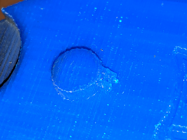

Any idea if any company is working the magazine release?
I don't have access to a 3D printer so that's out.
