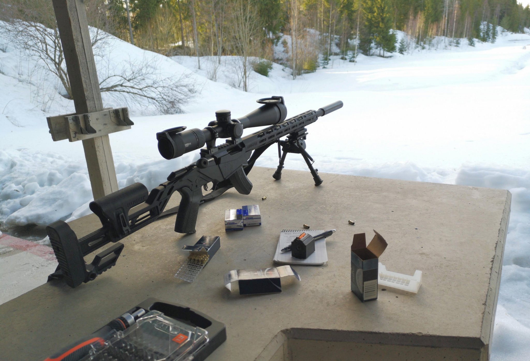

Finally remembered to take some pics at the range. Here's a few groups - Federal Gold Medal Target/Match are still doing well, but it's the older White Box. Haven't tried newer FGM. CCI SV does well enough for me to stock up on it some. Aquilla is not great. To be fair, I'm far from an expert marksman, so the indian might have affected these some as well. :)
Florida, 70*, occasional gusts of 5-10mph but I tried to shoot around them. 50 yards, 1" pasters
Federal GM Target and Match - I removed the 5 shot pic as I think I mis-labeled it and can't recall which group is which :(.
Federal AutoMatch and CCI SV - Automatch was initial group shot today, after that I adjusted the windage a bit
Aquila Super Prime...
I also had some Eley Target, but for some reason don't have a pic. It's wasn't great, worse than FGM and CCI SV, better than Aquila. Nothing to write home about.
Guy a few spots down from me had a CZ455 and a Anschutz, not sure of the model. Both looked very sweet thought. He was very curious about the RPRimfire...

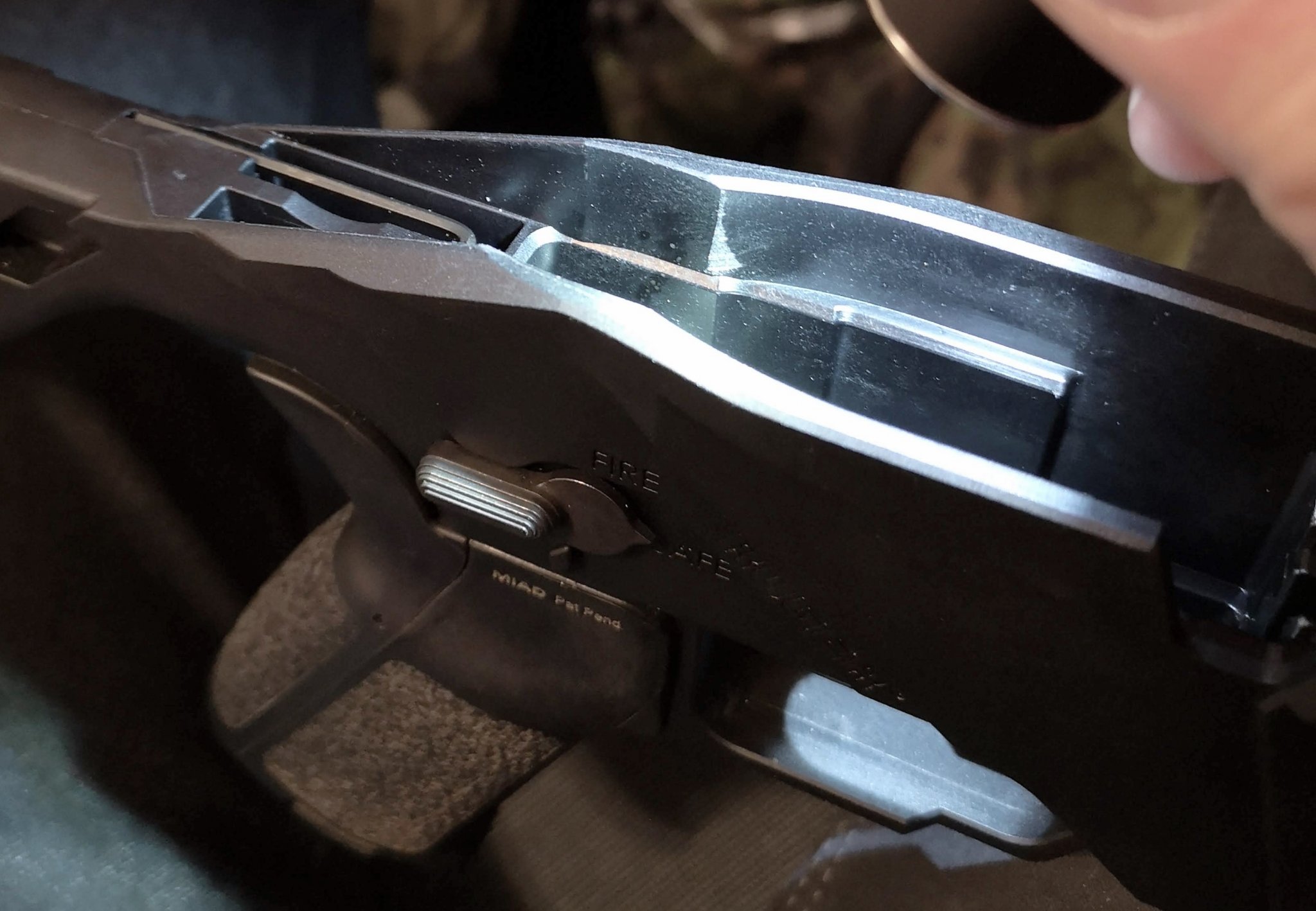

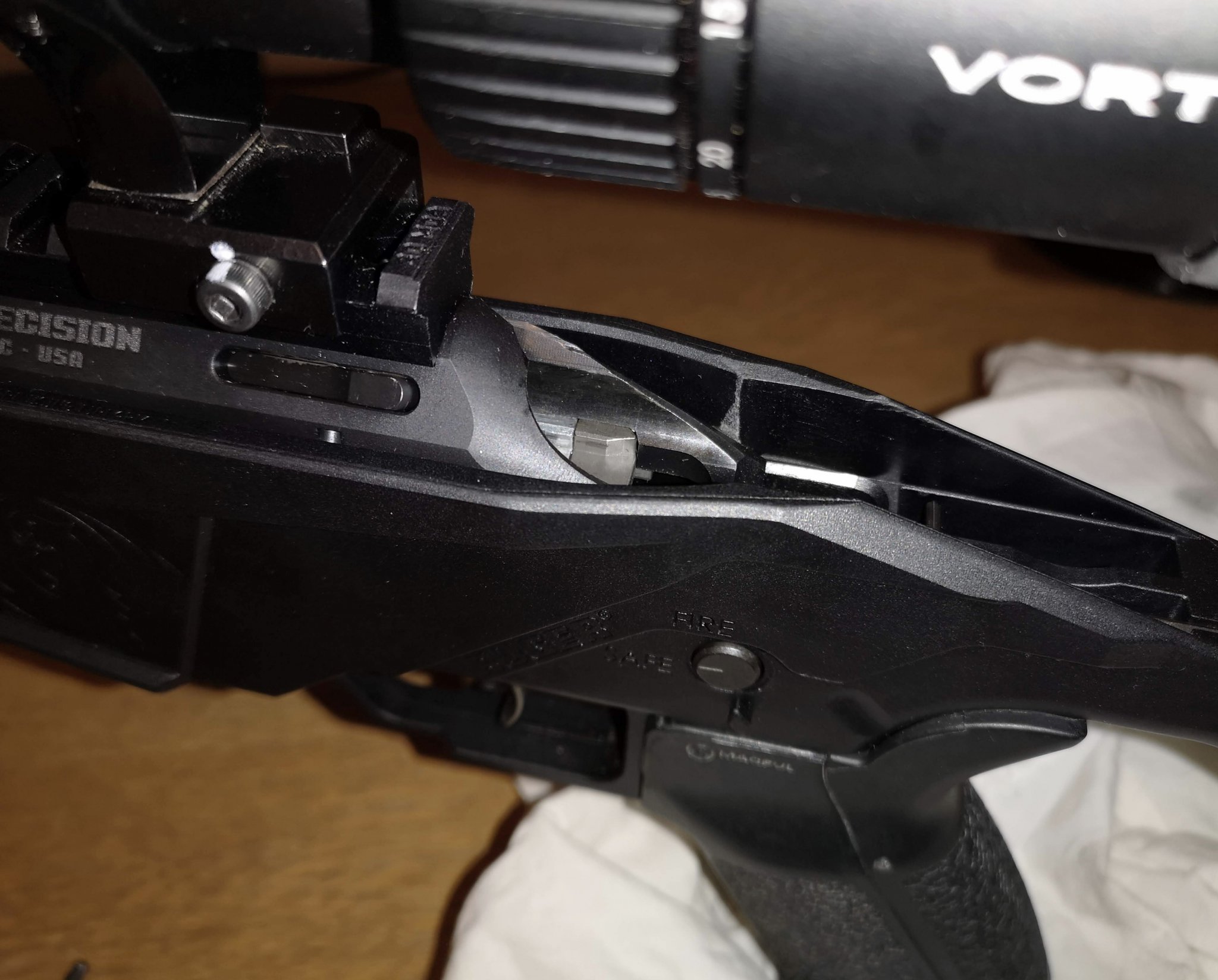

My RPRR safety was fine when it came out of the box. It's not now. I would pull your action and thumb button from the stock. I would then slide the thumb button into your trigger to actuate the safety in the trigger module You will probably find that your safety will move fine with the stock and action divorced. I will work on mine today, April 6th and let you know what my problem/fix appear to be. Then there is a relationship between the stock and some other parts that may have changed like your hand guard moving aft a few thousandths. Would I like a new Timney... heck yes! I would like to get rid of the center safety and have a straight blade but it is not worth 215.00$ to me. As a side bar.... from what I saw on a you-tube, an Aluminum Tape foil bedding job would be worth doing. You can't turn a sow's ear into a silk purse, but you can eek out every last inch of performance out of something. That is what I enjoy doing.
If I get a chance today I will look at doing that. I think you are right. I don't remember the safety being hard to move until I pulled the action.

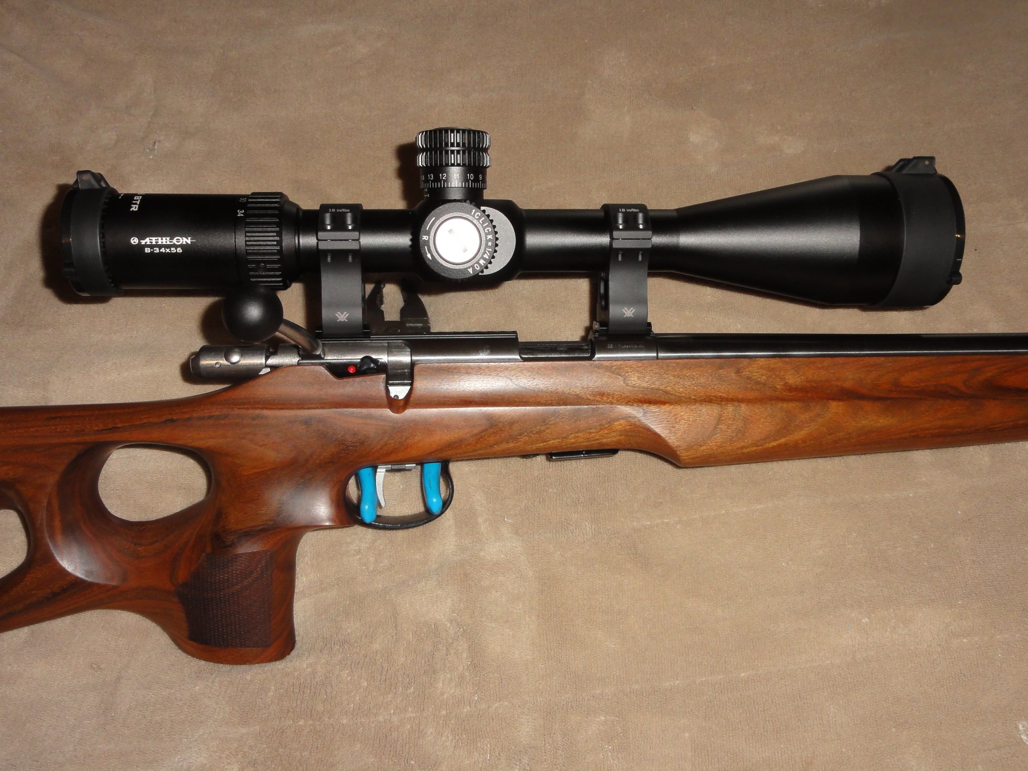

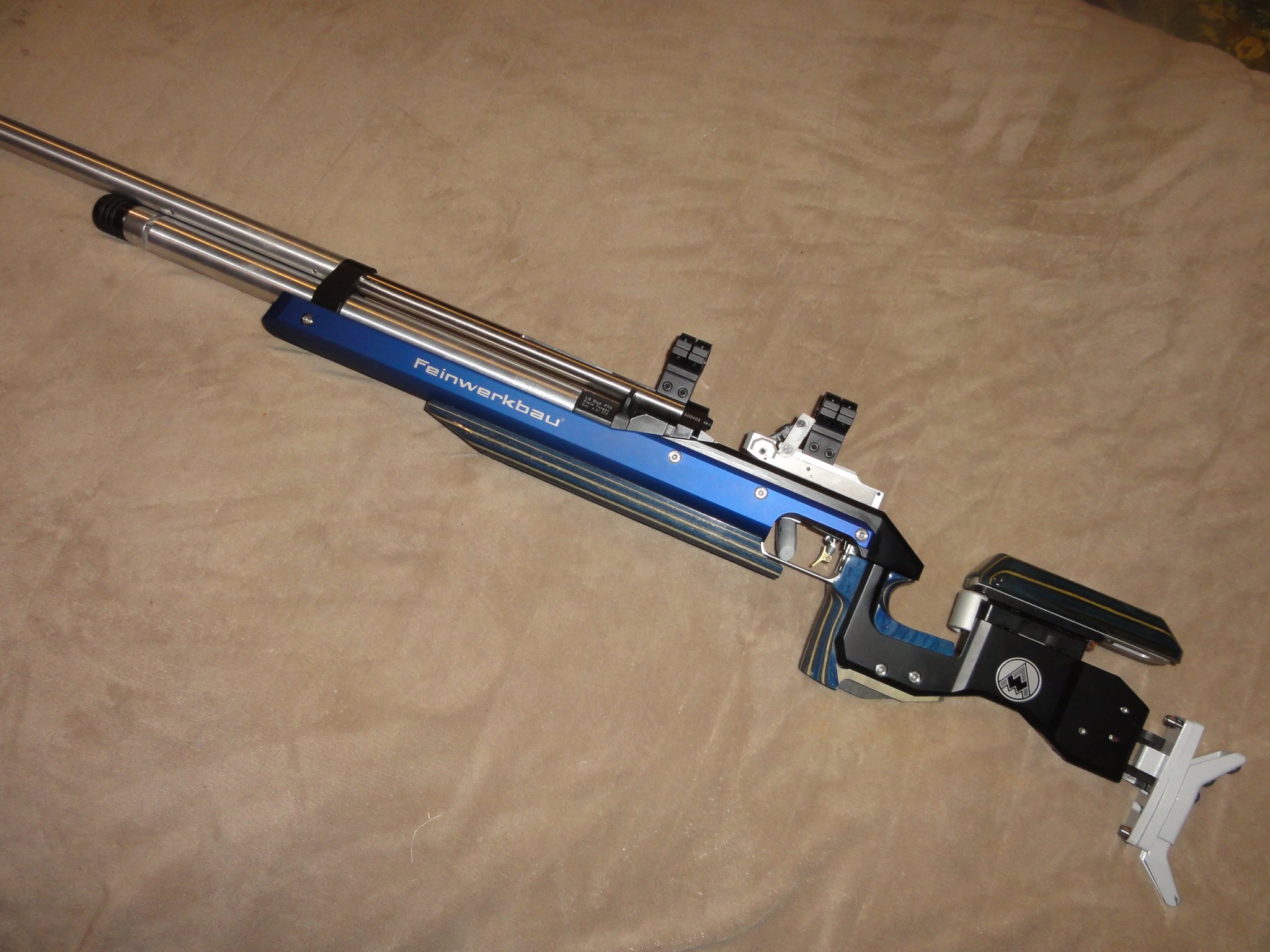

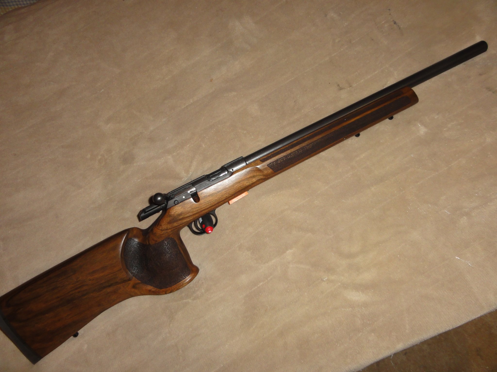

The blue rifle is a .177 air rifle. The second to last is a CZ457 MTR. I put an extended aluminum magazine release today. It's only .085" longer but it helps and the factory is a plastic. I got the two Annie's this past week. You can see that the Annie's have 17mm of trigger adjustment for and aft and the blade is wicked comfortable in it's shape and weight of 6.35 oz.

I too installed a Kidd plunger with x-pwr spring and it did about nothing. Dimensionally it's virtually the same. Even the spring wire diameter. Always remember that I work on my guns largely for the enjoyment it brings me.
I removed the hand guard and that helped my safety a bit. I also snugged up the action screws a little at a time. Front then rear then front then rear. In the rear slot of the trigger module, I can see some galling from the thumb button in the safety module. I'm going to enlarge the housing slot on Sunday, that should help loosen up the safety too. I will make it deeper like the new Timney

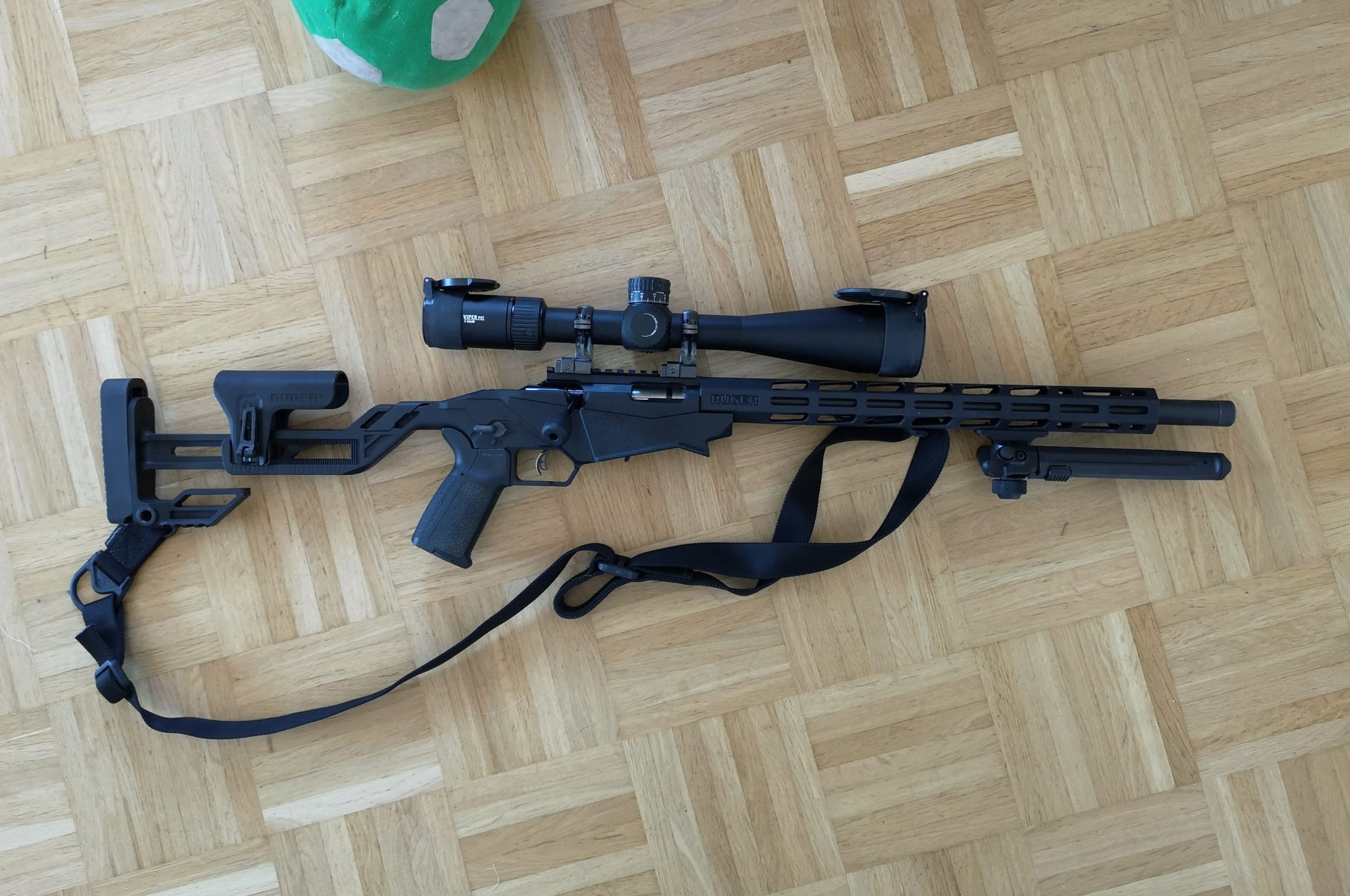

This is my first rimfire rifle, RPRR. The choice was between this and the Tikka T1X, and because of the adjustability and relatively low price point I ended up purchasing the Ruger. Some of the features and problems have since made me doubt my decision, but so far I'm still relatively happy with the choice.
Seems my RPRR sometimes suffers from bad ejection. I uploaded a couple of videos to youtube if you have any ideas how to maybe go about fixing this problem: slow-mo #1 and slow-mo #2. Looks like either the spring holding the shell is too weak and/or the extractor slips.
Also attached a couple of photos of markings on the inside of the chassis, near the stock. These have formed from dissassemly and assembly when sliding the action in and out of chassis. Are these normal? Feels like the back of the action might not be seated on the chassis properly and I'm wondering whether I should shave away some of the material from the walls.
Below a couple of photos of groups from 50 m. I'm not sure how much of this is me, rifle, ammunition or the wind. Overall, I'm satisfied with the potential this rifle offers, but I have no knowledge what is considered good.
CCI Standard shoots OK most times, sometimes the groups get pretty bad.
Lapua Midas+ has so far been the most accurate cartridge I've tested.
Fun gun to shoot and practice long range shooting.

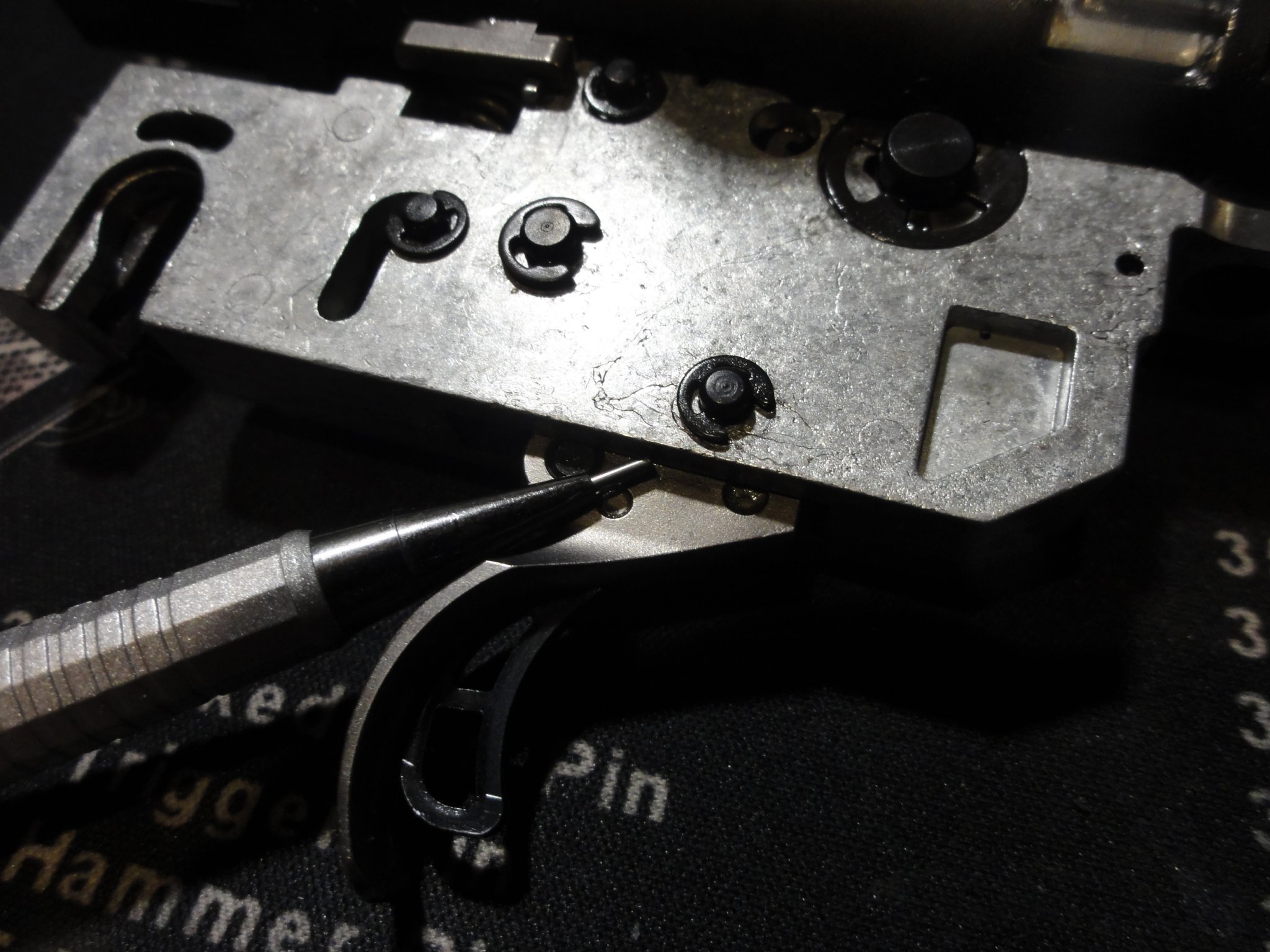

It is so very simple, so simple that you would rather do it than bother with the time it takes to mail it out. You don't need a granite surface plate or anything fancy.... I have a small 8" x 12" plate but that is not what I used. Any granite countertop or glass top table is good enough. I have it stuck to my laptop for this demo. It gave me a 1# trigger with no discernable creep. I absolutely believe that YOU could do it.
My only concern is that you loose the E-clip that holds the trigger pin in place. I got some 1 micron ( 14,000 grit ) lapping film with PSA backing from e-bay and stuck it to a flat surface. All you will need is a strip about 1" x 3". The trigger sear is almost 1/4" square, so if you use soft, gentle strokes, the trigger will maintain it's factory shape and stay square to the world. The edge of the sear that is important is the side next to the pivot though I did the entire top surface as you can see. You want to keep the sear edge to be sharp and not rounded over at all. After I did that, I removed the trigger tension set screw and it's spring completely. I reassembled and had a one pound trigger. I did the same thing with my American bull barrel.

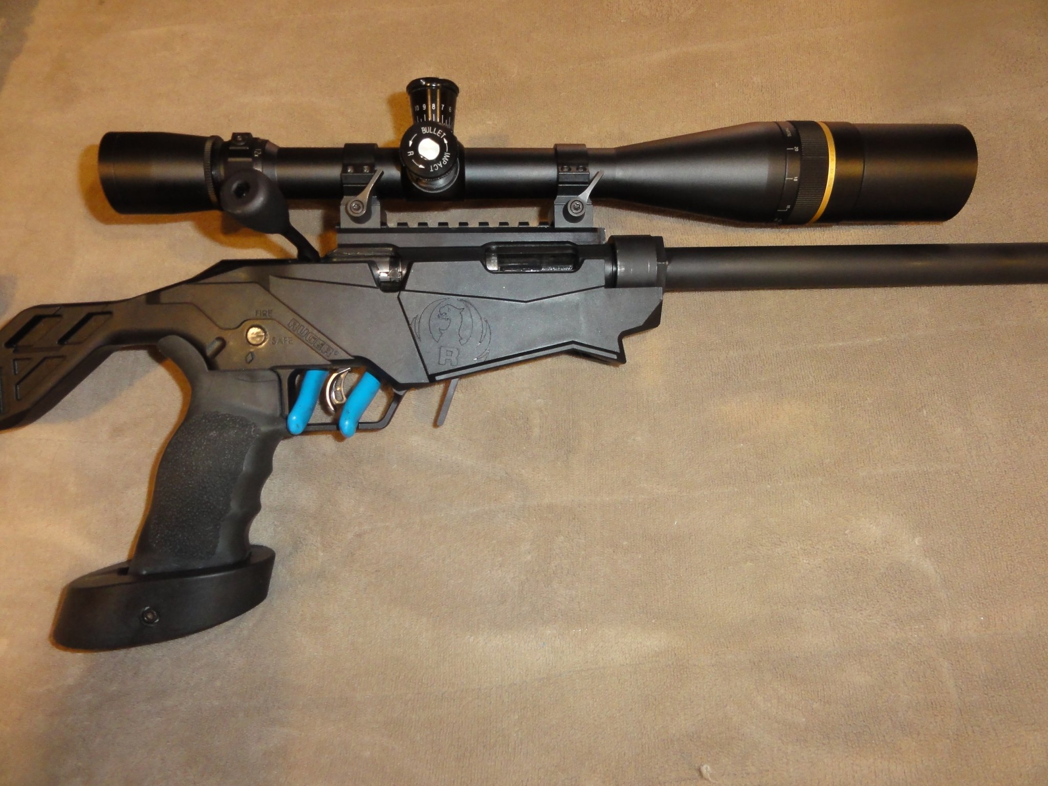

I just got a couple Annie's with the 5098 triggers..... pricey but like any really quality item, you can hand them down to your
children.

Addition to trigger fix........ If you loose your trigger E-clip, go to McMaster Carr and do a search for # 94981A120. That will get you to some S.S. E-clips for
just under 7.81$ for 25 qty. If you want high carbon black # 99620A525 for 100 qty. 7.81$ When you get your lapping film, don't forget to get the PSA backing. ( Pressure Sensitive Adhesive )
