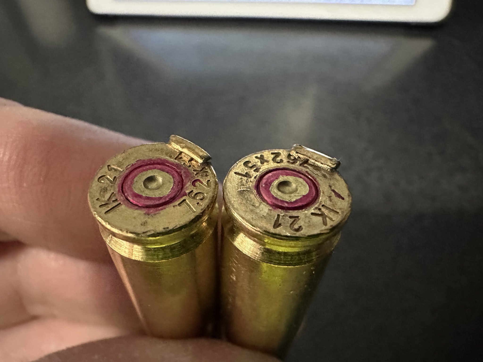

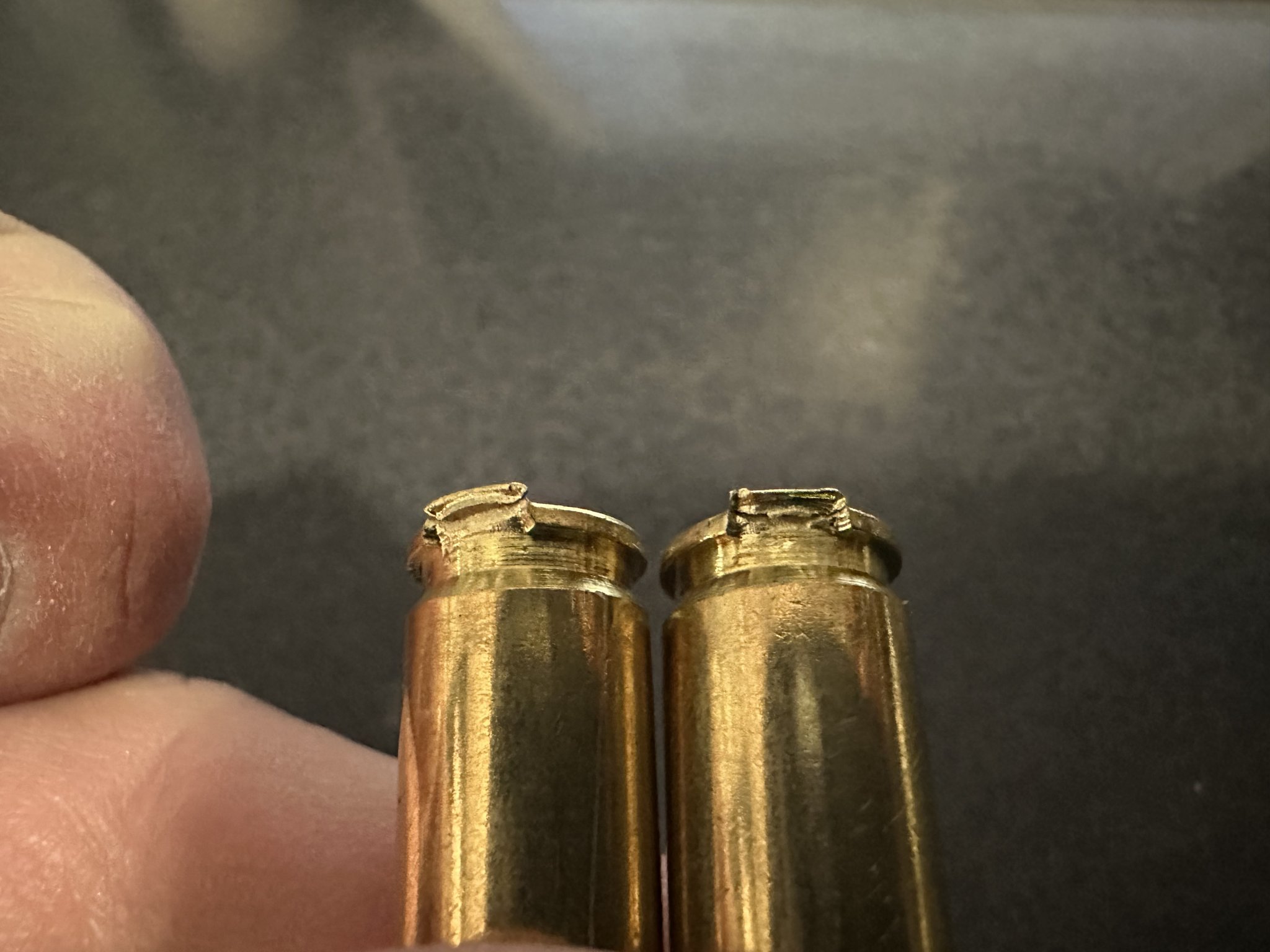

Ran 130 rounds through it today. Just pounded out the first 75 of ball ammo on gas setting 3. Ball accuracy was pretty horrendous. Had 2 stuck cases. Scrubbed the bore and moved on to handloads. First group with 168hpbts was about an inch and a half with 4 touching in an inch. Ran 175bthps and then some 168amaxes and some 125ssts. All the groups were pretty similar. 3 or 4 touching throwing the fliers in a vertical string. Shot a 10 round group that had 7 in an inch with 3 fliers.
Cases weren't too chewed up from the ejectors. Didnt look bad at all. Gas system didn't display any horrible issues. Seemed a little under gassed on setting 1 with the suppressor. Setting 2 ran fine unsuppressed. The regulator adjustment is very stiff now, dont know what's up with that.

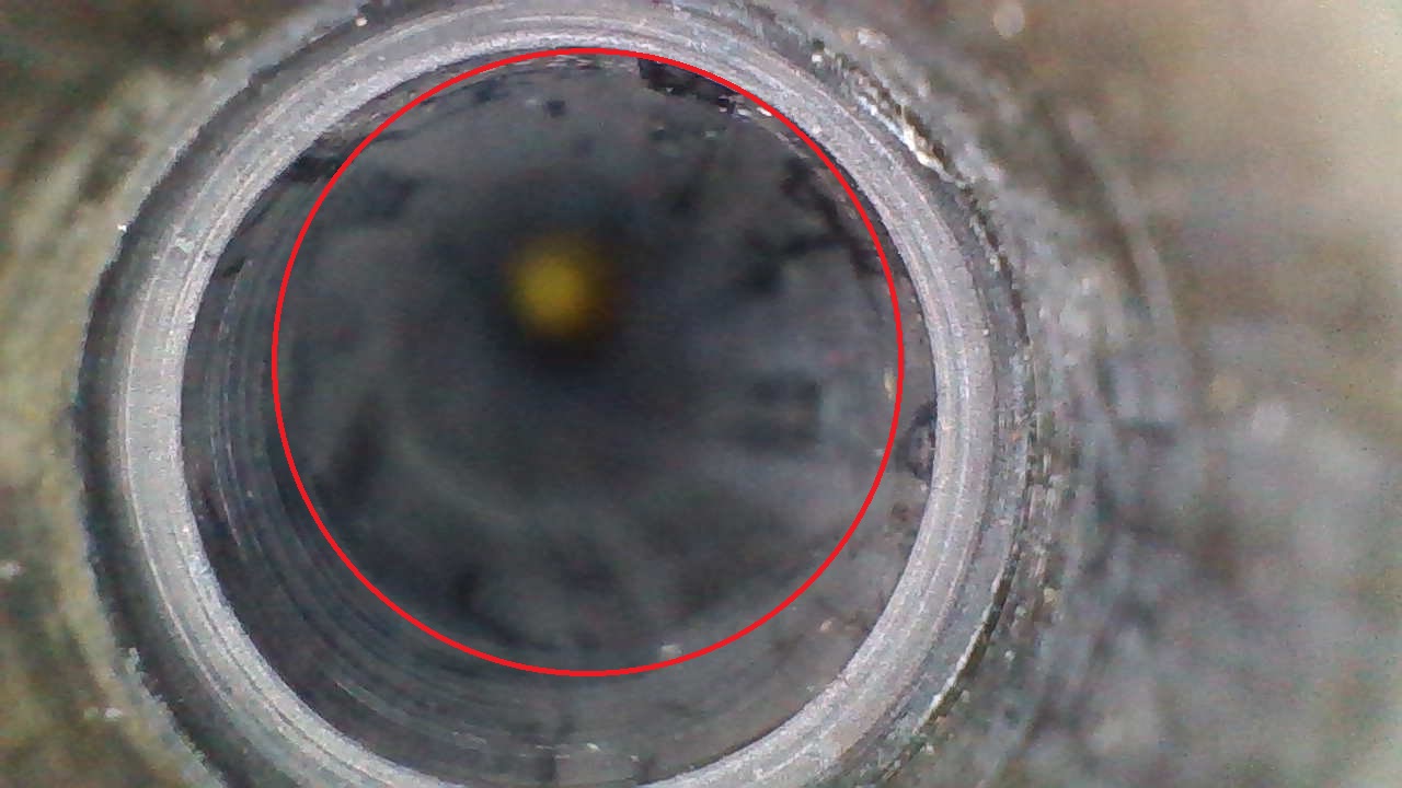

Just brushed the barrel out and scoped it. Today's shooting didnt do much to the ring in the barrel. The chamber looks like it was cut with a rusty pinecone. Planning on giving the chamber a polish and keep shooting it.
Overall pretty happy. Accuracy was maybe better than expected and shows promise. None of the horrible issues people on youtube had raised their heads. Will probably run a few hundred more rounds through it before standardizing on a load and tuning it for that.

Picked up a SFAR couple of months ago and life has prevented me from shooting it yet. Decided to throw my borescope in it and see how it looked. So the good...the rifling looks great. no burrs in the tube that I see. Gas port is also beautiful and perfectly centered. And the bad...the thing looks like it was chambered with a paddle bit. Lots of nasty gouges and off axis. One land starts right after the neck and the rest are an oval pattern from there.
Guess I will still try shooting it but I am predicting it will take a trip back to Ruger for a new boom stick...

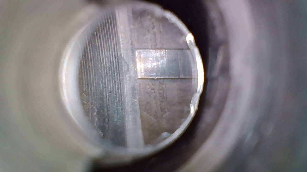

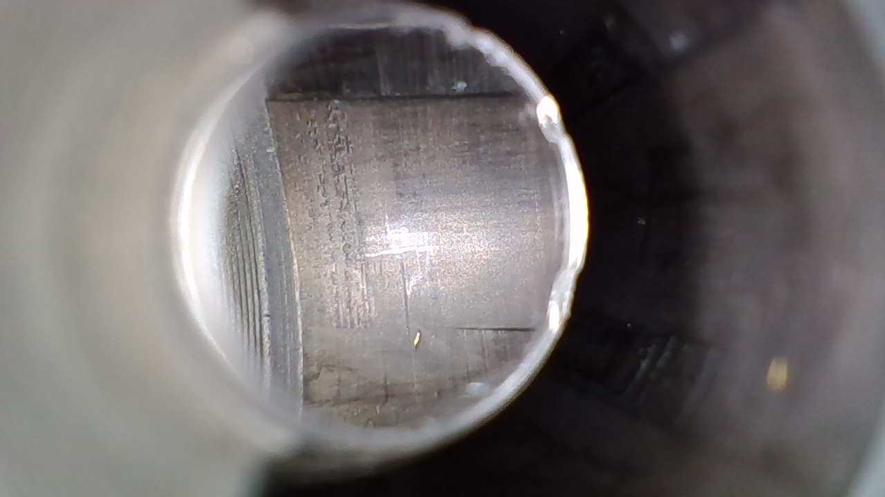

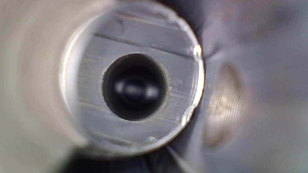

I should have looked closer at the freebore of mine. I just saw how chattered up it was and laughed. For clarification, I remember it was very chattered on one side and not the other. It was not symmetrical.
Reactions: doubloon
When I bore scoped my unfired 20" SFAR the throat was non concentric but the chamber was smooth. However it was accurate enough with groups from .75 to 1.5 moa. Given the fact that it's a 308 AR without a heavy barrel the accuracy is acceptable . Mine cycles fine at 2 with almost any load. I'm trying some service rifle loads from the Hornady manual for range shooting. They give the best accuracy with reduced blast and recoil.

I didnt look too closely at the chamber the first time I scoped it so I wouldn't have any preconceptions about its abilities. The fired brass all has shiny rings around them. That added to the stuck cases that had the rims ripped off and had to be tapped out with a cleaning rod makes me think that tuning the gas system by the ejection pattern is pointless.

I had the same problem. I had to tap the plug out with a brass punch. The plug grooves had some compacted brass/copper particles stuck in them. Scraped it out and it works fine now.
Pulled the regulator while I had the gasblock off, the equivalent of glitter poured out of it. The gas block journal of the barrel was plated in copper/brass. I expected it to be carboned in but not plated. That gap is ridiculous. I wonder if the flakes of brass and copper are caused from the non concentric chamber and throat with the non ramped (squared off with a hard edge) side of the lands.
Polished the chamber while I had the barrel out. Don't know how much it could help since the sides of the chamber look like a threaded bolt hole just before the shoulder. Added .003" of shims to the extension. Barrel seated tighter but still didn't require any heating of the receiver. This is the most shim material I've ever used on a barrel extension.
We'll see if things get better tomorrow. May toss the H2 buffer in to see how it runs.
Have you inspected the case mouths on the spent shells? Are they chipped up?
I had brass chips all over my BCG and chamber lugs but I don't recall seeing any inside the regulator.
I just checked the last 40 cases fired through my 20" SFAR. There are some small divots at the mouths but not bad for an AR 10 style rifle. The brass looks pretty good for being run through a 308 semi-auto. I now regularly check for free movement of the gas plug. I've had no problems since I freed it. Mine does sprinkle very small brass chips around the extension and bolt area but seems within a normal range for an AR. I am shooting fairly mild "service rifle" loads lately which probably helps keep the brass from being roughed up much.
Reactions: doubloon
I would think any brass chips outside of the chamber were coming from the ejector holes on the bolt shaving them.
