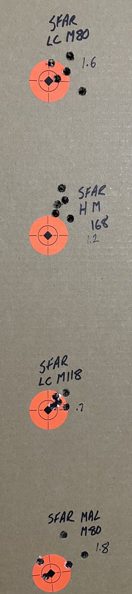

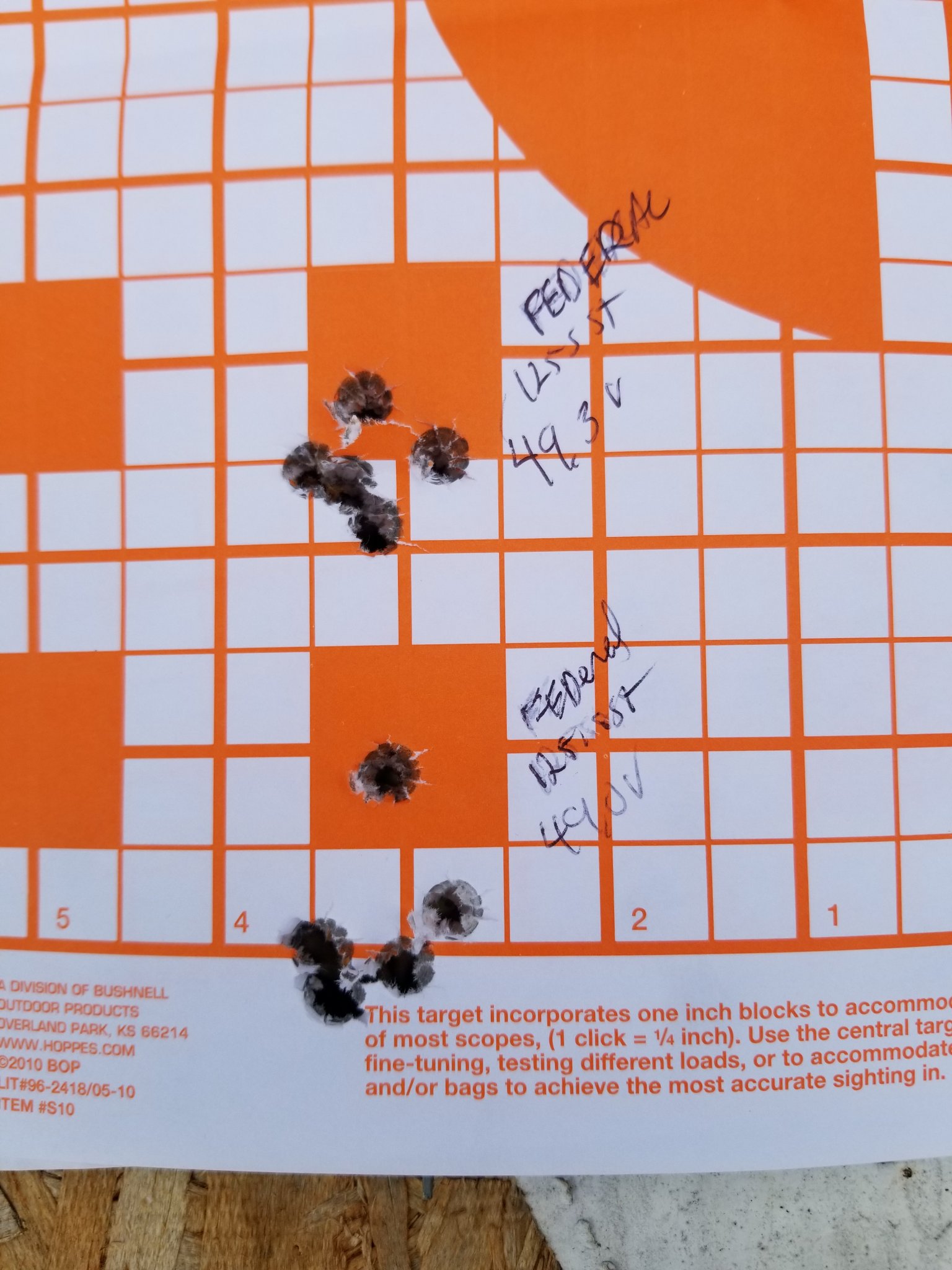

Took 3 of my .308’s out today to do an ammo comparison, and see what each rifle favors. Today - my unmodified 20” SFAR favored LC M118 ammo the most. I had zero malfunctions of any kind today - other than a freakin’ bee getting between my face and my glasses as I attempted to squeeze off a round.
Attached is the comparison 5-shot samples.
Lake City M80 Ball 147gr
Hornady ELD Match 168gr
Lake City M118LR 175gr BTHP
Malaysian M80 Ball 147gr
That M118 looks good. Down and left 0.1 mil each and you’re golden.

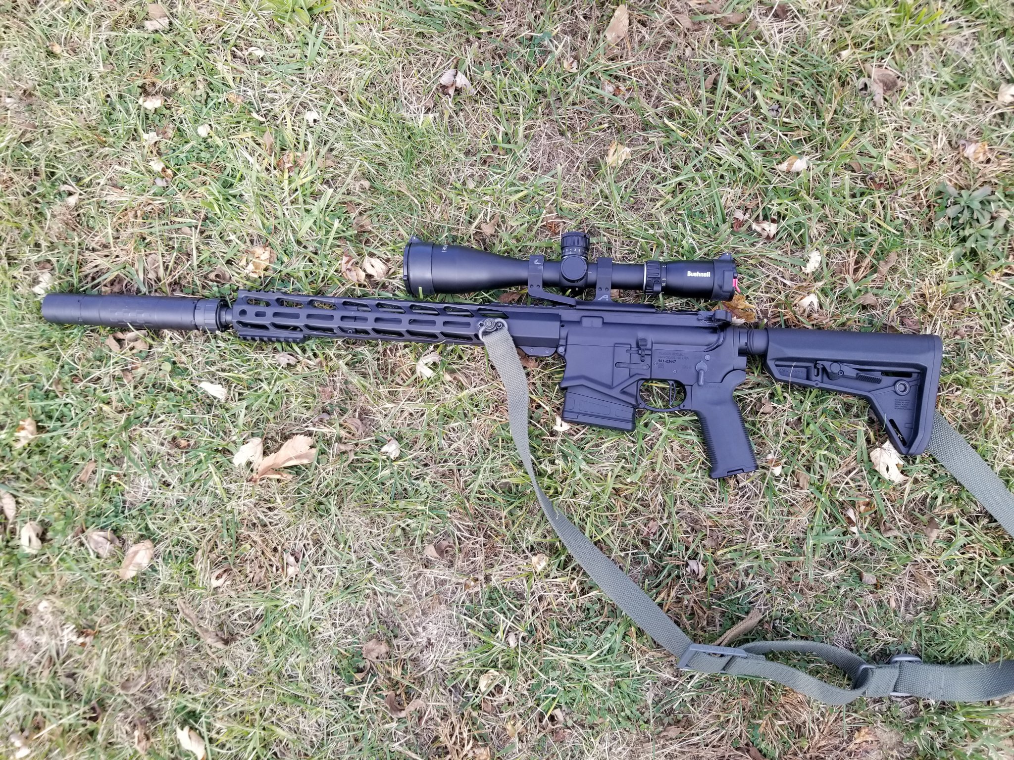

Took a coyote this morning at 300ish.
What suppressors are you guys using? How's the back pressure?
I'm using a yhm 7.62 phantom stainless steel I bought 13 years ago . As far as the sfar goes I am running the gas block on one setting suppressed , No issues with beat up brass or flat primers . since I have the rifles broken in I run everything else from 149 grain ball up through 168 grain on setting 2 . It get's no more dirtier than any other can I own .

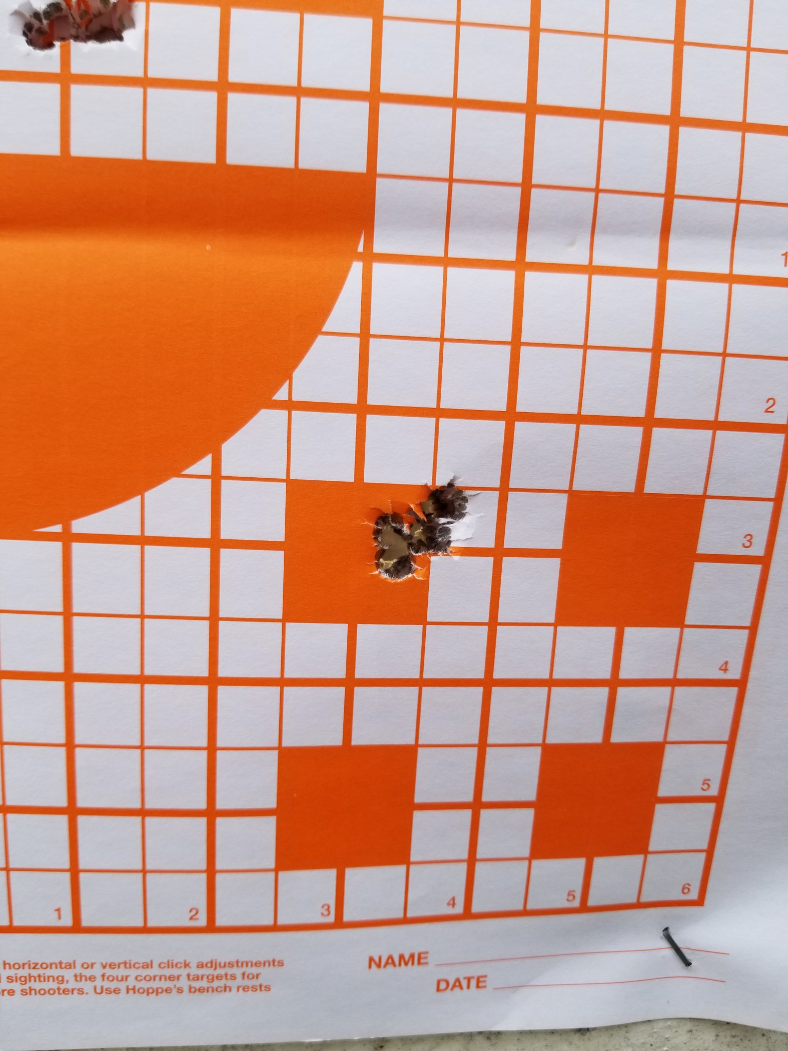

I reshimmed the barrel this week and got it out to check accuracy. This is a 4 round group since I used the first round to make sure it was on paper. Also after tearing the rifle apart to shim the barrel and removing the scope, poa was off 1 inch to the right and half inch high.
Also sent this pic to my larue slut buddy captioned "My SFAR thinks your OBR is a fat bitch".
Nice shooting. What size shim stock did you use?
Reactions: Bendigo78
The first time I had two .002" half pieces. This time i could only get one .002 half in there. I think there was some residual loctite green in there. You cant wrap the entire extension because of the vent ports. Put more loctite green in.
ETA tried to thermal fit a top .001 piece in but it was too tight.

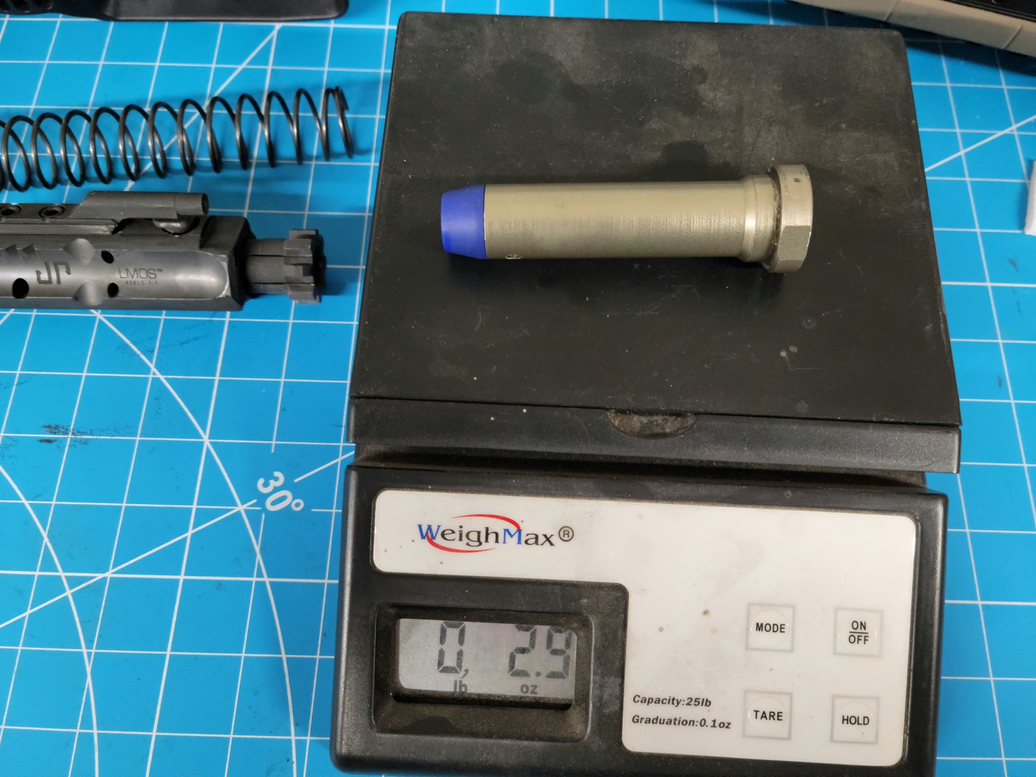

If he tried lowering the buffer weight
The buffer in my factory SFAR clocks in at 2.9oz, standard carbine. I'm actually thinking about going heavier since the LR-308 buffer is somewhere around 3.8oz.
The spring in my SFAR is heavier than either the LR-308 spring or a standard AR-15 rifle spring and longer than both. I'm also thinking about swapping in the LR and AR springs with the heavier buffer.

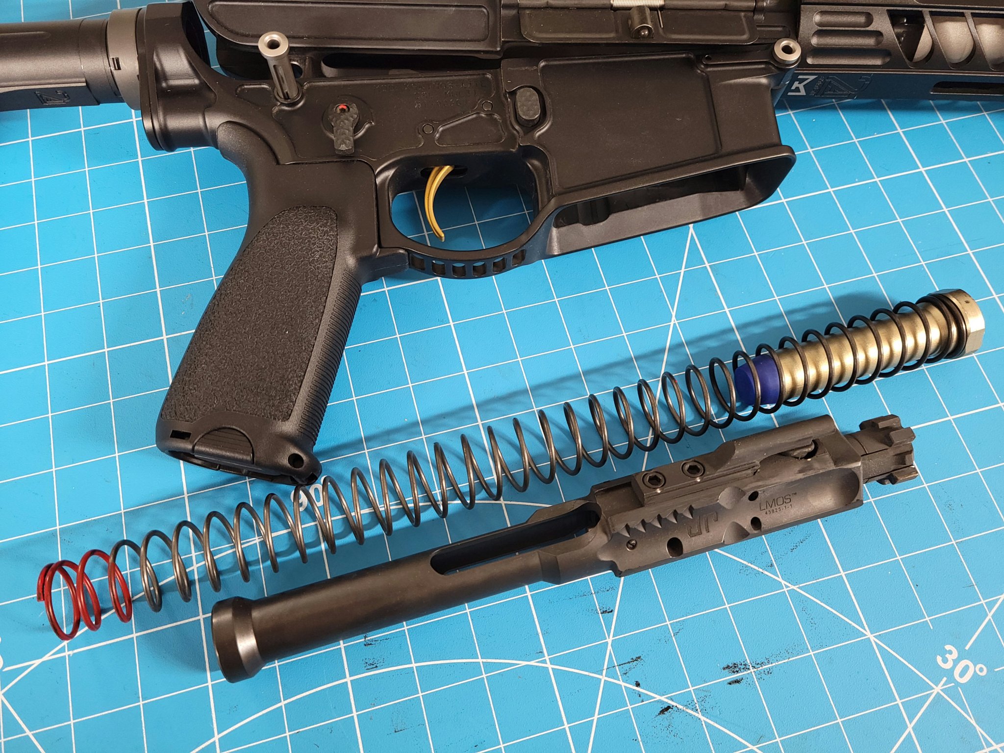

If you don't mind sharing the details, what is your 7lb LFAR configuration?
Low Mass JP BCG.
Carbine weight buffer
SprinCo Red spring
Adjustable gas block.
