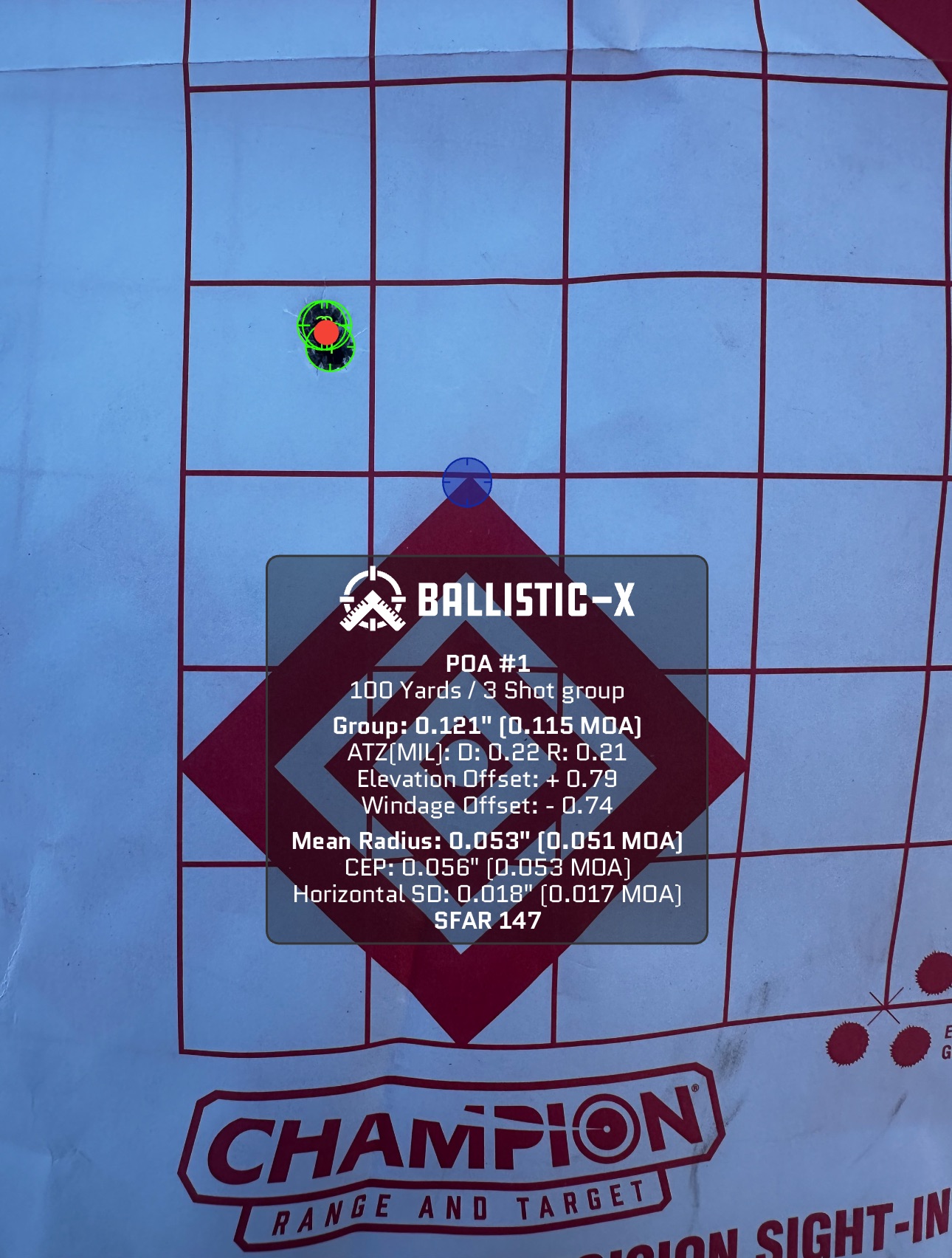

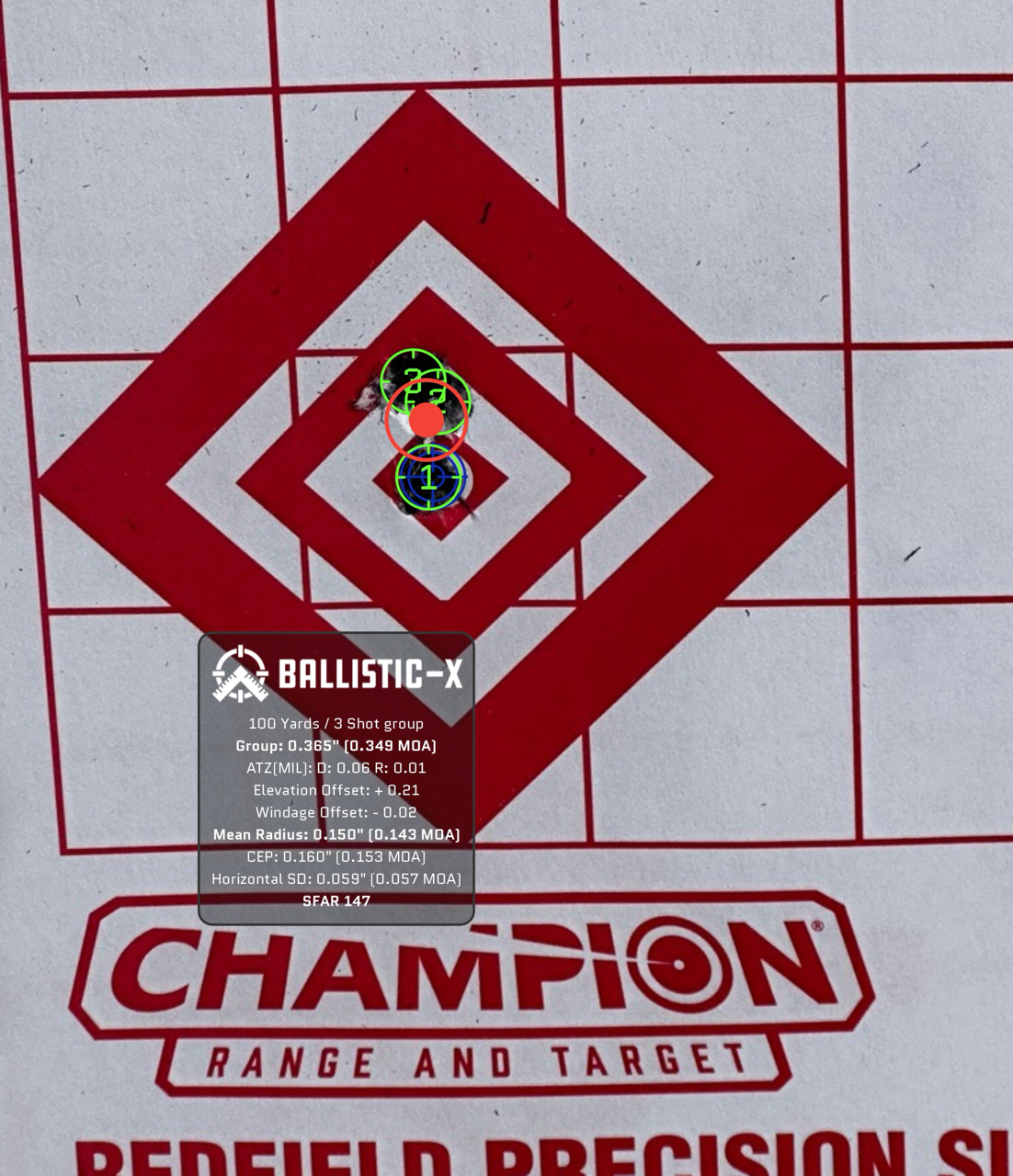

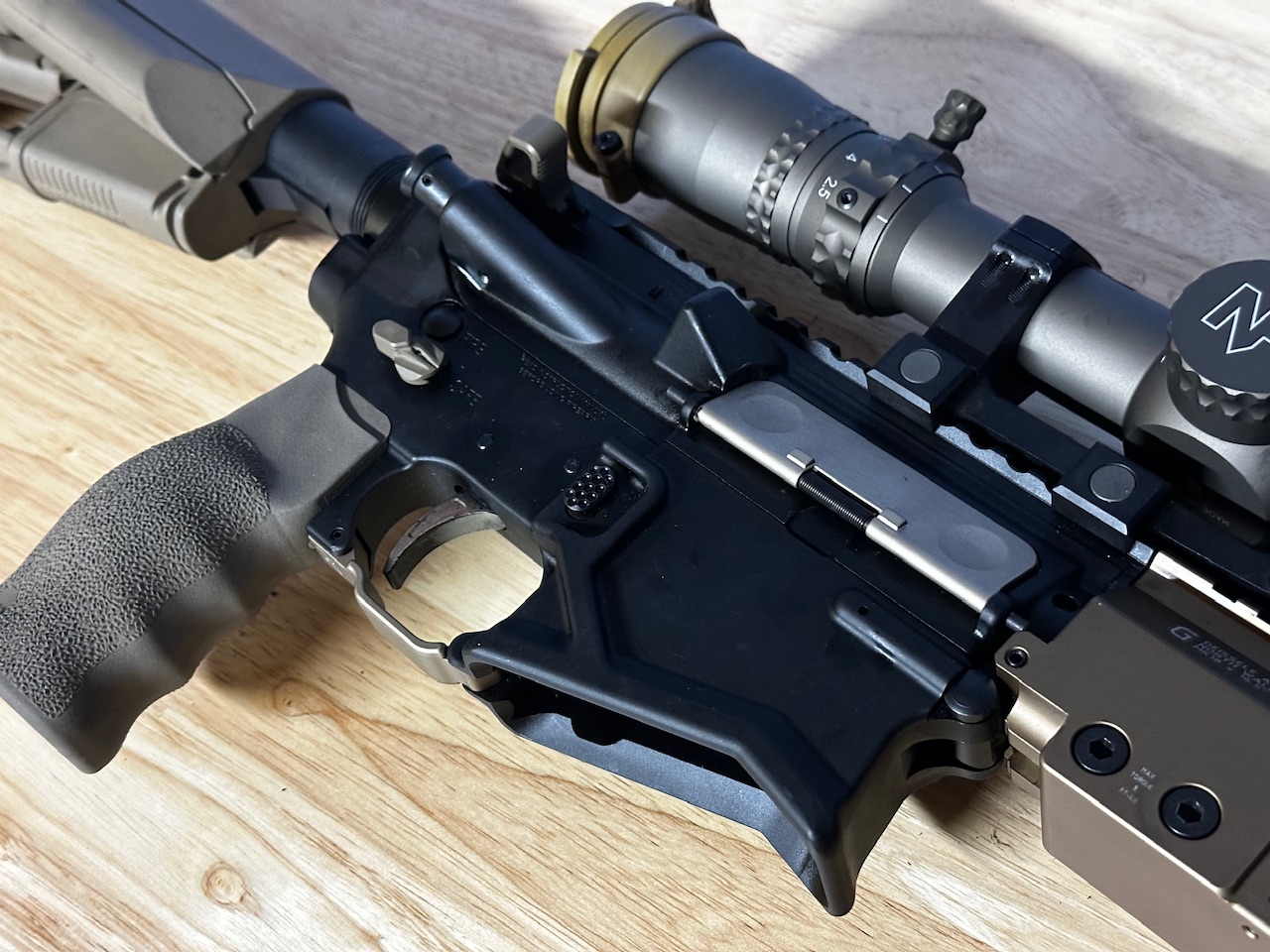

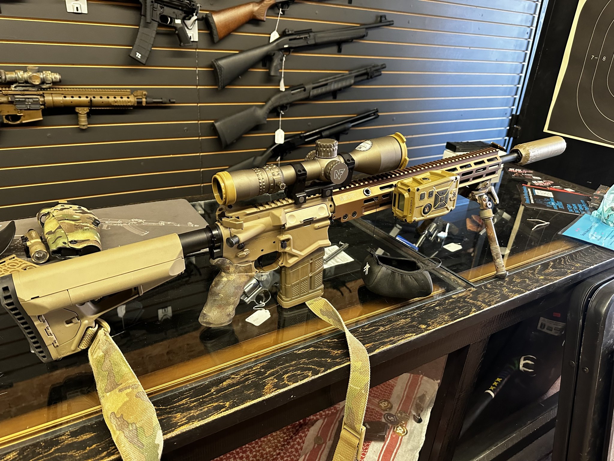

Ruger SFAR in 27 RPR
Reactions: Uhlan and LRRPF52
That’s great, would you mind giving a recap of what mods you’ve done to get it functioning so well?
Cerakote
Larue Trigger
FCD parts across the board
Adjustable gas
HuxWrx Flow 7.62 can
Polished the contact surfaces on the BCG heavily
POF Rogue buffer tube
Geissele MK18 rail
H2 buffer
Shimmed barrel

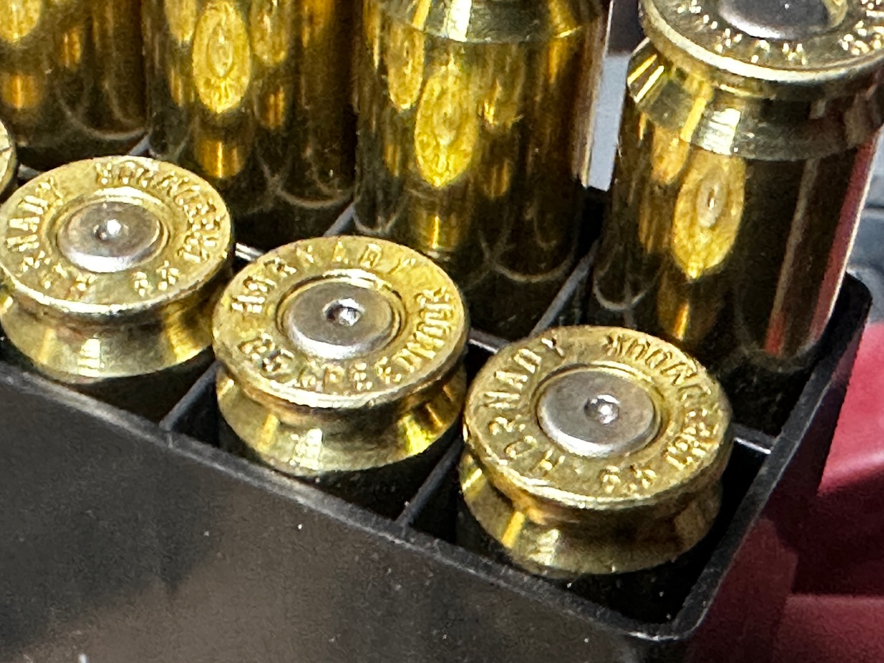

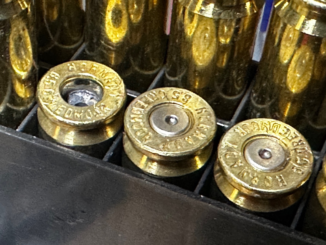

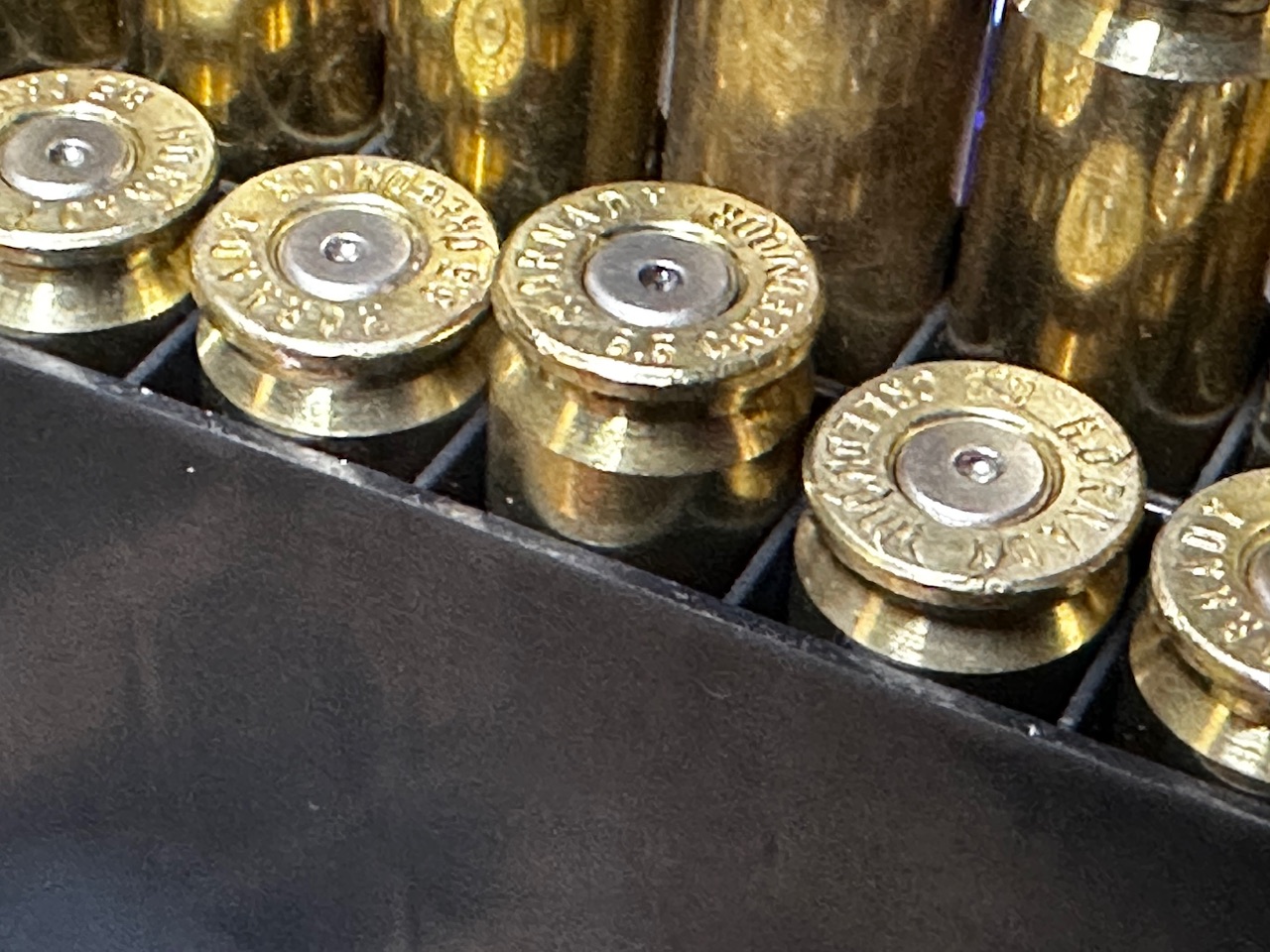

So i'm now having blown primer issues - bad. And the dang thing is clean as a whistle. 147 factory ammo blowing primers after about 5 rounds.
It wasn't doing this and just started - I wonder whats going on. I have an H3 in it right now.
If different ammo doesn't blow primers then there you go.
If ALL ammo is blowing primers then it's pita time.
It’s only ever been Hornady 147s. This is pretty odd.
I have adjustable gas and an h3. And a Huxwrx flow. It’s blowing primers every 4th or 5th round.
Bore is squeaky clean, no carbon ring or anything. Gonna check headspace right now.
Headspace is fine. Baffling. Factory spring, h3, Superlative gas, low back pressure can. Factory ammo.
Not even a bit of carbon ring around the neck or anywhere in the chamber?
One completely random thought ...
Can you measure the case stretch from some of the rounds with blown primers and compare it to the stretch from other ammo that isn't blowing primers?
The completely random and unsupported thought here being that maybe the brass on this particular ammo is momentarily welding itself to the inside of the chamber and not properly moving/stretching to keep up with the unlock leaving the base/primer momentarily unsupported.

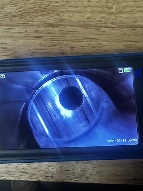

Looking in the chamber with a bore scope, I suspect the issue is that I managed to get through Rugers “break in” period and now the gun runs smooth and low friction….which allows the bolt to unlock too early now that it isn’t fighting Rugers bargain basement surface finishes.
Alright. So i’ll post pics tomorrow.
I don’t seem to be seeing signs of pressure if the gun has the gas turned off. Primers have mild flatness, no marks of any kind on the brass. Etc.
As I turn the gas up towards “it cycles” I get the beginning of issues.

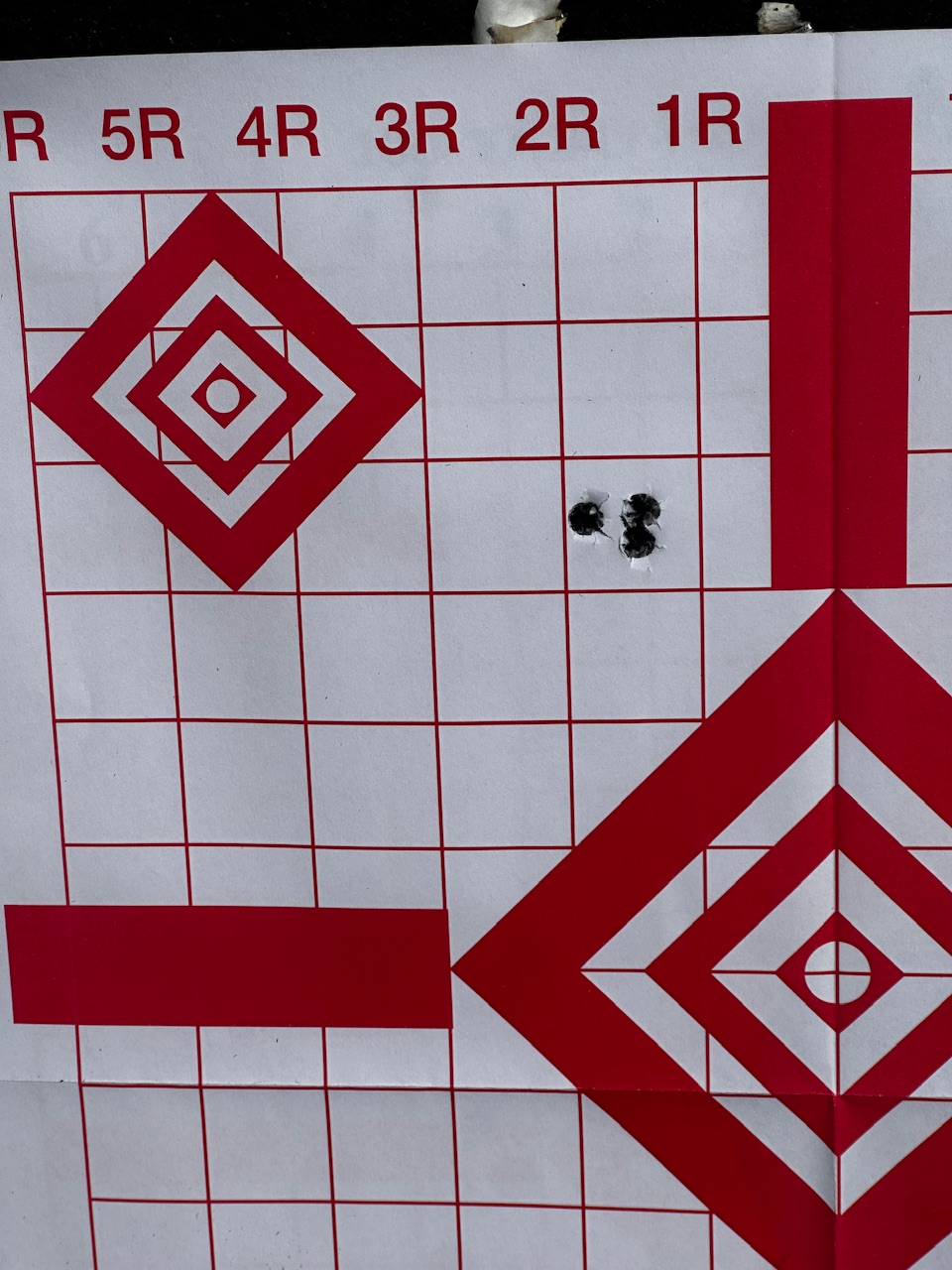

I wouldn't fuck with it and would just toss the barrel...but my factory ruger barrel shoots 3/8" groups regularly.

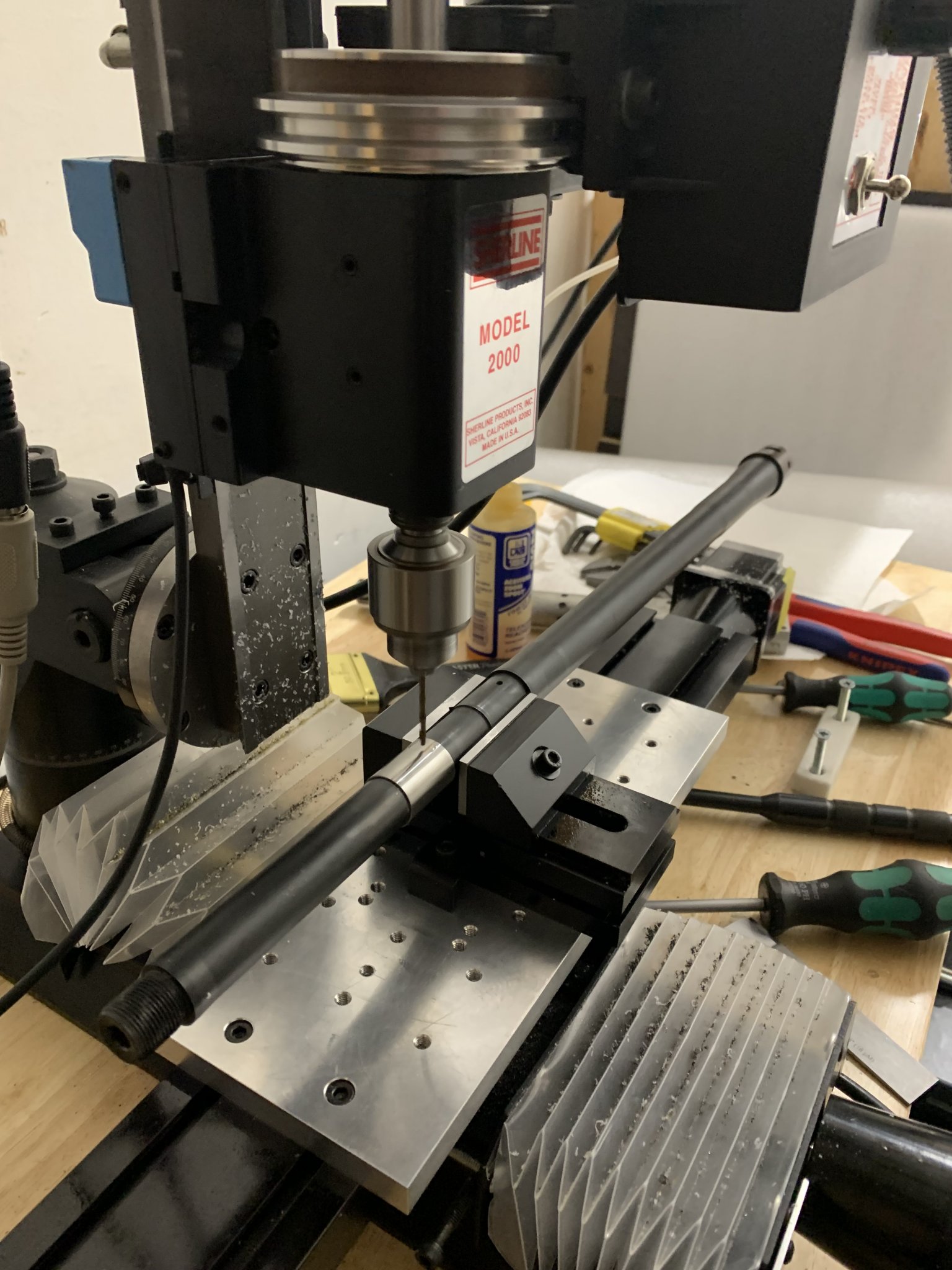

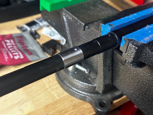

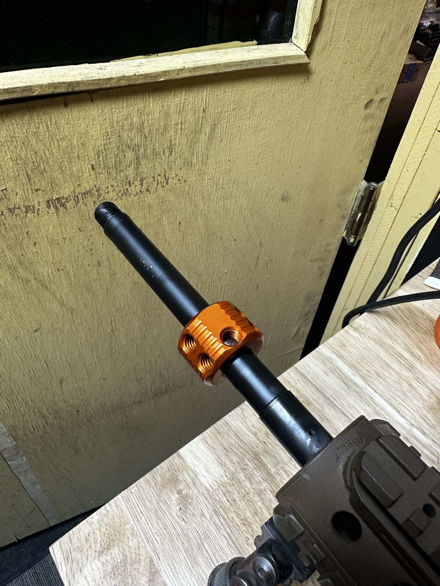

Still blowing primers at random. Main test this week we as to use the blow off part of the gas block to try blowing off pressure instead of restricting. Its a SA block. It told me to F off.
Moving the gas hole to +2 location. seeing what that does. Loctite green and .025 stainless shim stock gluing up right now.
