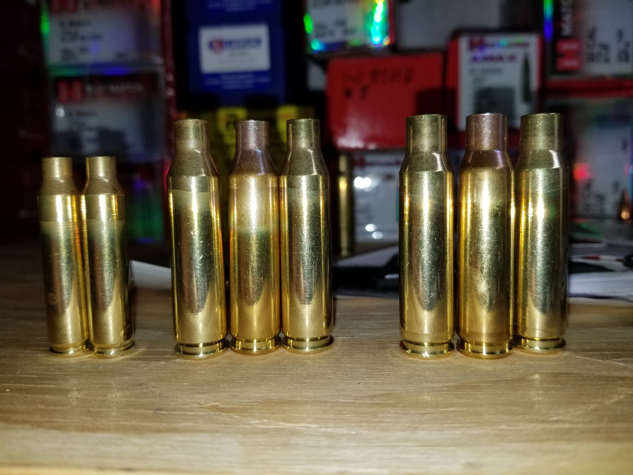

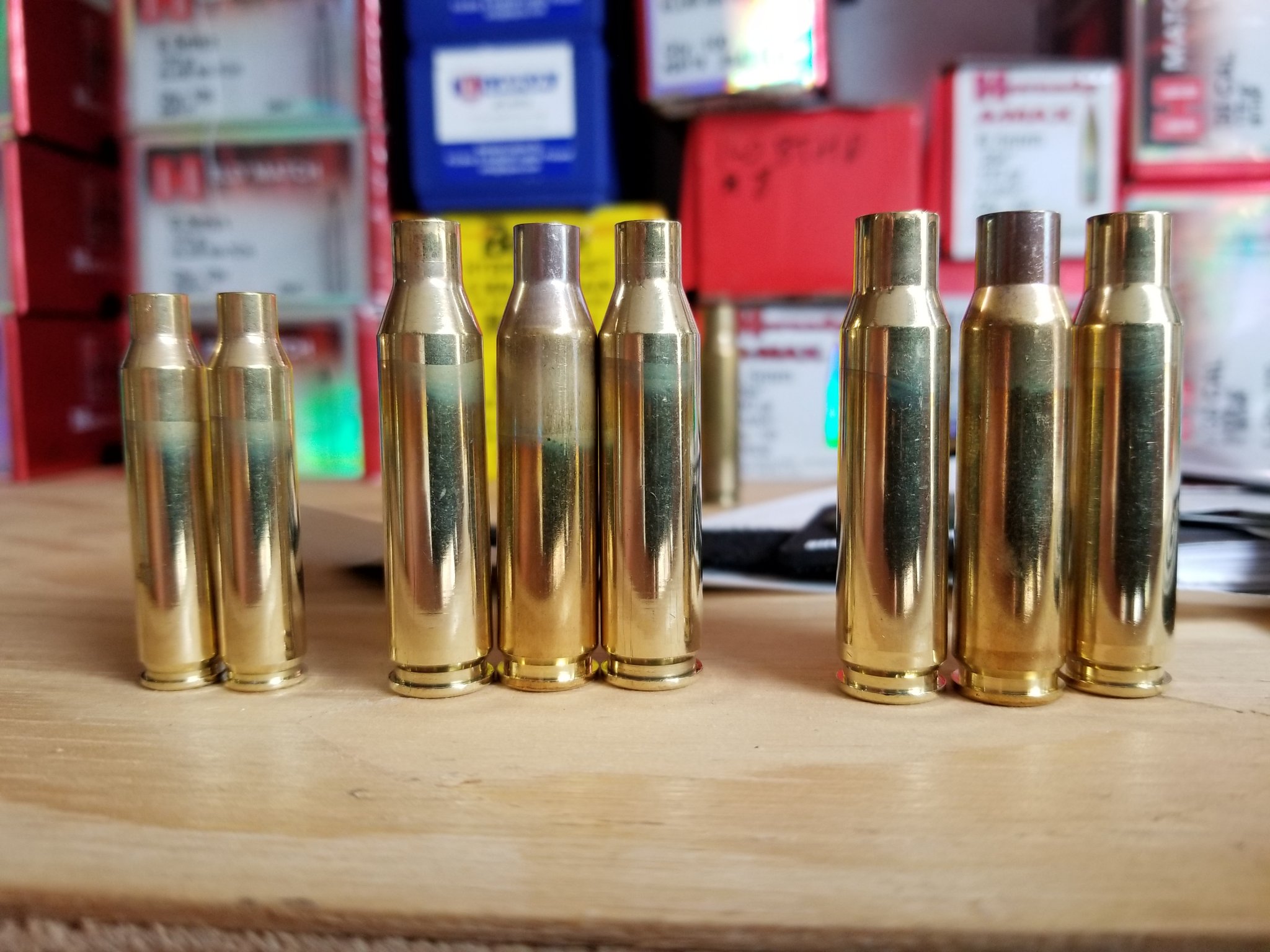

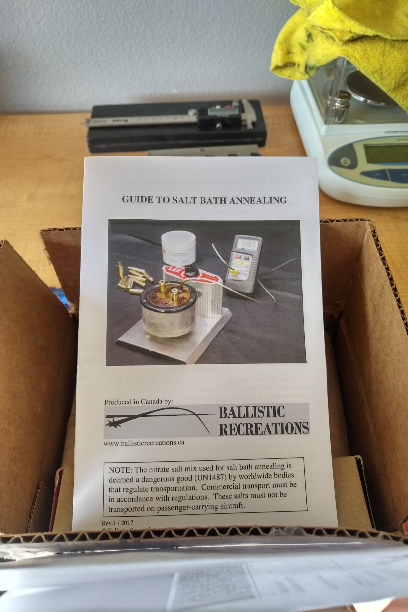

I got the BR salt bath annealing kit today and annealed some brass following the directions provided. Below are some pics of what the annealed brass looks like. The middle ones are factory Lapua 260 and 308. The factory 260 annealing goes down further than my annealed brass and so does the factory 308 but not as much as the 260.
Is it really necessary to anneal all the way to almost half of the body like the factory 260 or the way i annealed is fine? It's the 1st time I'm annealing so any help is appreciated.

To the OP, I also do salt bath annealing. Your cases look exactly like mine and I would feel good that they're not being annealed halfway down the body. If that's occuring with salt bath, you're probably leaving the cases in for too long and letting the heat migrate toward the case head. I typically dip mine for like 5-6 seconds at 500 degrees Celcius.
Appreciate the help guys. Using the slat bath annealing is not as dangeroues as it sounds. Same precautions and common sense that is used when reloading should be applied to this and youll be fine.
Looks good. I need to check and see if I have a spare Lee melting pot. I just got into casting and know I have at least one pot but they are pretty inexpensive especially compared to the other annealers.
Your brass looks fine....
I have the same kit. It works fine, with a couple of caveats;
1. The Lee "temp" controller is very basic/unsophisticated, which leads to temperature undershoot and overshoot when it tries to get back to set temperature because of taking heat out of the bath as part of the annealing process.
2. The Lee reservoir is small enough that with any reasonable cadence of cycling brass through the bath, the salt bath temperature drops pretty rapidly and takes a fairly long time to recover.
What I really like about salt bath annealing is the lack of flame and the fact that you have to work really hard at damaging brass, compared to flame type annealers. Personally, I think molten lava chasing me isn't any more or less attractive than flames chasing me.
I do like salt bath annealing, but the bath recovery time and the fact that you need to wash your brass to remove the salts after processing causes it to consume a lot of time. I'm not likely to ever spend the coin for an AMP, but I am looking at putting together the parts for an induction annealer. The nice thing about induction annealing is there is no cleaning phase after the annealing cycle. I have no issues with manual feed of brass, as I only anneal 50 pieces at a time.
Agreed with above. If you go too fast the temp will drop and you have to wait few mins for it to come back up, and washing the brass afterwards is annoying. I do ultrasonic cleaning after resizing the brass already so now I would have to wash/dry the brass twice, once after annealing and once more after resize. I might just tumble after resize now instead of washing it a second time.
Good part is that its pretty cheap to get into. The kit + extra salt was $121 with shipping and Lee was $32, and from what it sounds like people are happy with the results. Even if I stop using it I'm going to be out only $150. I stopped counting the $$ I have spent on crap I don't use a long time ago.

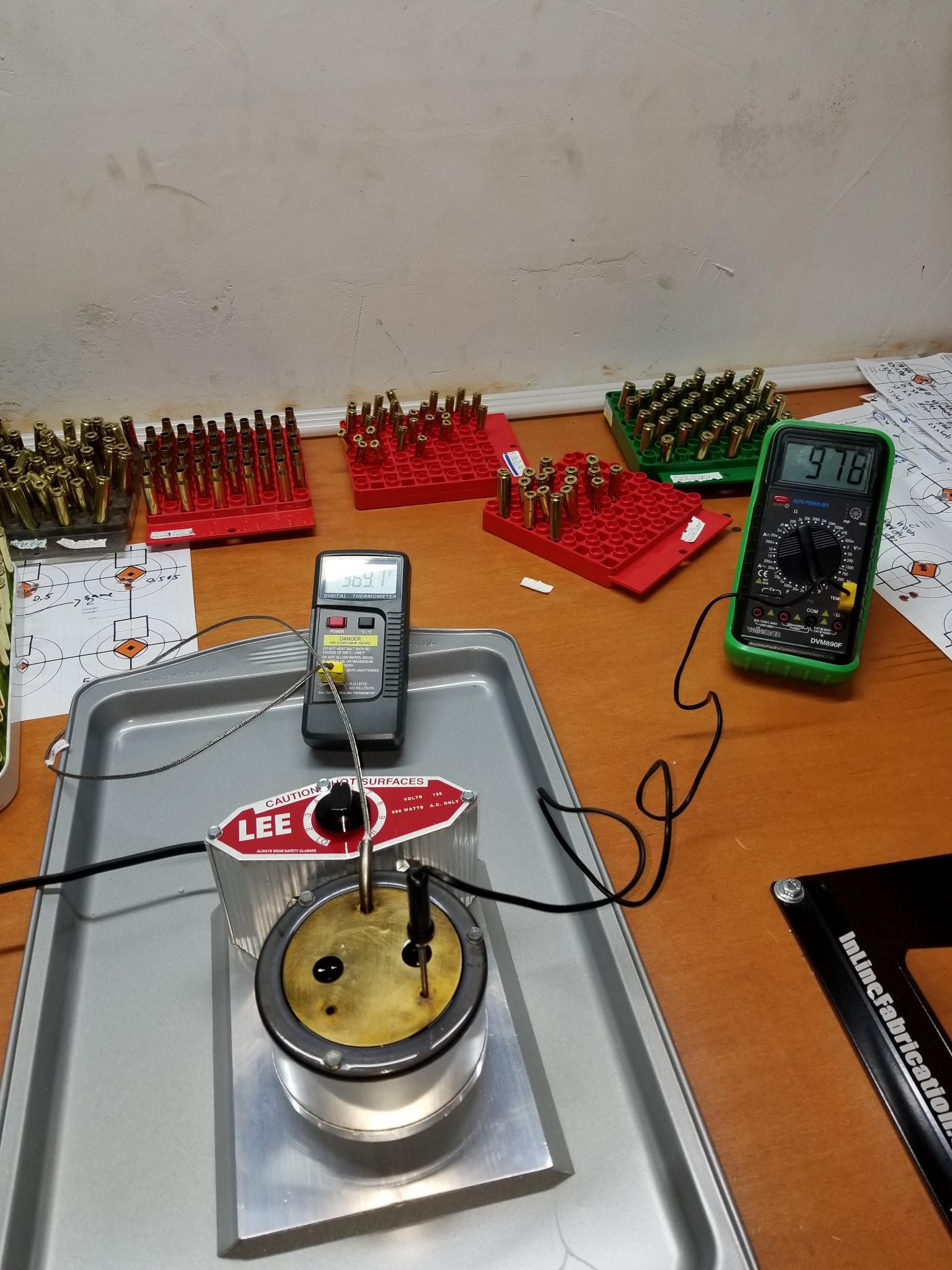

How do you know you're heating it to the proper temperature? You can't use Tempilaq can you? And you can't see the metal begin to glow in that "bath", right?
One thing I know for sure is trying to tell if it's done properly by looking at brass coloration is a fool's errand. The discoloration is completely unreliable for determining annealing because it has to do with oxidation not temperature.
I would be seriously worried about over-annealing with that setup.
And I've heard absolute horror stories about getting water in that stuff and other problems. Like Mt. Vesuvius.

How are you going to over heat it when I can only go up to 900 or so degrees. Anywhere from 4-6 seconds should be just dandy. The exact number doesn’t matter, just so long as you do the all evenly. Test to see if 4, 5 or 6 gives you better results, the brass should range from 650-800 degrees or so which are perfectly fine.
secondofangle2, did you not see the digital thermometer in the picture above? Probably one of the most accurate annealing methods available. You would need to pour water into the the salt pot to create a problem. it's a very easy process and if you can't do this you shouldn't have a loaded gun.
that is patently false because 500 C is about 1000 F degrees and 1000 F degrees is too hot. It takes time, a variable amount of time for a metal of one ambient temperature to heat to a new ambient temperature depending on the mass of the metal. So the final temperature of that metal is anywhere between its starting temperature and the temperature of the bath,, depending on the dwell time, and you don't know that temperature unless you measure *the brass* not the bath.
750 F brass temperature is about just right for annealing it. Too hot and you've overcooked it and made it lose its springiness, too little and you've not annealed it and wasted your time. And any variation means you're variably annealed and I don't like variation.

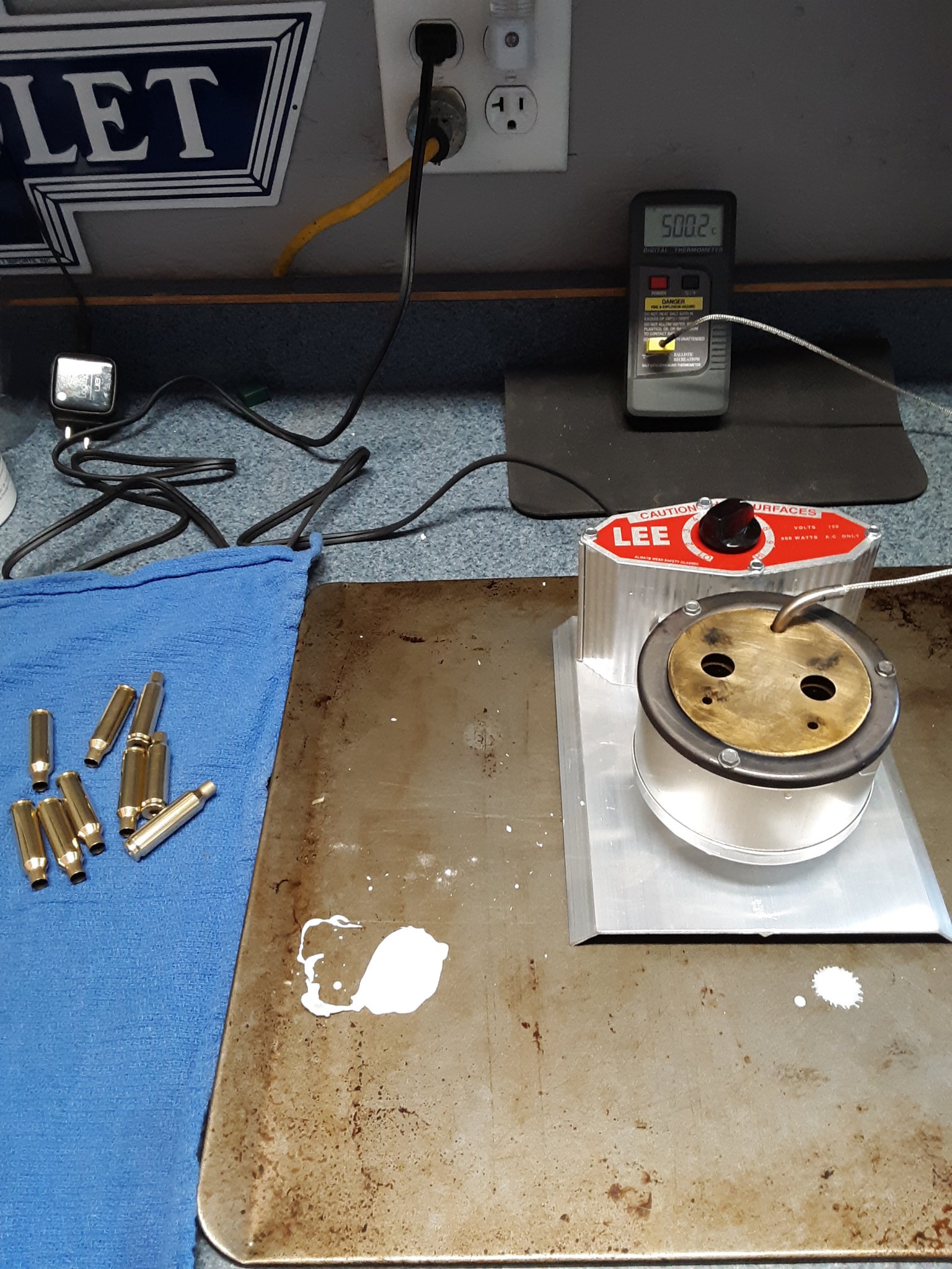

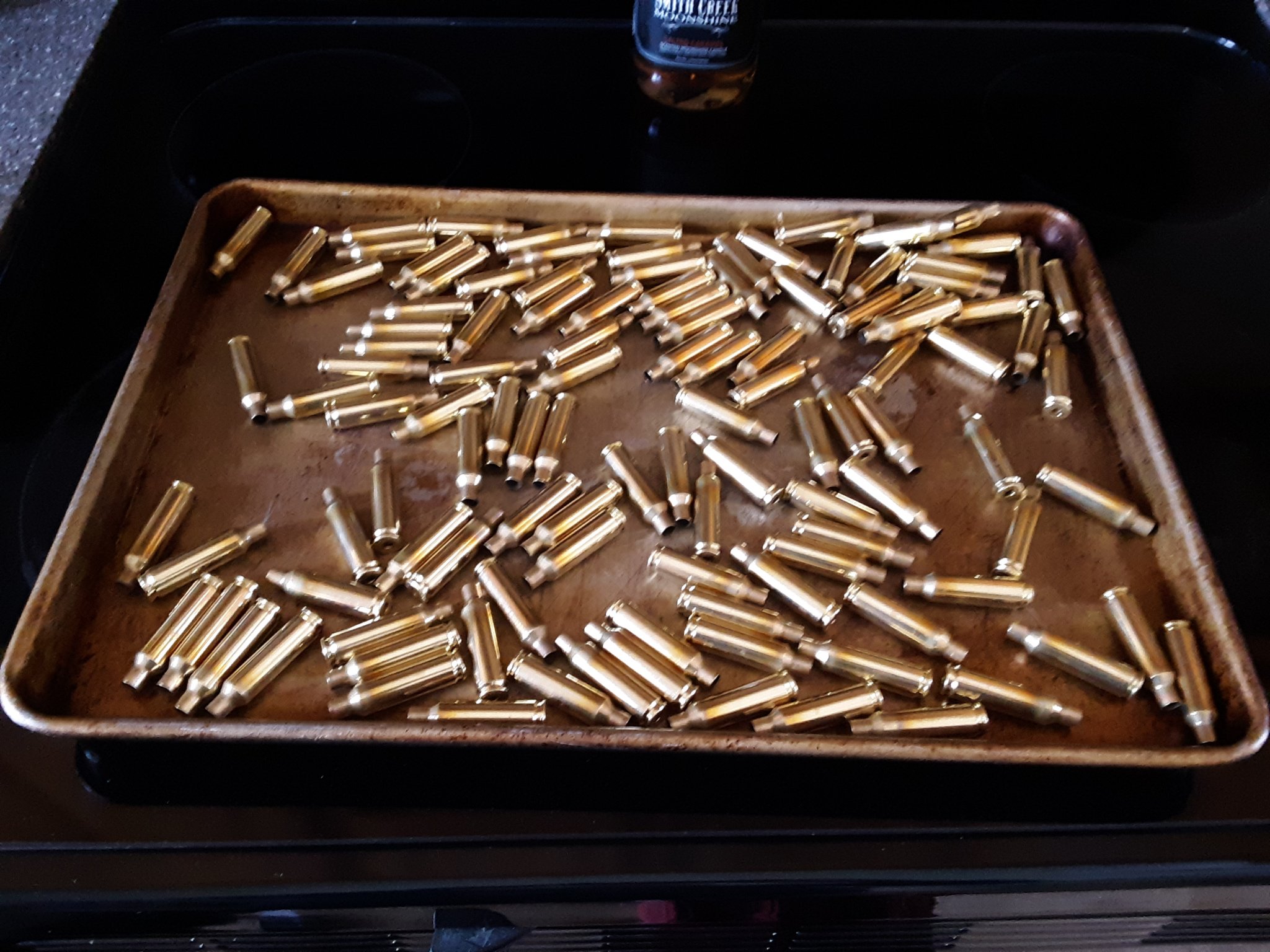

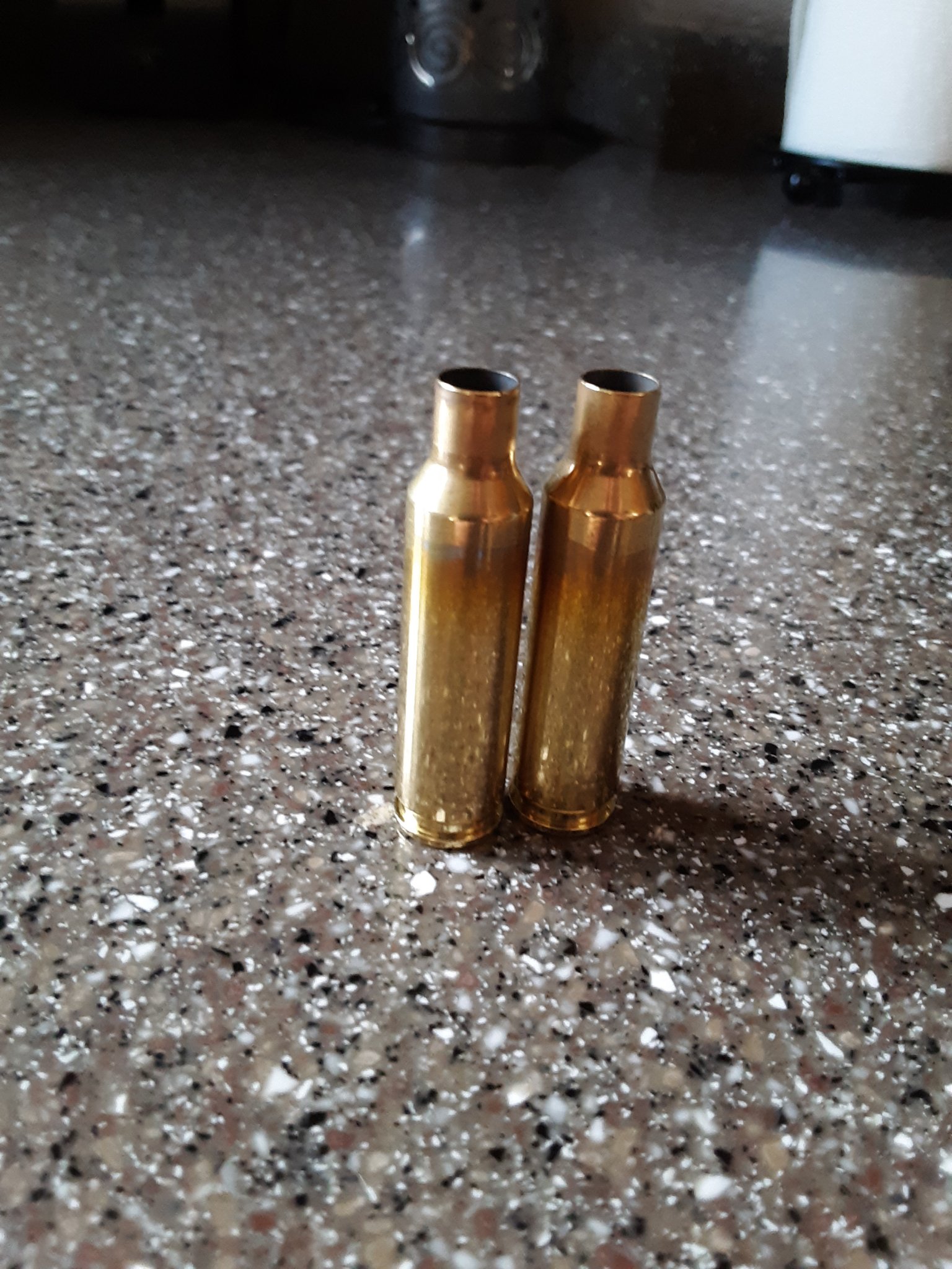

I just did my first batch with that kit the other day. I don't have any other annealing process to personally compare it to, but I think it works pretty slick.
Not counting pot warm up and cleanup, it took me about 20-25 minutes to do 175 6.5 Creed cases. I only waited one time (for a minute or two) for the pot to get back up to temp.
I chucked the cases immediately into a 5-gallon bucket with about 8 inches of water in it. After they were all done, I rinsed them and put them in the oven at 200 degrees for about 25 minutes. They came out completely dry and free of any salt residue. All I saw were water spots here and there. I suppose I could throw them in the vibratory tumbler for a bit to make them perfect, but I'm good with the result.
It takes me one to two teaspoons to replenish what salt was lost for each 100 rounds of .243Win brass annealed. I take out the holder adapter as soon as I'm done, then let the salt cool for an hour and cover loosely with aluminum foil, let it set over night before tipping the pot to remove the salt plug. I store the salt plug in an old cool whip container with tight lid to protect from moisture. Then wipe down and dry the pot. The salt is reusable indefinitely.
