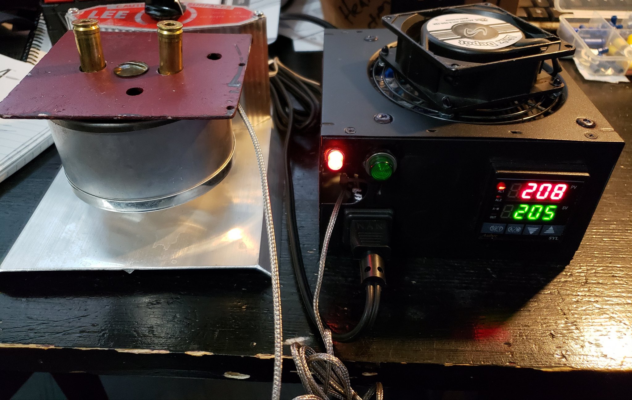

Just finished building my shell holder, PID controller, and doing a test run with boiling water. Still waiting for my salt to arrive in the mail. I'm using brass hardware for the shell holder assembly which is below the steel top plate.

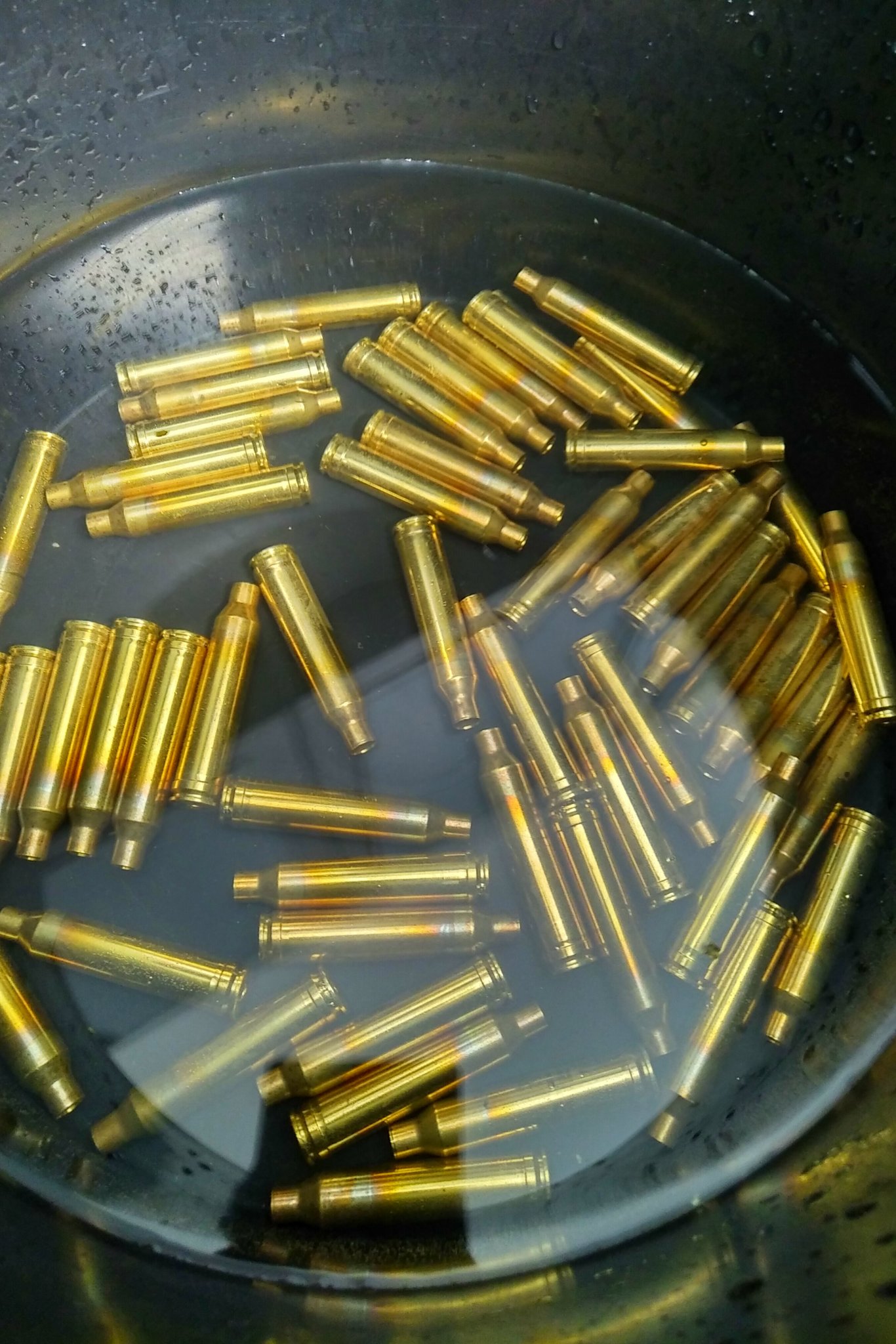

When taking the brass out of the quench bucket, does anyone have a problem with residual salt being left on your brass? I had some show up in my primer pockets. Air dried the brass with the case head up.
I did have that problem also. I accidentally left some cases in the quench water and they are slightly discolored now. Time will tell if there is any structural difference going forward.
