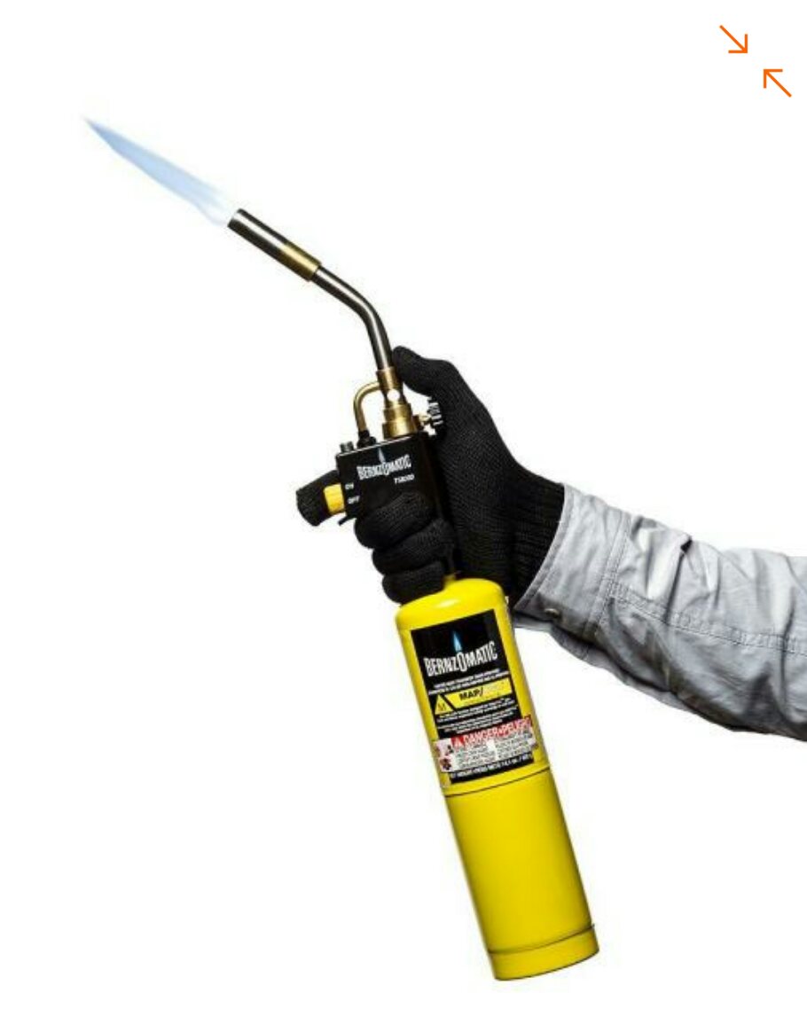

So the questions I'm sure many other common plebs like myself that don't have 1400 to spend on an AMP and are down in the gutters with torches and drill sockets are:
Am I just wasting my time/propane?
Should I spend my money (100 or so is doable for me) on a SBA setup?
WTF is the truth?
@Cerwinski here is my opinion and thought on it.
The torch and drill can work fine, it is just difficult to be consistent from case to case in my opinion but if you are careful I guess it will work. I say I guess because no matter how careful I was I could never seem to keep it consistent and would waste 10 cases just getting set up every time to what I “thought” was the correct heat and dwell time but there are a bunch of people that advocate they get single SD’s from this method, so if you believe those people then the method works.
I have not used SBA but the concept of it seems to lend itself to being more consistent than a torch and drill and possibly anything that uses a torch in my opinion. The reason I say it may be more consistent is due to the fact in my personal opinion it is hard to control exactly how much heat the cases get using a torch. The torch is so hot and even having a case slightly out of position can really affect how much heat gets to the case in a set period of time. With SBA it seems to me it would be much easier to control how much heat actually gets into the case compared to the tour he methods. It still seems like you need to be careful to keep the solution at the proper temperature and not add so much brass that it will drop the temp too far. Like I said have only used the AMP and torch methods so only have experience with SBA based on what I have read. Once again many people claim consistently getting single digit SD’s using this method, so if you believe them this method works too.
So what do we know, all of the methods seem to work based on people’s experience. For me I could not get the torch to work and based on videos and other information I was afraid I would not be able to get the consistency I wanted using something like the Benchsource or Giraud. This was not because they are unable to give you the consistency but because I didn’t have the ability to do it with those tools. The AMP on the other hand is for stupid people like me I guess who cannot make the other methods work to get to single SD’s, the AMP can be consistent for everyone and you do not have to have any ability to get it to work right. This appealed to me because basically it is point and click there is no way you can mess it up.
It comes down to if you can make a method work, I didn’t feel I could so I had to go with the most expensive option but the least finicky option. I don’t like putting my money into the AMP when I know I could save so much using something else but if I was going to anneal it was going to have to be the AMP based on my ability to keep everything consistent and that is the method I chose.

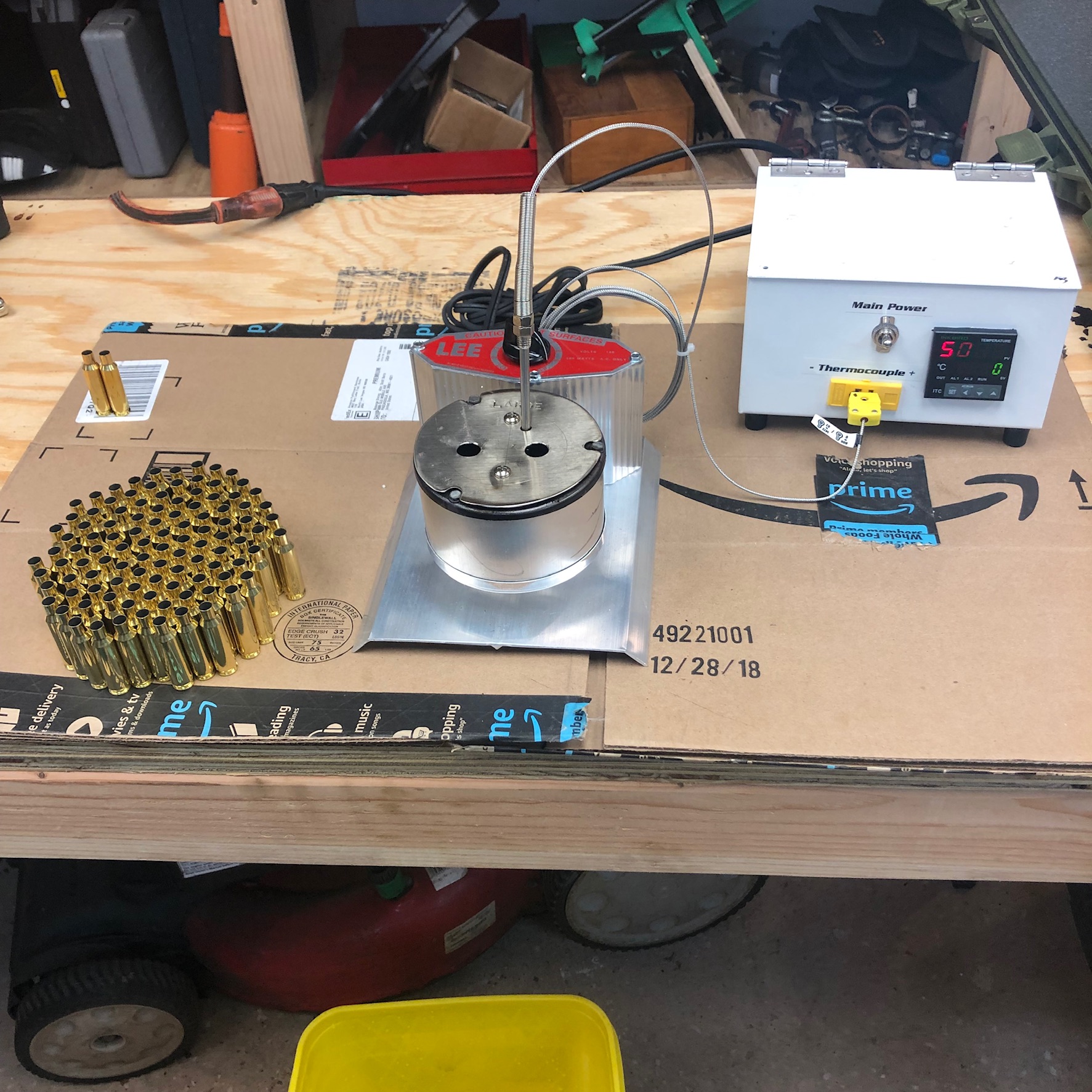

After some research between SBA & Induction annealing the salt and melter needed would be more expensive than what I own , but if an induction unit could be had for no more than $500 that would be interesting, no need for programs/per brass manufacturer and case specifications as that could be worked out by the reloader.

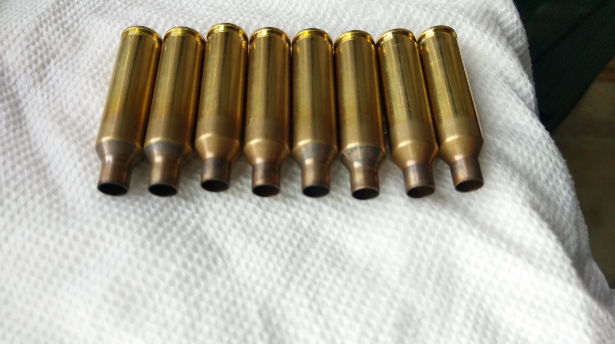

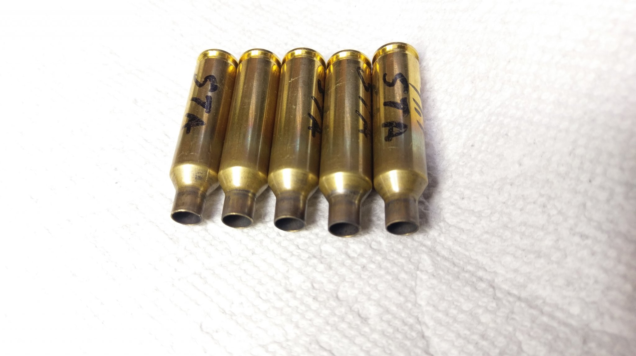

I'm not settled one way or the other yet on the SBA method. My first try didn't give me as good a results as I've had with torch and socket method. SD's for torch and socket in the single digits and high 20's for SBA on 86 pieces of once fired brass. I'm going to try ten at 940F for twelve seconds and ten more for eighteen seconds. It may be a couple of weeks before I can report back on this thread.
Above is same lot lapua brass fired at the same time same load. Starting from the left case 1,2,5,6 are once fired, SBA, FL resized and a mandrel pushed into the neck. Case 3,4,7,8 are virgin with a mandrel pushed into the neck.
You can see that there is soot on the shoulder on the once fired SBA cases where the virgin cases have no shoulder soot.
This leads me to believe that the virgin brass necks are softer than the SBA case necks.
I then grabbed 5 once fired cases that were already processed, they were steel pin tumbled, SBA, FL resized and mandrel pushed into neck and SBA them again. So I basically SBA after sizing. I fired these today, look at the shoulders.

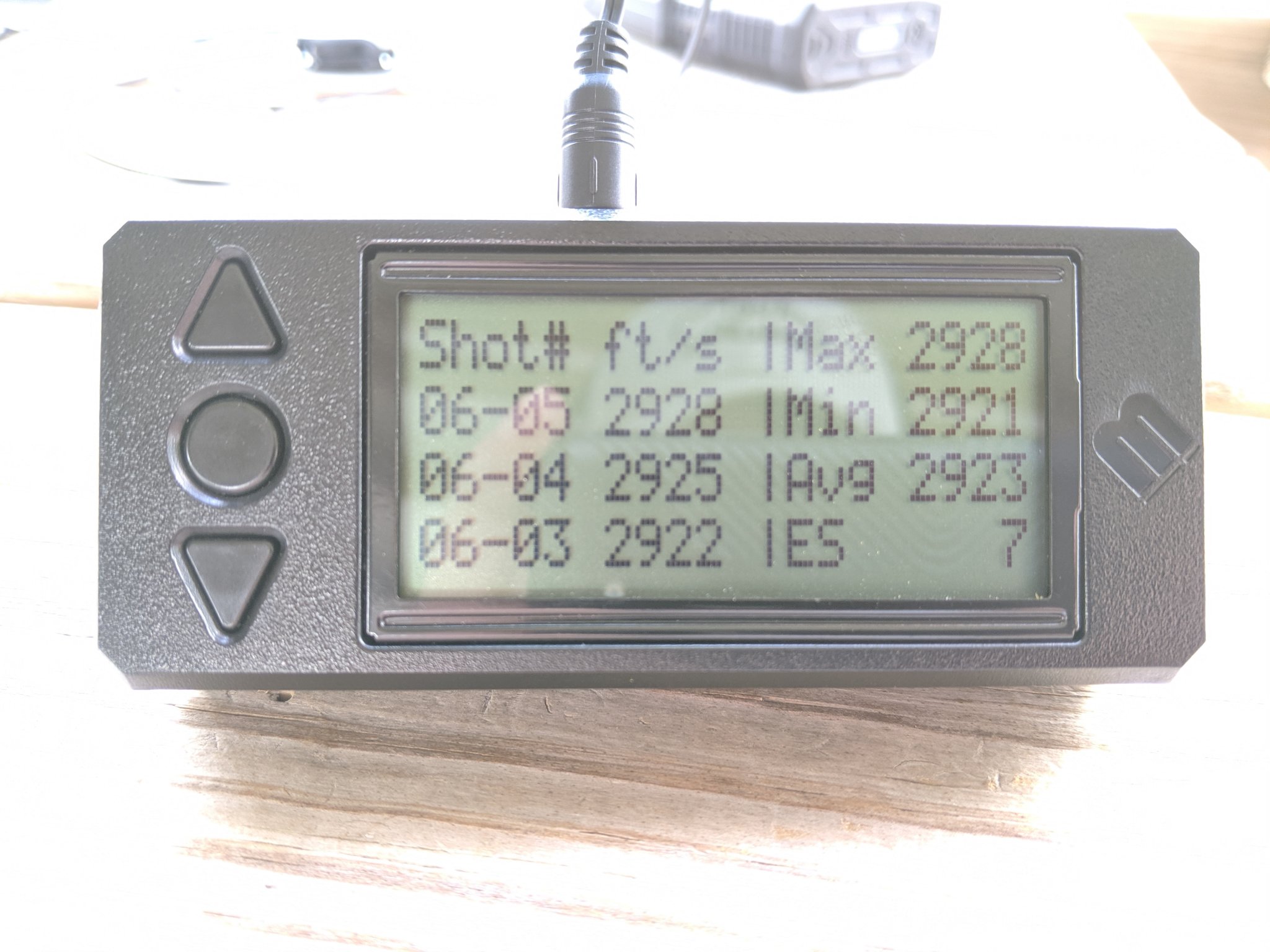

Velocity Results 6mm Creedmoor 41.0 H4350 105 HPBT
3063
3063
3062
3063
3056
