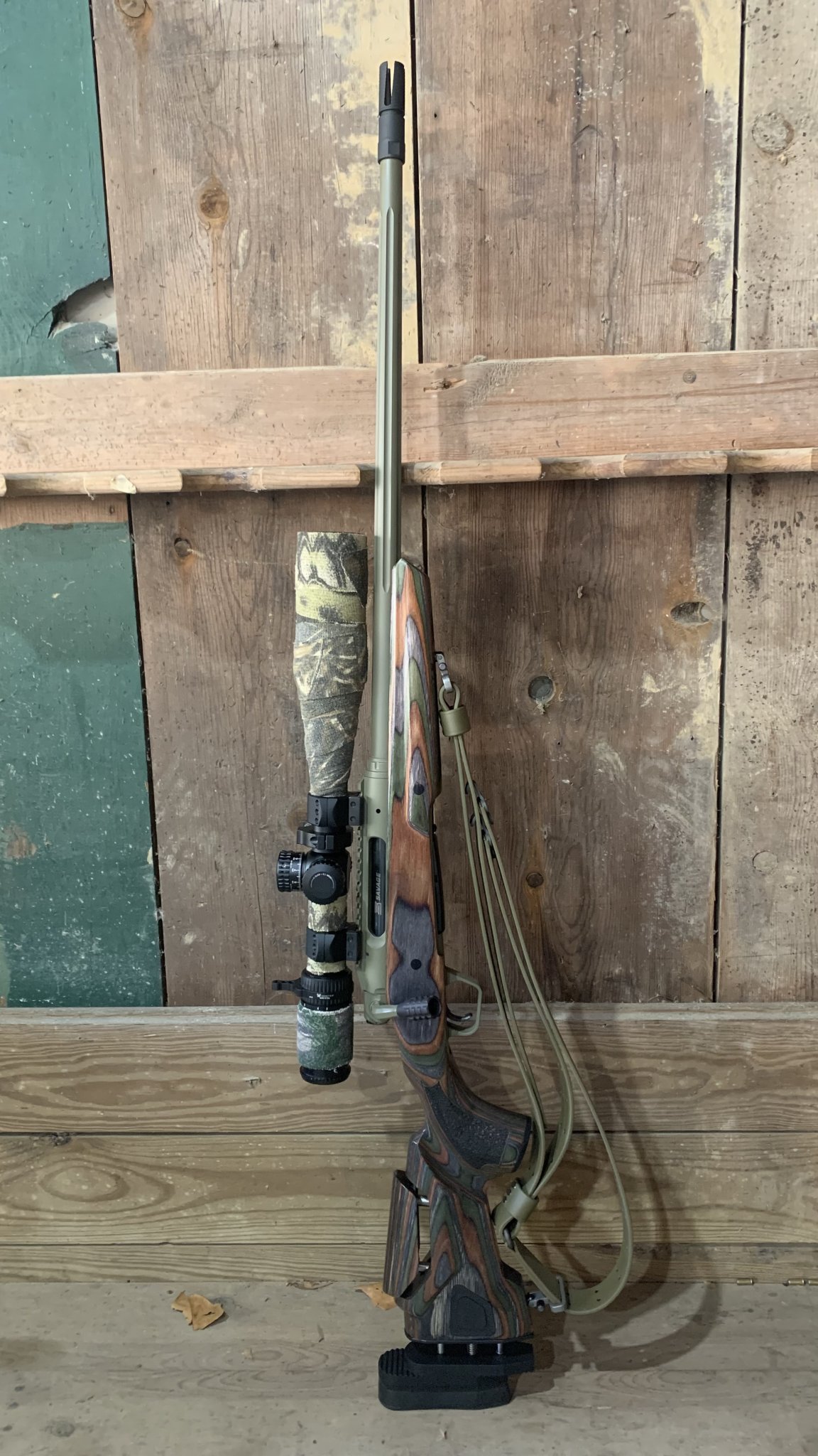

Received my Impulse predator .243 April of 2021.
I'm a sucker for straight pull rifles and I couldn't wait to get my hands on the first American made straight pull rifle that uses AICS magazines.
After sighting it in with my XP38 and XG50 scopes, I decided to make it my primary rig for the late 2021 and early 2022 varmint season.
NY's coyote season runs from Oct 1st to almost the end of March.
Out of the box, the bolt was slow and also barrel heavy.
After break in, lubrication and some range time, the bolt is very smooth.
I got the barrel spiral fluted and although the fluting made it a little lighter, it's still barrel heavy.
I'm anxiously waiting for the carbon fiber X barrel to arrive to alleviate that issue.
Performance wise, the rifle operated flawlessly in weather conditions ranging from -30 to 100 degrees, during flash blizzards and rain storms.
No issues with feeding from the AICS magazines, as would be expected and I'm glad Savage made the decision to add that feature to the Impulse predator.

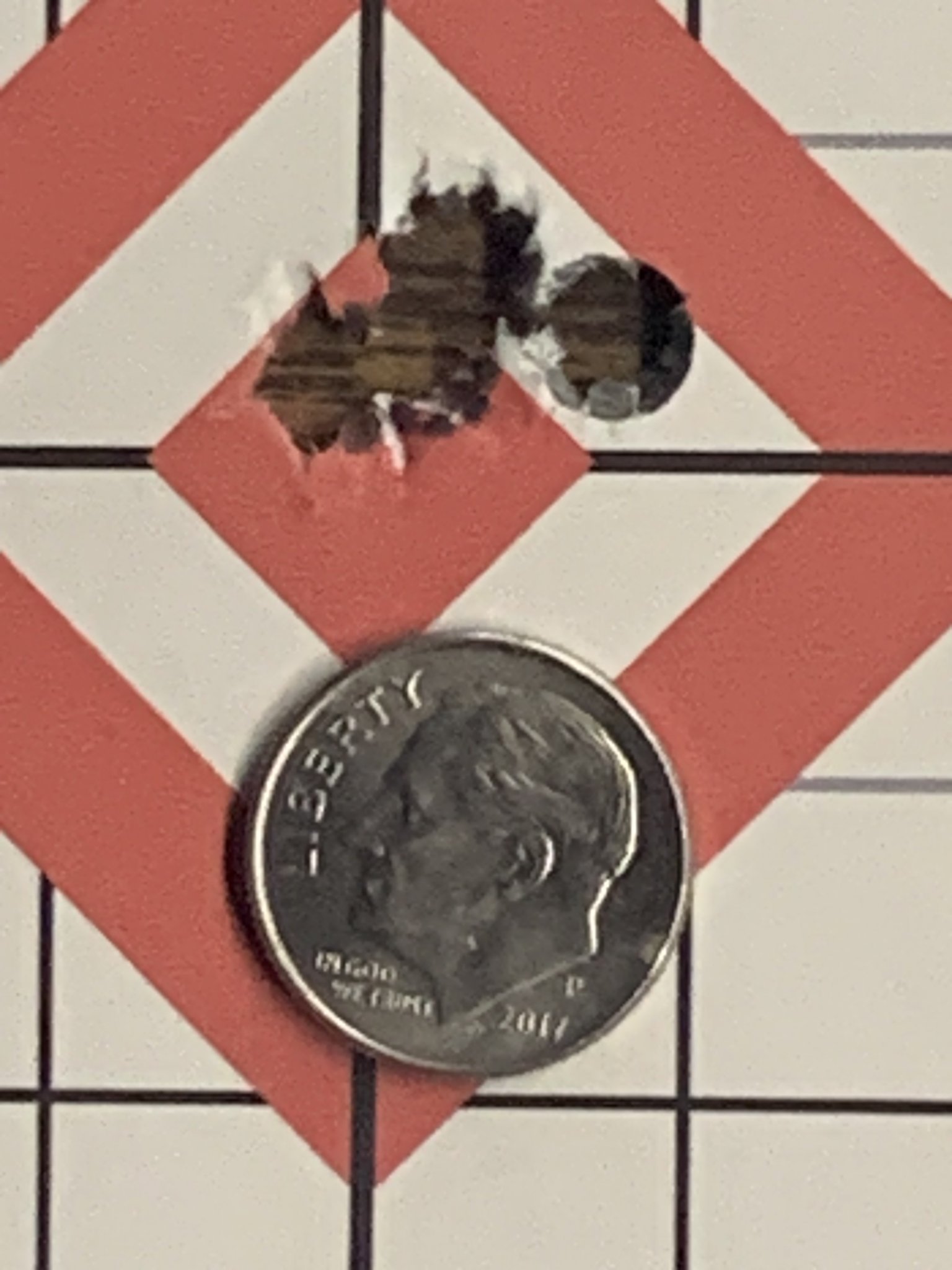

Accuracy wise, it's a tack driver with almost every weight projo I tried in the 65-95grn weight range, but was a one ragged hole wonder with 70 Grn NBT's, so I procured a lot of them.
Hopefully it'll shoot just as good with the X barrel that has the same twist rate as the factory barrel.
Savage has upped their game with the Impulse rifle line, but they've taken care of all of the issues that Savage rifles are known for with the Predator model using AICS magazines.
They just need to offer it with a carbon fiber barrel option to alleviate the weight concerns of hunters.
With the barrel extension and swappable bolt head features, Savage has added the ability to make it even easier to change barrels and calibers.
That's as soon as they have barrel extensions and bolt heads available for purchase.
In conclusion and after a years time of lugging it over hill + dale in upstate NY, I'm keeping my Predator.
Once the X barrel arrives, It'll be my go to varmint rifle for the foreseeable future.

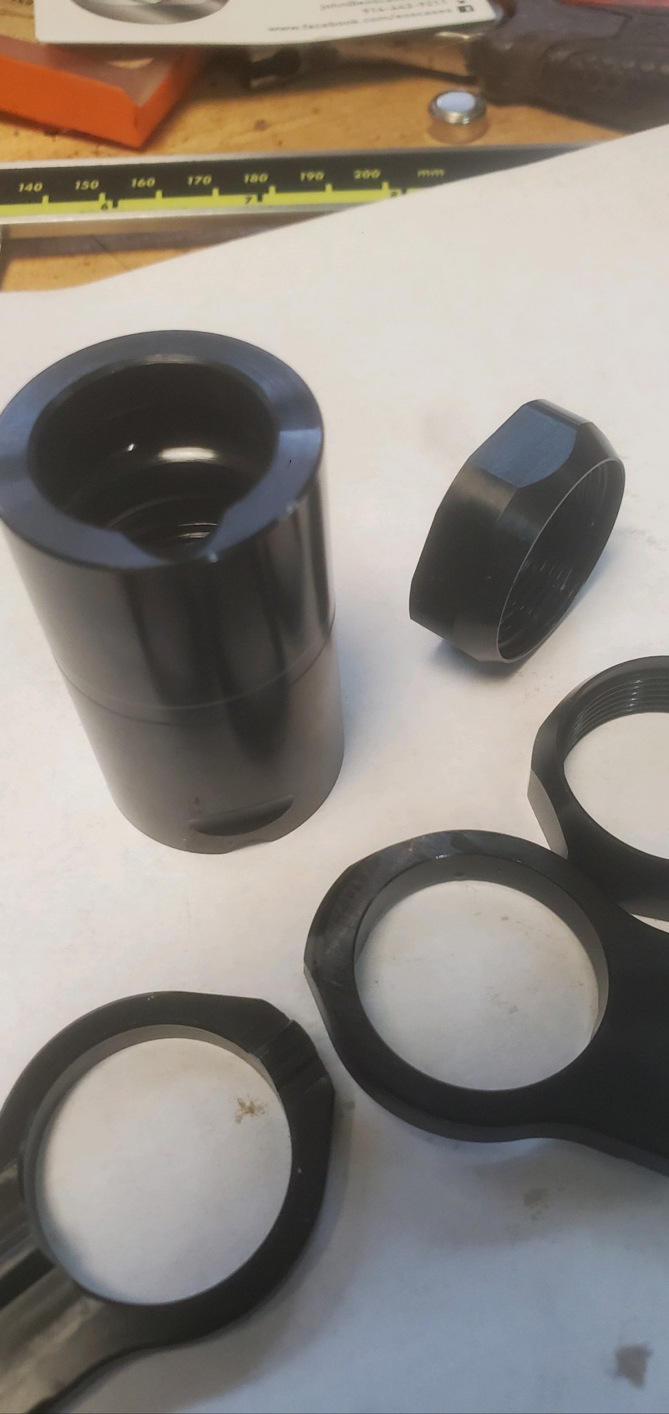

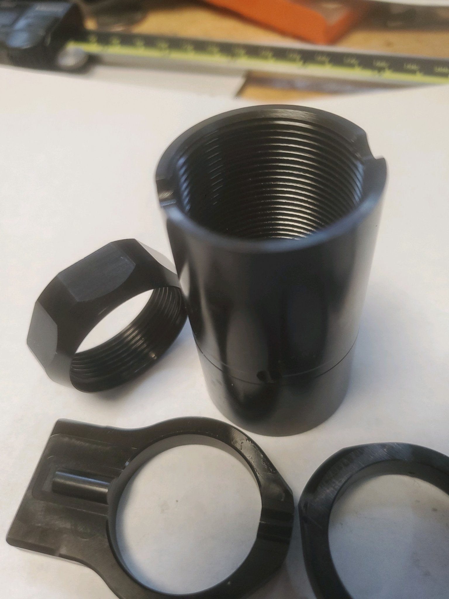

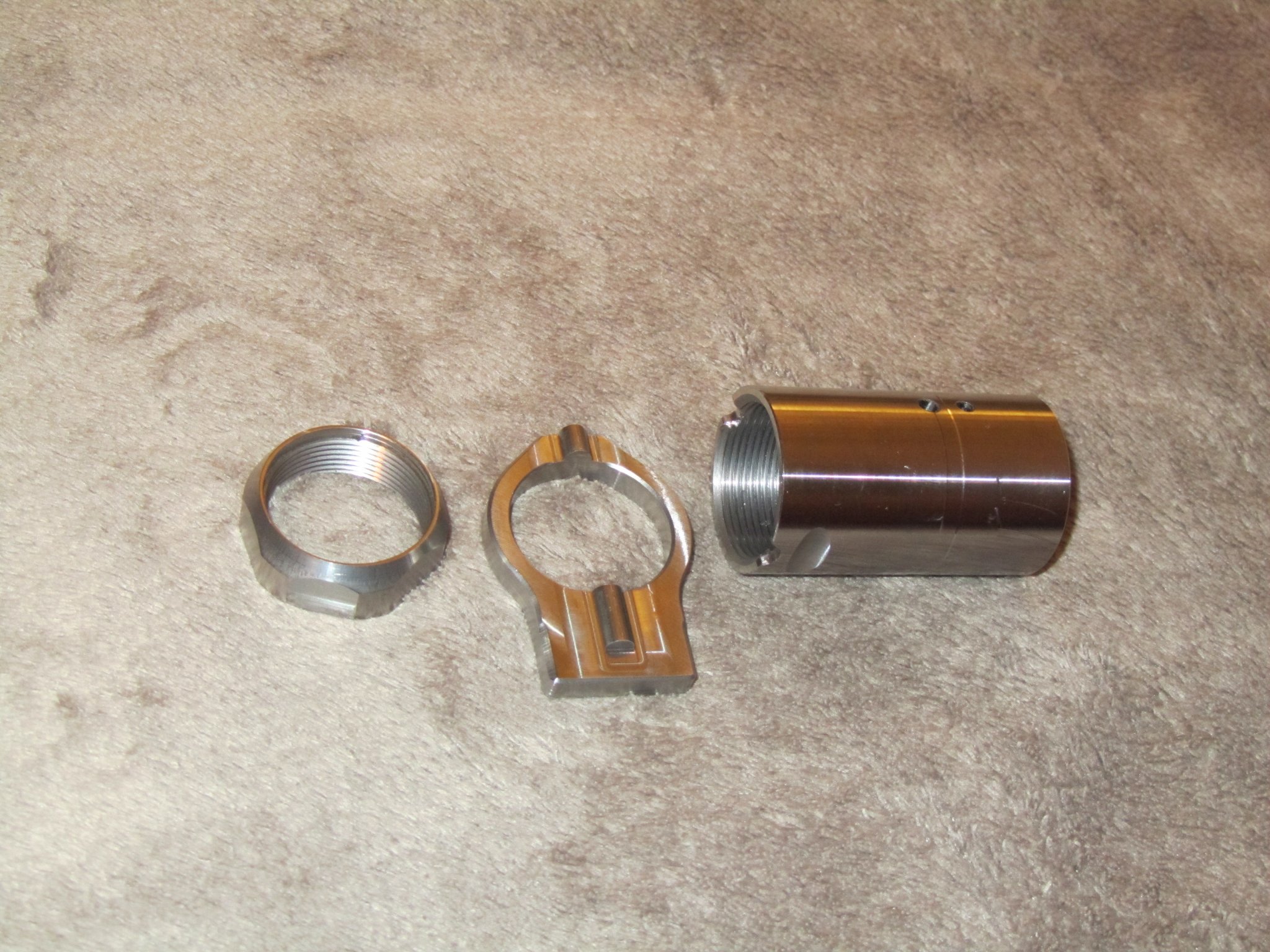

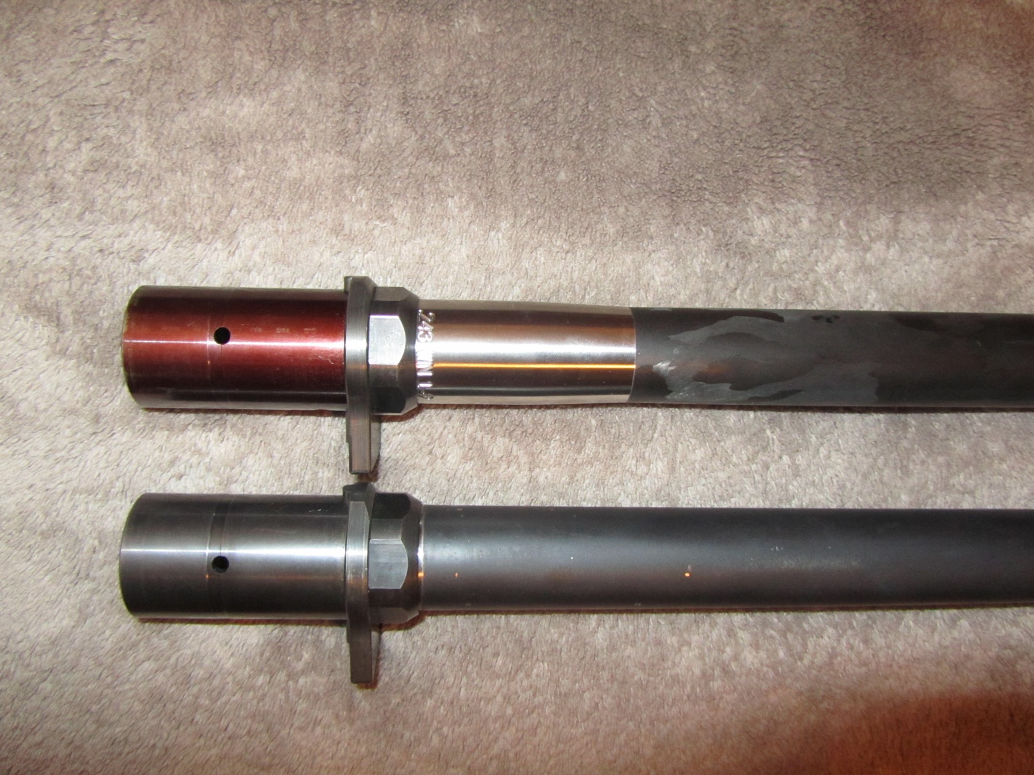

Since Savage isn't selling any parts to be able to change barrels on the Impulse rifles they sell, I visited a machinist friend and after almost a years time, we finally made all of the parts for the quick change barrel kit.
Barrel extension, Recoil lug and flat sided barrel nut.
I've put almost 100 Semi hot rounds through the factory .243 barrel and 50 through the .260 barrel without a hitch.
Even did some POI test's and although it was only done at 25 and 50 yards, there was no significant POI change.
Since the barrel assy has the recoil lug attached to it, you need to remove the barreled action from the stock to switch barrels.
I can change barrels in under two minutes.
Pics;
Reactions: echamp8 and Dirty D

After initial testing, I've only used the rifle for predator hunting and I've had no issues with it so far.
I did send a few parts to get professionally black oxide coated and they look great.
After some testing with the anodized parts we might start selling kit's, but from the beginning I did this for my own use.
I didn't think there'd be enough Impulse owners interested in swapping barrels to sell them.
My rifle is in predator hunting mode now, so I'm not going to be messing around with it till predator season ends at the end of March.
I was going to buy another Impulse predator rifle and do some testing with it, but I have to many irons in the fire now.

Impulse recoil lug width is .219".
I've had no issues head spacing four different brand small shank barrel's in my Predator's.
I'm going to start another run of parts in a week or two.

Receiver bolts were roughly 45-50 in lbs, no loctite. Bad news-My 308 elite is a large shank barrel, which means my pile of small shank barrels is not going to work until I get a small extension. Off the shelf savage barrels may only work with a thin nut, as the shank behind the front face of the lug is roughly 1.23".
The OD of the Impulse predator extension is 1.225".
If you have a large shank barrel, the small shank barrel extension won't work.
You would need to make a whole new extension with the OD to fit the larger receiver and threaded for a small shank barrel.
The Savage Elite model is listed with a 338 Lapua chambering, so it needed to be large shank.

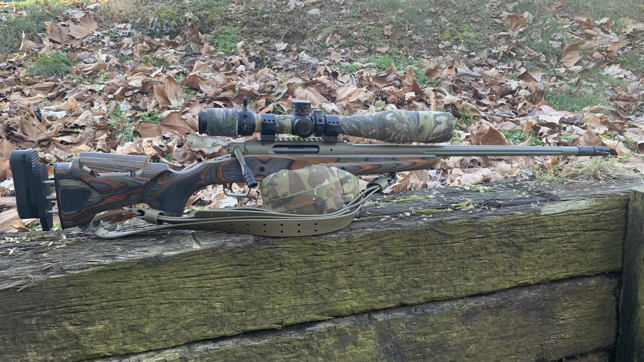

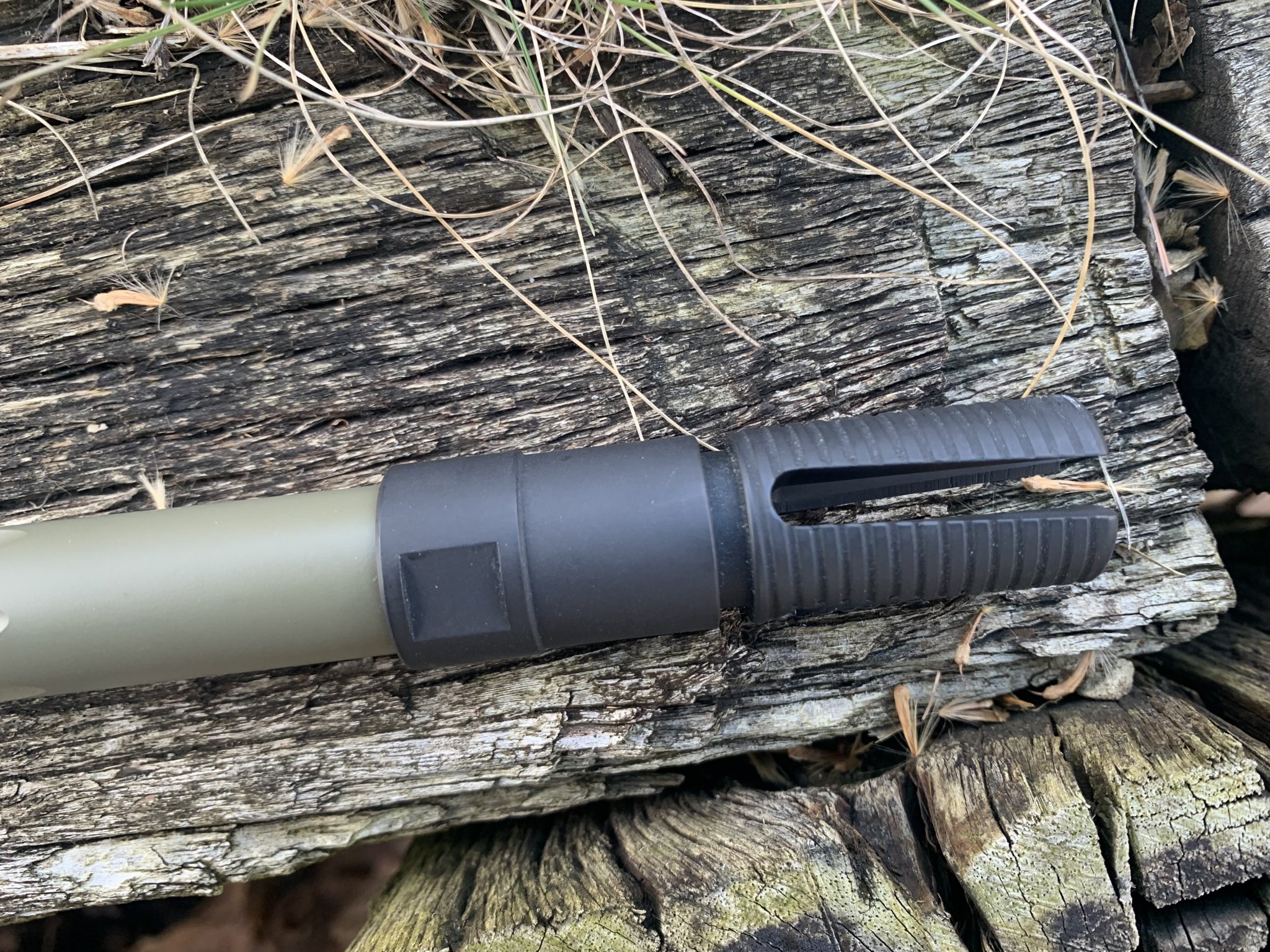

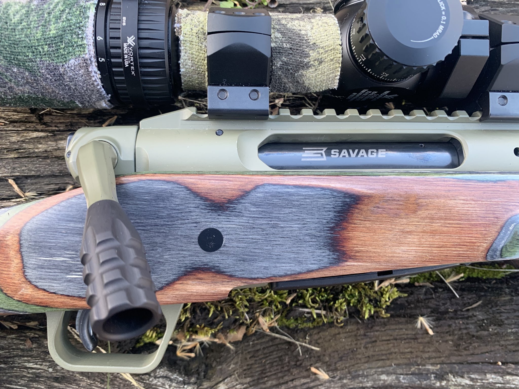

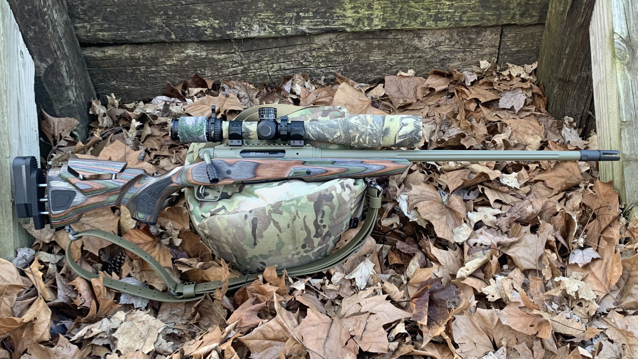

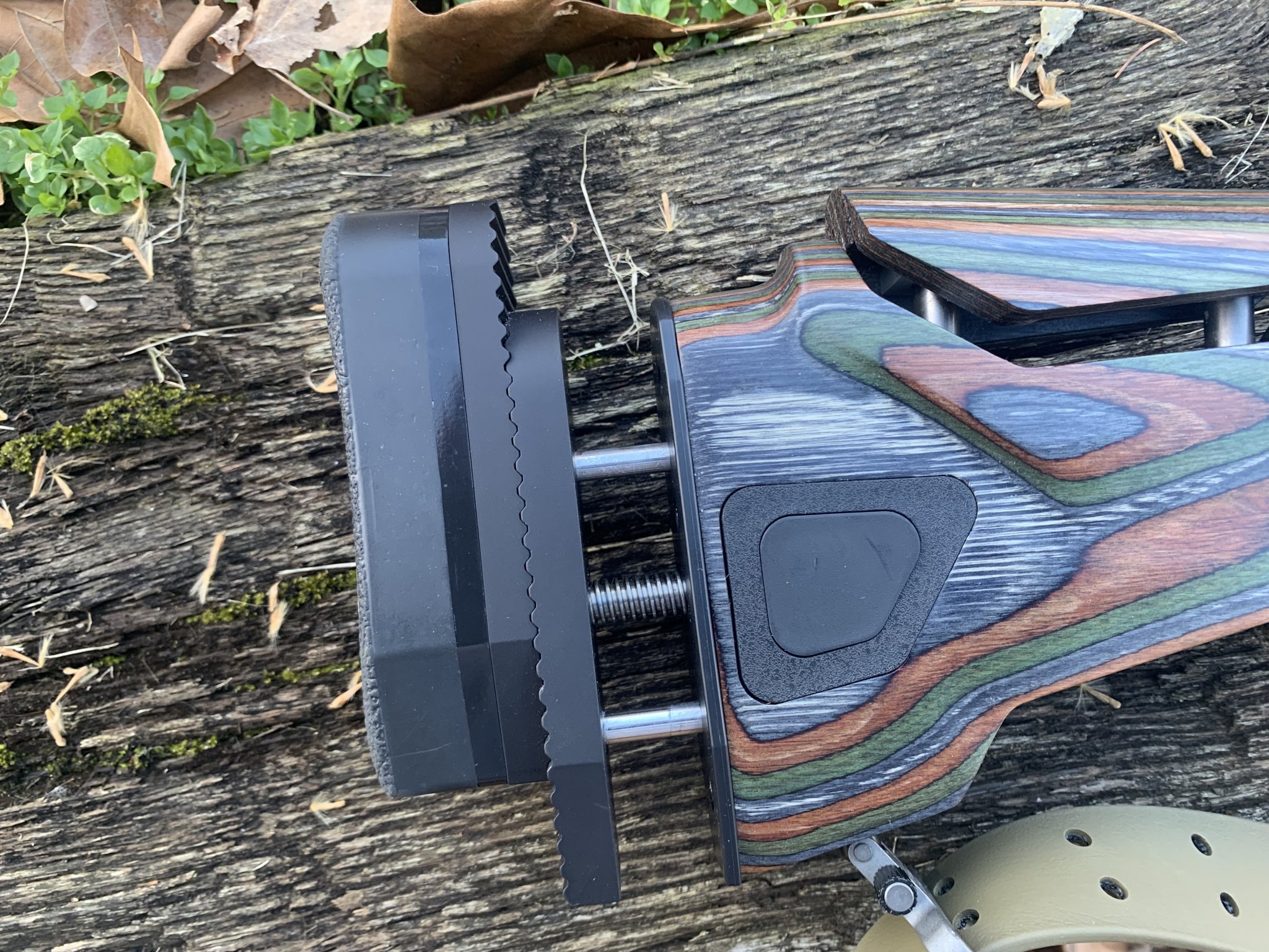

Savage Impulse Big Game rifle.
6.5 Creedmoor Hornady 147 ELDM / Avg MV 2700 FPS
Vortex Viper PST 5-25X
Burris Signature rings
Boyd's Agility rifle stock
Boyd's Agility vertical adjustment butt plate with 1" rubber butt pad
Smith Enterprises flash hider
Turner Biothane sling
I forgot where I got the after-market bold handle knob

View attachment 8073930View attachment 8073931View attachment 8073933View attachment 8073934View attachment 8073935View attachment 8073936
Is the stock specific to Impulse or the 110 footprint fits?
It is specific to the Impulse. If you go to the web site look for the ribbon / row just below the top of the screen that says "Build & Price."
You will want to choose:
Make - Savage
Model - Impulse (Note: there are two choices in the drop down list: Impulse and Impulse Predator)
Choose Action - If you chose the Impulse in the previous drop-down list the only option here will be Long Action Detachable Magazine Heavy Barrel. If you chose Impulse Predator in the previous drop-down list the only option will be Short Action DBM AICS Heavy Barrel.

Extension is the same OD with the large shank, who knows if they will run the lapua on this receiver. The specs on savage's site are not updated for the long action elites.
Yes, it's the same OD as yours
To summarize.
Birch7 has a 308 Impulse Elite Precision which uses a large shank barrel and extension.
That extension has the same OD ( 1.225" ) as on Shoots100 243 Win Impulse Predator with a small shank barrel.
