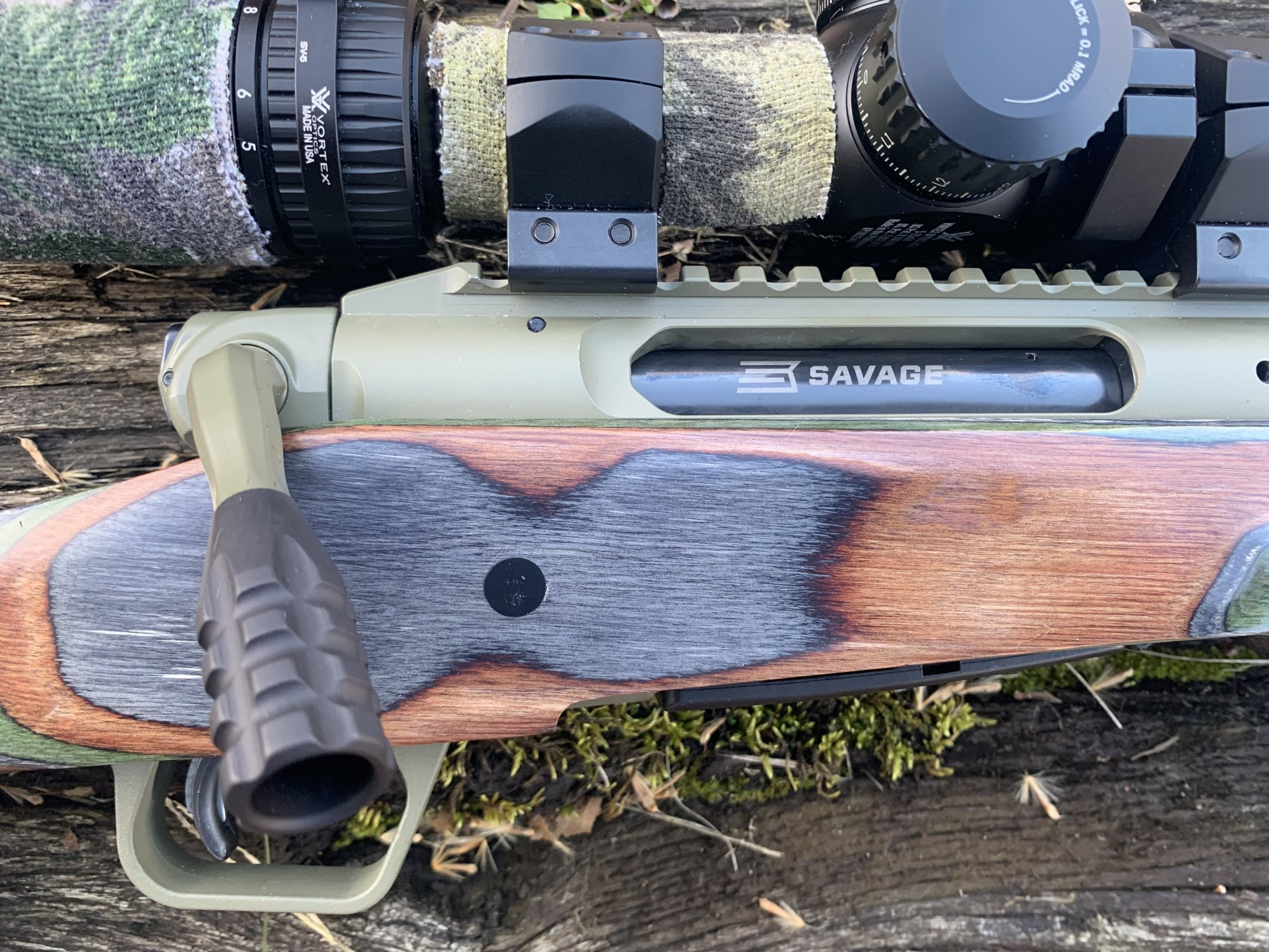

I did a quick video on ejection. If you run the bolt as slow as possible, it will drop inside the action, but I'm not sure why anyone would do that. If you run the bolt normally, you can launch cases almost as far as you like. The only issue I've had is finding my brass. Sometimes it's 3 feet, sometimes 12. Just depends on how hard you pull on the bolt.
Brass catcher, but they only work if you remember to put it on !
It's made in Chyna and imported by Lyman, but the Tacstar brass catcher has worked great for me.
Very light, folds flat and I haven't had any issues with it melting, like I had with other brands.
I bought an extra pict rail adapter so I can use the brass catcher on both of my predators.
Since I'm a southpaw and have the bolt handle on the left side, I've had no issue with the brass catcher, but remembered that it won't work so well for a right handed shooter, as the bolt is to close to the catcher and gets knocked off when trying to grab the bolt.
So tough luck for you evil right handed shooters, but great if your a southpaw.

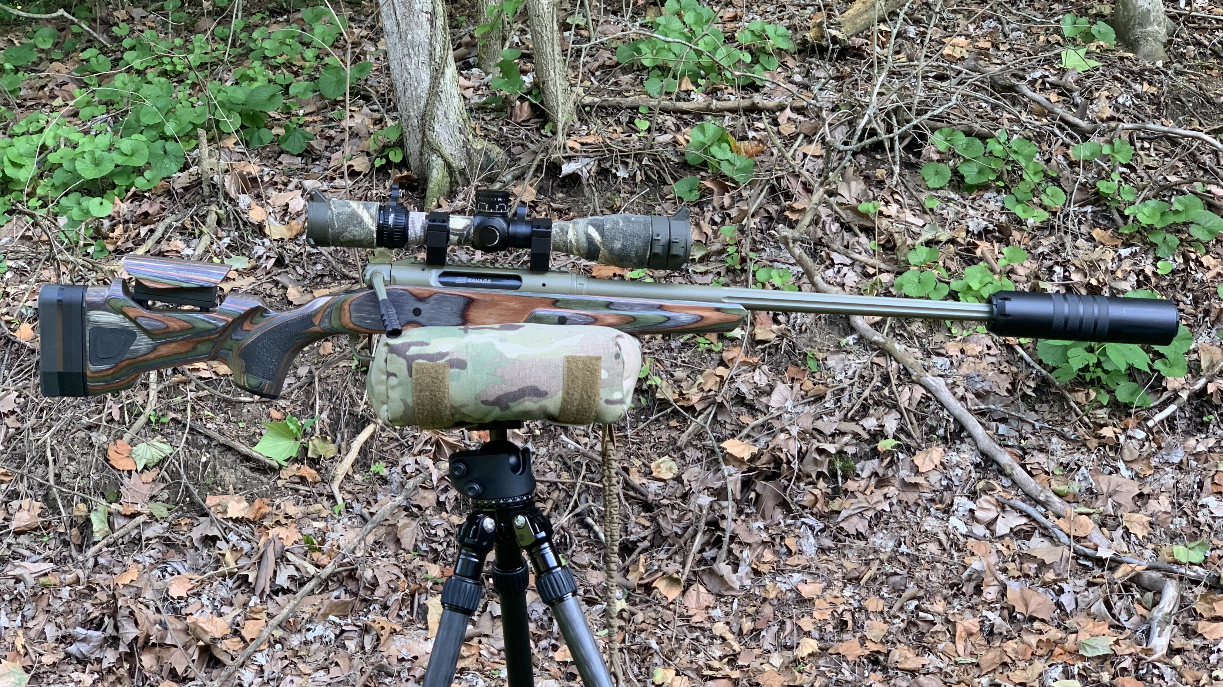

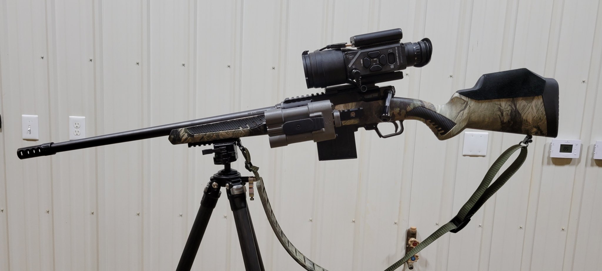

Weighs around just under 10lbs with the Halo X50 , LC and a loaded 5 round metal AICS mag, as I would be carrying it in the field.
Reactions: PRCWV
After initial testing, I've only used the rifle for predator hunting and I've had no issues with it so far.

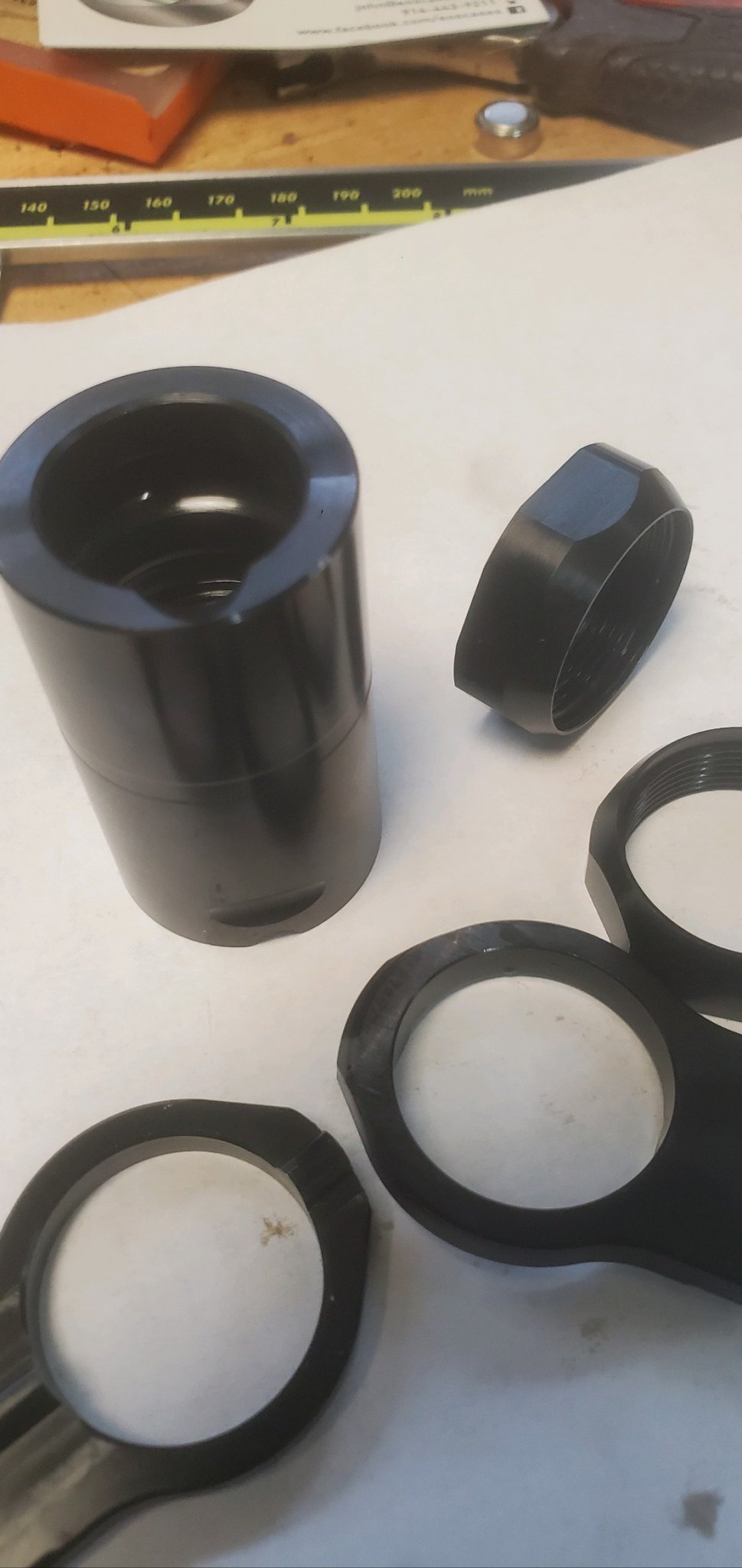

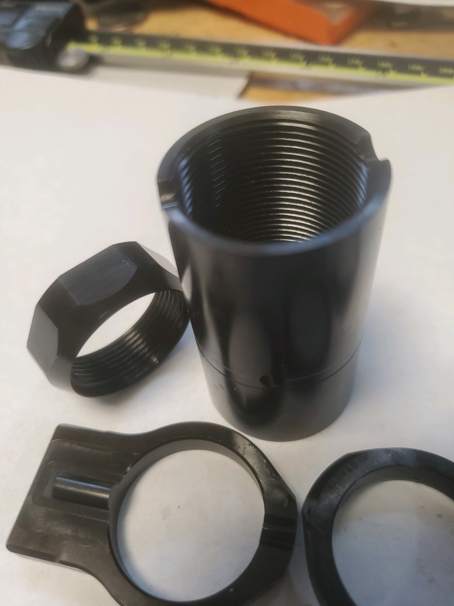

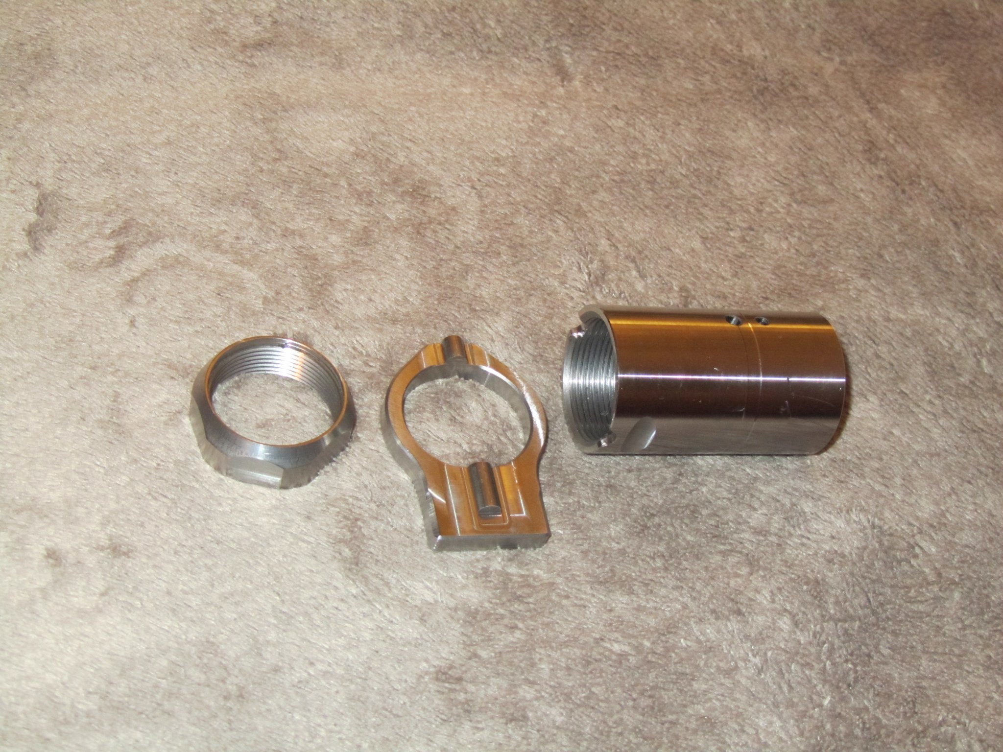

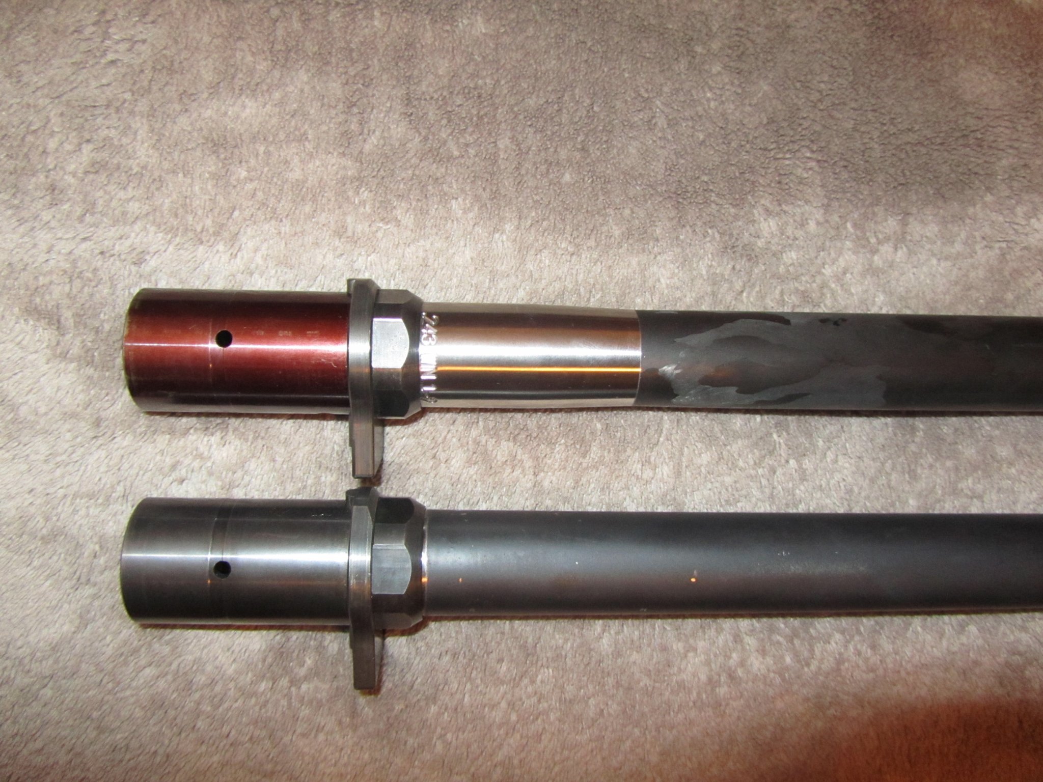

Since Savage isn't selling any parts to be able to change barrels on the Impulse rifles they sell, I visited a machinist friend and after almost a years time, we finally made all of the parts for the quick change barrel kit.
Barrel extension, Recoil lug and flat sided barrel nut.

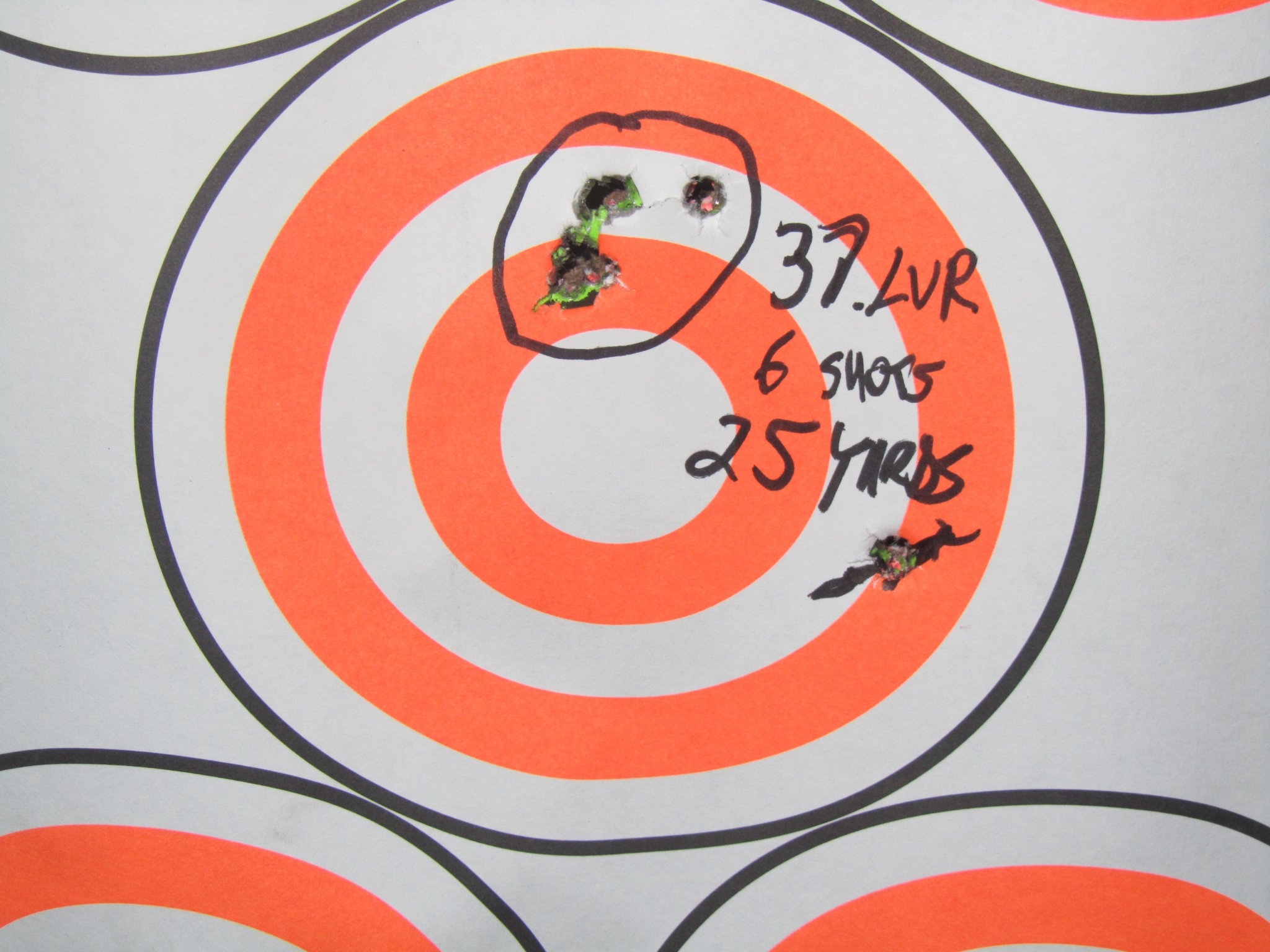

I've put almost 100 Semi hot rounds through the factory .243 barrel and 50 through the .260 barrel without a hitch.
Even did some POI test's and although it was only done at 25 and 50 yards, there was no significant POI change.

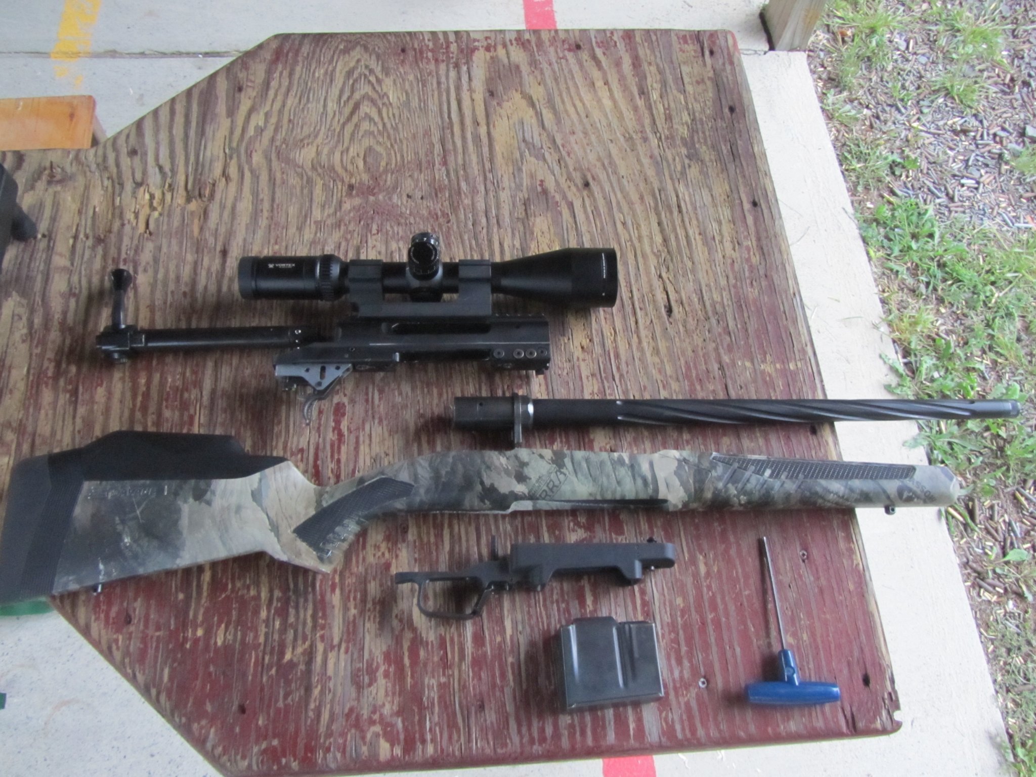

Since the barrel assy has the recoil lug attached to it, you need to remove the barreled action from the stock to switch barrels.
I can change barrels in under two minutes.

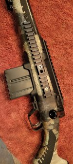

Any Impulse owners able to comment on if the big game version could be made to work with AICS mags if dropped into a stock that supports it?
Looking at the Big Game in .300 WSM, but the proprietary mags put me off. Wondering if it could be dropped into the Boyd’s predator inlet
I have the big game version in 6.5 CM. AICS will not work.
Savage also says their magazines for the 110 will not work.
However, I have made them work by doing some filing on the top edges. I did that to both the 10 round and 4 round magazines.
It took a lot of trial and error but I got them to work.
The ten-round magazines will only hold nine rounds.
I keep meaning to do a how-to write up on modifying the 110 mags with photos but been so busy that I keep forgetting. Sorry.

I will test multiple options, I have a decent collection of MDT made AICS mags.

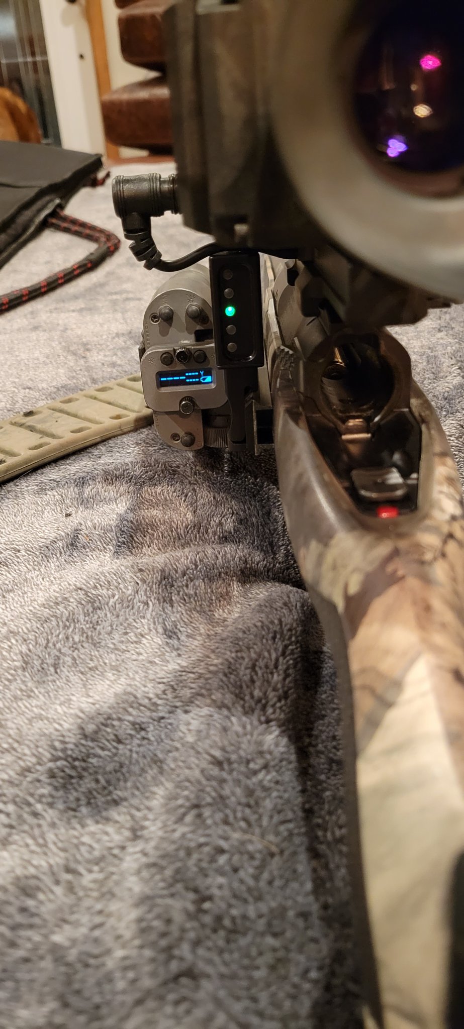

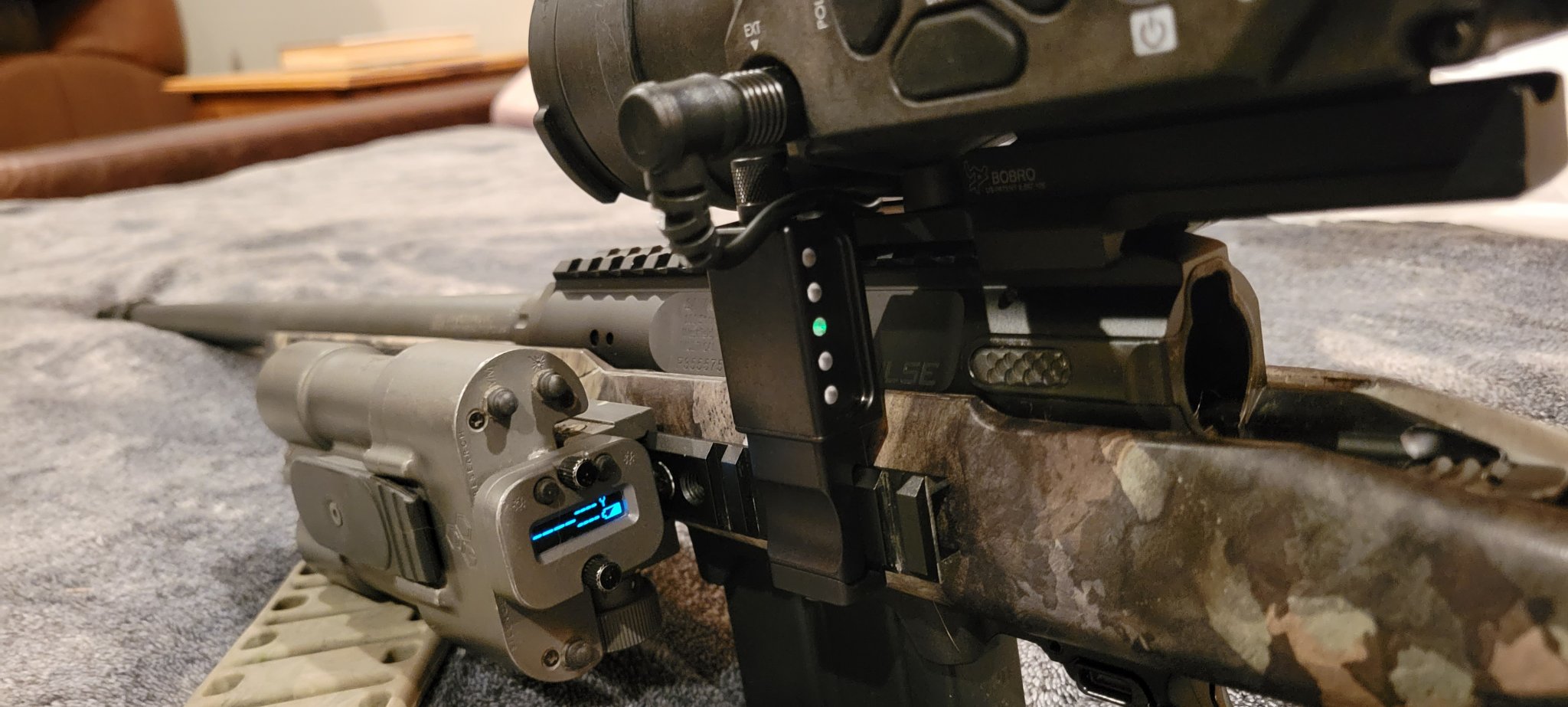

I added a pic rail to the side to mount a swr radius and mdt level. You can drill and tap into the aluminum there. Put some suede on the cheek piece which is nice.
