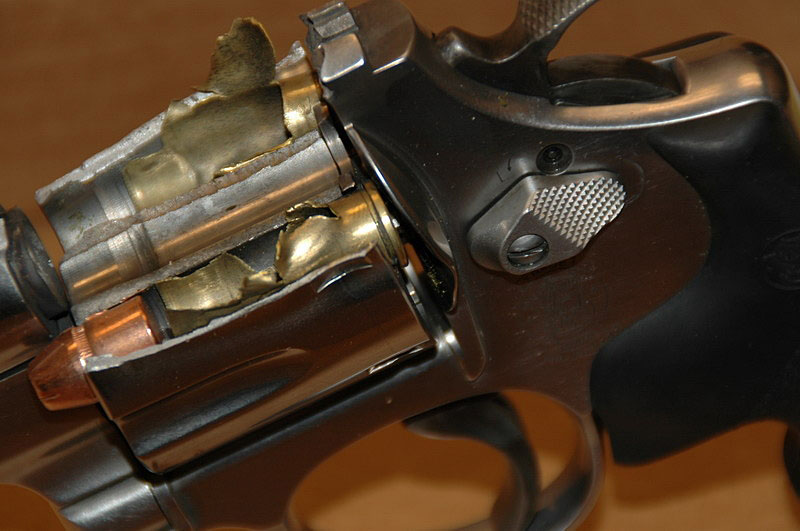

Saw a peeled Magnum once don't recall the caliber ,it was back when SS actions barrels were just coming around . It looked as if someone had literally peeled the barrel away from the action in #3 strips .
I personally was on the 27 yd. trap line one evening ,when shrapnel flew from #3 stations away . Shooter next door station was killed head trauma .
Russian made O/U and Not cheap . I knew both shooter and victim . Factory loads NOT reload on that incident local PD held everybody for hours while investigation proceeded .
Karma fate apropos call it what you will , two months later same shooter different range during a league shoot was killed on the 16 yd. line . Seems another shooter's homemade load went boom and killed George . Illegal loads and obviously overloaded were the culprit .
I was eating at a local restaurant awaiting MY division's shoot off ,when a mutual friend came in and told us what went down and all was canceled of course . Sad night had known George for 30 + years (n)

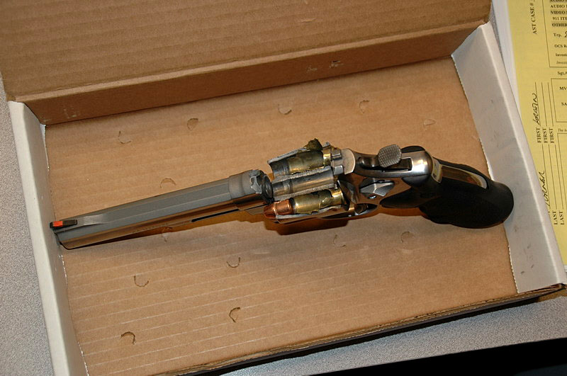

This wasn't mine but saw one similar ,some folks just don't understand PRESSURE in a confined space !.
I learned early ,went into My old Bosses garage to get some tools for work early one AM and met a Bobcat !!. Not the mechanical type either :oops:

That S&W model 29 ,that had the cylinder relocated ,didn't stop sales a fraction . Sir Issac stated it best ; For every action there is an opposite and equal reaction .
Just remember it's NOT always and overloaded cartridge ,which can ruin your day and under filled FLASH OVER can most certainly do damage .
A close Friend was fire forming cases for some old WWl French rifle and neglected to get enough Dacron on top of the powder ,so as the rifle became horizontal powder fell forward . Primer ignited overtop of powder rendering extractor and bolt face unusable . The action held but was worthless after that . If any of you have ever witnessed a Back Draft during a fire ,it's the same principle .

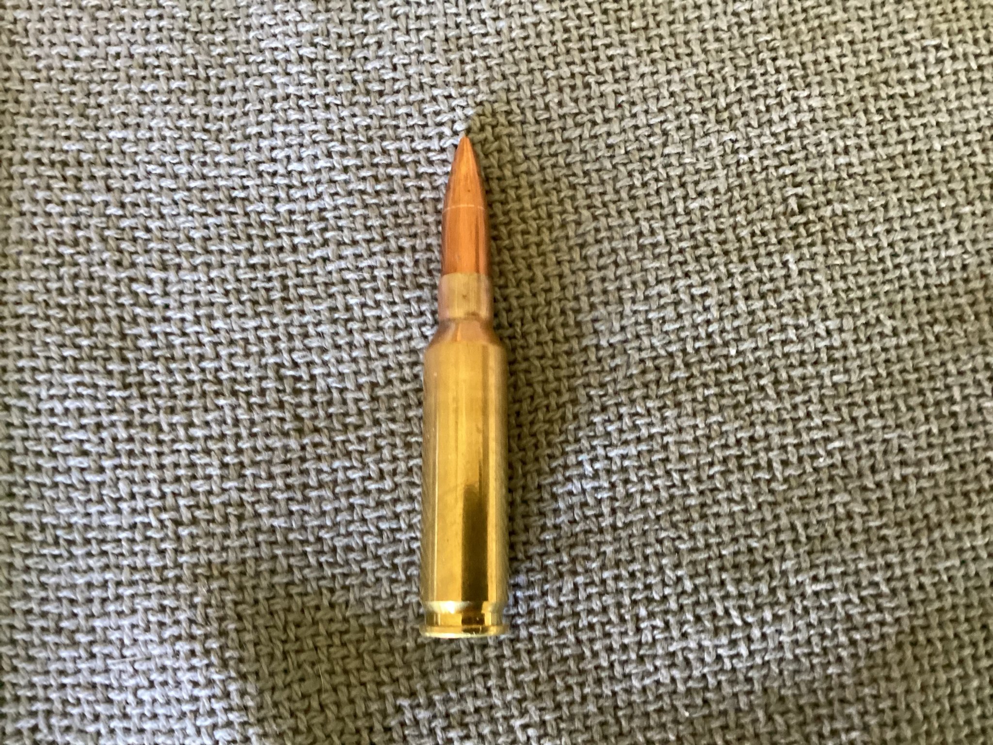

Could have seated a .270 or 7mm in a 6.5mm Creedmoor case?
Pretty Damn easy!
7mm 150 grain Sierra Matchking, seated in a Hornady 6.5 Creedmoor case.
That’s what I said but others said the die would crush the case. I’m gonna go to the shop right now and give it a try. Lots of retired cm cases and shoot very little 7mm any more so lots of material to give it a try.
Could have seated a .270 or 7mm in a 6.5mm Creedmoor case? View attachment 8125560
Pretty Damn easy!
Pretty Damn easy!
If that’s what he did he wouldn’t be able to close the bolt because the round would be stuck in the neck area of his chamber. Thus, not able to fire. I know this because I once sold a 270 wby mag to a dumbass who went and bought 7mm wby mag rounds and later calls me up and asked me why he’s not able to close the bolt. Comes to find out he’d thought he bought a 7mm wby mag.
With factory crimped rounds, I totally agree. But with VLD bullets, loosely seated and with the bolt forced home it is possible. its been done. Keep in mind, this fellow does not appear to be the brightest bulb on the Christmas Tree. Of course, without the load data, the entire rifle and some kind of visible check on his loading habits/loading bench, who knows.

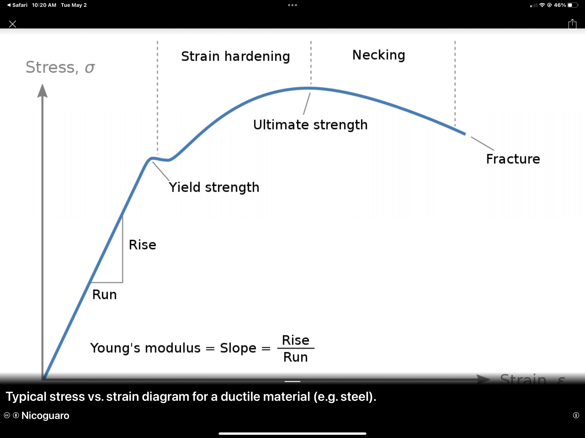

There was a nothing that says the action let go due to a single catastrophic event. It is entirely possible that the guy was above book max with an “appropriate” powder and the action let go due to too many high pressure rounds.
One of the main knocks on proof testing is that the proof load, while not destroying the firearm, DOES cause damaging stress to the firearm. The theory is that a proofed firearm is weaker than an unproofed firearm, due to the proofing process.
Proofing a firearm does not cause ‘damaging stress’!
One of the qualities of steel is that if you keep the stress below the ‘Yield Strength’, steel will dimensionally change and when the stress is removed, it still has the original dimensions.
Proof loads keep the stress below the ‘Yield Stress’.
To determine the ‘Yield Stress’,
a coupon is put into a fixture and stress is applied. The elongation is measured and stress calculated using the original dimensions to yield the Stress/Strain Curve.
Reactions: acudaowner
To determine the ‘Yield Stress’,View attachment 8133019 a coupon is put into a fixture and stress is applied. The elongation is measured and stress calculated using the original dimensions to yield the Stress/Strain Curve.
If proof loads didn’t cause “cumulative damage,” you could feed your firearm a steady diet of proof loads without worry. Do this, however, and your gun will eventually fail.

“f proof loads didn’t cause “cumulative damage,” you could feed your firearm a steady diet of proof loads without worry. Do this, however, and your gun will eventually fail.”
“The SAAMI pressure testing protocol uses test barrels that have a hole located in the chamber at a location specific to the cartridge. “
How many test loads do you think SAAMI fires before changing a barrel?
