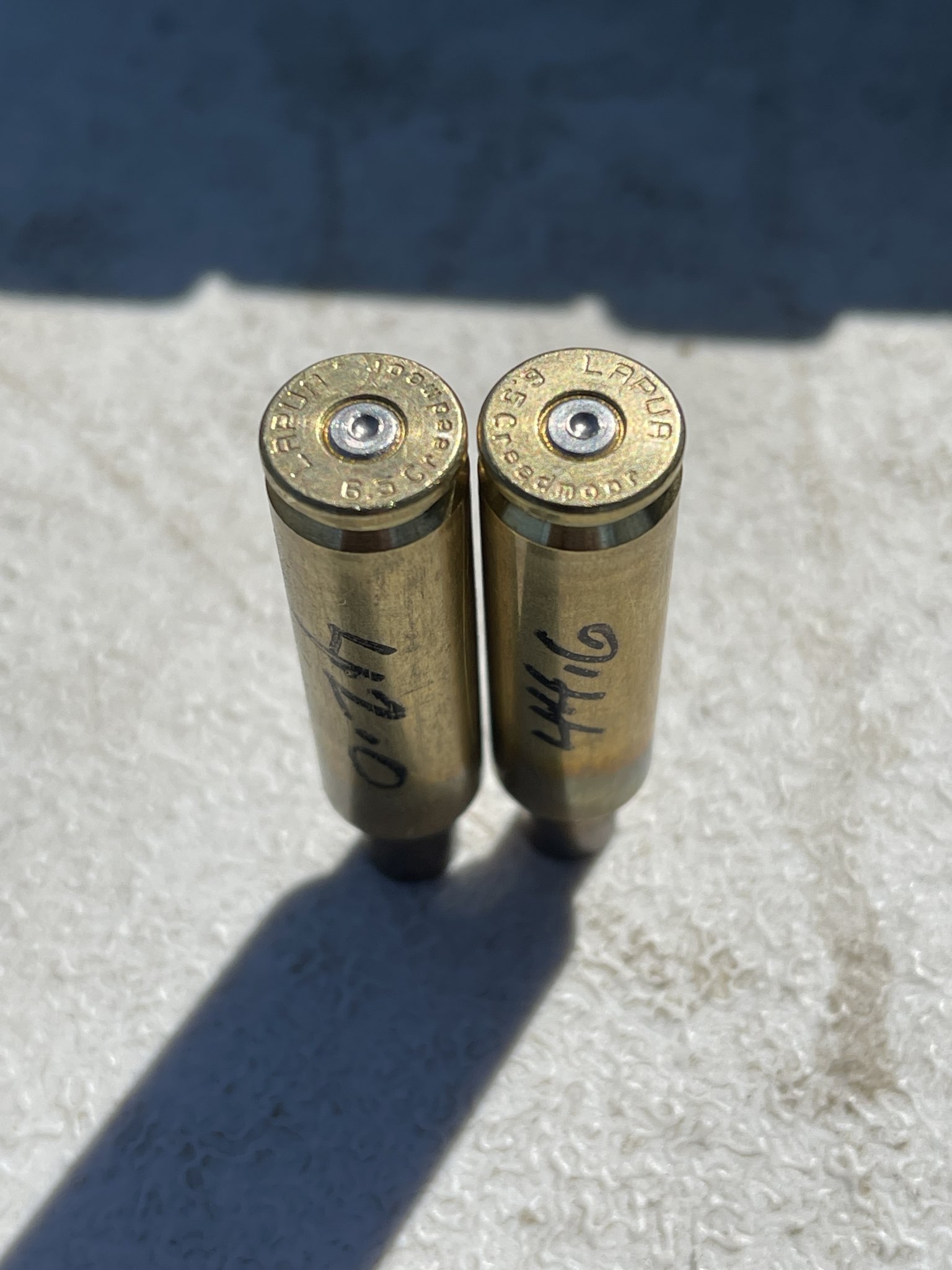

140 gr at 3000 fps out of a 24” 6.5 cm. One of those standard pressure snipers hide loads.Ok guys! That is pretty scary. But here’s what I got going right now and I really need your guys input. Please take a look at this picture on the brass and the primer crater. I’m shooting 140 ELDM, R16, CCI BR4 primer, Lapua brass (3rd firing), 6.5 creed, 24” Proof 1:7.5 twist. Starting load was 42 gn with speed at 2840 fps, and max load was 44.8 at 3001 fps. My inspection on the cratering and the brass shows almost identical condition so I don’t know if they were both over pressured. Bolt lift on both loads are identical and normal. And based on what I read online, CCI primers tend to crater more than most primers. But the fact that I’m pushing a 140 grain at 3000 fps on a 24” barrel seems chillingly eerie. Please let me know if I’m still safe or if I’m in the kaboom zone. Shine in and keep it professional. Thank you!
Thank you ! 42 and 44.8 were my starting and max loads, not the published numbers. Both of these loads gave me the best velocity nodes with single digit ES and SD but sounds like I’m in the danger zone so will need to go below 2800 fps to be within the safe pressure zone. Any other powder besides H4350 and R16 that you guys used to get the highest speed and still be under acceptable psi..?140 gr at 3000 fps out of a 24” 6.5 cm. One of those standard pressure snipers hide loads.
Where did you get 42 gr as a starting load? Thats a max load. 3000 fps is a zippy load out of a 6.5-284.
Both your cases show obvious excessive pressure. The BR-4 is a very strong primer.
That’s the funny part, everyone on the hide is a expert reloader140 gr at 3000 fps out of a 24” 6.5 cm. One of those standard pressure snipers hide loads.

I mean how did you come up with 42 gr as a start load? H4350 and RL16 are the best powders for the CM, one need not look further, forget the speed. Your load is going to be in the 40.5-41gr range (2750-2800 fps).Thank you ! 42 and 44.8 were my starting and max loads, not the published numbers. Both of these loads gave me the best velocity nodes with single digit ES and SD but sounds like I’m in the danger zone so will need to go below 2800 fps to be within the safe pressure zone. Any other powder besides H4350 and R16 that you guys used to get the highest speed and still be under acceptable psi..?
41gr of either powder won’t touch 2750 in a 26”. At least not with hornady or prime brass. I’ve loaded for Bartlein, rock creek, proof, and lothar walther barrel. It takes at least 42gr of either and a 26” barrel to get there with the brass I listed.I mean how did you come up with 42 gr as a start load? H4350 and RL16 are the best powders for the CM, one need not look further, forget the speed. Your load is going to be in the 40.5-41gr range (2750-2800 fps).
When your starting load goes faster than the max load should, its not time to celebrate, its time to stop and evaluate.
He’s going 2840 with 42 gr. Lapua brass is adding pressure. Subtracting one grain will equal about 70 fps.41gr of either powder won’t touch 2750 in a 26”. At least not with hornady or prime brass. I’ve loaded for Bartlein, rock creek, proof, and lothar walther barrel. It takes at least 42gr of either and a 26” barrel to get there with the brass I listed.
Maybe the difference is the lapua brass because even at 42gr, @Rockhurr is clearly over pressure and way to fast for a 140 and a 24” barrel.
I agree completely. 2840 is far and above what he should be seeing. The cratered primers and light ejector stamps give it away even without the velocity numbers. I was just sharing what I see with my brass and powders. It’s the reason working up from a low number is a smart move. Components make a difference.He’s going 2840 with 42 gr. Lapua brass is adding pressure. Subtracting one grain will equal about 70 fps.

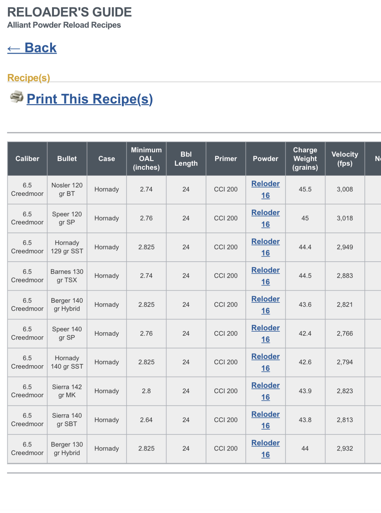

I may be over pressured but I’m seeing this chart taken directly from Alliant’s website and they are loading 140’s past 42 grains… so41gr of either powder won’t touch 2750 in a 26”. At least not with hornady or prime brass. I’ve loaded for Bartlein, rock creek, proof, and lothar walther barrel. It takes at least 42gr of either and a 26” barrel to get there with the brass I listed.
In a Hornady case. That case seems to have more internal volume than yours. I don’t know for sure, but it’s very likely. With the same powder charge in both my hornady and prime brass, there is roughly a 25fps velocity decrease in the hornady from the lower pressure.I may be over pressured but I’m seeing this chart taken directly from Alliant’s website and they are loading 140’s past 42 grains… so
Just my opinion but 3000fps from a 24" 6.5CM is smoking hot even with some of the magic powders like RL26 ( I use the phrase magic powder loosely since I have seen some of the velocities listed but have never neen any real pressure measuring equipment used during those tests )Ok guys! That is pretty scary. But here’s what I got going right now and I really need your guys input. Please take a look at this picture on the brass and the primer crater. I’m shooting 140 ELDM, R16, CCI BR4 primer, Lapua brass (3rd firing), 6.5 creed, 24” Proof 1:7.5 twist. Starting load was 42 gn with speed at 2840 fps, and max load was 44.8 at 3001 fps. My inspection on the cratering and the brass shows almost identical condition so I don’t know if they were both over pressured. Bolt lift on both loads are identical and normal. And based on what I read online, CCI primers tend to crater more than most primers. But the fact that I’m pushing a 140 grain at 3000 fps on a 24” barrel seems chillingly eerie. Please let me know if I’m still safe or if I’m in the kaboom zone. Shine in and keep it professional. Thank you!
And your first 42 gr velocity was way faster than theirs was at near 44 grains. You should have stopped.I may be over pressured but I’m seeing this chart taken directly from Alliant’s website and they are loading 140’s past 42 grains… so
