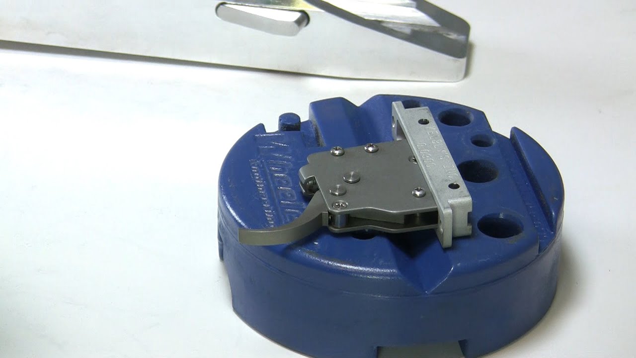

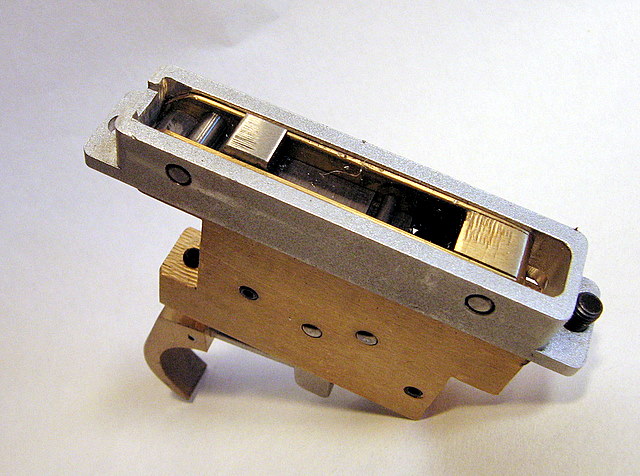

    Actions either utilize them or don’t. A couple brands that do are Kelbly and Impact. The trigger hanger allows the shooter to both easily swap trigger using one or two screws rather than driving pins in and out. It also assists with trigger timing to your action - as some manufacturers make them in different sizes.

    It began in the BR community. It's very typical for an action to be glued into a rifle stock permanently on a bench rest rifle. Trigger wells get removed with two small screws, usually wood type or if the smith takes the time to install threaded inserts into the stock, machine screws are used.
    So, pull the guard, take the two little 6-32's out of the hanger and remove the trigger assembly for service. It's literally that simple. I've built a number of these rifles over the years and I've never personally witnessed any form of accuracy improvement because of them. It's merely an adaptation to fit a very particular application. It's cascaded into "regular guns" for some reason. Likely because someone saw it, though it was cool, and wanted it. Using variations to alter fire control timing could work I guess, but its a bandaid fix to a larger problem that lies squarely in the lap of either the action maker or the trigger company. Nudging forward or backwards with offset pinholes isn't exactly a standard.
