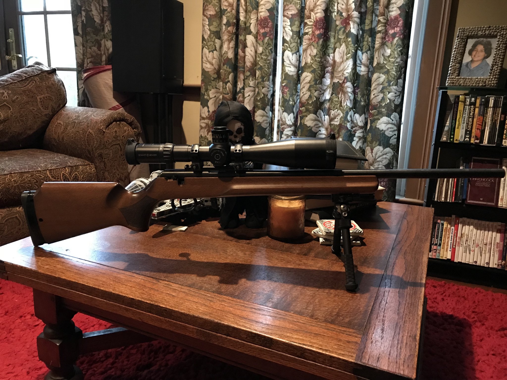

I use an S&B 5-25 on my custom 64 MPR...Gen IIXR reticle. Couldn't be happier.
