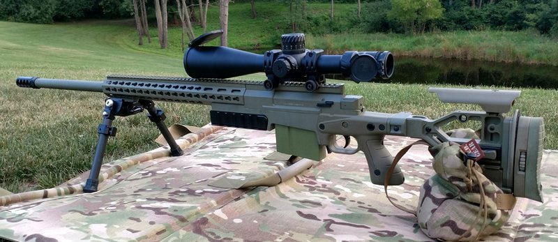

Tangent Theta is the easiest hands down. Next would be the new turrets that are on the Vortex AMG.
