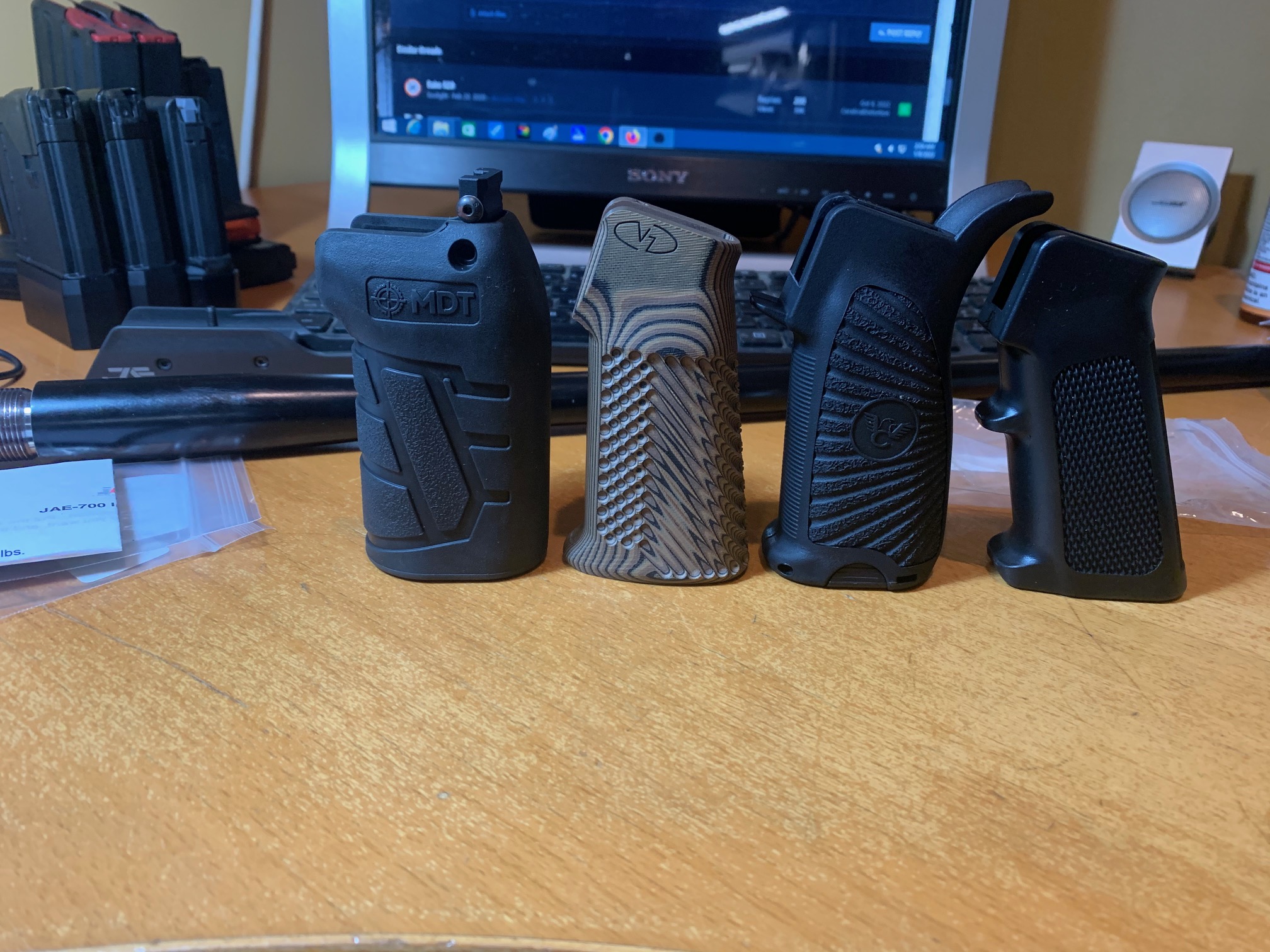

The physical design of the grip itself plays a important part of this. A incorrect fitting grip will have someone start to use the thumb stack. Such as a Ergo grip with a person of smaller hands will not work like intended on a large frame.

2. Grip angle and shape hasn't really been brought up in this discussion, but I think it's important. Shooting PRS style matches with an AR there are compromises. I try to square up behind the gun as much as possible & tend to run a shortish length of pull. Even prone I run the bipod high to keep my head more vertical. This all leads to having my right elbow dropped and a more vertical grip angle is more comfortable especially when wrapping my thumb and trying to maintain the 90 degree trigger press. Likewise a narrow grip profile gives me more leeway to reach the trigger from compromised positions.
I've pretty much settled on the BCM mod 3 grip angle for all my AR's. The Wilson starburst grip is a BCM mod 3 just different texture (my current favorite). The VZ grip also shares the BCM mod 3 grip angle.

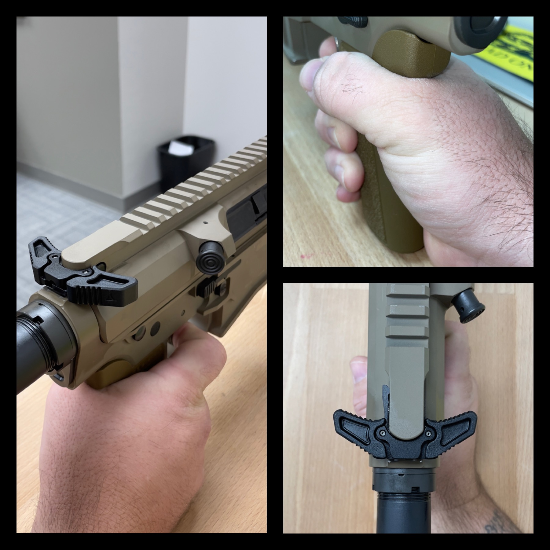

This lack of control from the “Precision Grip” will minimize our ability to control CANT. The AR platform is tippy due to a higher center of gravity.
