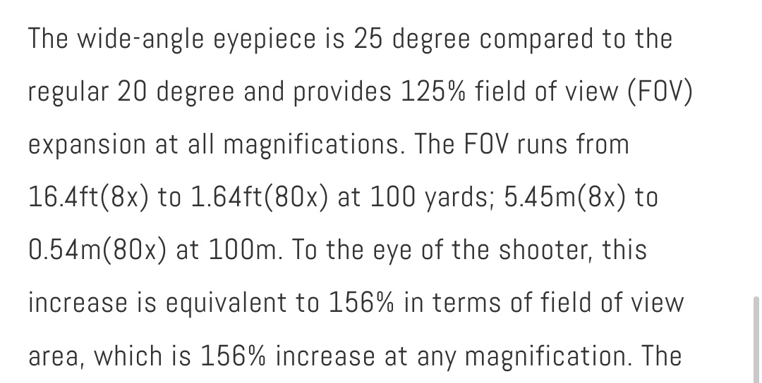

I am not familiar with your term "AAOV" maybe Apparent Angle of View? I use AFOV (Apparent Field of View) which directly relates to the numbers above and is different from the angle of view. For many scopes AFOV is not a linear value so as a general rule I track AFOV based on the max magnification, it's not perfect, but because many scopes struggle at bottom magnification (as you point out with the NX8) and because most users do not use lowest magnification frequently (typically somewhere in the mid range) I just track the one figure at max mag. That being said, Nightforce is notorious for designs that have low AFOV values at min. mag but increase rather quickly (not linearly) - unfortunately we don't know the actual values because we would need precise measuring tools throughout the mag range to identify the AFOV at different magnifications. This is why I've started charting the actual mrad value of hash marks on the reticle but even this is not perfect and can deviate slightly depending on the diopter setting as well as the actual magnification mark vs. the printed magnification mark.
The March Majesta has 25° AAOV from 8X to 80X.
Again, I am not certain what you are referring to as AAOV? But I decided to run the Majesta's numbers through my spreadsheet (which has the formula for calculating AFOV) and this is what I get:
March's specs for Majesta are:
CORRECTION: 16.4' @ 8x and 1.64' @ 80x (at 100 yards)
When plugged into my calculator this is what I get for the Majesta: At 8x the AFOV is: 25.03° and at 80x the AFOV is: 25.06° (I had mistakenly grabbed the FOV values from the non-Majesta scope with the previous numbers)

Not sure where you pulled your majesta numbers from, but the FOV specs March provides for the 8-80 majesta high master with the 25 degree wide angle eyepiece work out to be 24.96 degrees AFOV @ 8x and 24.75 degrees @ 80x. See below...

I use the metric numbers provided: 0.545m @ 80X and 5.45m @ 8X. The US values are 1.64ft @80X and 16.4ft @8X.
The numbers you listed are for the older 8-80X56, not the Majesta.
Well shame on me for not paying closer attention, I did not realize March has a non-Majesta 8-80x56 and I looked again and indeed that was the one I pulled FOV values for. I will edit my post so no one gets confused.
As mentioned above I did not realize there were two 8-80x56 scopes and had inadvertently grabbed the "old" scope specs instead of the new Majesta specs. That said, these are the numbers I am getting when I plug into my spreadsheet:
16.4' @ 8x and 1.64' @ 80x (at 100 yards). At 8x the AFOV is: 25.03° and at 80x the AFOV is: 25.06°
These numbers are slightly better than your numbers so want to make sure my spreadsheet calcs are setup correctly, can you check your numbers again?
Your numbers are correct, as are mine... There is a difference in AFOV depending if you use March's imperial vs metric specs. That's why these AFOV calculations should have a big note next to them that says "dependent on accuracy of manufacturer provided specs." In this case it could be simple rounding error down to 2 decimal places in the numbers March provided if say the metric numbers were rounded down and the imperial numbers rounded up to 2 decimal places.
Ahhh, gotcha. Are you using the same formula on the metric conversion as you do with the imperial? If so that might be the issue. My spreadsheet has the formula you helped me with for 100 yards, but you can't just convert the metric to feet because the metric values are at 100 meters (which is farther than yards), so you have to run a calculation on the metric conversion to get the equivalent of 100 yards (not meters) so the AFOV calculation works correctly. I've had to do this with a number of manufacturers who only list their FOV values in meters at 100 meters. With the Majesta you would take the 5.45 meters and convert to feet which is 17.88 but then divide by 1.093 to get the equivalent value at 100 yards (instead of 100 meters). When I do that the 17.88/1.093 comes out to 16.358 which when rounded up equals the 16.4' that March lists for 100 yards.
It's an angular measurement, so metric vs imperial doesn't matter to the arctan calculation as long as the view width and distance to target are in the same units-- meters, yards, inches, femtometers, furlongs, it doesn't matter and the arctan will return the same value as long as the width and length are in the same units.
99% sure we're just splitting hairs and seeing slight deviations in AFOV between metric and imperial units because of March rounding to 2 decimal places in the specs.
I used meters from the March specs only because it's faster as it saves having to do a conversion from feet to yards.

The spreadsheet I put together allows me to specify "f" or "m" for the values I enter from the various website. My formula uses feet @ 100 yards if "f" or meters @ 100 meters if "m". I did it this way because lots of sites have the values in imperial only and others have them in metric only. When they have both, I use the metric value as that usually seems to be more accurate.
I like this idea of “f” and “m” and think I may put that in my spreadsheet but am curious why your numbers for the euro Schmidt 6-36 were so far off mine?

I'm sure it's because I used different specs than the ones you have. I got them some months ago from S&B website. There were two sheets, as I remember, one for US and on for Euro version. The Euro version had the dual vision thing, and since I was only interested in what people can get in the US, I used the US version and that's why my AAOV numbers are different than yours, I would guess.

US version data sheet has had the wrong data for a year or two now. At least when I checked it earlier last week it still looked wrong to me.
