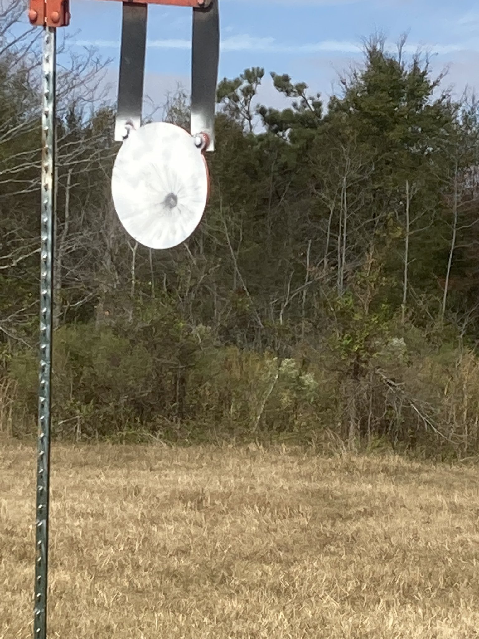

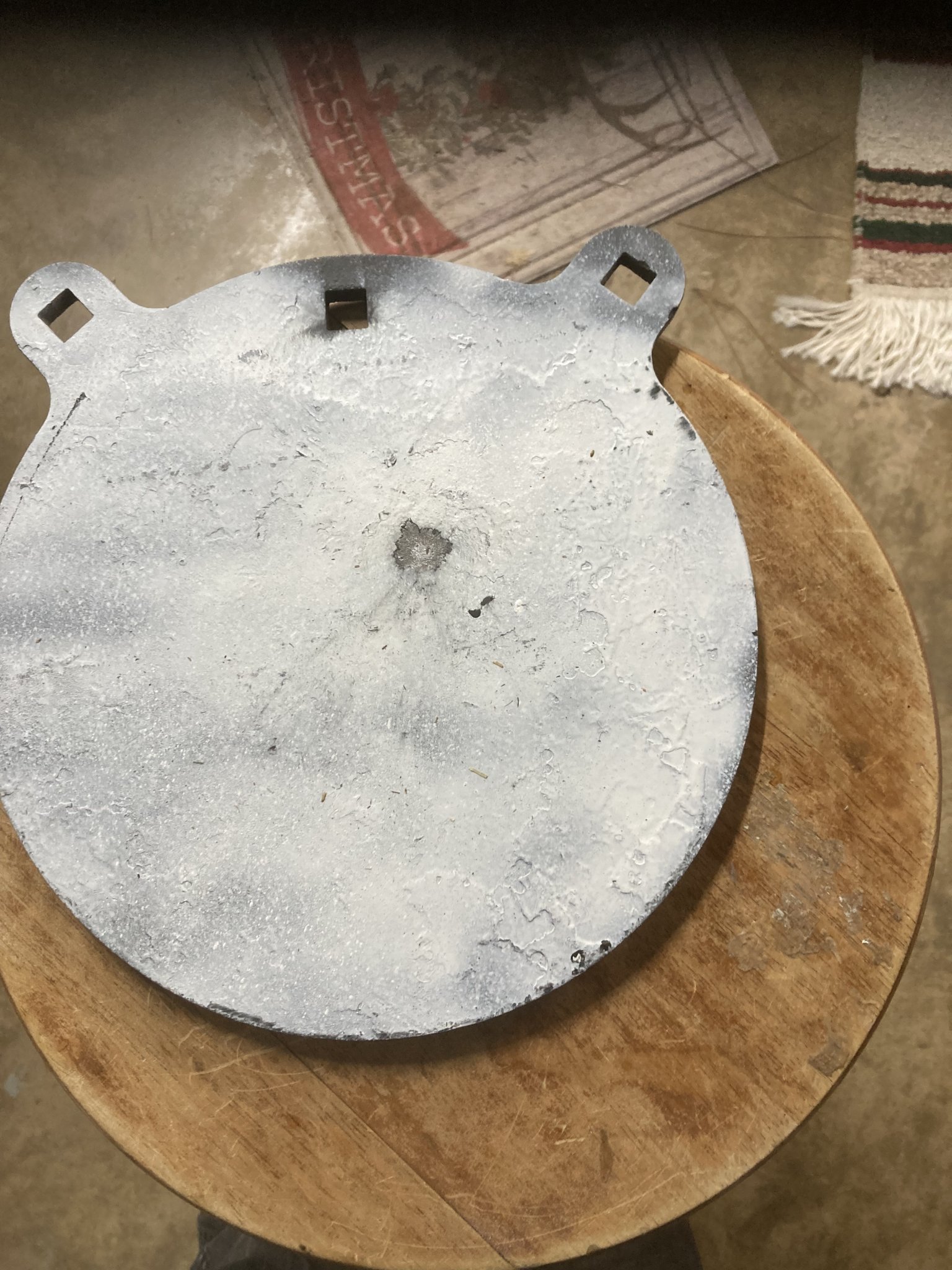

I do like both he 6.5 and the 6GT, but these two targets were shot at the same range, are same size targets but the shots occurred on different days. I’m kinda tied down to the GT these days with brass, bullets powder, primers and two rifles in GT, if I was ever going to change rounds, I very likely would go back to the 6.5.
6.5 Creedmoor 130 grain Berger VLD, range 600 yards Prince Memorial
6GT 105 Berger Hybrid 600 yards, Prince Memorial
The 6.5 Does make a bigger splash.
