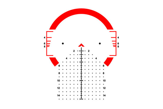

Have you taken a good look at the Griffin Mil reticle?
I mention the reticle first rather than the optic for two reasons: 1) assuming the turrets are repeatable and the glass is at least decent, the reticle is what is going to make an optic shine or make it suck for your intended application. I believe this particular reticle is by far the most well-thought out reticle on the market for an LPVO. 2) The name Primary Arms tends to make people with budget of $1K or more immediately stop listening. However, their Platinum 1-8 is made by LOW (the same factory that makes the Trijicon 1-8, the Nightforce NX8, the Vortex Razors, and several other tier 2 optics). The reviews are stellar and say that image quality and eyebox are similar to the Trijicon and the Razor. The scope is heavy and robustly built and has a lifetime warranty.
The reticle has a large illuminated horseshoe which I love because it is highly similar to an Eotech at 1x, and it is thick, so easily visible without illumination.
The horseshoe houses an apparently very fast (according to reviews) man-sized-target ranging system. At magnification, a 15 mil tall Christmas tree grid becomes visible.
For me, the thing that sets this reticle apart from all the others on the market is that it has a christmas tree AND a fine aiming point. All the other LPVO tree reticles have a big, target-obscuring dot. The tip of the chevron is an infinitely fine aiming point and thus lends itself to precision shooting. Try that with any other LPVO. Vortex razor g3 has a .7 moa (EBR-9 MRAD) or 1 moa (EBR-9 MOA) center dot; Nightforce ATACR and NX8 1-8s both have a 1.2 moa center dot; all the Kahles 1-6 and 1-8 reticles have a 1 moa center dot; and Leupold mark 6 has the finest center dot at .5 moa.

Vortex Razor Gen3 1-10x24 has non-illuminated reticle features that work on 1x. It is no an ideal arrangement, but it is usable.
Here is what it looks like non-illuminated:
And illuminated, though not on full blast:

I'm in the same boat as you (want a bomb-proof FFP LPVO that's as close as possible to a red dot on 1x but capable at distance with great glass) and I've researched this for months.
That looks like a fantastic reticle. I know what I'm going to be looking at in the future. Thanks!
