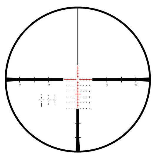

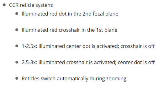

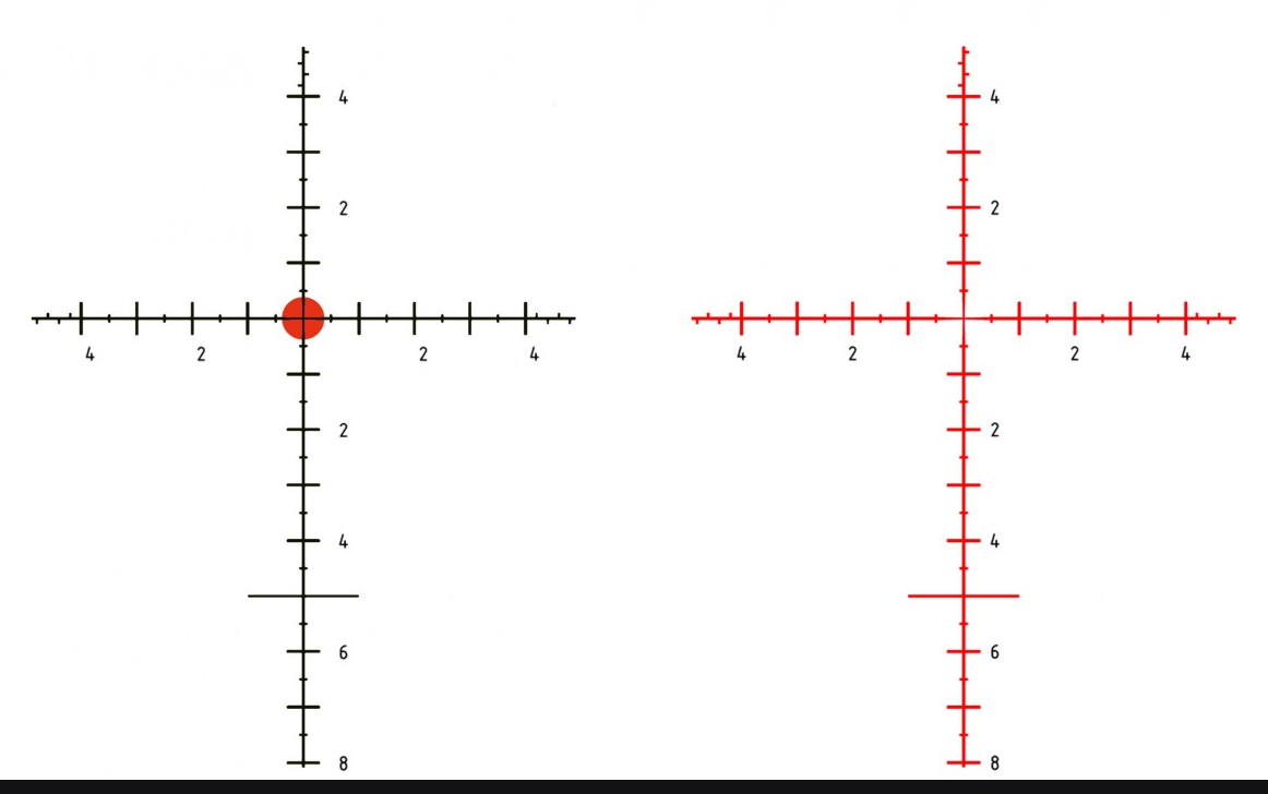

The ZP8 has a very underrated reticle system called the CCR (complete combat reticle). They absolutely suck ass at marketing & thus not a lot of good info out.
As described below the reticle is automatically in the second focal plane from 1-2.5x & it automatically switches reticle illumination & focal planes as you dial past 2.5. 2.5-8x is in FFP (pictured below 1-2.5x on left & 2.5-8x right).
Now what Minox doesn't tell you & they should (@koshkin will hopefully way in), is that the parallax also switches automatically from 50m @ 1-2.5x to I think it's 210m from 2.5-8x. This means once diopter is set you should get a more focused image near to far vs something with fixed parallax like the NF Attacker (and thats asuming glass is equal).

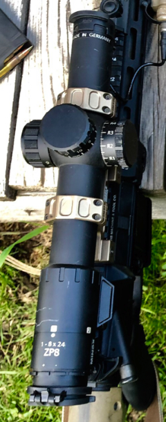

Not a scratch on that turret? And to OP's point about batteries dying. With this reticle even without the large Red dot, it still draws my eye to center.
Edit: might as well add this since I don't typically see it provided in the ZP8 info.
The MR10+ reticle in the ZP8 is equipped with specialized markings to determine the upper body sizes of the targets. Not only can the torso height of 1 m (39.4”) and shoulder width of 50 cm (19.7”) be determined as a reference measurement, but also the height to the shoulders of 70 cm (27.6”) and the height from the shoulder to the top of the head of 30 cm (11.8”). The distances between 300 m (328 yds.) and 800 m (875 yds.) can be directly determined without calculation steps.

That friggen Minox better have a foundation under it. 4k optic.
I know, very proud of them they are Hmm (insert Yoda emoji). Street price looks to be about $2400.

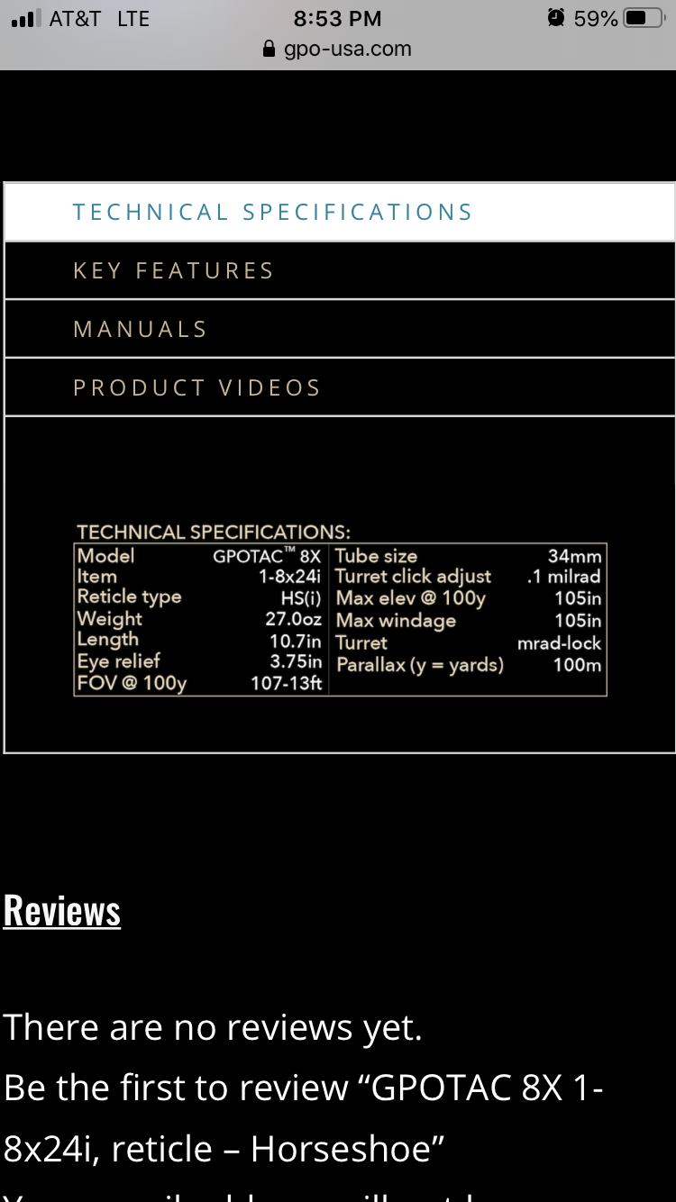

Anyone have any info on this one?
Looks like a little less field of view then ZP8
112'- 14' (ZP8) vs 107'-13' (GPO tac)
It's also a little heavier, a little shorter, & less $$
In the specs from the German web sight, item below caught my interest? I wonder if it is a variation on Minox's 2nd - 1st focal change?
From the terrible description I get the impression their somehow magnifying the FFP reticle when it's on low or 1x power.
Reactions: JDB55
Call me crazy but 27 ounces seems heavy. Also the spec sheet seems odd. Says mils but lists the max elevation and windage in plain inches not even moa?
Also parallax also says Y-Yards but then lists it in Meters?
I agree, it's 1/2" shorter then Minox & weighs 5oz more. That's like 3 pieces of heavy metal from a buffer tube. If that equates to durability it might be a beast best suited to a battle Scar!
Their 1-6 GPO tac looks more reasonable @ 20 oz with 30mm tube, but still has what looks to be a pretty good reticle and locking turrets.

What reticle do you prefer?
The FMC-2 looks interesting for low power, but looks like it would give up a lot of usability at the 8x power end?
The FMC-3 looks like it would be great at the high end but no so good at 1x ?
