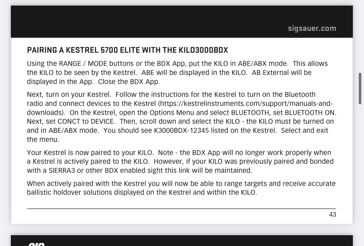

You don’t have to have your phone open.
You need to put the BDX 3000 in applied ballistic mode (ABX) and connect via Bluetooth to the kestrel and not your phone.
Thats a part im lost on, can you expand on it for me? Thanks
when you pair the kestrel with the bdx, with the bino in abx mode, all the job is made on the kestrel. the kestrel has its compass, not the best in the world but there it is. the bino does not have a compass so when you hit the range button it sends distance and angle from shooter to target, but not the direction of fire. the applied ballistic engine on the kestrel needs you to enter the direction of fire of the actual target to give you the right windage solution
