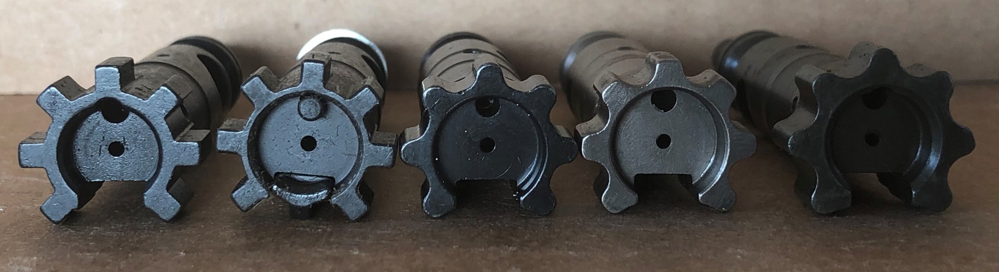

Opinions LOL. The Maxim bolts made from 9310 are probably better than most, at least they are not Nitride/Melonite QPQ treated. I would go that route before buying a nitride treated Ultrabolt.
ETA- Bolt lugs are .100" thick but the web between the lugs is only around .040". That web if too brittle will break and then the lugs break. to keep it from breaking the center should be ductile but tough around 50 rockwell, the surface apx .015" deep should be 60 rockwell. Melonite QPQ will not harden to that depth so it is not a good option for a single heat treat. If the bolts are gas carburized per spec the hardness can be dialed in perfectly. They check the case depth by cutting a bolt in half. If the bolts are Nitrided after being gas carburized the 2nd heat treat will soften the case hard previously done by gas carburizing. It doesn't completely anneal the material but it does soften it and over time the lugs will compress. Someone here or on M4carbine posted photos of some compressed lugs in the last few months.
The UB appears to use the extractors from Black Rifle Arms in New Smyrna Beach Fla. https://www.blackriflearms.com/BOLT-ASSEMBLIES-PARTS_c_12.html The UB also looks to have the same exact dimensions as mil spec bolts except for the .136" deep and .448" dia recess so I don't know how they can claim to be the strongest made. Doubtful they are 9310 Vac Arc at the price point he is selling them for since that material has doubled in price since I stopped using it. It cost $1284 per 12ft stick buying a dozen sticks at a time which is enough to make 576 bolts but we round off to 500 for waste. Normal 9310 cold rolled annealed is more inline with his price.
I stopped machining the 750XD and Titan bolts around 2015, left to right 5.56, 6.8, Titan (243 and 264 LBC), 750XD, 800 series. The 750XD and 800 were made for wildcats using a 308 diameter case in the AR15.

I never used it on bolts but back when everyone started Melonite treating barrels the extensions were being melonite treated. I had to remove them, clean and retorque to get the torque value up to spec. During that time I noticed the extensions were soft so when LRRPF52 said they were too hard and too brittle I took a silver extension(the ones everyone thinks is stainless but isn't) and hit it with a 4lb sledge, it shattered into 10-12 pieces. Then I took a Nitride treated barrel extension and hit it with a 4 lb sledge and it folded up flat only splitting at the side where it bent 180 degrees. That is a quick common sense way to see which is harder and which is softer. Later when I had time I sent the to the lab where our bolts were checked for hardness and case depth which told me the same thing. At that point I stopped letting H&M metals (who told me Melonite would not harm the extensions or cause them to loosen on a barrel) treat the extensions.
A little later a customer was pushing his loads pretty hard, he called and said his headspace had increased and sent the barrel in. He was correct the lugs on the barrel extension had compressed almost .010" further proving Melonite/Nitride treatment softens an already case hard part.
I'll try to find the thread where the guy posted a photo in the last few months clearly showing bolts lugs compressed, it had to be here or on M4C.
