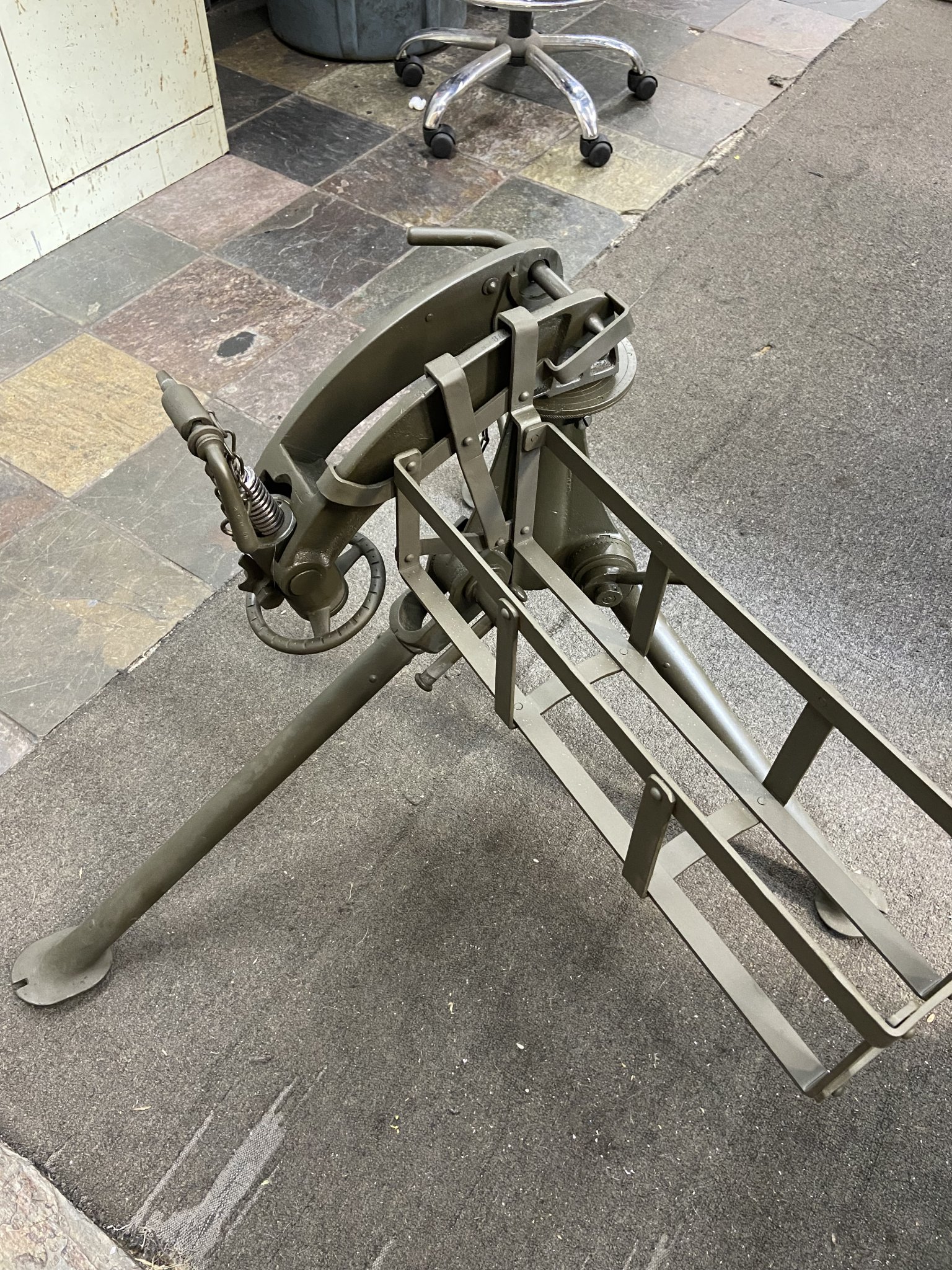

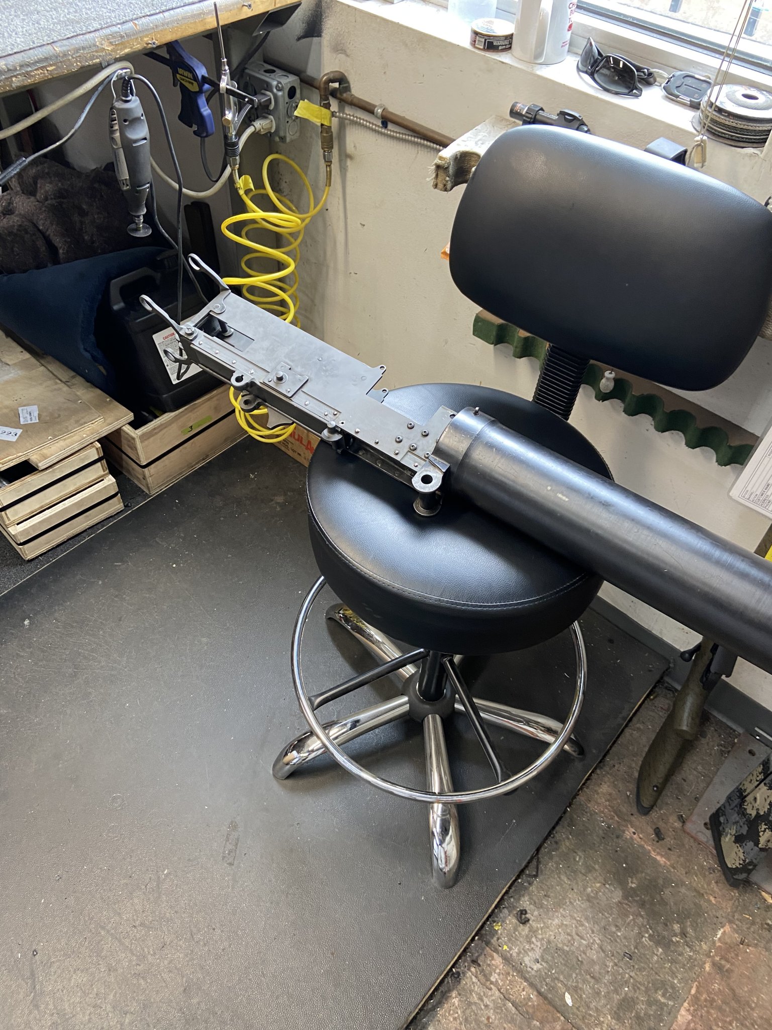

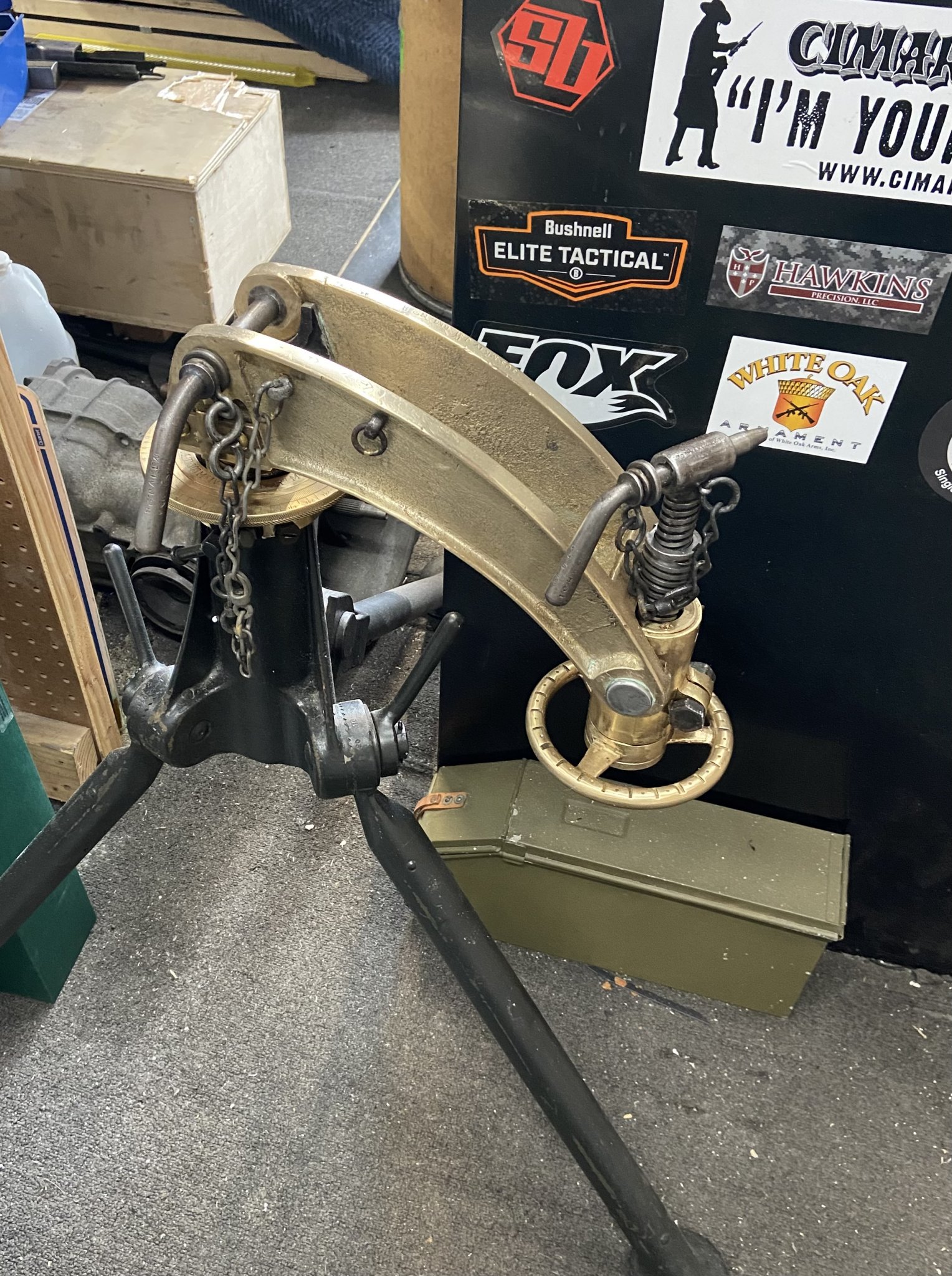

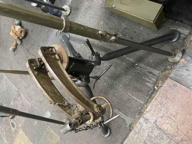

Decided I needed a water cooled project. colt 1917 parts kits seem to be non existent, as do a lot of the old parts kits, seems I’m about 15 years behind the power curve. Well I found a vickers “display” gun and thought I’d take the gamble and got it. Got it before I even knew much about them but here is the gun as it showed up, along with the tripod.

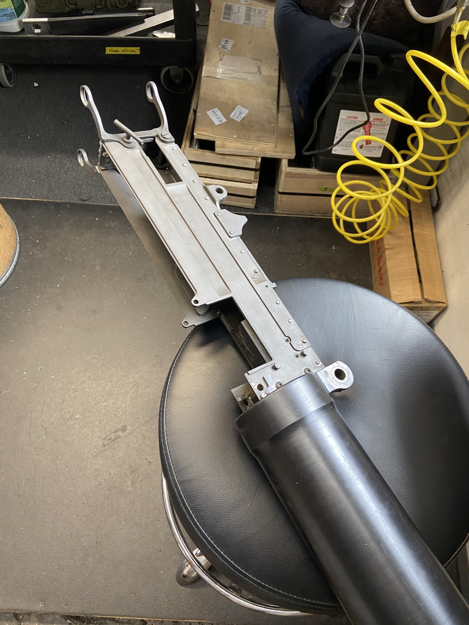

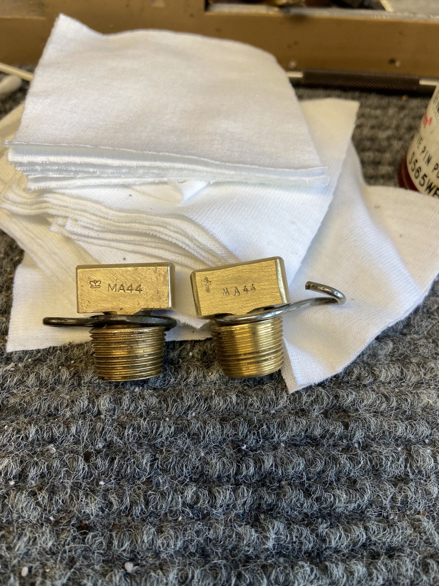

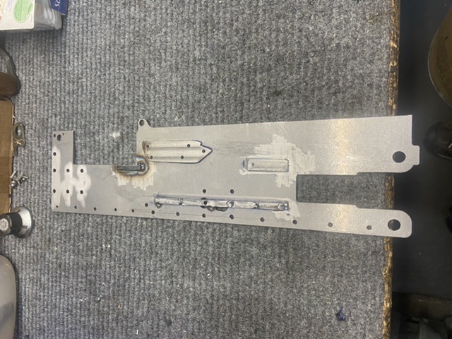

It had a lot of good parts(mainly all Australian MA 42)seemed to be original bluing on the water jacket. Discovered it’s recoil plates were both chopped in half, missing the water tube adapter, missing one water jacket plug, no cork, both side plates were fake with welded llatws on onside to prevent installation of real recoil plates, here is it being river popped and taken apart
View attachment 7895927View attachment 7895928Decided I needed a water cooled project. colt 1917 parts kits seem to be non existent, as do a lot of the old parts kits, seems I’m about 15 years behind the power curve. Well I found a vickers “display” gun and thought I’d take the gamble and got it. Got it before I even knew much about them but here is the gun as it showed up, along with the tripod.

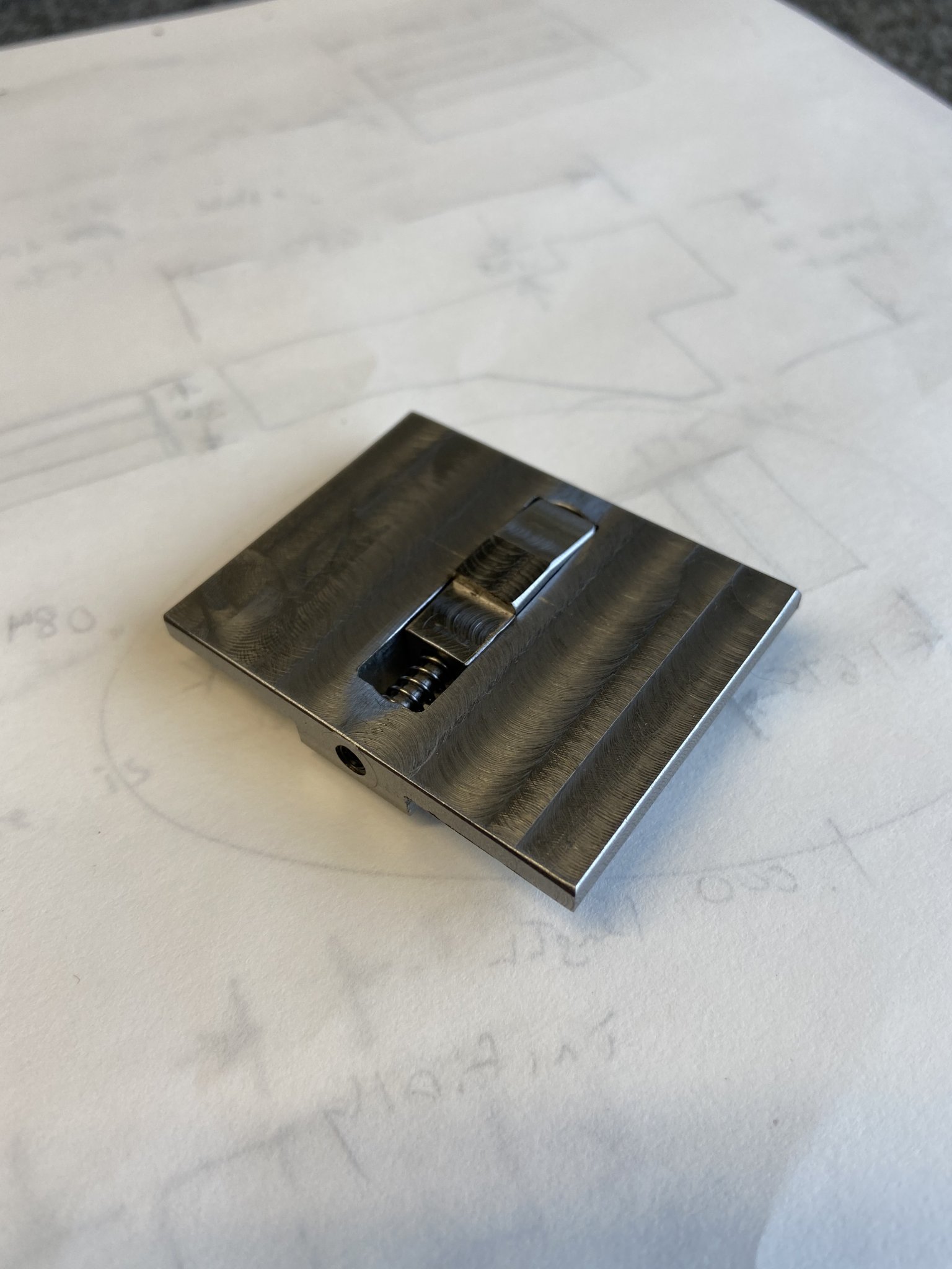

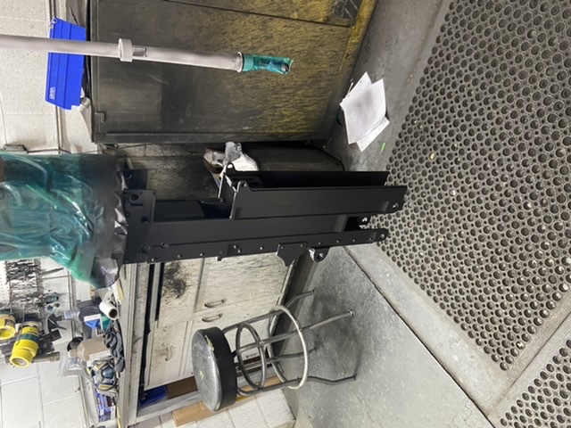

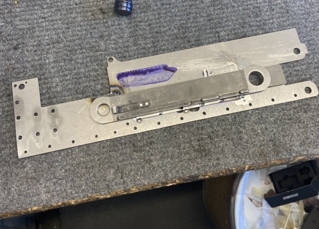

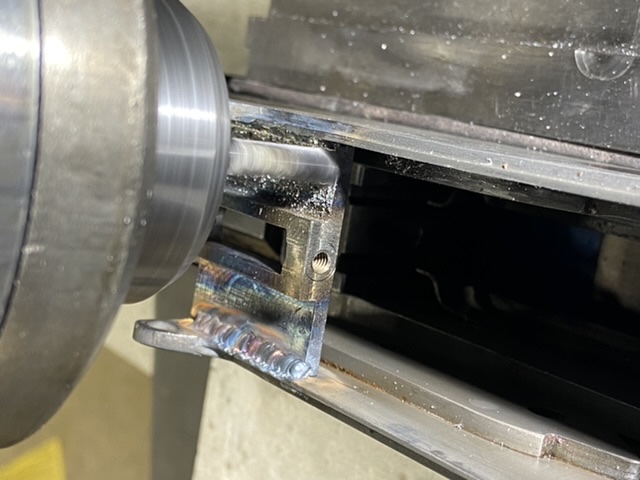

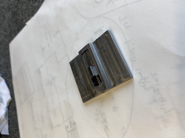

For the atf worried types, this is a semi auto conversion, follow along. Found one lone set of recoil plates, cost more than my house, but they just aren’t out there. Had to modify the right plate to fit through the denial blocks on the right side plate. Manufactured a denial island and welded it in after riveting the side plates together, then milled welds clean

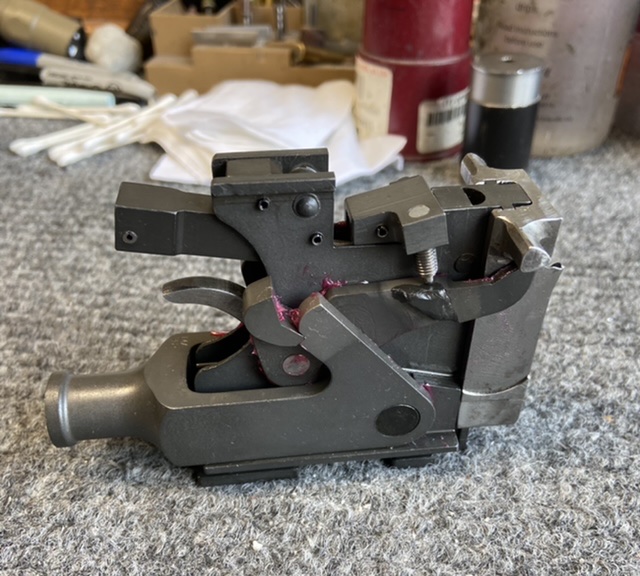

View attachment 7896194Then came the tedious task of doing all the conversion mods to the lock. Basically making it have a disconnector. There are a few websights with pictures like vickersblog, I’ll spare you all the in depth process or pics of the process but here is my modified lock assembly finished

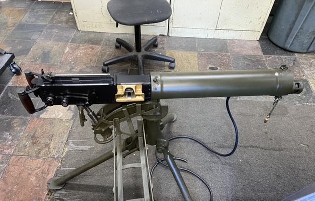

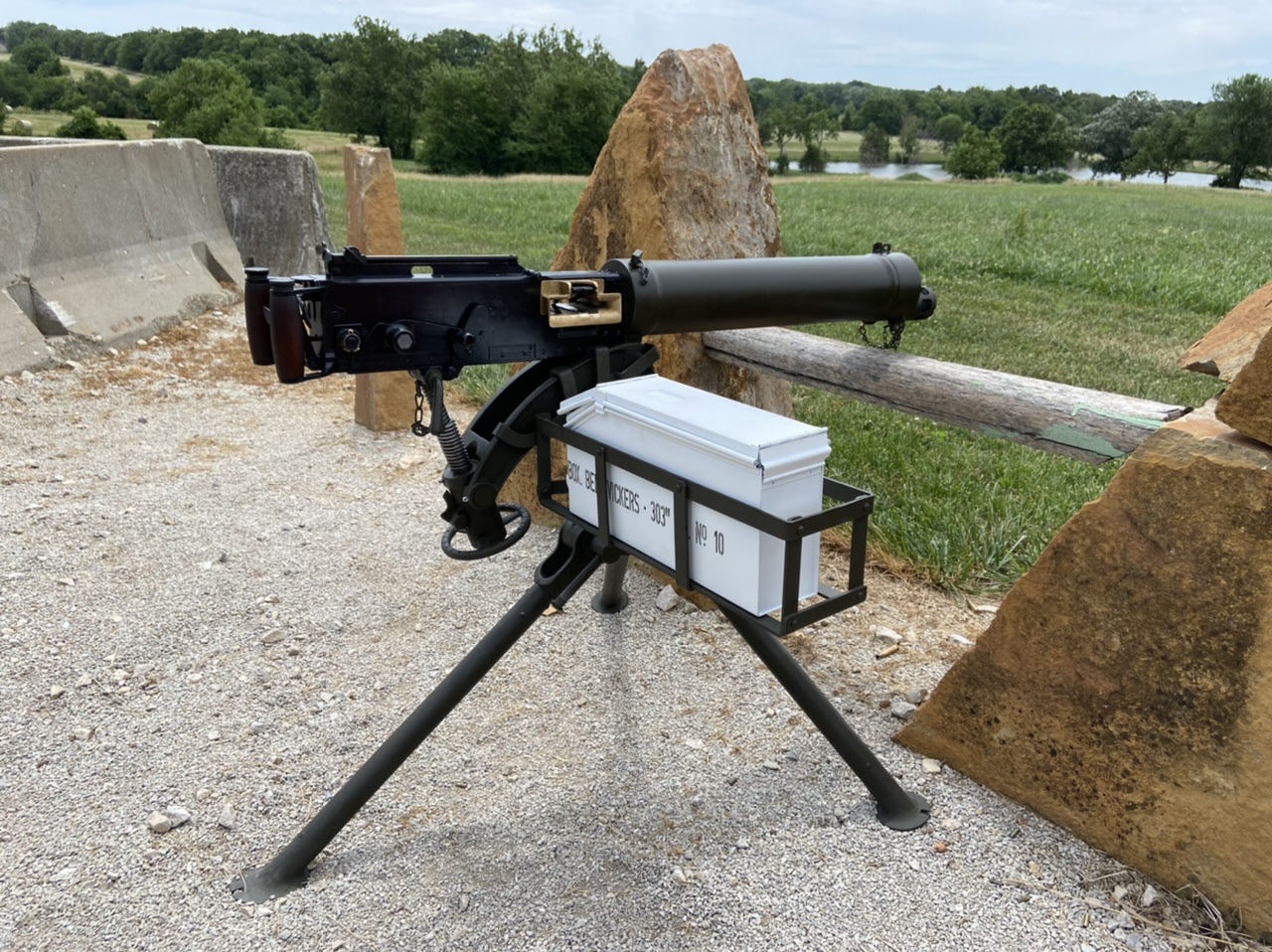

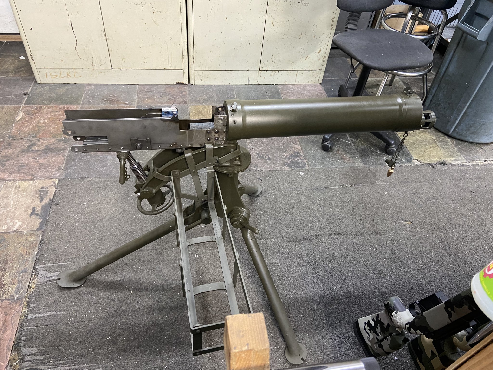

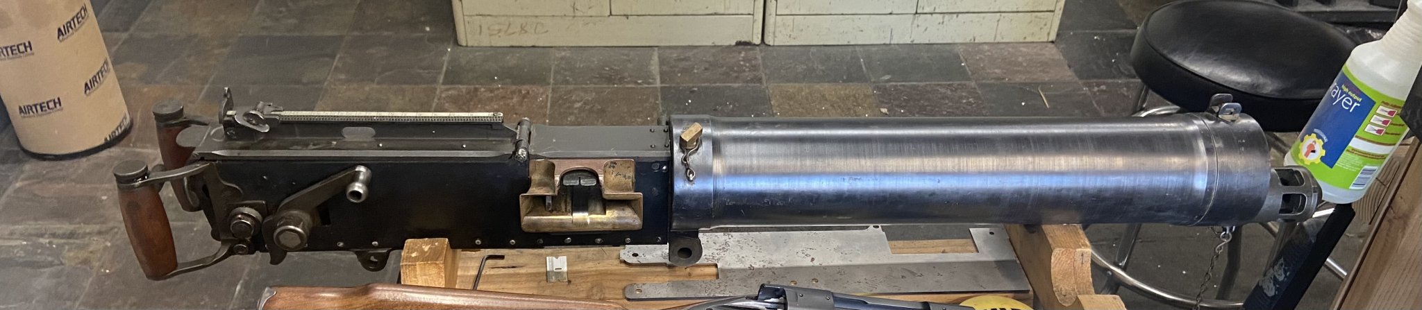

So from what I could gather historically, the guns were shipped completely blued, then the units would brush paint the water jackets green, varying in shades of green depending on what nation what unit etc. Basically correct would be all blued or blued reciever with various shades of green water jacket. So I went with a somewhat restoration concept but only loosely. I cerakoted the water jacket Magpul OD
Maybe some of the history guys can chime in on more accurate colors for these, I just went with what I thought looked good

Thanks, very interesting. I like the one on the right of the Nicholas and Alexandra screenshot, shows the I believe German army mustard turd dierrea brown paint that I’ve seen pictures of. Never want to paint mine that color but it’s interesting and stands out from all the green ones
I liked that pic too. Chose it specifically because of the two different colors. As I said, since they're in movie armory inventories, I dunno what they might've been used for before that particular movie and it doesn't mean the colors are accurate. Look at how a lot of WWII movies paint their grenades the wrong shade of green/brown or omit the yellow band or even don't paint them the yellow color of early-war grenades, for example. And film quality and lighting have their say in it too.
But I'd say you have good enough reason to color yours as you did and it doesn't look half bad either, so I wouldn't worry about it too much. A picture on Wikipedia looks like it's painted white for the winter, so you could've gone that direction if you wanted. If it were me, I'd have gone with the closest to typical British Army Green-brown, and then painted over that with a khaki color for that El Alamein look, haha.
