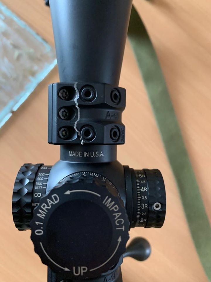

Hello to all of the forum members !
Sphur mounts are very popular in the shooting community around the world and I personally use their products with great results. However, for the last couple of month we had a number of issues reported with Sphur mounts among Ukrainian shooting crowd. Snapped rings for instance, where people are sure they did all the mounting by the manual...
So decided to create this post to see more global statistics and prove that above mentioned problems are a question of user errors. Please, write your experiences with Sphur, especially negative ones if there were any.
Is it possible those mounts were counterfeit? I know some manufacturers of popular items have dealt with product returns that were determined to be fake. I believe Kasey can speak to this concerning his Atlas Bipods.
Assuming they are not counterfeits with the Spuhr name, they are out there, and assuming they are torqued correctly and evenly, the thing I noticed in the picture was that the clamp was right where the bell for the objective was increasing. Maybe it is the camera angle. If so I would move the bell away from the clamp more as this could be inducing a stress riser through the clamp because of two different diameters, even if it is a small difference. When I torque mine, I half torque the screws, then go full torque.
that is the camera angle.
I have five ISMS mounts, and lots of "accessories" hanging off the sides and tops ... I tighten to 25 i/p and have had zero issues. My five were acquired over the past 30 months, with two of the five in the past 6 months.
Reactions: Shooterpaddleman
While I was torquing a Sphur mount to a rail, the screw failed and stripped a bit. Of course this is a screw, not the mount itself and MileHigh had a new set of screws in the mail the same day. Pretty awesome mount that even comes with alignment shims (if that is what you call them).
Edited to add MileHigh sent the screws at no charge, not even shipping.
@Shooterpaddleman
there were an early (called gen.1) ISMS mounts which had bad design around screw holes on the ring clamps - there were no enough material left, so rings were prone to crack (like your ones). There are a few photos on this forum with this gen.1 mounts with cracked rings. I thought that Spuhr updated the new design for more crack resistance...but you bring the same thing with gen.2 too, strange.
edit: not the same thing - your ring is cracked on the different place, not over screw holes, but above them ( ! )

@Shooterpaddleman
Had this happen too. Spuhr was aware and replaced the ring for me. No issues with my other Spuhr mounts.
