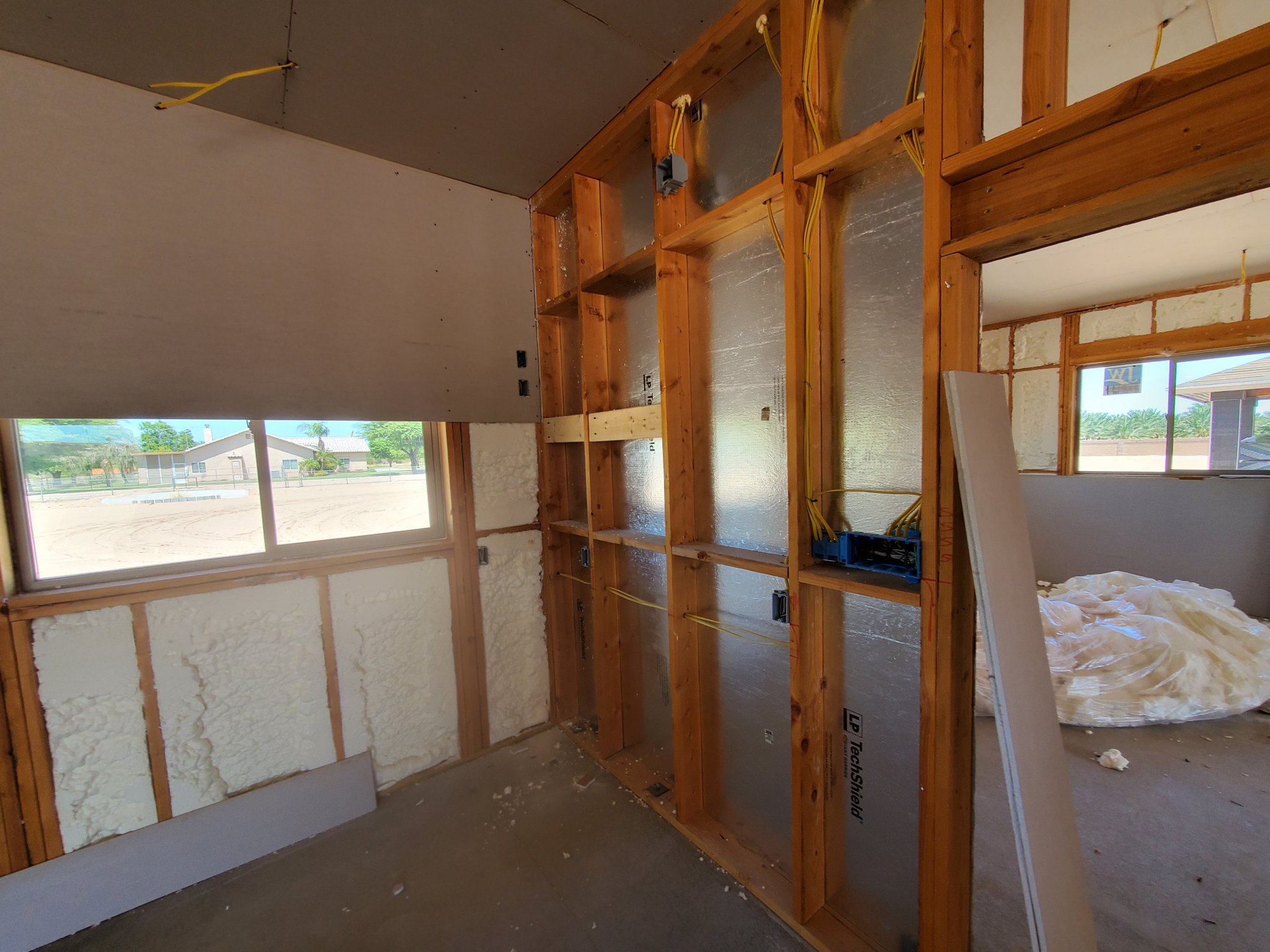

Just had our new 3100 SF house and 1800 SF shop done in southern AZ. Did open cell on everything.
Could immediately tell major difference and the house is amazingly quiet inside.
Reactions: 338dude
