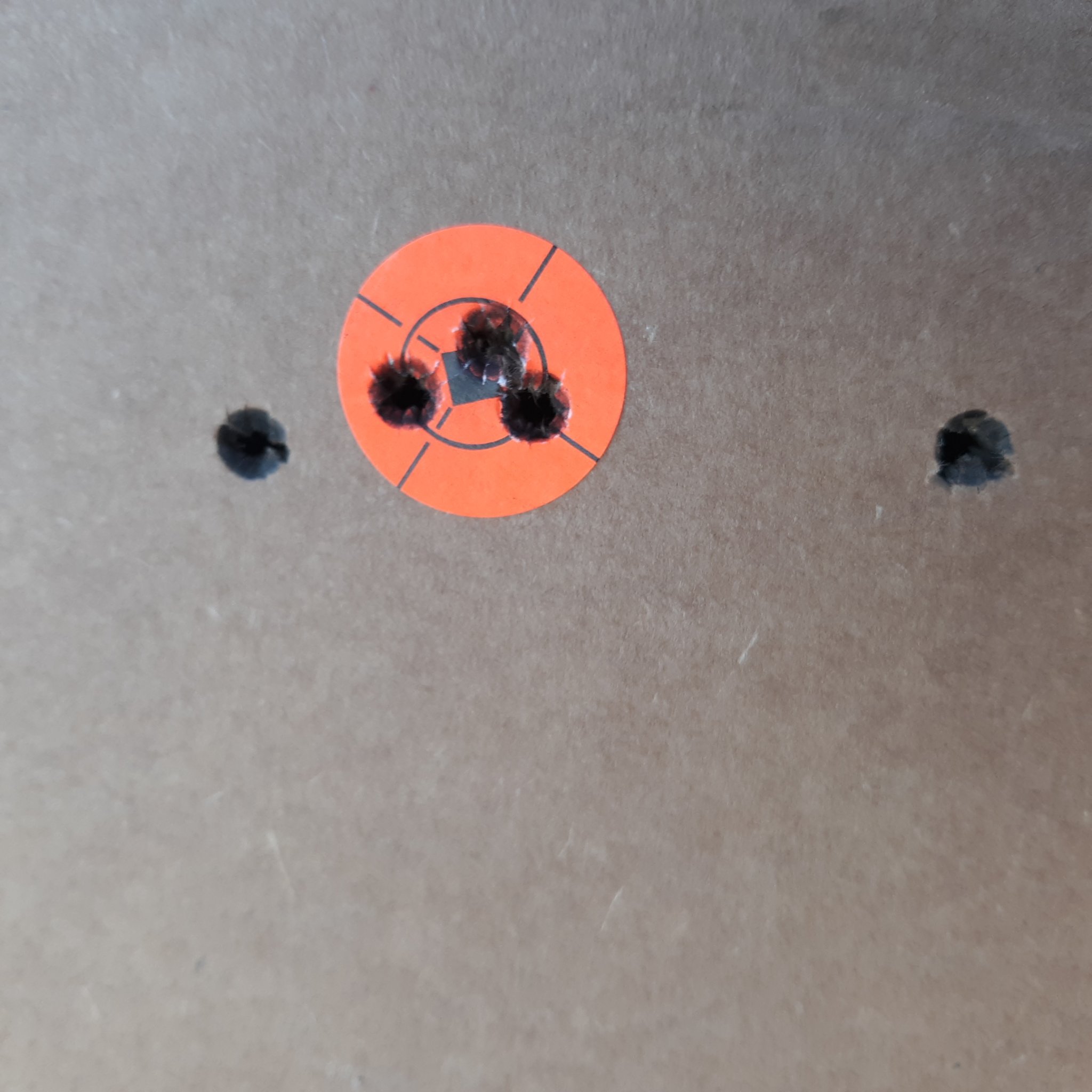

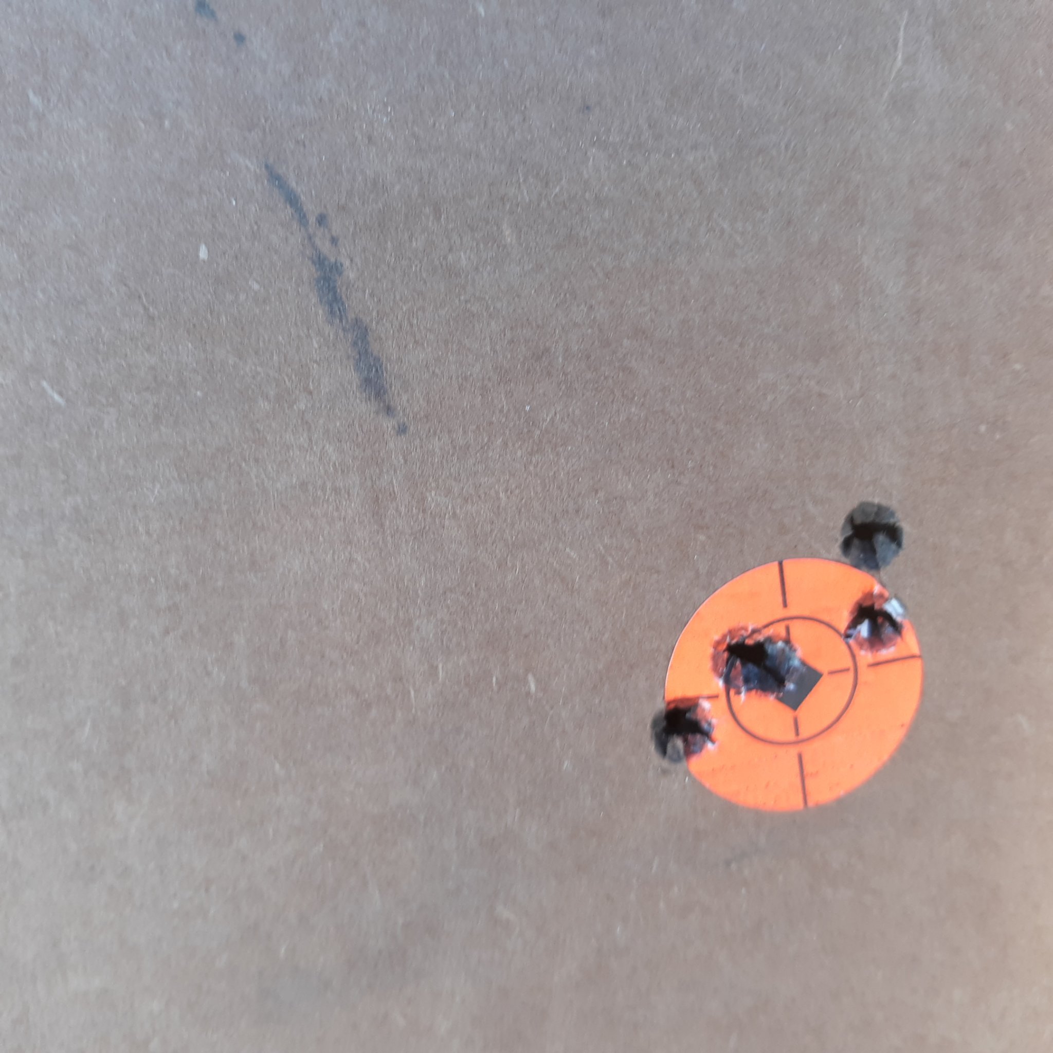

I've got some staball 6.5 powder to play with. The rifle is a R700 in 6.5 cm. Hornady brass, CCI large rifle primers and Hornady 140gn ELD-M bullets. Overall length is 2.8 inches. I started at 40gn and worked up to 44gn in .5gn increments. My best group was at 40.5gn. Has anyone else tried staball 6.5?
I've got some staball 6.5 powder to play with. The rifle is a R700 in 6.5 cm. Hornady brass, CCI large rifle primers and Hornady 140gn ELD-M bullets. Overall length is 2.6 inches. I started at 40gn and worked up to 44gn in .5gn increments. My best group was at 40.5gn. Has anyone else tried staball 6.5?
I've loaded it but haven't shot it. 43.8 is book max for my 147 gr eldm. I started at 42 i think, then went up in .2 increments. I loaded a ladder test for my chrono but haven't had time to put the new barrel on and shoot it.
Just got 2 lbs since 4350 and RL16 are running low. RPR with 140ELD in Lapua brass and was going to start at 41 to about 44, so ill be following.
went yp to 43.6 saw a few decent loads with 6.5 stabal none were where I wanted to be speed wise even up to 43.6 gr But at slower than 2600 i got some nice groups even if not all of them had great looking numbers . I did get confused by the numbers when I switched neck tensions went from 3 thou to 1.5 and to a .5 as I did the sd's got worse and speeds dropped I have to try this again when I get the chance over all if you can work with a slower speed it's not a bad shooting powder but not my favorite powder of the bunch we were able to get . best of luck to you and your loads .

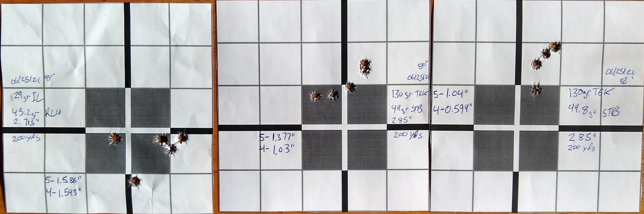

@8pointer uses 43.8 with his 140gr Manbun loads.
Very good shooting load.
I used it in my old barrel at 44.0 and it worked great.

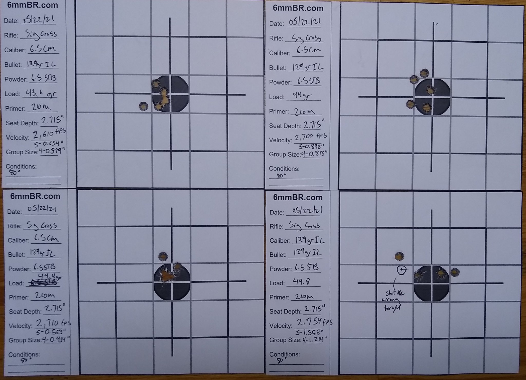

Tried it in my 6-BR with 105 Match burners. Got 2815 with a 26" barrel.
Used the same cases with the incorrect neck bushing that increased neck tension by a huge amount.
Accuracy was the same, but velocity went up to 2880.
Totally crazy response from the powder. Seems that it might prefer to have higher neck tension which will create an earlier peak pressure and give more velocity.
It would be fun to play with a pressure test barrel to verify this.

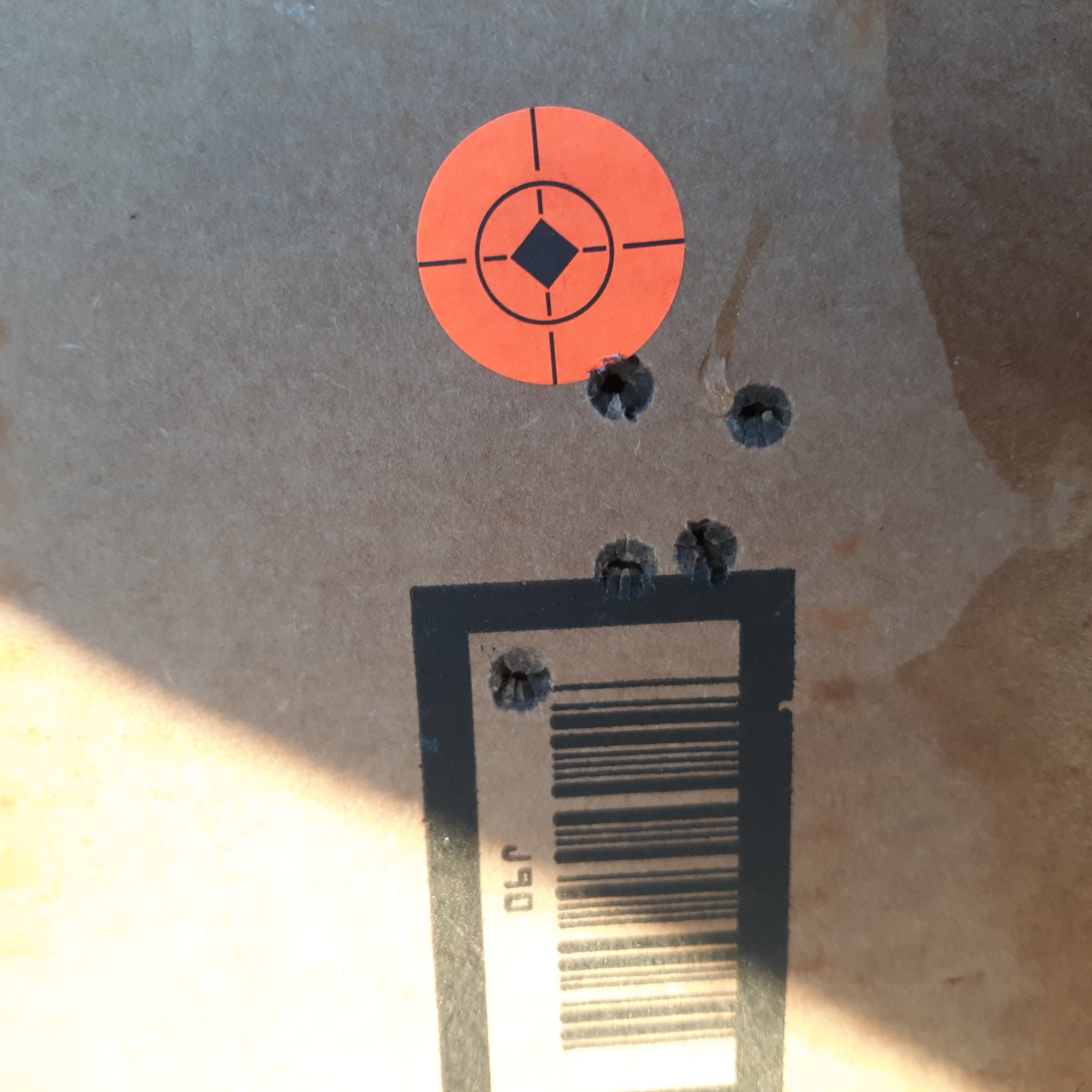

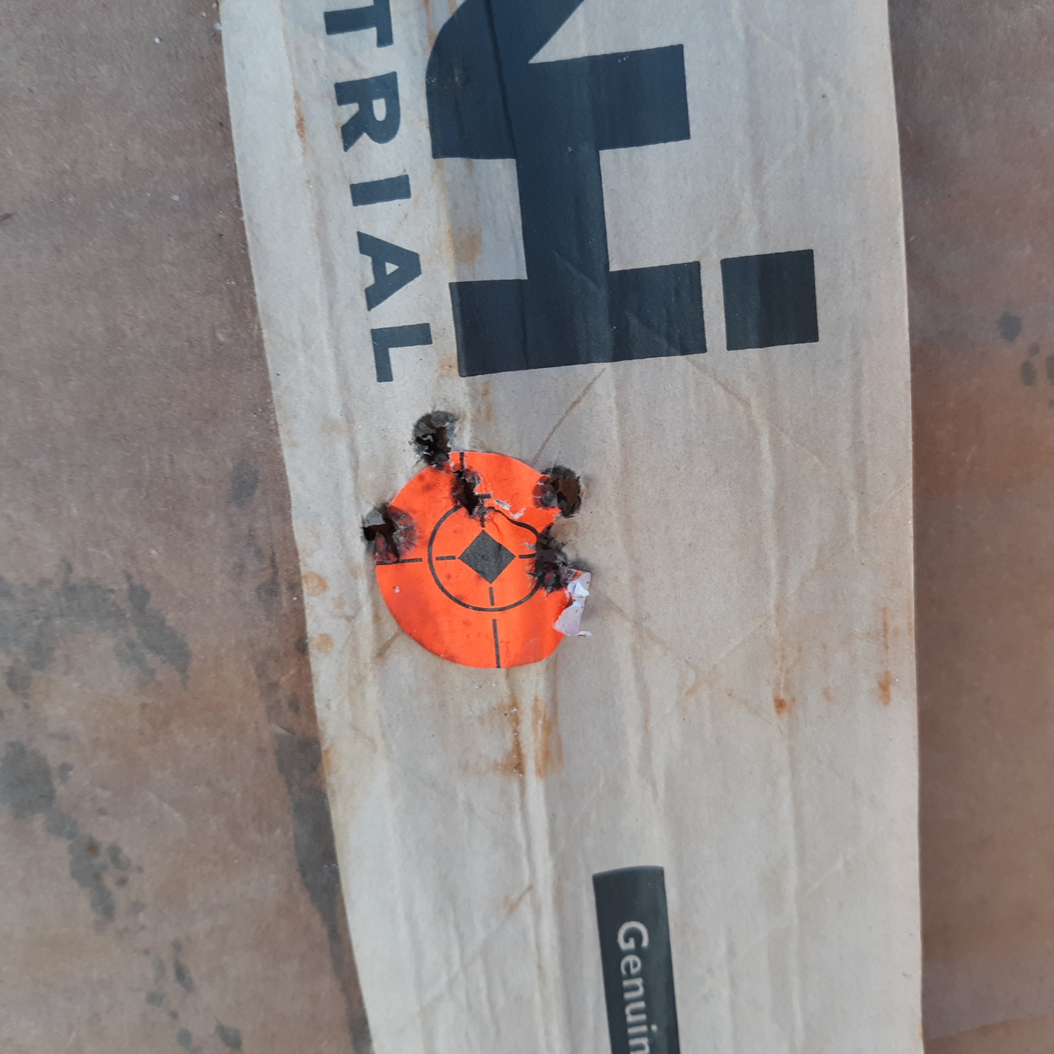

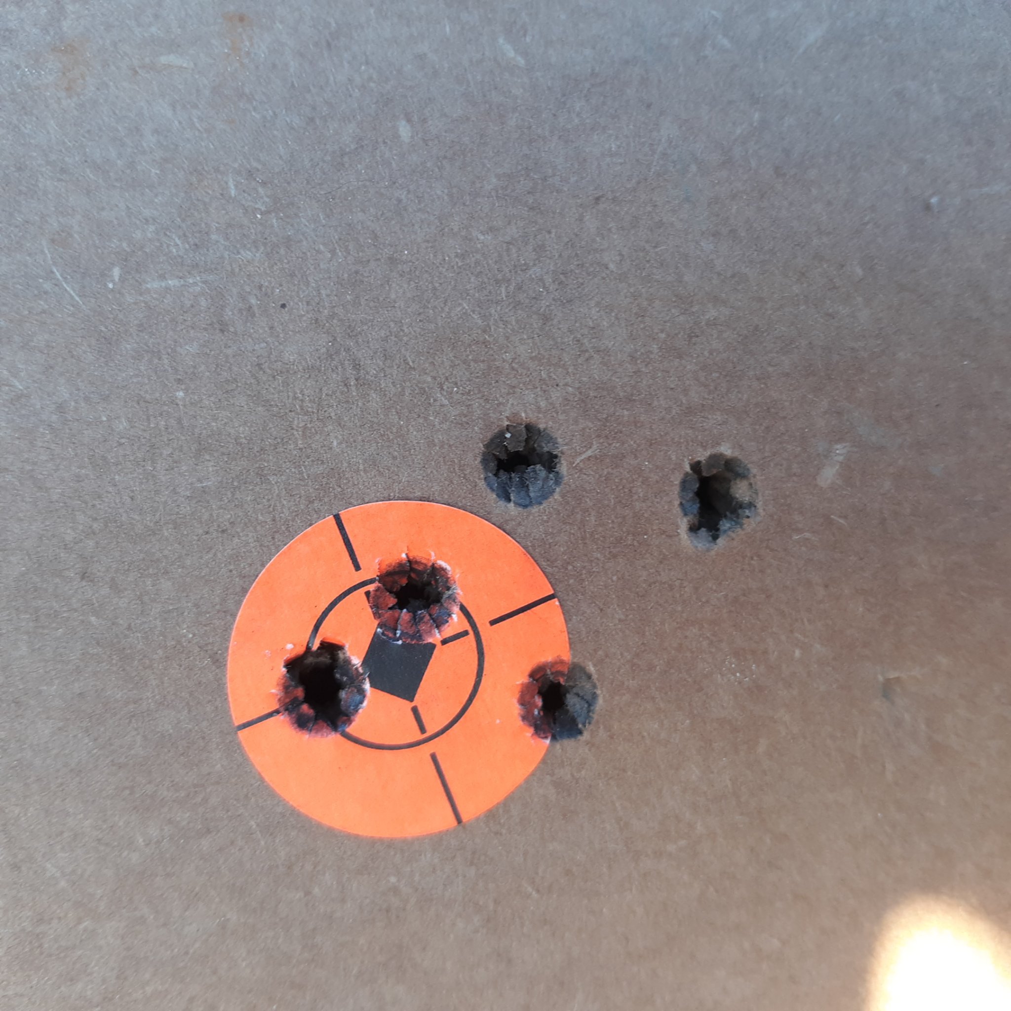

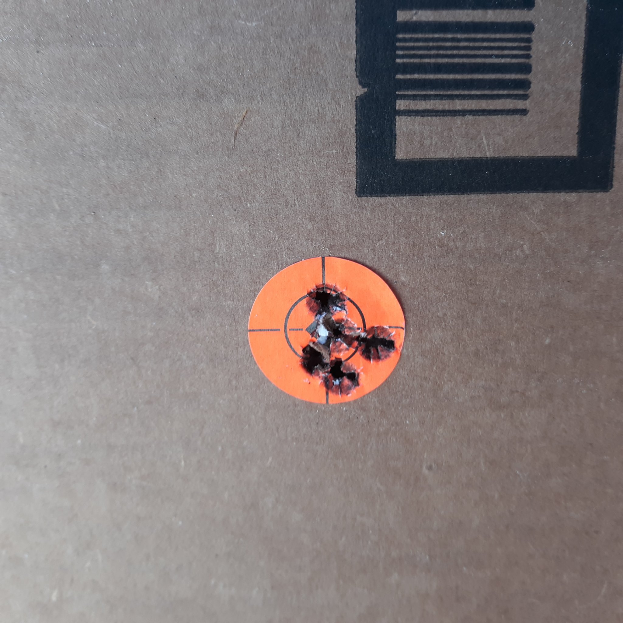

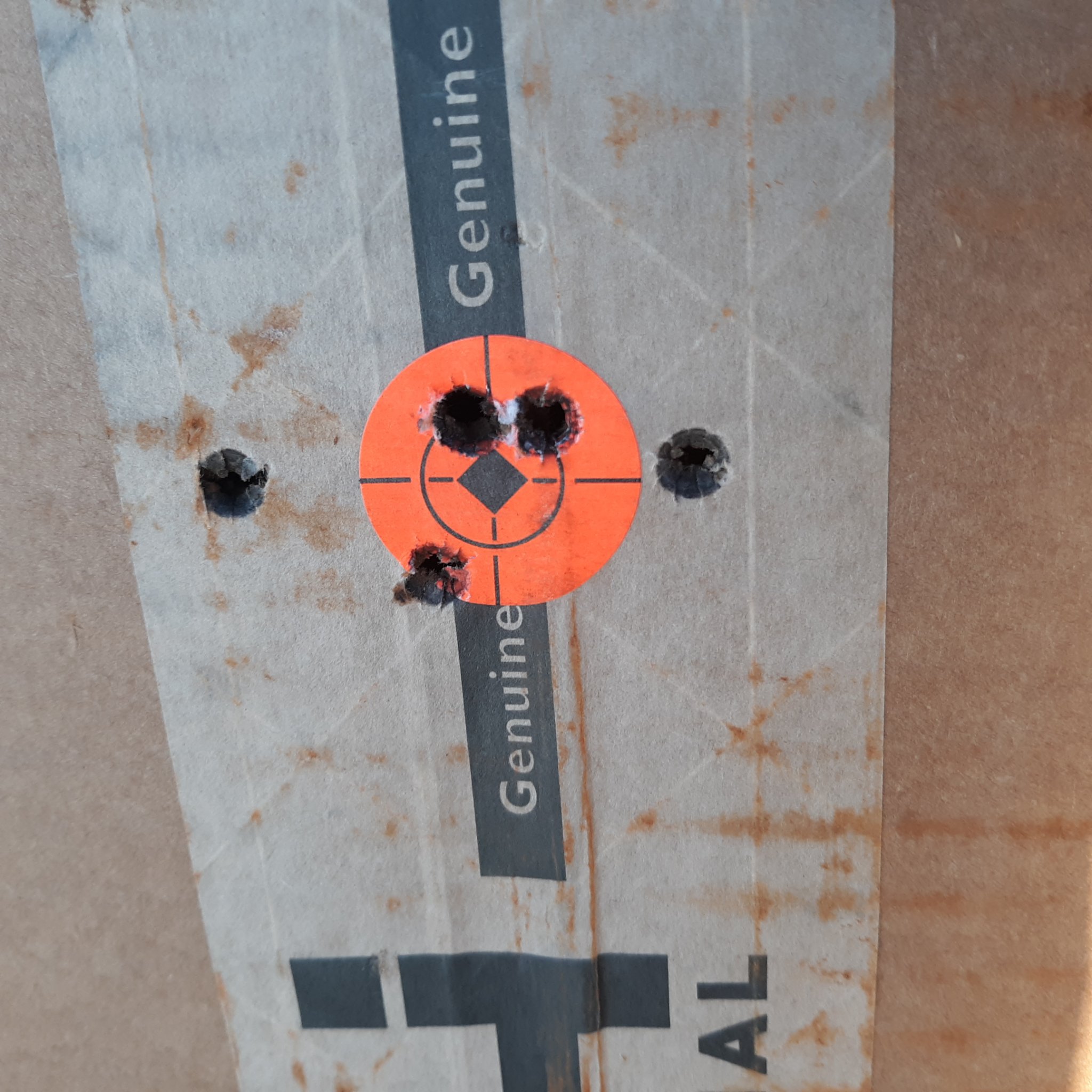

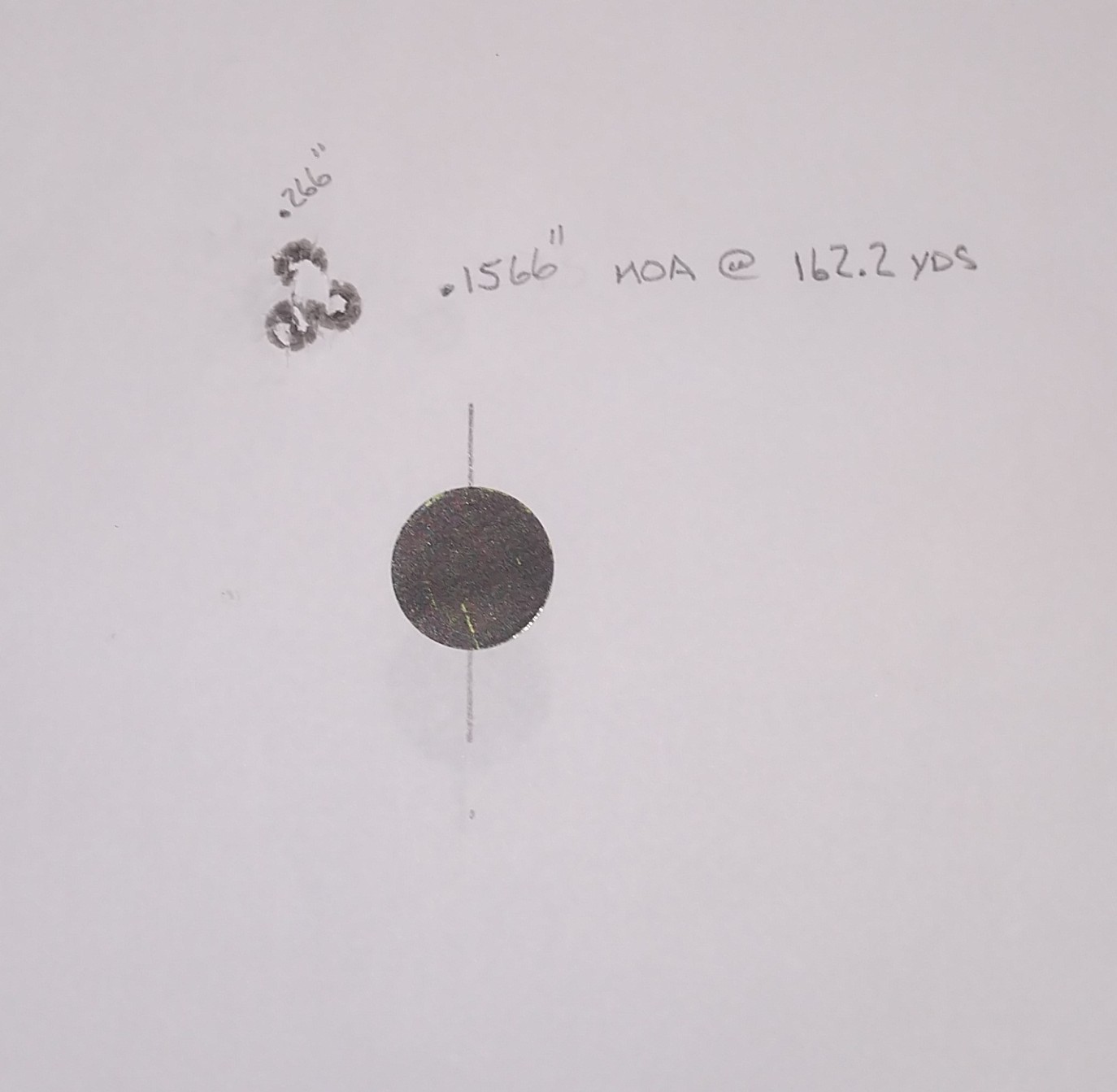

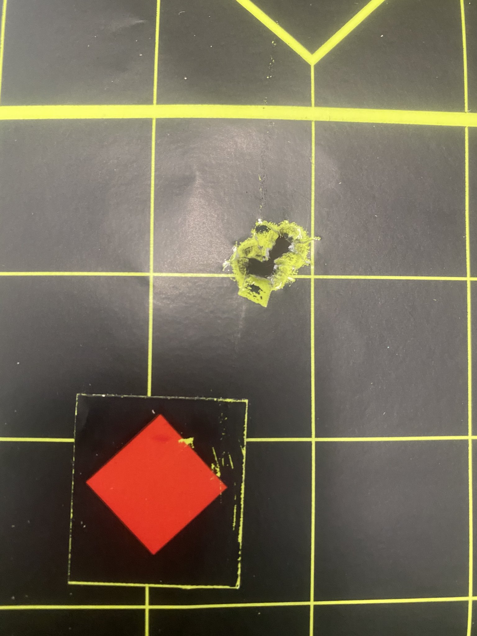

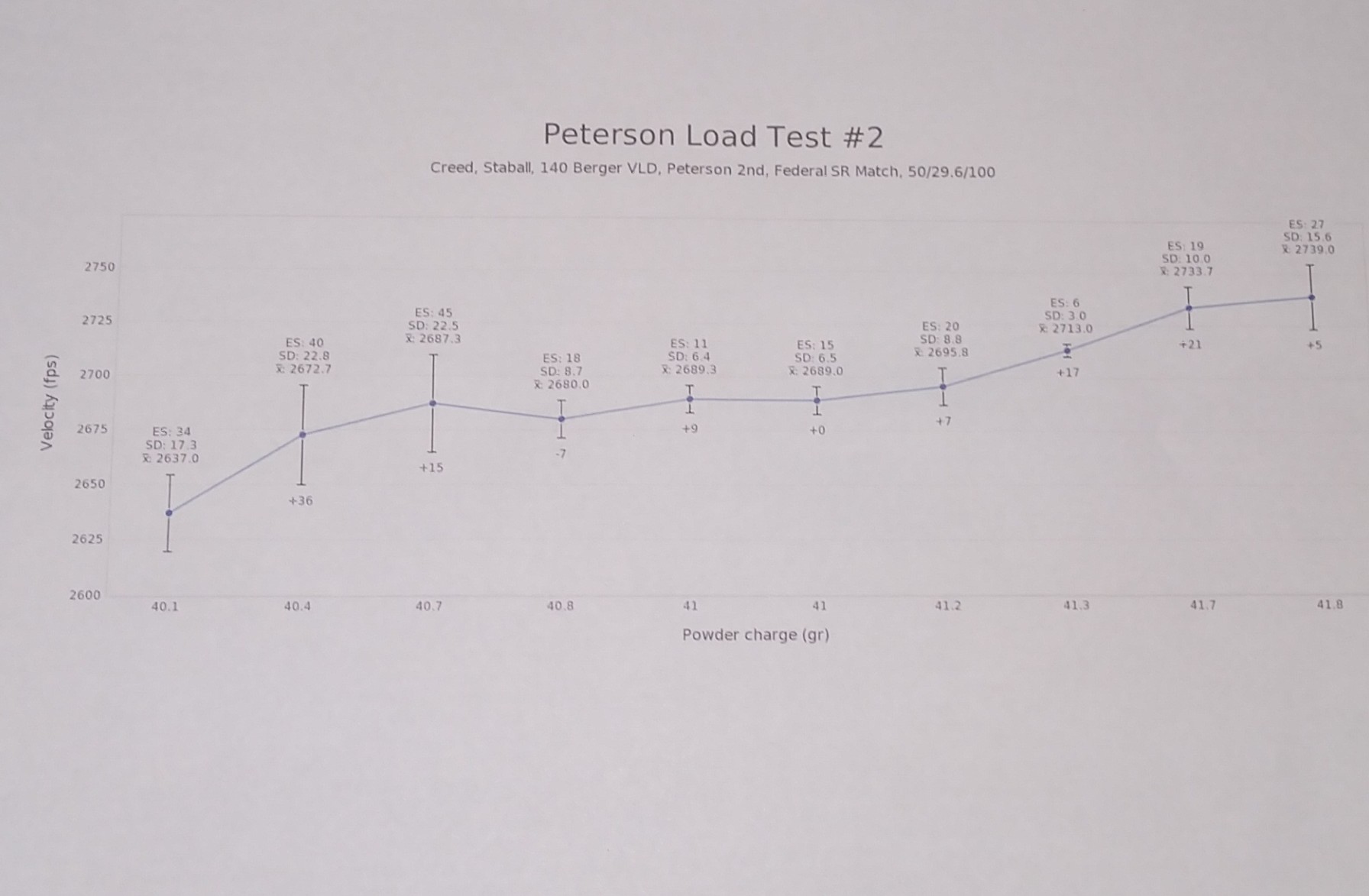

I pulled my last information on Staball development and added the picture.
I use 3 round groups but you get the point.
@ 41. Grains printed .1566 moa group.
Yesterday I fired 2 more groups over the chronograph just to post you some updated information.
At 6 rounds the s/d was 4.5 and velocity at 2684.5.
If you compare it to the original development chart those numbers are holding strong through 7 reloads.
Keep good information and it will serve you well.
Shoot safe.
