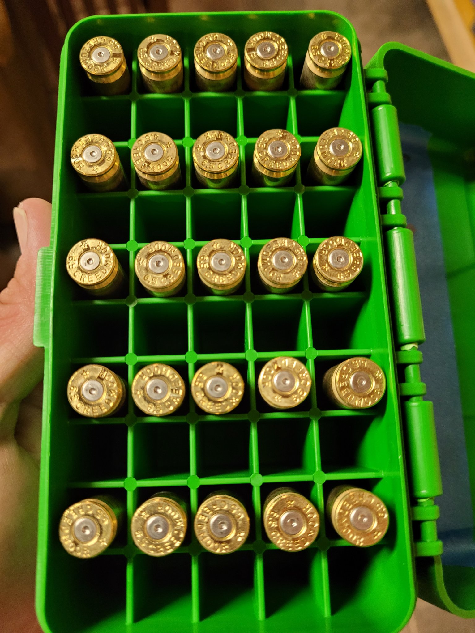

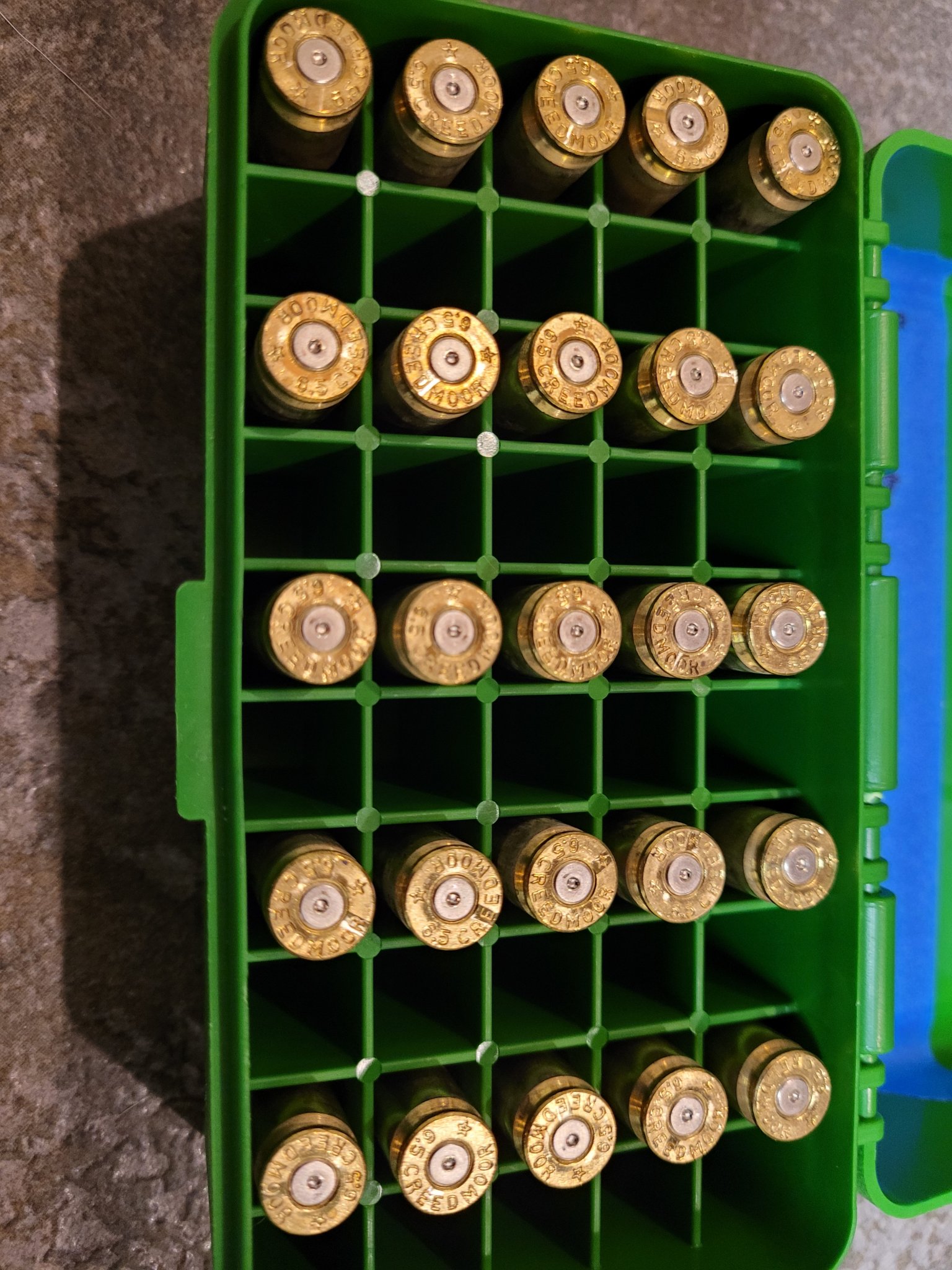

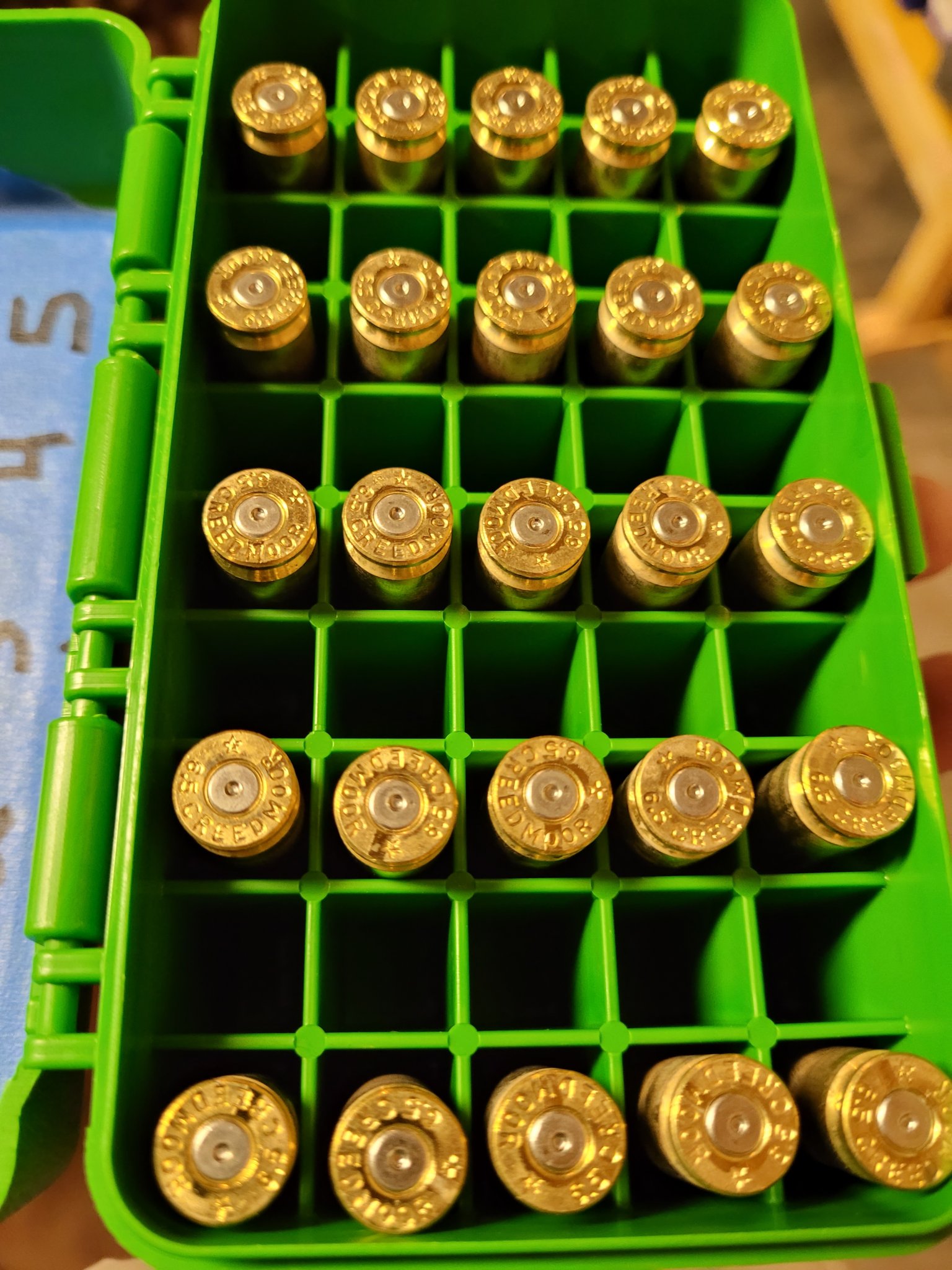

Later pics: anyone have any ideas why I am getting pressure now with these???

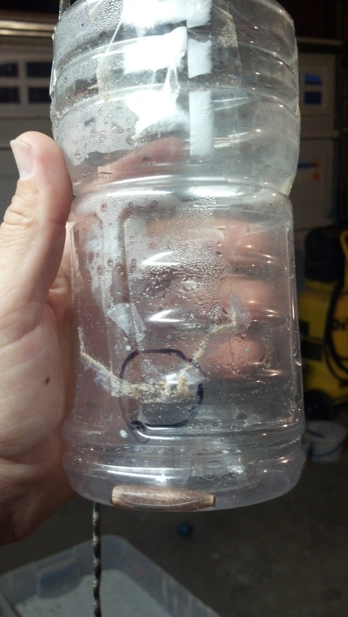

Powerade Bottle with bullet still inside was at 1760.
The Liter Coke Bottle was at 2060.

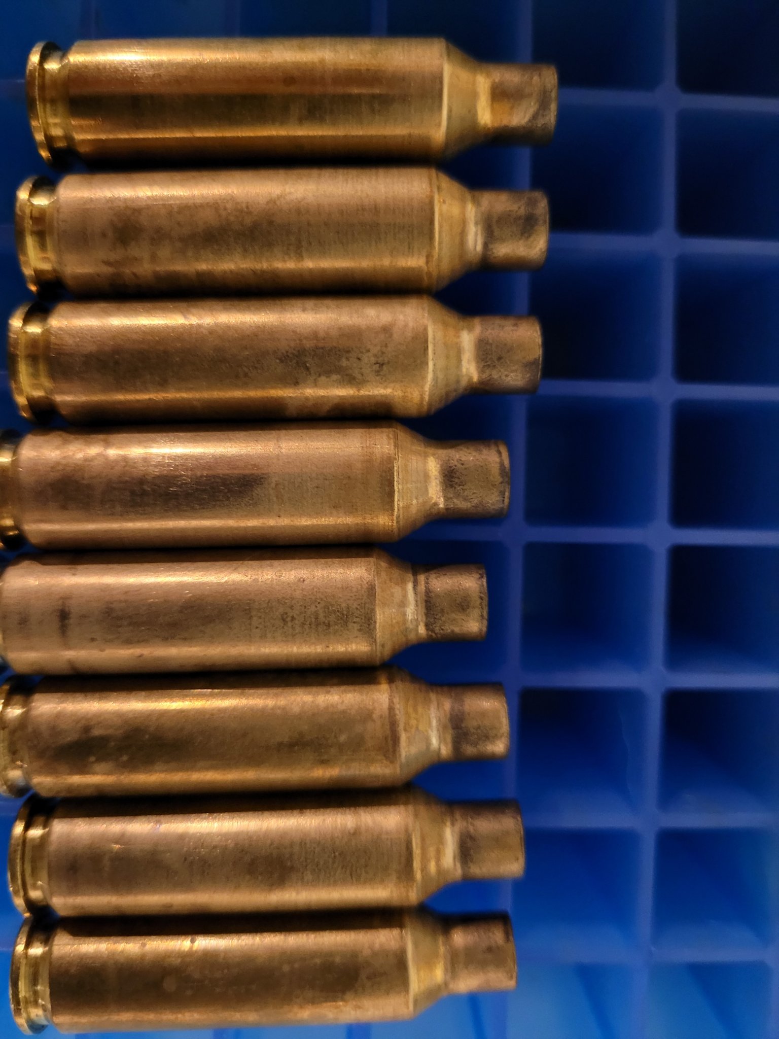

On the topic of speed.
I posted a video to YTube awhile back titled Case Life.
Essentially following a Lot to retirement.
I stopped using it at 42x because I ran out of the bullet and couldn't justify testing through another development on such weathered brass.
Anyways, you put some gas behind them and I was curious what life you're getting from your cases.
Documented information is better if you keep good logs.
Also curious at what elevation you're shooting at?
I ask because I enjoy the "what effects what" aspect to reloading.
