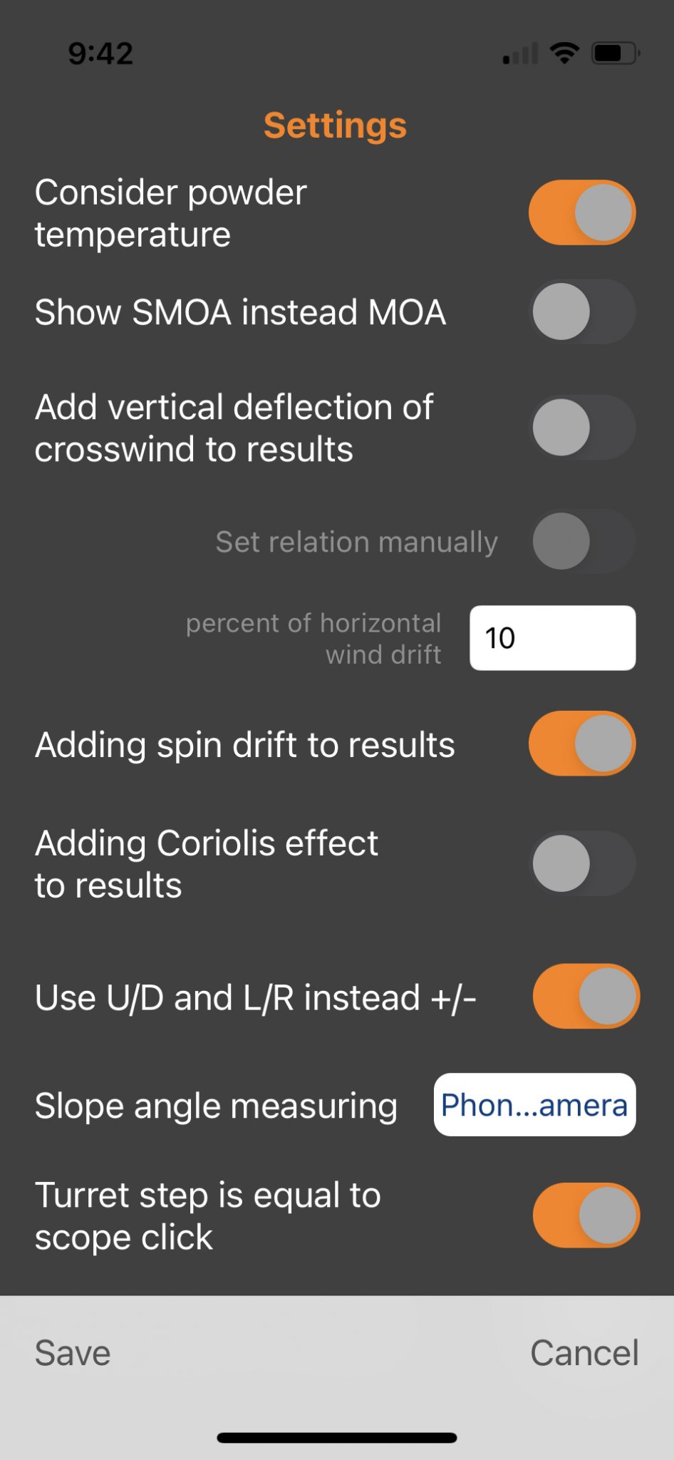

It's under MV:
But I was talking about the parameter at the top of the settings page "Consider Powder Temperature" (which is what you think the ambient temp of your ammo is sitting in the box or in the mag):

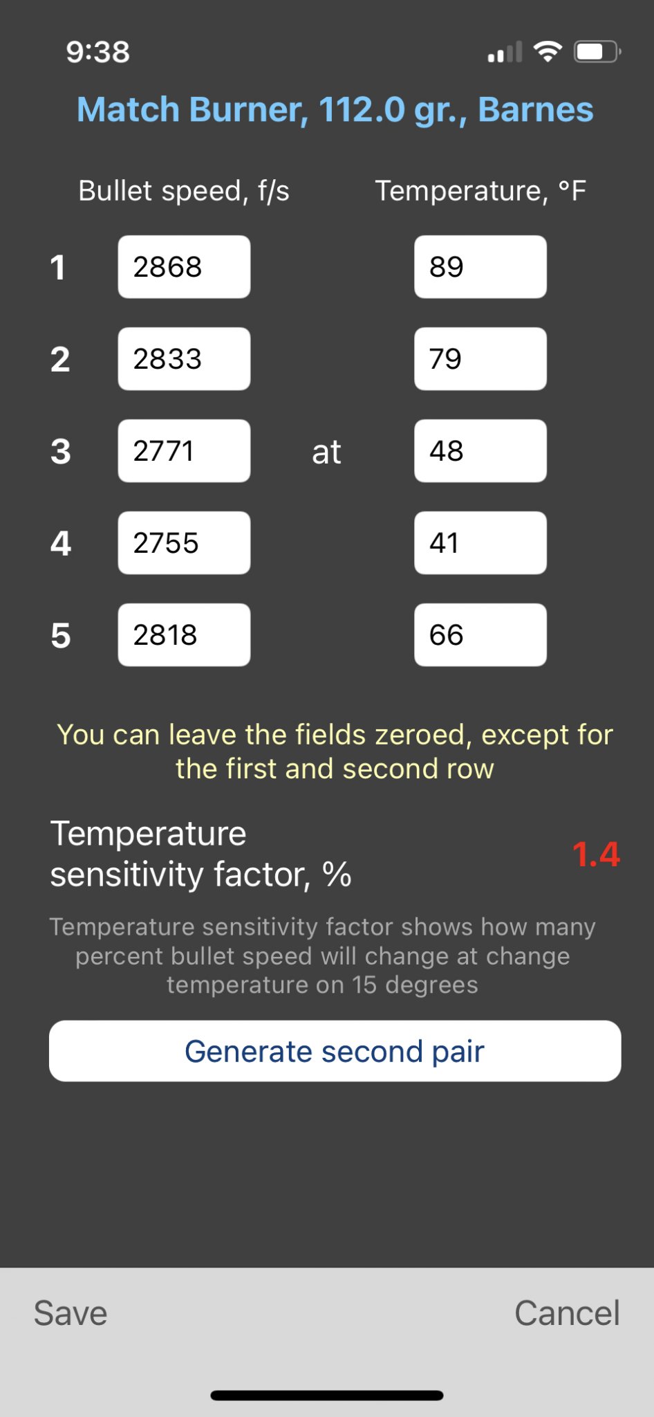

Ahh, I see it. Strelok appears to calculate it from temperature pairs. Hmm, I don't have that data but one could fudge it.

The more the merrier, I try to remember to chrono a few if the temperature is +/- 10 degrees from when I last chrono'd and also Strelok will populate some of the open places as you true your MV on different days.... chrono a couple, and true a few times, and after a while, it gets pretty dialed in.
Once I've got a few solid numbers in there I pretty much expect first-round impacts out to 1000yrds, and once everything is in Strelok I can go months without touching anything... I'll true my BC here and there but as the weather changes it tracks well, even when it's off it's rare if it's more than a tenth...
Using a magnetospeed, I saw a 30’ish fps temp variance from frozen to 110 degrees. This was with 140gr bullets and FC210 primers. Those getting these wild spreads have deficiencies in their loading, measuring or thinking.
Using a magnetospeed, I saw a 30’ish fps temp variance from frozen to 110 degrees. This was with 140gr bullets and FC210 primers. Those getting these wild spreads have deficiencies in their loading, measuring, or thinking.
Lol. That's one egocentric conclusion. :rolleyes: Or, your Magnetospeed is broken (not that unlikely honestly).
A 30'ish FPS spread with StaBall over those temps doesn't match what I've seen (or what most have reported), and would be neck and neck with the best of the best as far as temperature insensitivity is concerned. H4350/RL16 are the kings, and that's playing in their stratum (https://precisionrifleblog.com/2016/06/19/powder-temp-stability-hodgdon-extreme-vs-imr-enduron/).
It's temp stable for a ball powder, just not that good, let's not get carried away.
My SD's stay in the single digits and I get softball-sized groups at 1250 yards, so think my loading and measuring are under control, so it's probably just my thinking that's fucked up, but there isn't much thinking involved when just entering numbers I read off a chrono or truing impacts and letting the calculator glean what it wants to from that.
But, IDK, that Cal guy might have the same have deficiencies in his loading, measuring, or thinking that I do... his data is probably BS and wrong too (unless it matches yours of course). :p

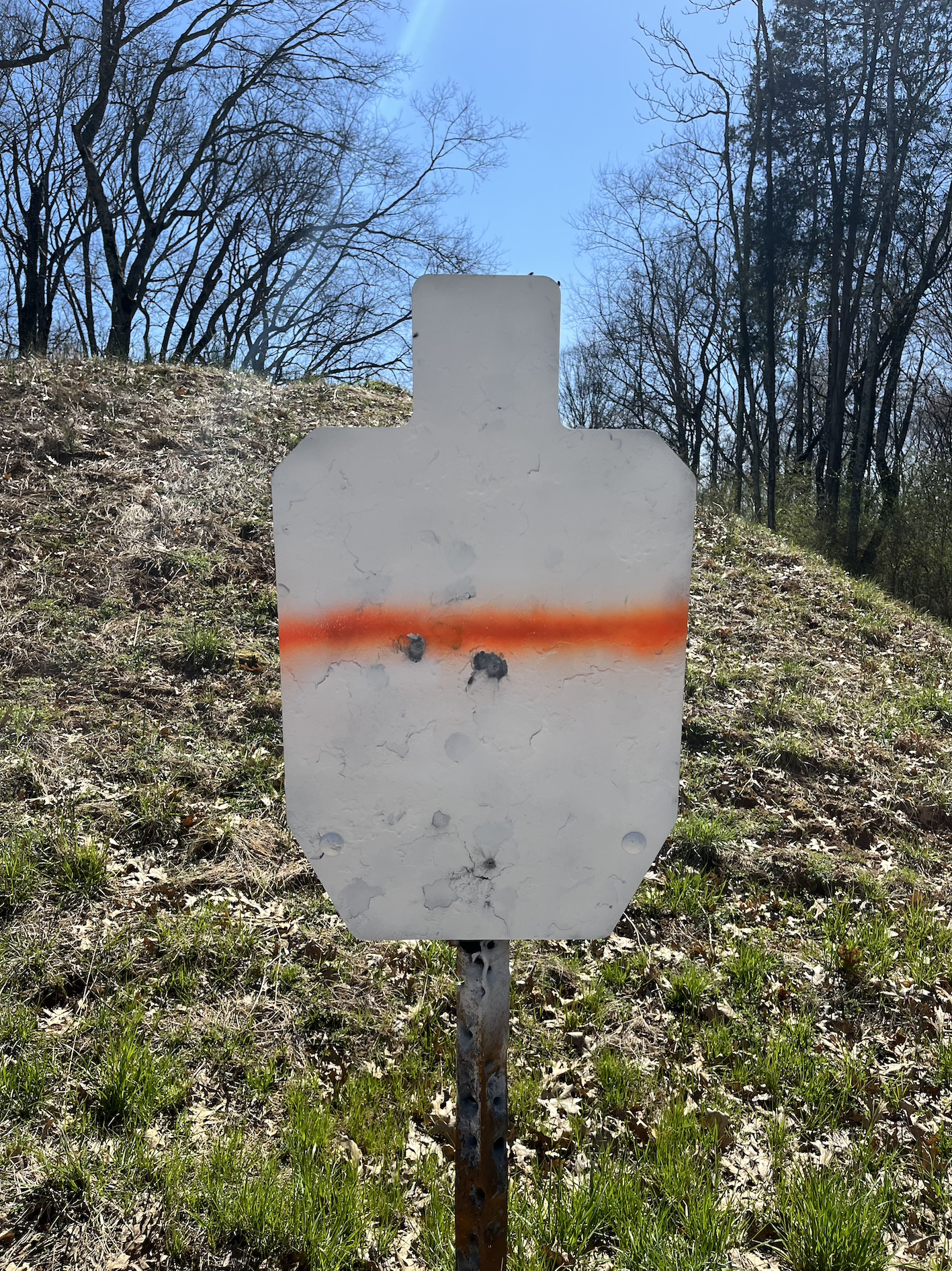

Nope, boring old out-of-fashion 6CM. I'm just running it like a Dasher, 41 grains easy peasy, and jumping a mile to see how long my barrel will go shooting this dumb "barrel-burner" and not going anywhere near the lands lol.
1,250yrds IPSC, 2100rds on a Proof prefit, still going... :

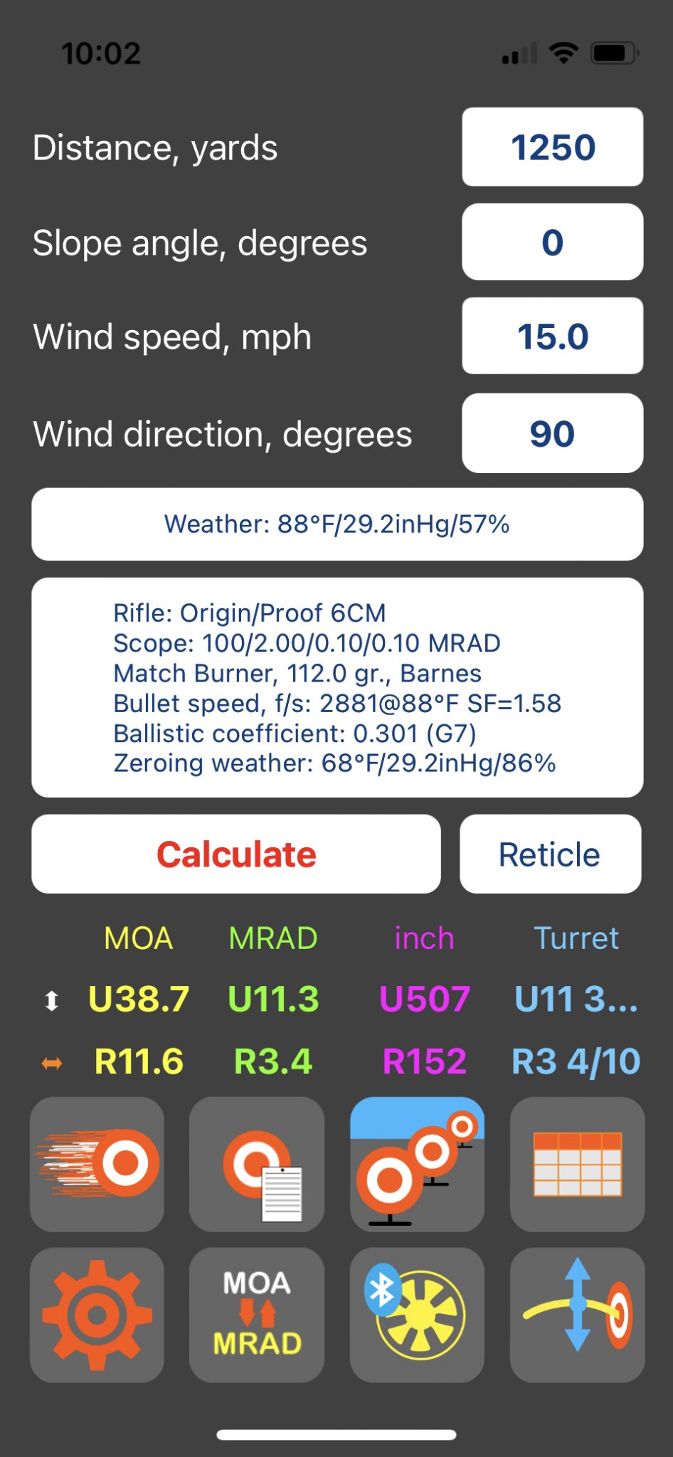

6CM
Lapua ex-22-250Rem-to-6CM brass (7x fired, AMP Aztec mode, originally necked up to .241" with a mandrel and zero-hassle fire-formed into 6CM on the first loading/firing)
CCI 200 LRP
Barnes Match Burner 112gr
41gr StaBall
CBTO 2.241" / COAL 2.802" (jumping approx. 0.100" to the lands)
- new barrel, zero barrel break-in (don't believe in that nonsense, single dry patch and go), zero load development (rounds leftover from old barrel), rounds #96-#100 down the pipe from the bench with bipod and rear bag:
Reactions: acudaowner
Just saw this thread and realized I never revisited it. I tried magnum primers, the line
of gunk on the bottom of the barrel is no better with them. But it is shooting well, so I’ll stick with it. (The powder that is.)
