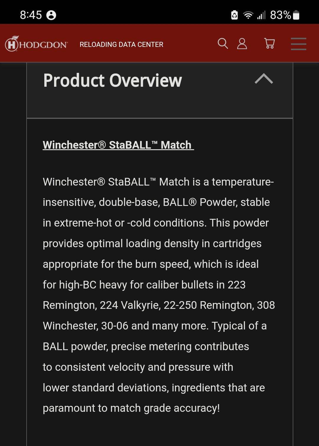

Maybe I have mis-spoken and I'm thinking of BLC. I'll do some looking through my notes tomorrow and get back with you. I don't remember the allocation of "6.5" being included in the title of staball so I'll have to go look.
You must be thinking of your loads with Staball 6.5 which has been out for a while and which is generally unsuitable for the 308.
However, you may have gotten a good load with it, IDK.
Staball 6.5 and Staball match are two DIFFERENT powders.
Says right on their website that it's good in 308View attachment 8065151
You may have but then you also immediately doubled down on being wrong... twice. That’s why you are being treated like you’re an idiot.

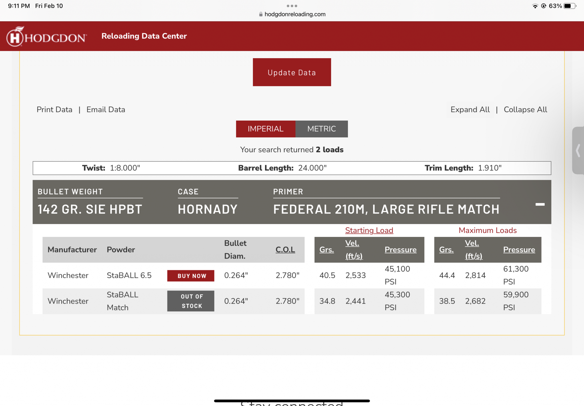

I totally new to loading, I ordered 2 lbs of Match. Im using some new Hornady 6.5 CM brass that came primed. 143gr ELDX. I tried 41gr loading and experienced tight eject. I'm going down to 38 or 39 next. It appears I can't use a higher load with this Match ball powder. Using an Axis II Precision. Bolt lift on this rifle sucks with no round in the chamber, and the lands are really tight out of the box. Getting a chronograph next.
Jesus man, be careful out there! Hodgdon lists 38.5 as max with that class of bullet and match. Staball 6.5 would suit you better as far as winchester powders go for that bullet.

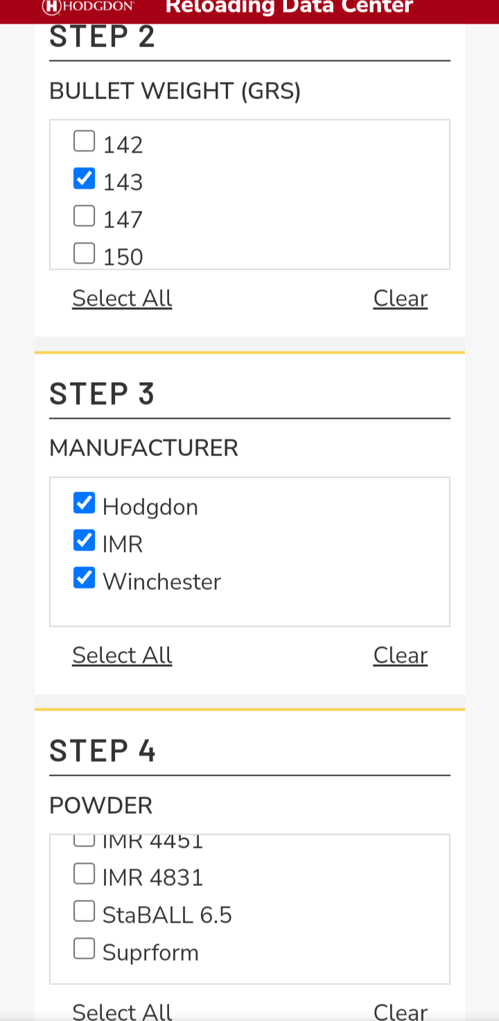

Thank you. I've been having a hard time finding information. I'll add that site to my bookmarks. Haven't done anymore until I found some solid info. Much appreciated.
You never forget something you learn the hard way. My searching led me here. I've got much to digest. I did make sure I wasn't bottoming on my lands, that probably would have been worse.
I couldn't find the Match powder listed
