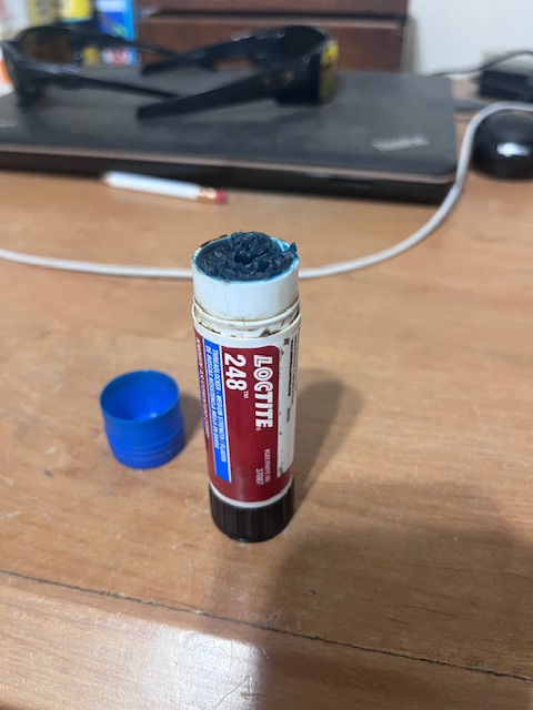

all joking aside, i use blue loctite paste on some stuff. its not nearly as aggressive as blue liquid for some reason.
started using on pistol suppressor threads. put a small dab of paste on barrel threads, let it air dry for about 12 hrs then thread the can on. let that sit for about 12 hrs and break it loose amd re-tighten
that leaves residue in the threads that keeps the can from walking off.

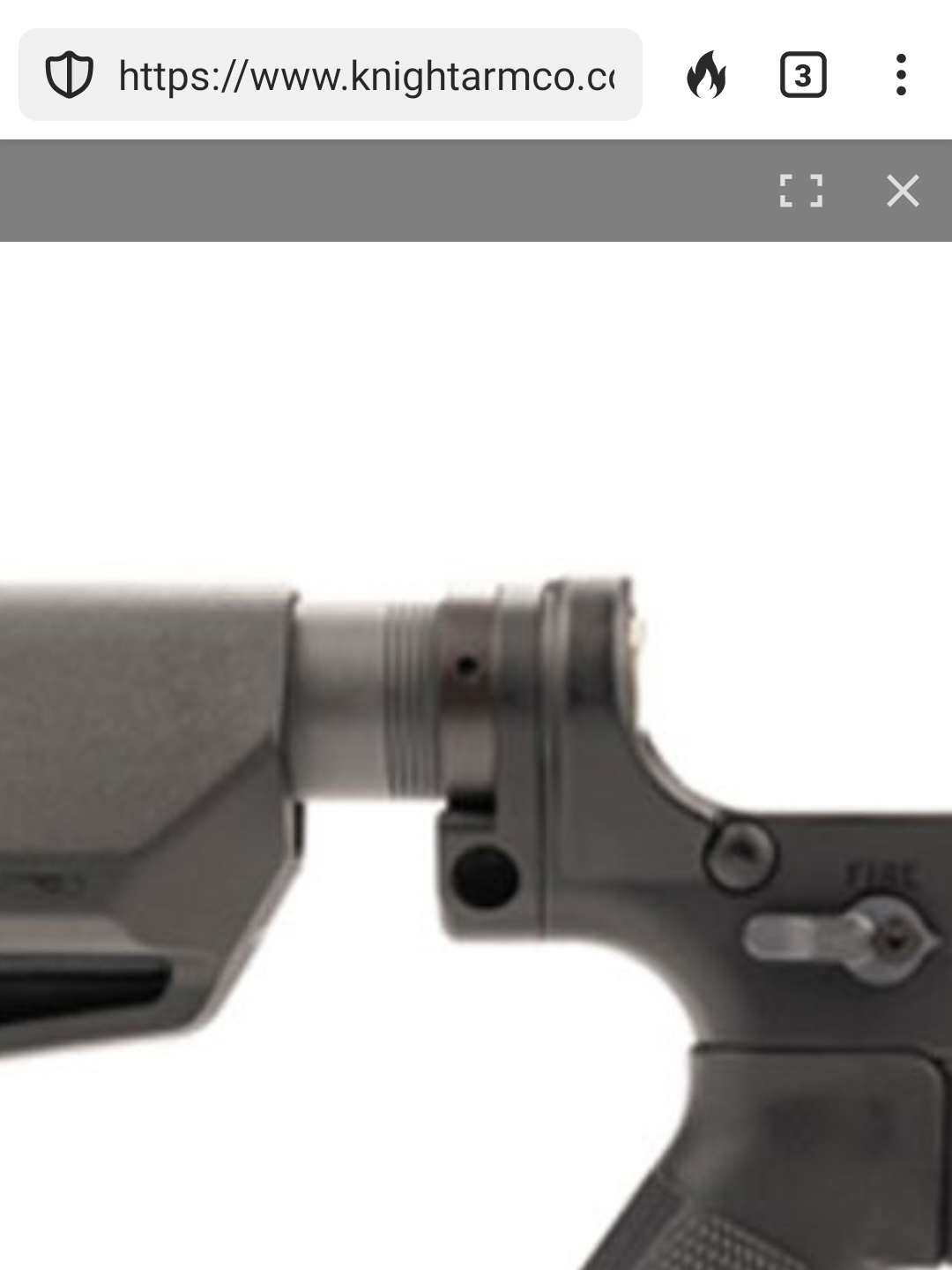

Some manufacturers' end plates aren't designed to be staked, KAC's QD end plate is one example. I think it's probably like everything else with the AR-15. Buy quality stuff and you won't have issues. Buy cheap shit with loose tolerances and you just might.
In recent years they’ve not used those and had stake-able nuts. 🤔
