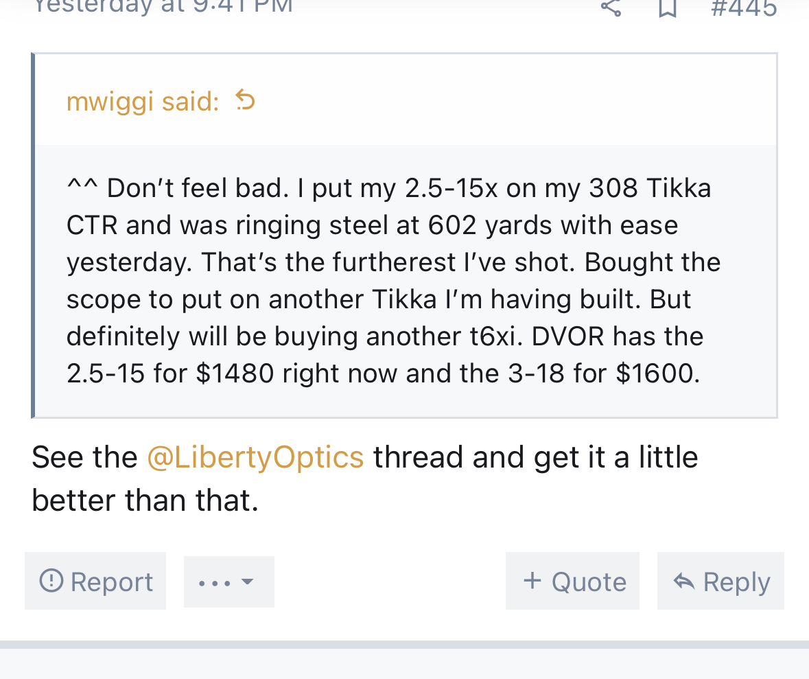

Well I guess l liked my 2.5-15 t6xi. Just ordered this for a AR 6.5 creed build I’m finishing out. Be my second T6xi now

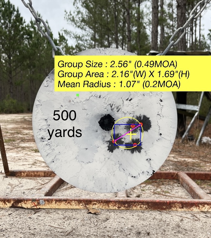

^^ Don’t feel bad. I put my 2.5-15x on my 308 Tikka CTR and was ringing steel at 602 yards with ease yesterday. That’s the furtherest I’ve shot. Bought the scope to put on another Tikka I’m having built. But definitely will be buying another t6xi. DVOR has the 2.5-15 for $1480 right now and the 3-18 for $1600.
Reactions: B Man

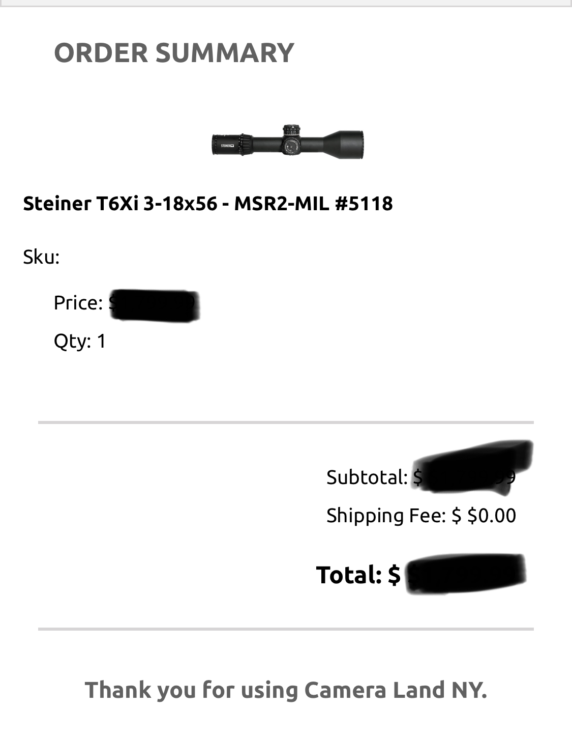

Those prices are crazy good! And I thought I did good on mine at camera land. Oh well they are great folks there so I’m good with it.
Yeah I’ve ran my 2.5-15 to 700 yds a few times on my Mega built AR 223 easily on 12” plate. I wanted to go 5-30 on this one but being practical I won’t shoot over 1k hardly ever so felt the 3-18 will suit my needs more on this build. They are fantastic scopes, especially for the price.

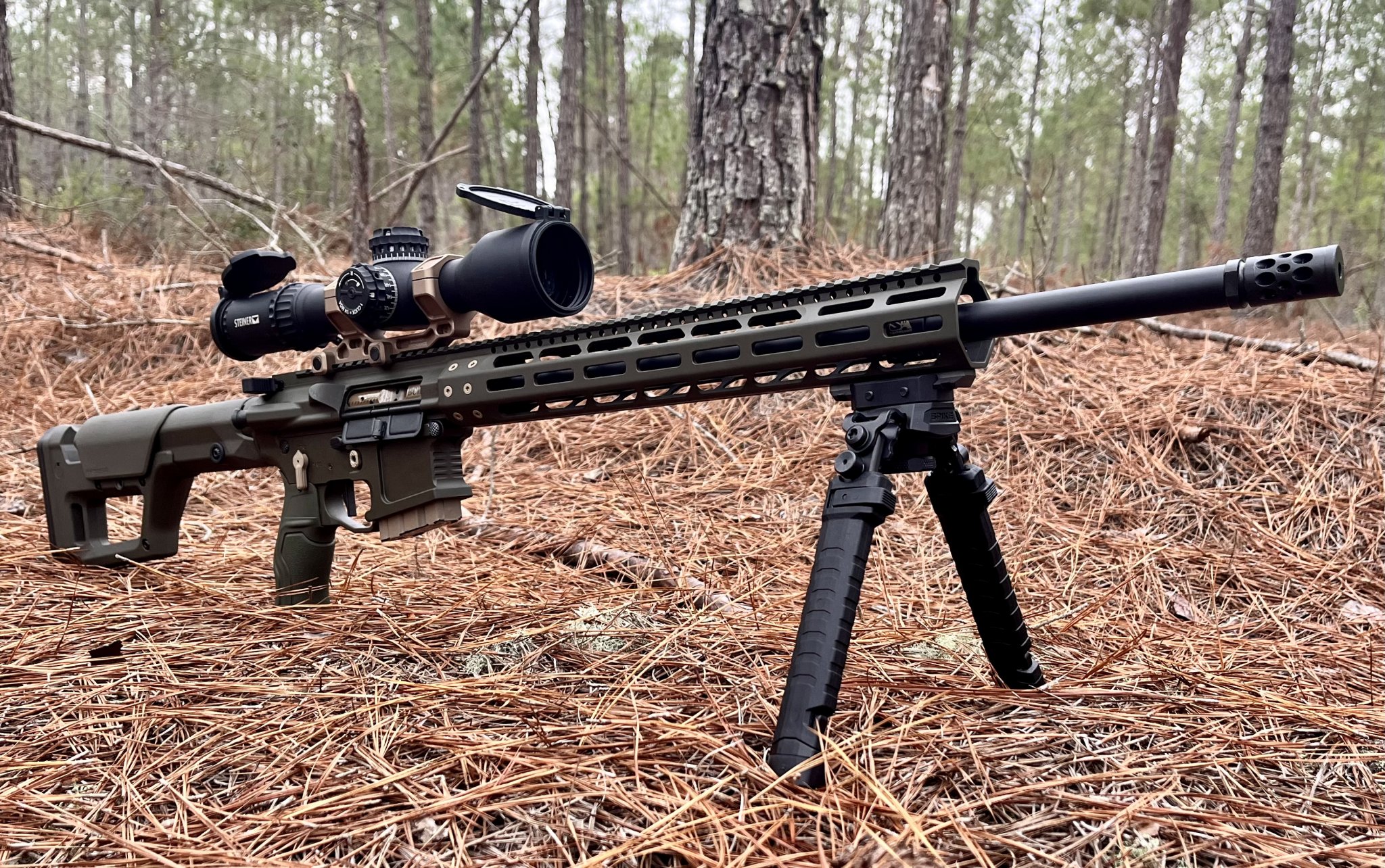

I've ordered the 3-18, its going on my 2A-Arms 6.5 Creedmore AR when it arrives. I was torn between the 2.5-15 vs the 3-18, but since the weight is so close I figured go big or go home.

This is my first “higher end” scope and I’m hooked. But you’re right about the magnification, up until now I’ve had 5-25x on everything and that’s really not needed. Going to ultimately put it on a whitetail hunting rig and 15x is more than enough.
That’s an impressive AR, doing good to hit a torso sized target at 25 yards with my AR pistol. Bought it without doing any research cause it was cheap. I need to at least get a decent upper though.
It’s shoots great, my favorite set up. Scope just fits the role perfectly

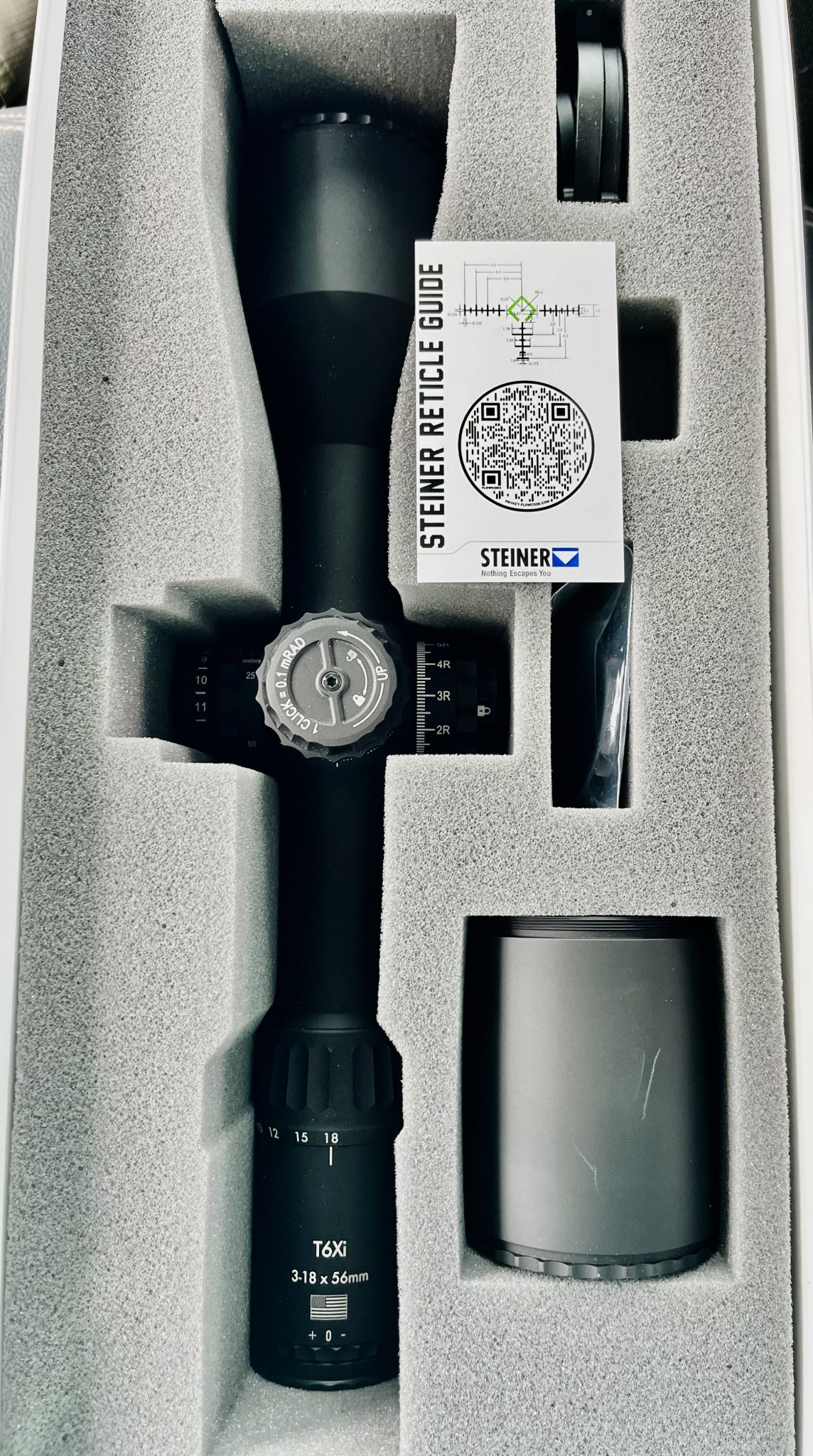

I don't have a Burris to compare my new 3-18 to. Just received it this week. I looked pretty heavily through the glass today, both during some cloudy morning hours and also when it was mostly sunny. My current other optics are a couple Sig Tango 6 LPVOs, a Leupold VX-5, a S&B PMII 5-25, a Steiner P4Xi 4-16, an SWFA Ultralight, a Tract Toric, and a Delta Stryker 1-6. The T6Xi glass to my eyes is better than all but the Schmidt. And its not far off that, in fact I might say its equal, but would like to compare out on the range and side by side before I make that claim. The glass is just super clear, no yellow or blue tint to it like I often see on cheaper lenses.
I don't know if the T6Xi is German glass, but I expect it is. My other Steiner and the Schmidt to me are the best glass I own (although the P4Xi has some CA on bright sunny days), and both use german lenses. I had a Razor 1-10, and it didn't compare. The only other 3-18 I've ever owned was a Tango 6 Gen 2, and the new Steiner smokes it.
The eye relief is awesome, I love the green reticle (wish it was brighter), and the eye-box for a 6x erector is pretty forgiving. Now I want to try the 1-6 and the 2.5-15! Gonna have to wait though, as we lost most of a big tree during the recent wind storms, and cost to cover cutting down and removing would probably have funded both of those. Such is life.
Id like more info on the 1-6. Also, how sturdy are these steiners? Im used to nightforce. I get what I dial, every time, and they just don't break. Im torn in the nx8 fcdmx or this 1-6.
See the @LibertyOptics thread and get it a little better than that.
