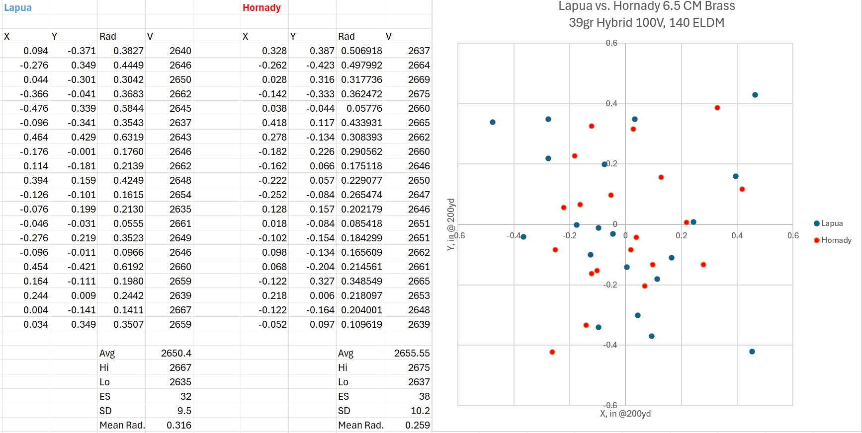

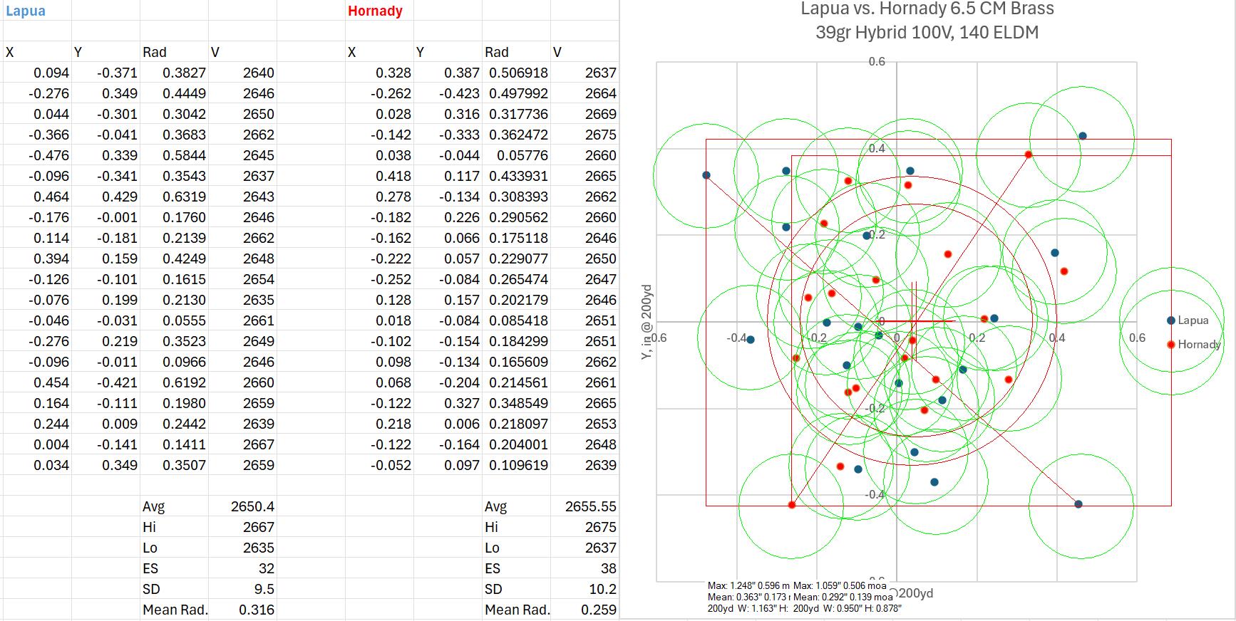

What's particularly interesting to me is the target. Those Lapua shots measure 1.248" ES, .596 MOA; Mean Radius: .363", .173 MOA. Hornady's measured 1.059 ES, .506 MOA; Mean Radius: .292", .139 MOA. Hornady wins on target results. ;)

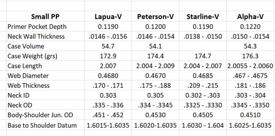

How is Alpha brass stacking up against Lapua?
I'm new to Alpha brass as I only purchased some just a couple months ago to give them a try. The first thing I do when I get a new batch of brass is to take measurements to see what I'm dealing with. In the pic below you can see how those measurement compare.
The one things that really did surprise me was how consistent the case volumes, as well as the corresponding cases weights, are for this particular box of .308 brass. It was better than any of the Lapua's I've had. . . better than anything else I've had to date. The primer pocket depths were the most consistent as well.
That consistency showed up when I fire formed them. I fired 80 consecutive rounds and got and SD of 6.2 with an ES of 29 for the 80 rounds. . . best I ever got out of virgin brass. I did have to chamfer and deburr the case mouths before loading though, which was the only thing I did to the cases before loading.
Note: these are all virgin brass measurements:
The one things that really did surprise me was how consistent the case volumes, as well as the corresponding cases weights, were for this particular box of .308 brass. It was better than any of the Lapua's I've had. . . better than anything else I've had to date. The primer pocket depths were the most consistent as well.
Good stuff. Thanks for taking the time to do that and post the results!
Question: what is the -V? Is that 5 pcs measured? Thx
"V" is for virgin. I also measure after firing and designate as "F". 15 pcs measured.
In case you or anyone else is wondering, I use pin gauges to measure ID's and web thickness. Note too, when I measure web thickness, I always deburr the flash holes with a 21st Century deburring tool so that I get a good thickness measurement.
