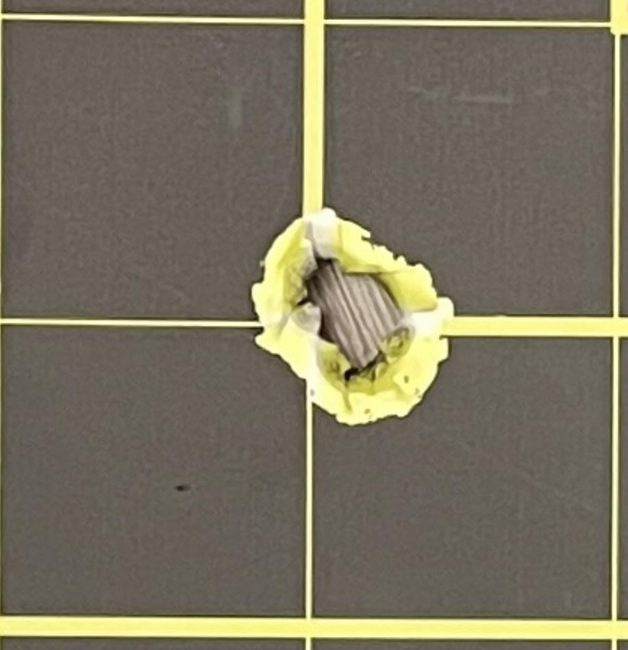

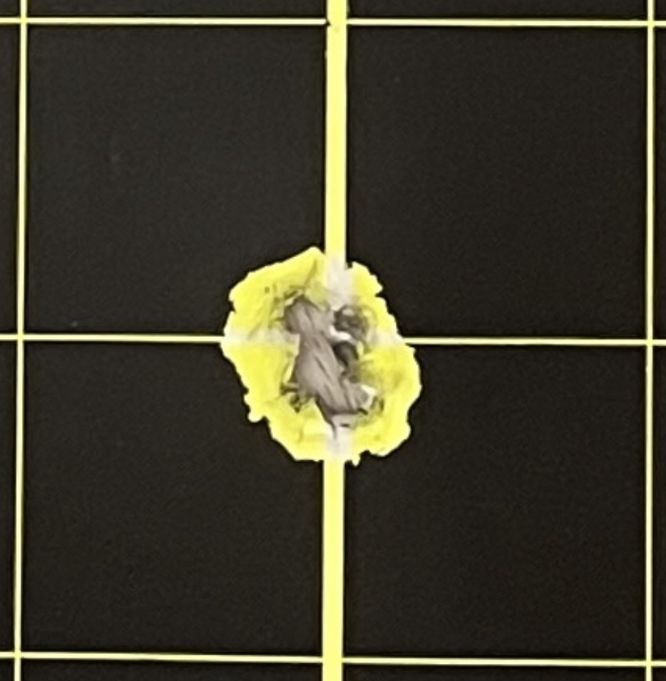

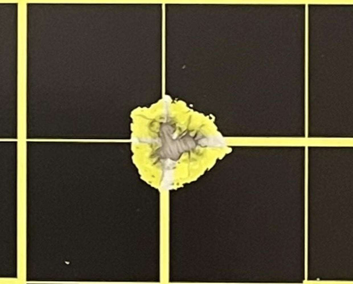

Not that long ago, while testing, I shot the mythical one hole group. (0.13 group size.) However, the group before it was over an inch. Third group was closer to two inches. It happens. Moving up to the next powder charge weight, one group went slightly over an inch, but the two groups before and the three after were well under a half inch and most running in the 0.35 inch range. If that was one large group, I would say the rifle/load was over an inch. However, the grouping tells me, that the rifle/load is quite capable, and that one bad group was an anomaly. Maybe I be wrong, but the loading has been very successful and has shown a very good ES and SD.

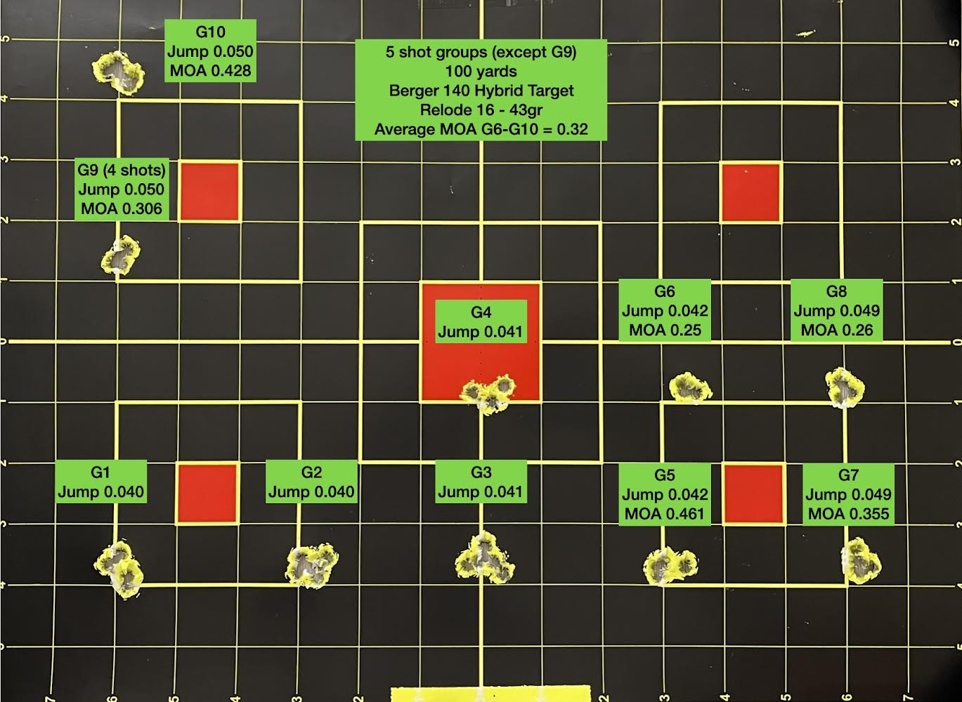

Seating depth tests worked for me. I was able to reduce my group sizes from 0.75MOA (average with factory ammo's) to under 0.25MOA consistently. The barrel was Bartlein so I guess that helped greatly.
When I bought the rifle, I tried a bunch of different factory Match ammo's. Group sizes varied from 0.45MOA to 1MOA. But the smaller groups are not repeatable.
Then I bought a $600 Lyman reloading kit and this was one of the earliest seating depth tests.
Then I found a few nodes and this was the confirmation test.
In the end, the rifle shot under 0.25MOA consistently for 5-shot groups when the jump was 0.050". These are some of the best groups.

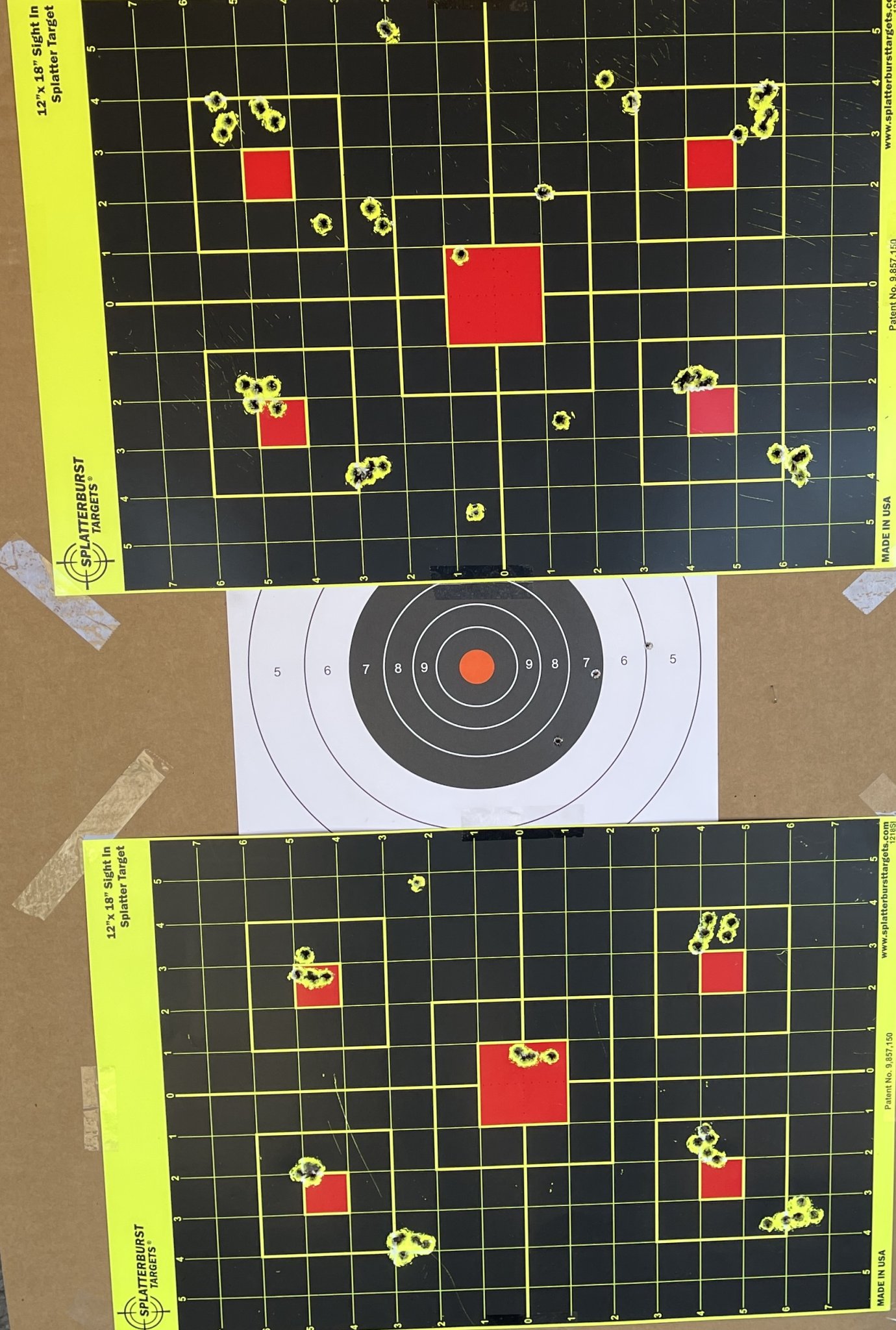

Shooting 7 x 3 shot groups is far superior to 2 or 3, 3 shot groups & gives far more info for the shooter to see what's going on.
If we refer to Markl323 target pics (nice shooting by the way) we can see that if we look at where the groups are situated with respect to the box intersection lines, we can see the group centers shifting around from group to group when we compare each groups POI center.
This is not a huge deal for the most part & tells the shooter most of what he wants to know but, if you were looking for a very fine measurement, we can see how, many small groups don't account for an overall shot POI shift which tends to artificially shrink the true dispersion if all the groups were counted as one large group.
This why I much prefer 10 shot groups. Ten shot groups are overall easier to work with & they reveal a slightly more honest account of the situation.
This why I much prefer 10 shot groups. Ten shot groups are overall easier to work with & they reveal a more honest account of the situation.
To be sure, when testing, unless things go really awry early on, I make it at least 21 shots, in 3 shot groups. The three, 3 shot groups demonstrated such bad results that I simply felt it was worthless to continue printing good shotgun patterns than obtaining decent data.
