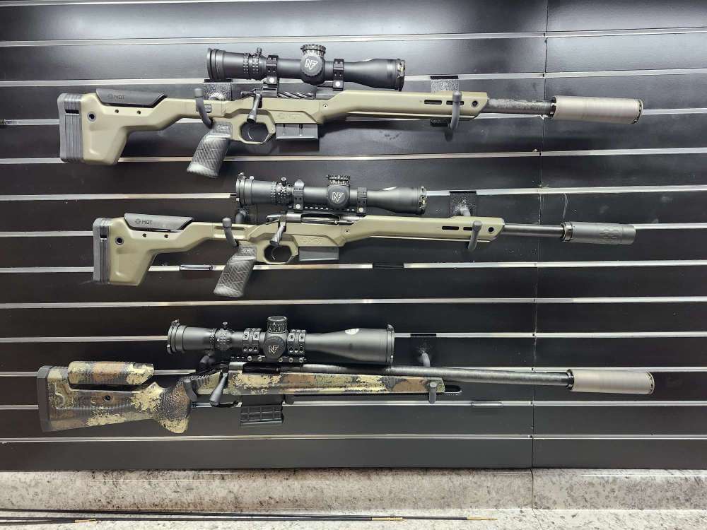

My Casio keeps better time than my Rolex. Some people just like nice things. I've done the 450 and highly recommend the 350 over it.
Origin 350 legend (middle)
Reactions: 2c1fr
IDK if that's what OP needs, but that's exactly what he's asking for
