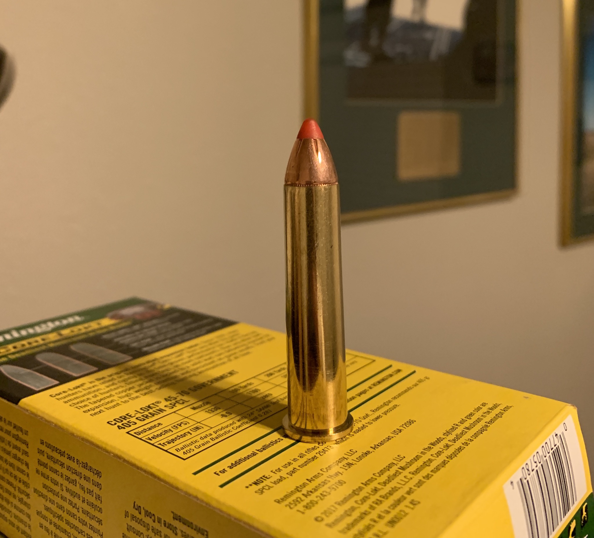

    45-70 will getter done. A fella at the range was getting decent 2-3 moa groups at 200 yards with that cartridge. You’ll get better accuracy than he did. He was shooting a scoped hand cannon Ruger Blackhawk.
