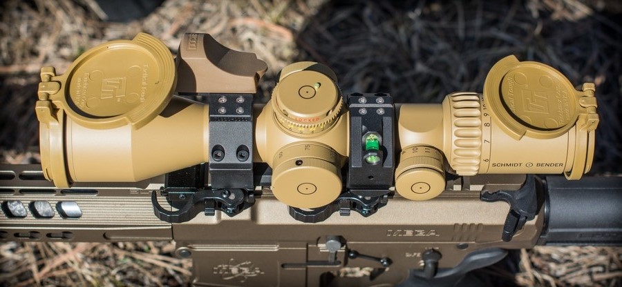

There are also scope mounts that accept RDS plates right on the rings like ERA-TAC, here was my Schmidt Ultra Short 5-20 with an ERA-TAC mount and a Doctor RDS on it
